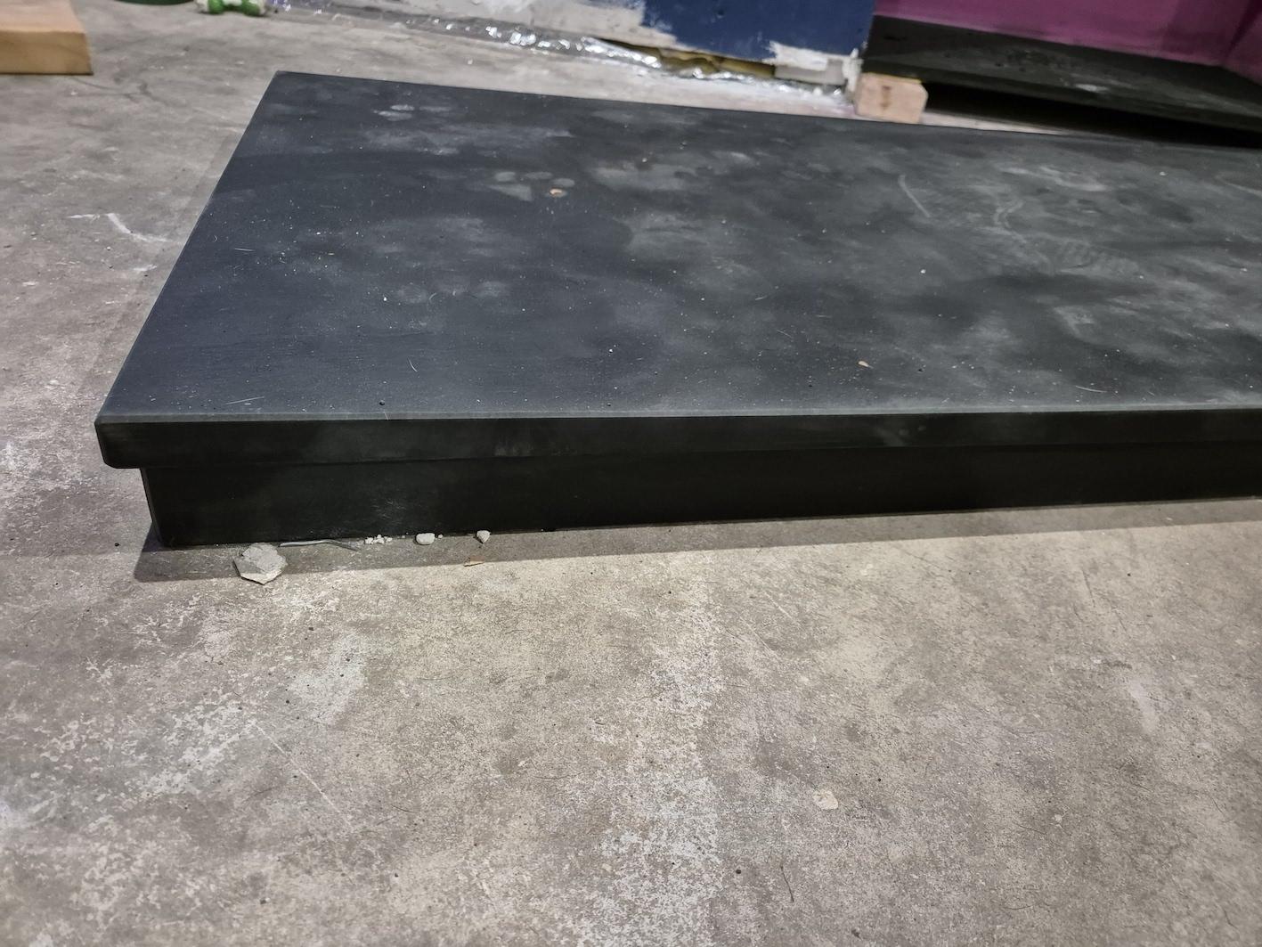

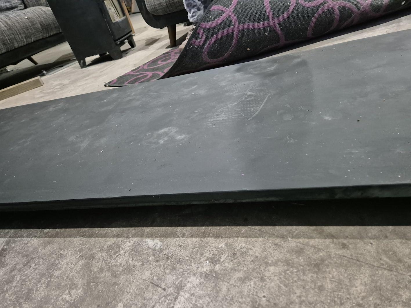

Hi trying to decide on the right size of hearth from the wall for opening of 760 mm, I understand what building regulations say this is more what looks right. I have drawn a hearth on the floor which is 1400mm x 450mm and one at 1400mm x 500mm but not sure about it. What has othere people went for as i see some hearth advertised at 600mm deep. Also what have you used for the hearth I need somthing robust as concenrned people will drag things accross it even if they are told not to.

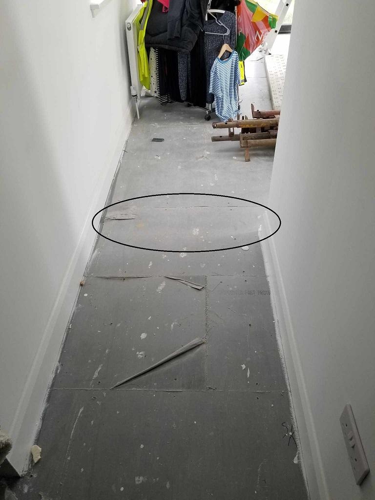

Do you not think you will notice it if a good quility underlay and carpet was fitted?
I should of relised that this was going to be an issue as when we plasterboarded down stairs we had to pack the joist out. So the floor in the bedroom dops by 10mm and the entrance not sure if I can use a thin underlay in the coridor and a thick one in the bedroom to resolve the issue. if I wanted to change the hight of the floor it is a lot of work.

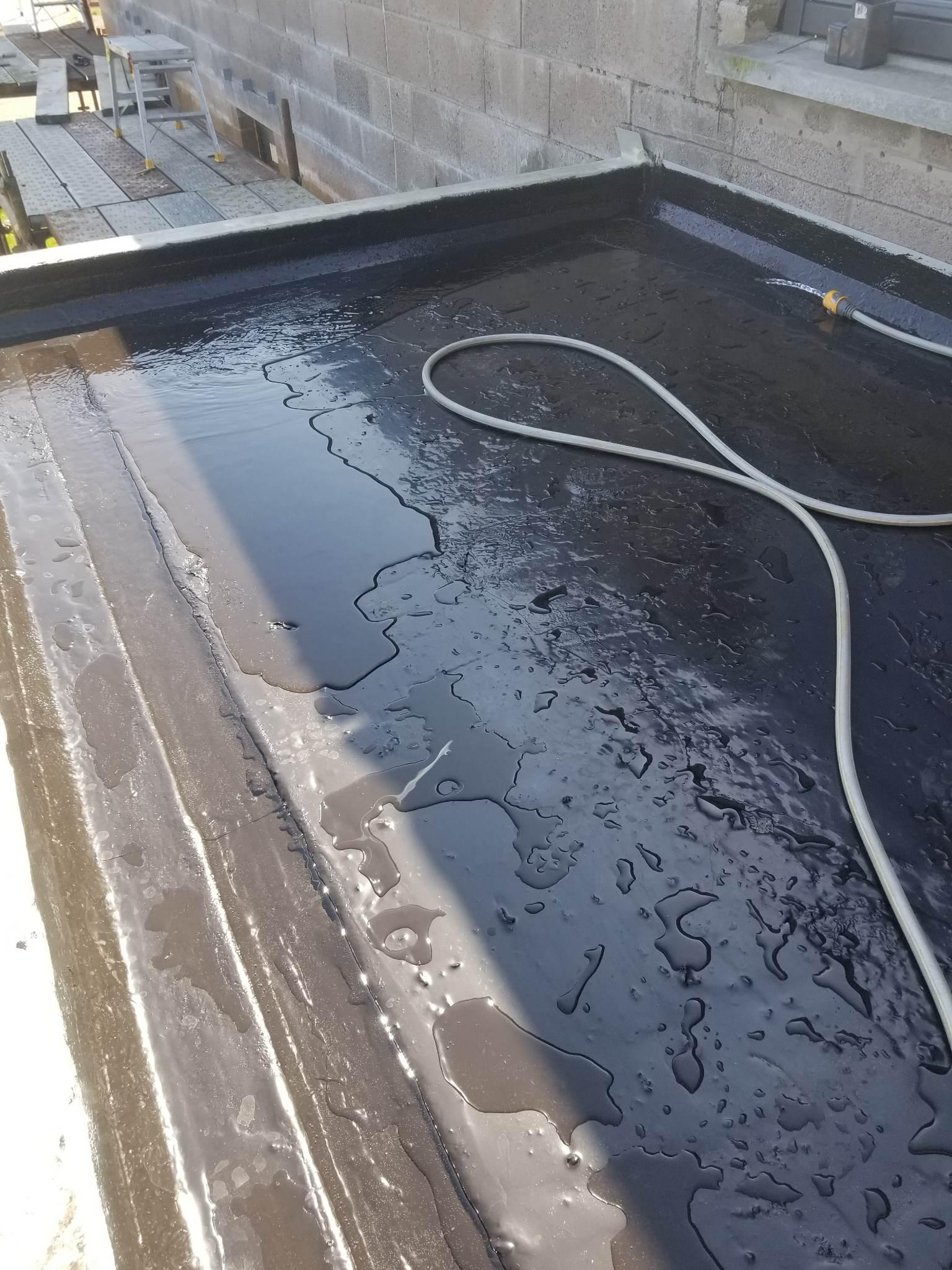

So that will be fine as the roof according to the span guids can take 200 kg/m2
Horrible stuff. The roof joist are 1800 mm long 145 depth x 47 and at 450 centres looking at the span tables it can take 2.8 KN per square metre. That is about 200 KG per square metre

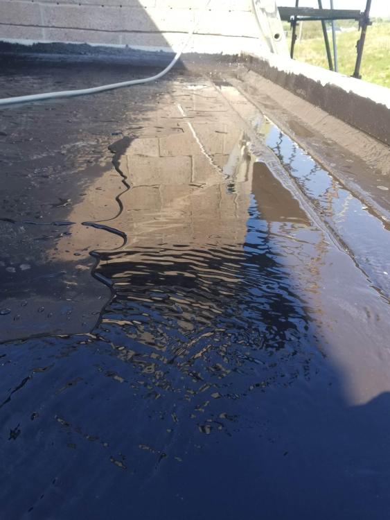

Hi After numrous probelms with my flat roof I have managed to get it water tight with liquid ruber. It does not look pretty though so was thinking about making it a green roof. The roof is North facing with a waal to 2 sides it also has a down pipe coming of another roof in the corner. There is a bit of ponding on the roof see pics will this be an issue and what system would you recomend to buy?

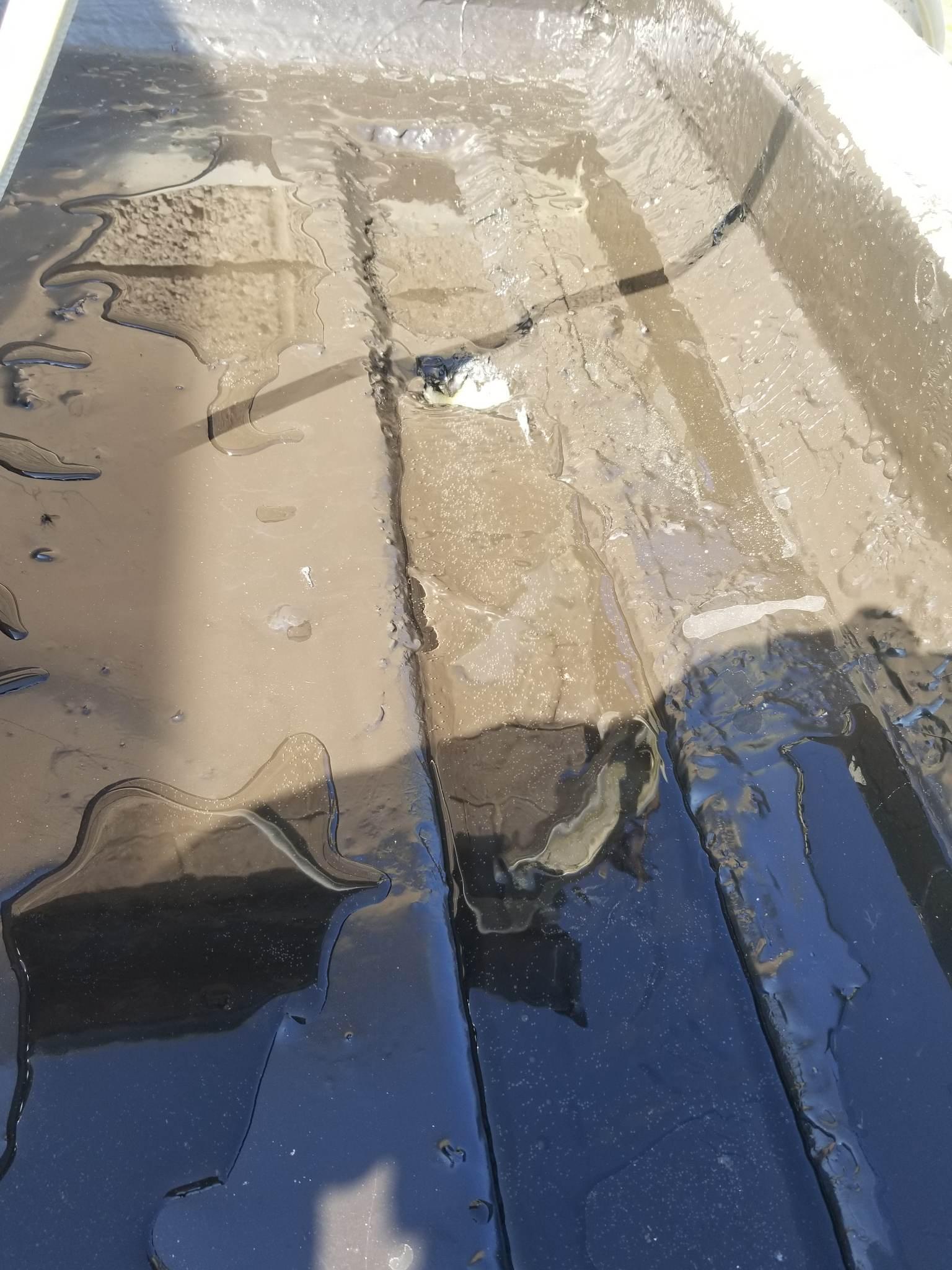

I was informed that the top coat was not a waterproffing coat by cureit and was worried if I put the top coat on and it was still leaking then I would not beable to fix it. The roof looks OK and enough resin and can not seem to recreat the issue with a hose unless I am not hitting the right part to make it happen. I was going to put some more matting on in any supspect areas -
Hi I have a flat roof which I did myself using CureIt GRP system not finished yet as no applied the top coat. I decided to make an internal drainage for the roof as I did not weant to put a gutter on it. After it rains for a while I start to get water dripping from offset part of the down pipe but I am not sure if the roof is leaking or the pipe is sweating. I did put some wool insulation in to try and keep the room air away from the pipe but it just got wet. I do not want to spray in PU foam as incase it hides the issue of the roof leaking and the water goes else where. I have been upon the roof and ran a hose and do not seem to be able to recreat the problem. Any advise on what to try next?
