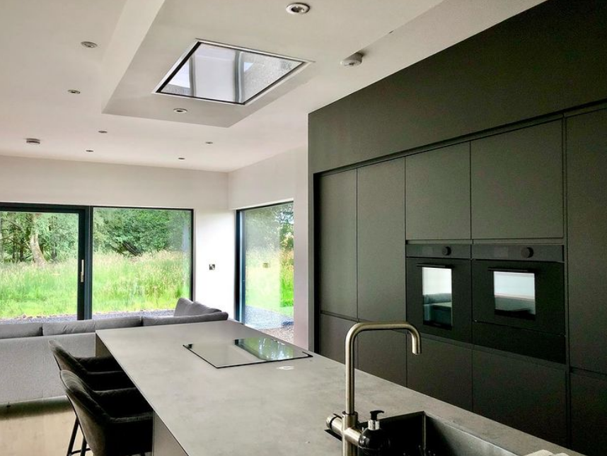

  3. We've had them for a few months now and I really like them. The only issue we had was that the catch on the warming drawer would not hold, Samsung replaced the whole unit. They also come with a five year warranty.

  8. If you are looking for black appliances I'm pretty happy with our Samsung infinite Range. Steam oven, oven microwave combination and warming drawer. Hob is Samsung as well. They all seem to be working great.
