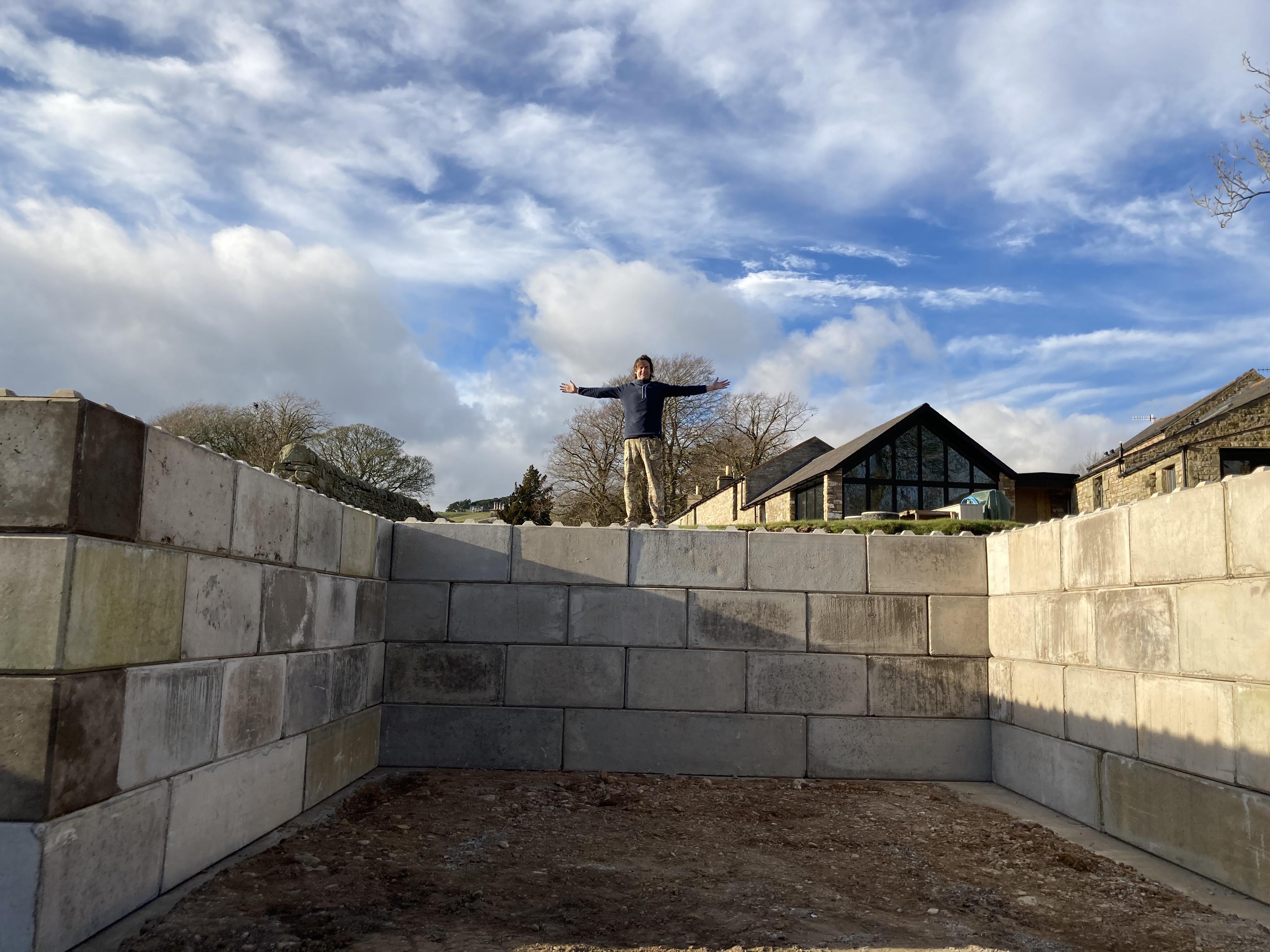

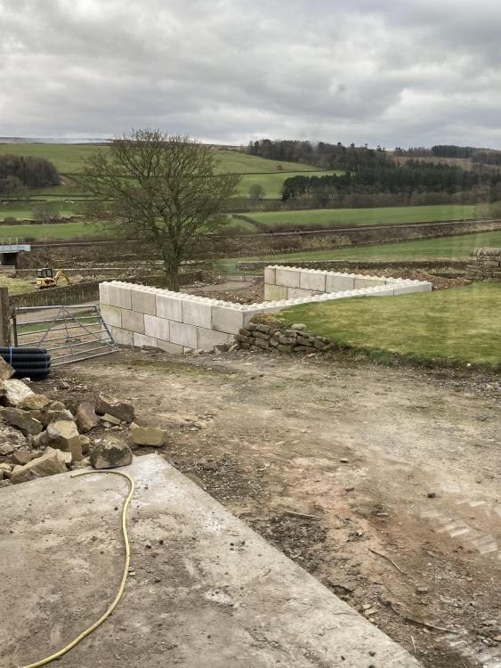

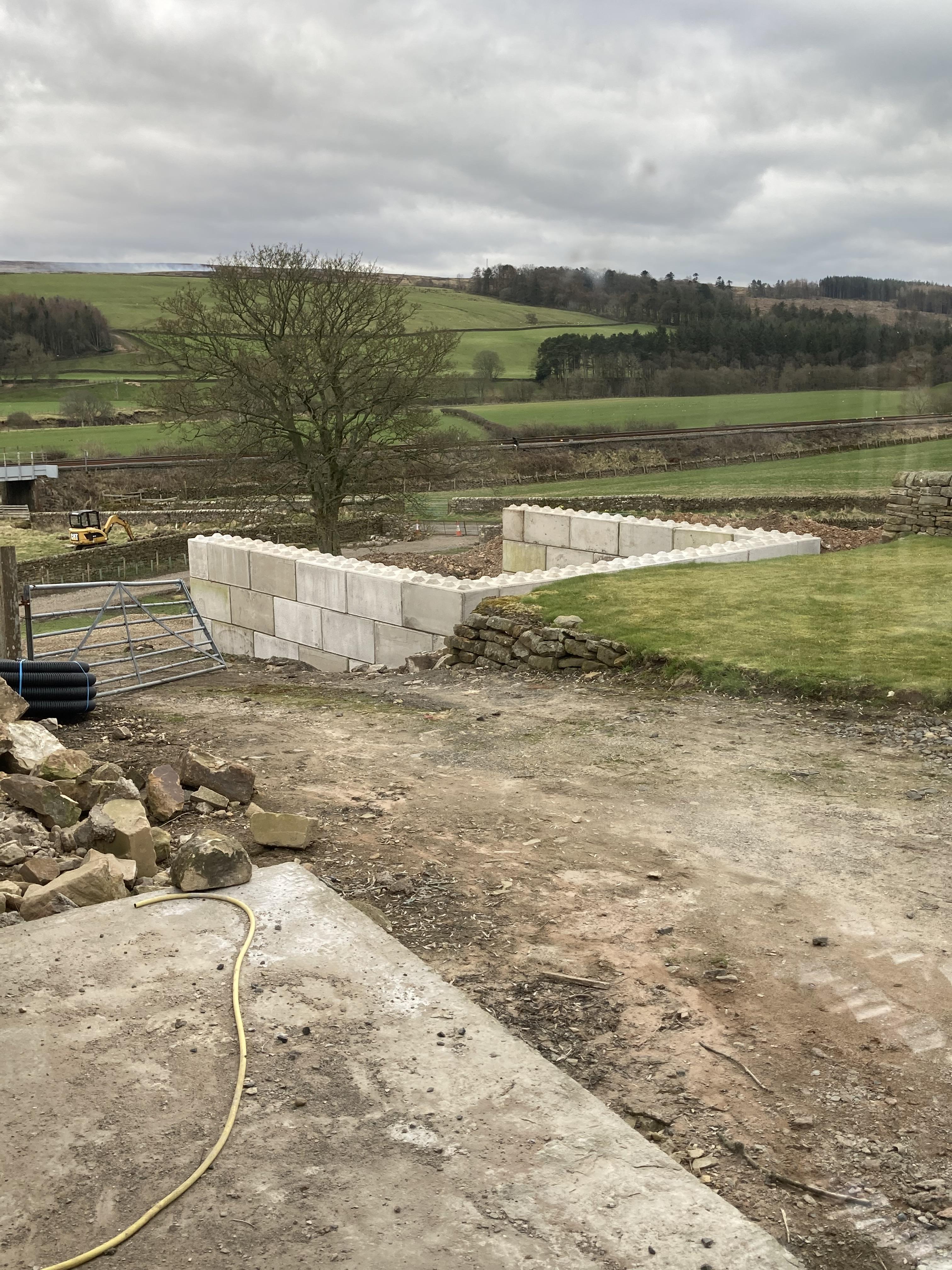

I have just had three retaining walls erected at 2.4 metres high using concrete lego blocks. 64 blocks went in in 5 hours. Its fantastic stuff. Not sure of your location but I am very close to the Cumbrian border in Northumberland. The Lego is made nearby. Its obviously not pretty, but can be disguised. A 1200 x 600 x 600 block is £75.00. I got free delivery as local. Simon. -
