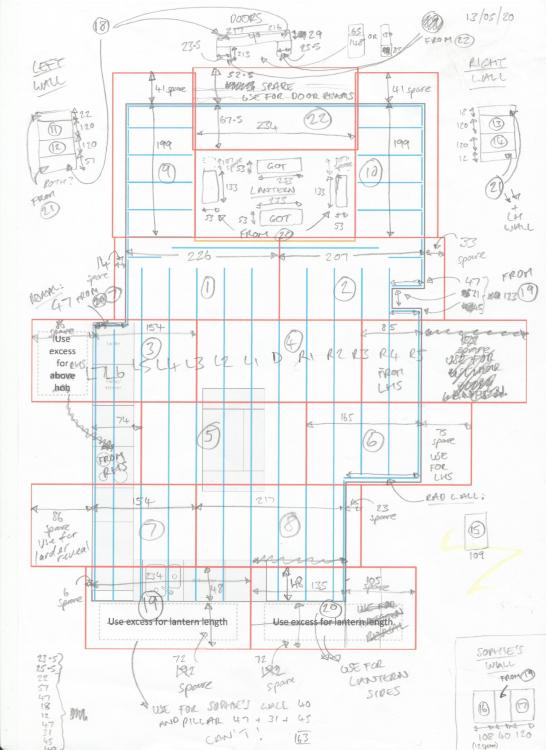

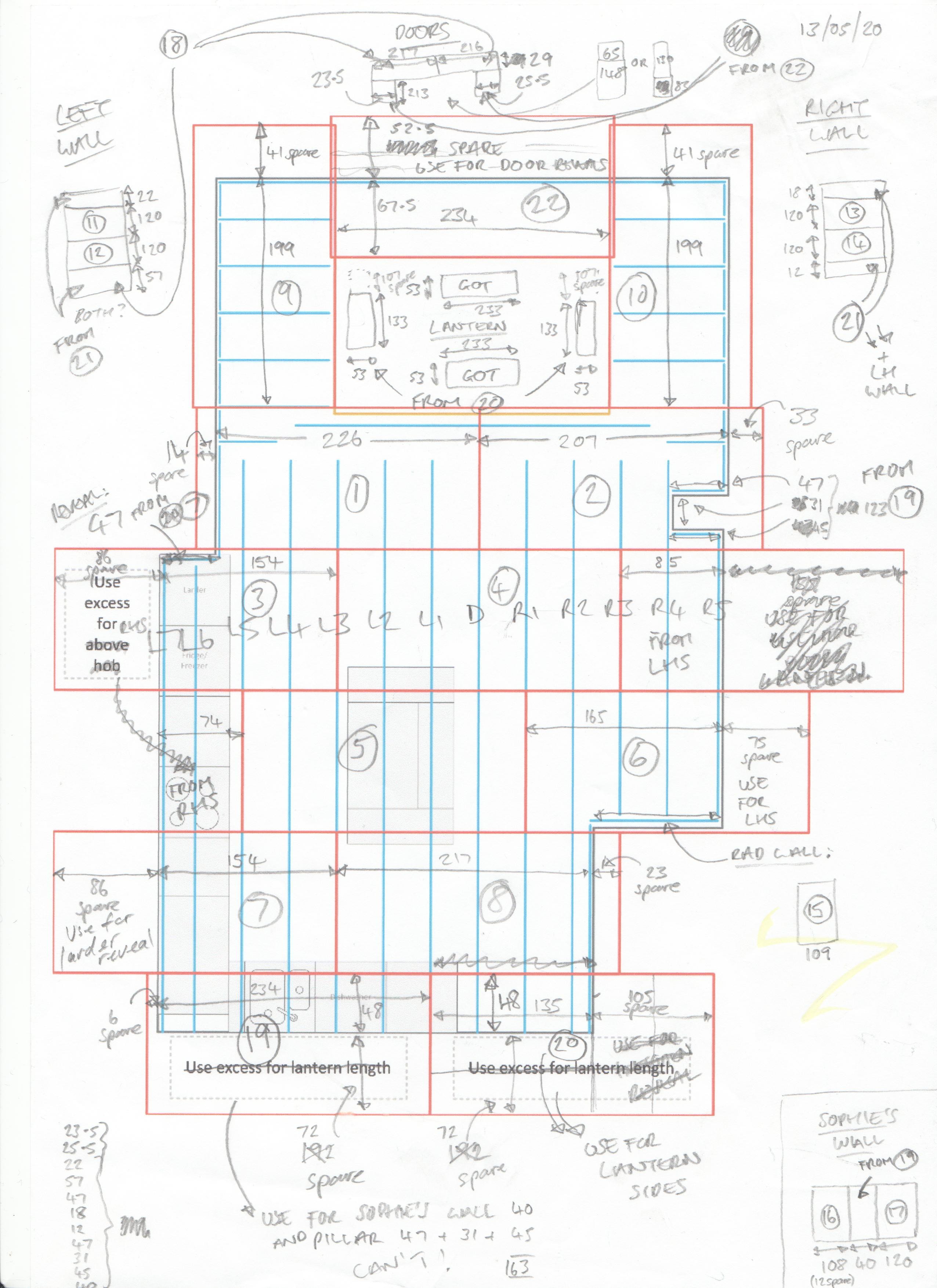

Thanks everyone for the input - all really useful. Following up on a couple of points: Yes, that's what's concerning me. Even more so that I might screw up a hole and have to perform a repair of some sort. Doing that on a beautifully finished skimmed ceiling would make me weep! It's a bit of a complicated room shape, with a lantern cutout and numerous corners to accommodate, and moving the boards round on my board plan didn't give me many options without resulting in thin slithers or another joint-related problem (e.g. MVHR vent holes) somewhere. The problem join is the bottom row of boards below (where 7 and 8 run alongside 19 and 20) above the worktop beneath. More to the point though; the boards are already up! That's good to hear. As long as the plasterer can cope with it (i.e. it's not a showstopper - just a preference) then I'm a bit more content. I could always bung him £20 or something as a token gesture for any grief these holes cause him! -
The question as to whether to cut downlight holes before or after skimming seems such a commonly asked question on the Internet, but with a seemingly 50:50 split response this doesn't sit well with someone like me that prefers a right and a wrong way! I have just finished plasterboarding our new extension ceiling with 12.5mm square edge board on resilient bars at 400mm centres. As my (bad) luck would have it, 3 of the 5 downlights (for worktop task lighting) look like they're going to end up slap bang on unsupported board edges/joins (paper edged of course) and so I am getting nervous about what consequence that might have in terms of causing cracks, either during installation (if I drill the holes after the ceiling has been skimmed) or just long-term due to a compromise of board strength. I was thinking I might cut the holes before I get the boards skimmed then any movement during cutting won't be an issue. I could also then feed some adhesive-backed timber/plasterboard up through the hole and position them across the board edges/joins adjacent to the holes just to give a but more support. Does drilling holes beforehand make life hard for the plasterer? Will it inevitably compromise the finish he can achieve? I did ask him when he quoted (pre-lockdown) and I seem to recall him just saying he prefers no holes - mentioned something about plaster falling out - but I didn't really push him as at that stage I didn't realise I'd be wanting to drill on some joins. I also didn't realise what a maze of joists and resilient bars I'd be up against, and typically how nearly all of my desired downlight positions seem to be really near some sort of obstacle so if I screw up I'd rather do that before it's skimmed (to allow an easy repair) than after. I might be worrying over nothing... I do that. A lot. But if you can honestly tell me a plasterer won't have any issue with five 70mm holes (okay, and three 125mm holes for my MVHR vents too) over a 35m² ceiling that'll set my mind at rest.
