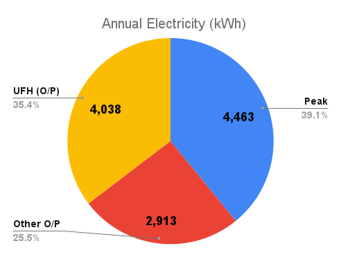

 As I have discussed on earlier podcasts and various topics, I have a Willis-based configuration for heating our low energy house, and control is implemented with a dedicated Raspberry Pi using a custom NodeRED application for our underfloor heating and SunAMP-based hot water.  This system logs a lot of instrumentation temperatures every half hour and also any significant events such as turning on and off pumps and the heater.
Our electricity supplier has been OVO for the last 4 years, and because we have a smart meter, the control application also includes a script to log on to the OVO Portal and download the daily usage data into the MySQL database.
Because these latest energy hikes, we have decided to revisit the issue of whether it would now be cost-effective to install an ASHP in order to save on monthly electricity costs for heating.  Because I have been logging all relevant data for the past 4 years, I can base this decision on hard actuals rather than some generic planning assumptions. The next two graphs summarise these results.  The first is an analysis of our daily energy use (we have an electricity only house).  What I have done here is to aggregate the 4 years of data by calendar month and split these into three categories:

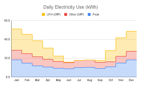

  • Underfloor Heating (34%  or ~4,000 kWh/yr).  In practice, we only heat off-peak and use the thermal mass of the floor slab and the house itself to smooth out the overall background heat levels.  As I have discussed in other topics, this results in a temperature ripple of about 1°C which is quite acceptable given the reduction in overall all heating costs.
  • Other Off-peak use (25% or ~2,900 kWh/yr).  We also use a couple of small oil-filled electric heaters on the first and second floors for the 4 cold winter months.  These output roughly 1 kWh and run on a timer (actually controlled by my home automation system).  We find that 3 or 4 hours is typically enough to keep the upstairs acceptably warm in the coldest month; this also means that the UFH on-time doesn't need to run over into peak periods. Our resistive load white goods (the washing machine, dishwasher, SunAmp DHW) are timed to come on in the off-peak period.
  • General Peak Rate use (39% or ~4,500 kWh/yr). Pretty much all of our baseload and direct hands-on devices: fridges, freezers, cooking, computers lighting, etc.
Note that the 2 retired (out of the 3) occupants of the house spend most of May, June, September, October abroad; hence the dip in this general use figure.  I find the annual variation on this base load a little intriguing ,and I am not sure why it is so high.  Our live-in son often has his radiator on in the evenings when he's at home, and we do spend more time indoors in the cold dark months.
1174027032_DailyElectricityUse(kWh).png.9fddf57172b5a236322dcf8b13a2ce2d.png784369419_AnnualElectricity(kWh).png.c948d863703e26666b779eee417d10c0.png

I've only been collecting external temperature data for the last three years, so I have been using this plus daily peak + off-peak values to examine correlations between these.
OVO has recently updated its logging query API, so I have updated my data pull NodeRED routines and have repulled the data from my last 4 years of fixed-price E7 usage, daily actual meter readings (which is what is used for billing), and the reported daily and ½ hourly usage.  (The old API reported usage incorrectly, basically because the dual tariff is based on 0-7 AM UTC for off-peak and a 0:00 UTC split on daily billing, but the OVO portal uses UK timezone for reporting and the current version still botches the hour to 1AM during daylight savings.)  However this is only a reporting issue and not a financial one, since this bug doesn't impact meter reading actuals.
Returning to the data, the strongest trend is shown by the external temp vs daily total power use scatter plot, which fits to P = 60 - 2.45T, that is each drop of 1 °C in average daily outside temperature requires an extra 2.45 kWh heating.  I also checked this against my pre-build design calcs which predicted 1.92 kWh, i.e. the as-built house performs about 25-30% worse than as-designed. (See my original post for the likely reasons for this off-nominal performance).   Maybe disappointing, but still factors better than a typical new build.
Realistically, given that we have an electricity-only home, I can do little to change this line.  As I have said, I can't make the investment case for installing an ASHP at the moment so I have to live with a CoP of 1.  The main behavioural handle that I have would be to drop average house temperatures a degree or two.  The other handle that I have is to control the unit price that I pay for my heating, this is by absolutely maximising off-peak use, and have a blitz on avoidable peak rate use, but I will do a separate post on my plans here.

Our total energy actual use for this closing year is 10.9 MWh.  All electric, green tariff.  That's for a reasonably large detached house with 3 bedrooms (2 with en-suite) and a bathroom on the first floor and my son's bedsit on the 2nd floor.   Total internal floorspace around 170m2, IIRC.  We are retired so live in the house pretty much 24×7.
Apart from heating,  and normal whitegoods / cooking, the biggest chunk of our base-load is my son's gamer PC and his two 60+in screens. 🤣
As I said in my OP, adding an ASHP could drop this by up to 3mWh, but I can't make the RoI case when I crank the numbers.  Food, booze, rates and electricity costs are about our only major outgoings, with no other maintenance or depreciation to speak of, because we designed the house with zero-maintenance in mind.  Unlike the Willis which is a long life resistive heater, an ASHP has a typical life of perhaps 10 years, and well as needing annual maintenance.
