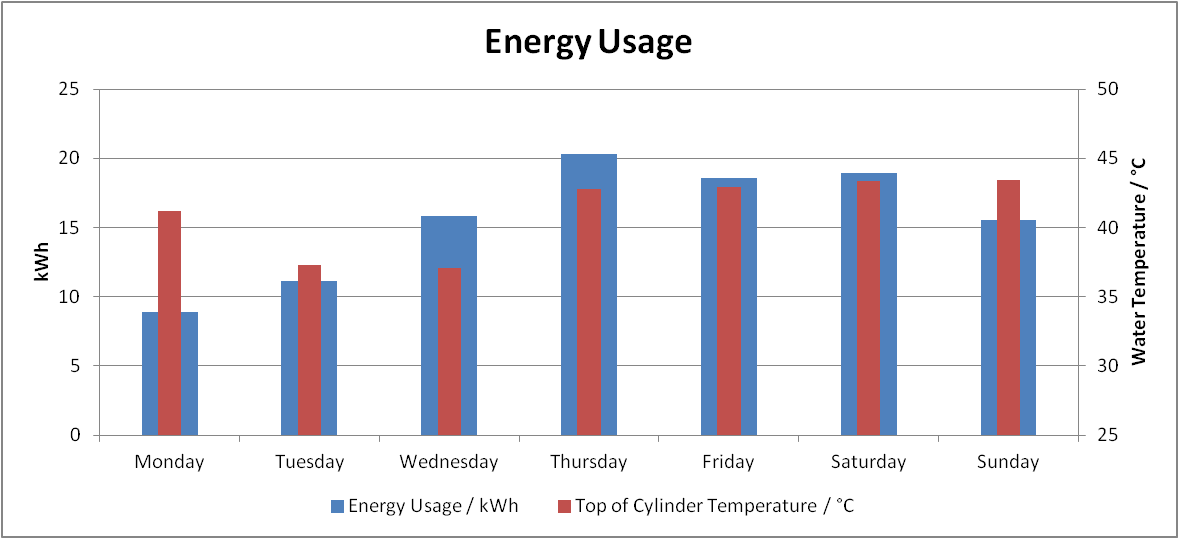

@MikeSharp01
Right, hope this is understandable.
This year, I have always been away on a Sunday and Monday (get back late Monday or more usually a Tuesday), usually travel up on a Saturday, so turn the DHW off, but leave the heating on.
Now as I am on E7, there is a time shift of a few hours, but my E7 is limited to 3 AM to 7AM (to get the most out of LC generation and less standing losses).
So a chart of all energy usage and top of cylinder temperature (water is probably higher temperature as I have only taped a sensor to the output pipe).
On a Monday I have not been at home, so there has been no E7 recharge (heating is on though). Generally the same on a Tuesday, think I have had only 1 Tuesday at home.  This is when I turn the DHW back on, but it does not recharge till Wednesday morning (3AM to 7AM, or when enough is in the tank).
Wednesday though to Friday I am at home as normal.  I usually leave Saturday morning, really early, so DHW is used first thing, but I turn it of so there s no recharging on a Sunday.
Now you would think that the usage and temperatures would be more in sync, but I suspect that when I return, the DHW is at a lower temperature, and my 4 hour window is not enough to heat it up fully.  So maybe I need to look a bit more closely at what is happening when I first turn the DHW back on i.e. how low has the temperature dropped, how much extra energy have I used.

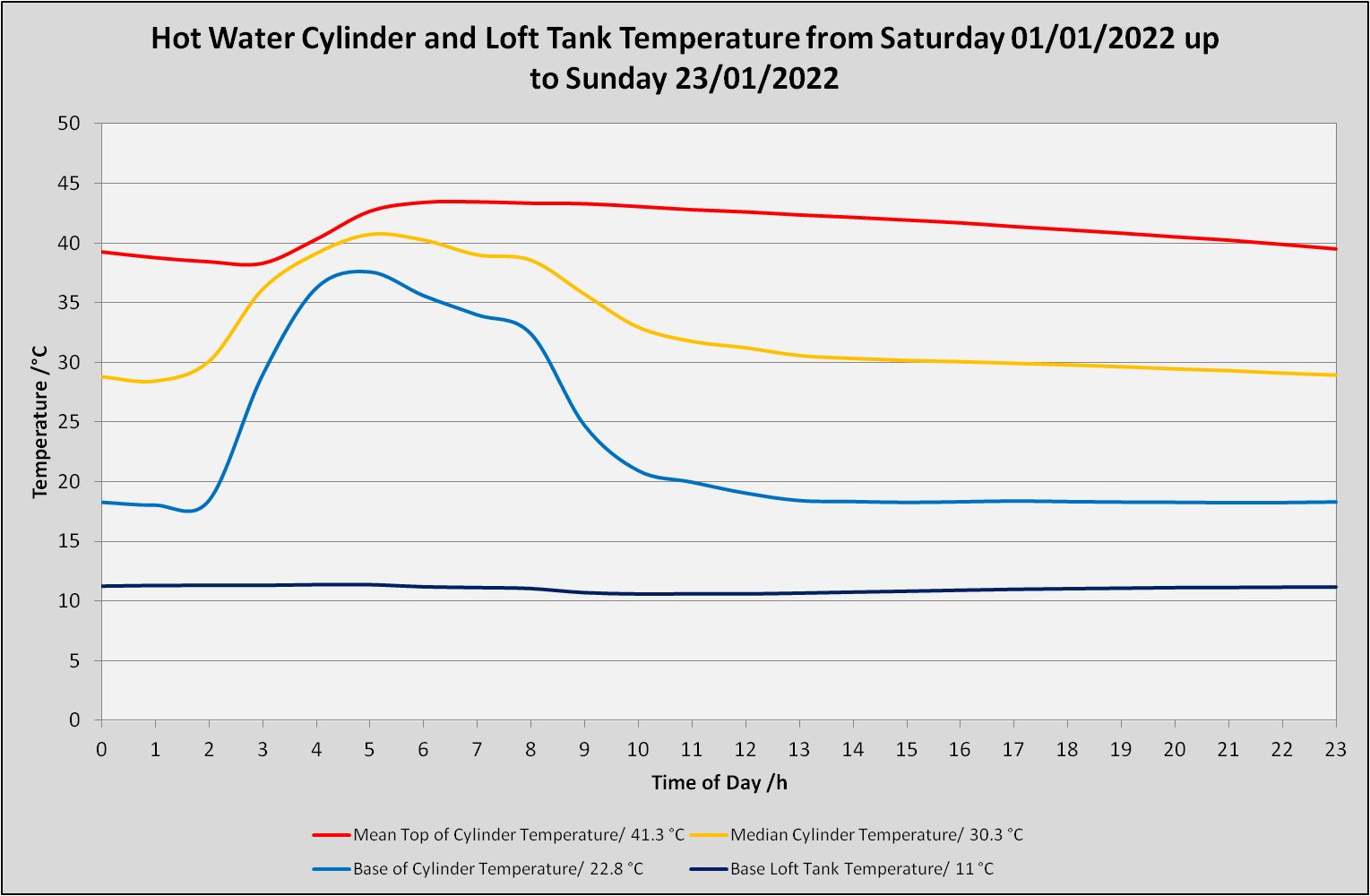

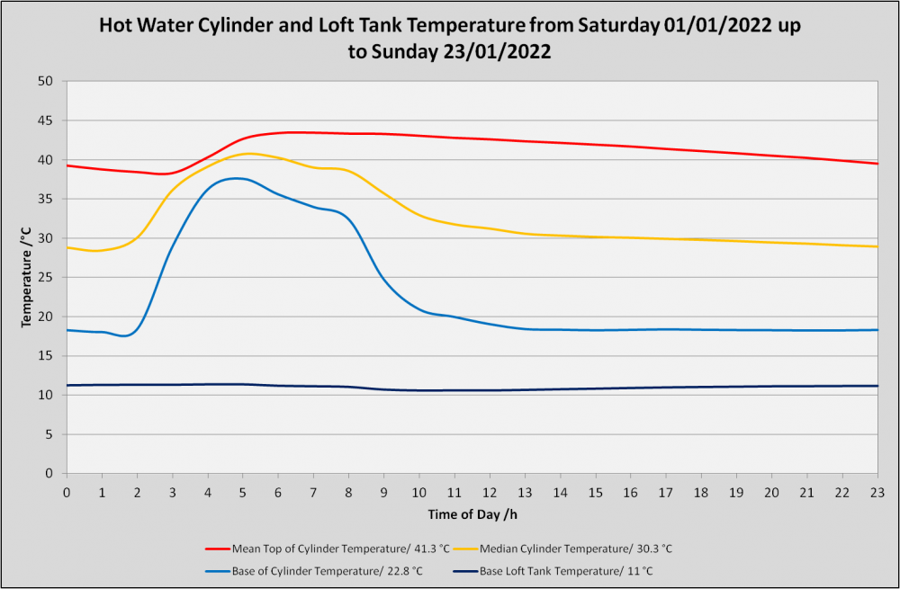

38 minutes ago, TerryE said:
if you bring the tank to temp say up to midnight, turn off electricity and don't draw any HW until the morning
Can't really do that, but it is possible to see the temperature loss over the day, bearing in mind that from 10AM to about 9PM (short after work shower, there is a steady loss.
That loss is around 5°C.
Taking the median temperature (only have two probes on it), the losses are less than 1°C.
May seem odd that, but it s probably down to turbulence caused by the bottom element heating, hot water usage and being replaced with cold water base temperature can actually increase by 3°C or so.
So how much energy is actually lost.
4.18 [J.kg-1.K-1] x 200 [kg] x 1 [K] = 836 kJ [0.23 kWh]
Now I am probably at the lower end of energy usage (my water is not that hot as I only need enough for me, though my system can do 4 people i needed)
So call it 0.3 kWh.day-1 losses.
At 15p.kWh-1 (about what E7 is now), that is £16.50 a year.
I replaced my cylinder after 32 years, cost less than £300.
Oh, forgot the chart of a days cooling off.

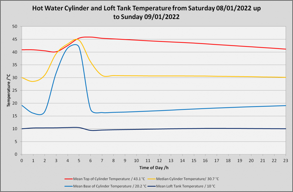

Nick, doesn't this 5°C refer to the top of the tank?  You have a thermal gradient throughout the tank, with the corresponding number at the bottom over 25°C and a tank average some 15°C so surely the losses are ~ 3× what you say.  But still a good number. ?
SteamyTea
(edited)

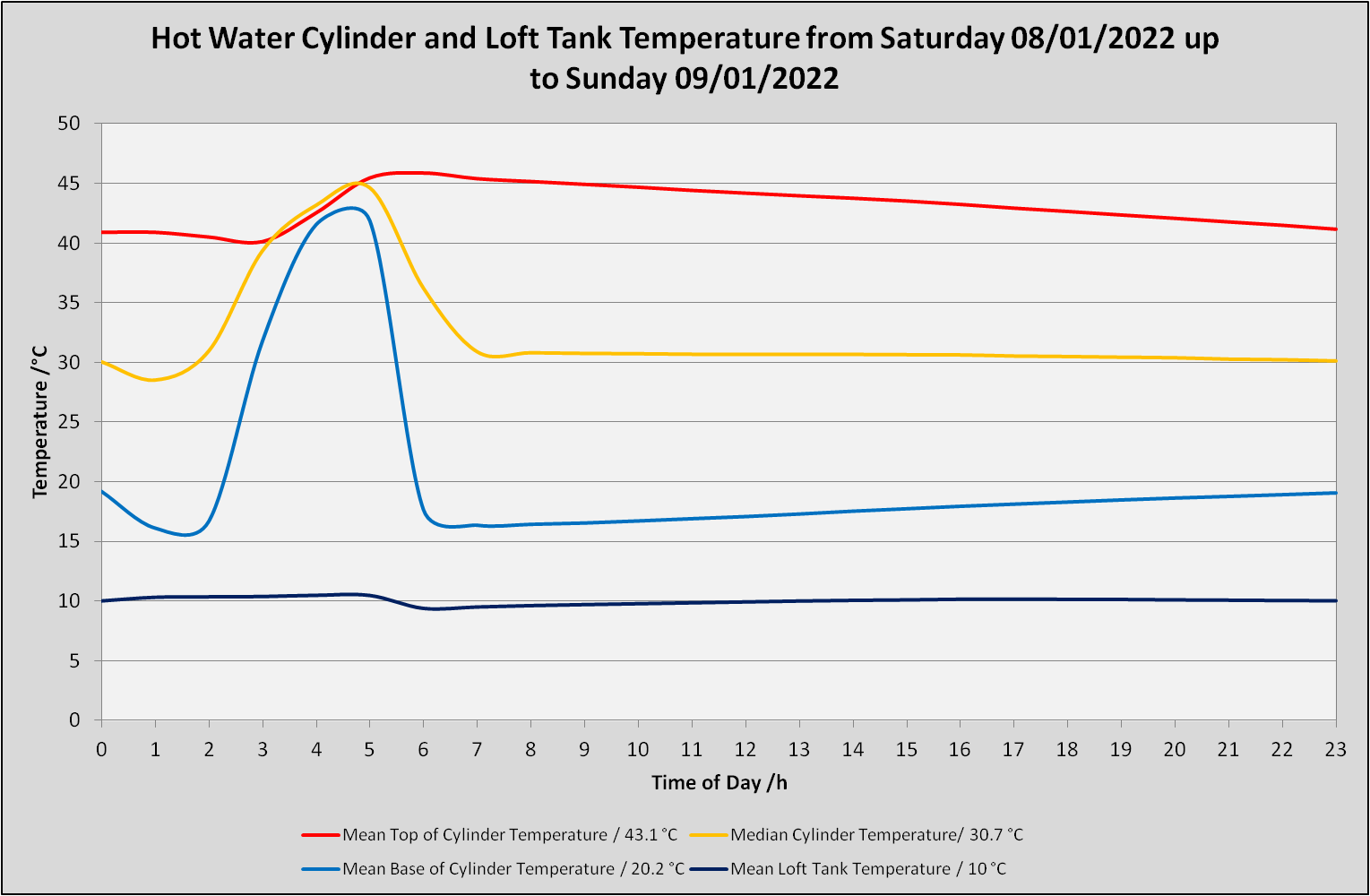

Not sure, I was doing it in a hurry, but I think the overall temperature is okay to use.  There will be more losses at the top than the bottom, but on average it evens out.
It should be the mean temperature I think.  As the probes are on the outlet pipe at the top (as close to the tank as I can get, and under pipe insulation) and the lower probe is on a bare patch at the base, the median temperature is the same as the mean temperature (technically it should be the geometric median, but treating it as a 2D problem, our CET weather temperatures use the median temperature at 9AM and 9PM I think).
Any water I draw off is from the top half of the cylinder, so the hotter part, that will reduce the overall losses thereafter.
But even of the losses where up to a kWh a day, still pretty low in reality.  Shows that insulating the cupboard around the cylinder helps.
What is interesting to me, is that the cylinder has fully stabilised after 1.5 hours after taking, the the majority of the turbulence being in the lower half of the tank, which isn't a surprise as that is where the element is.
