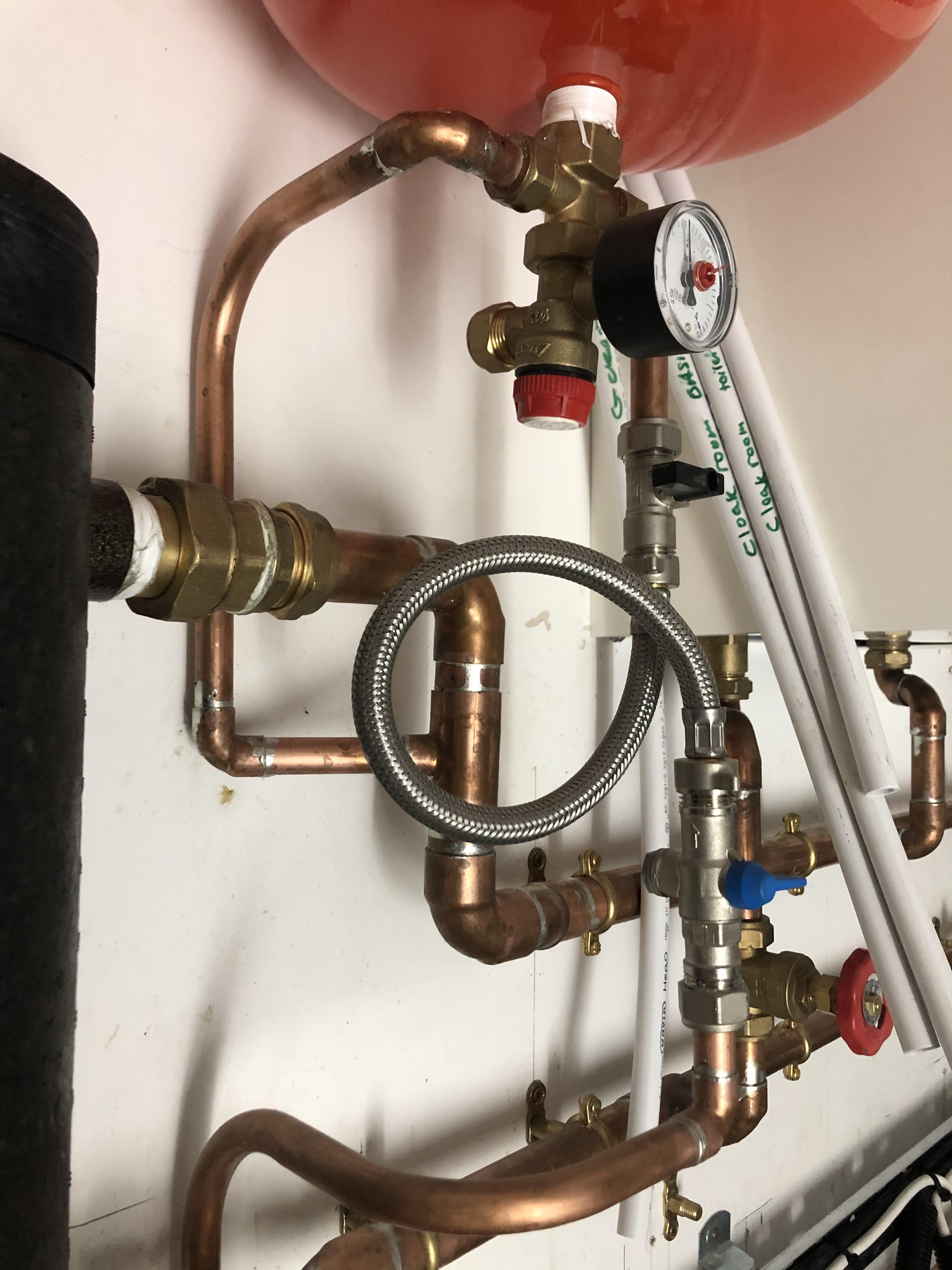

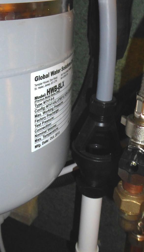

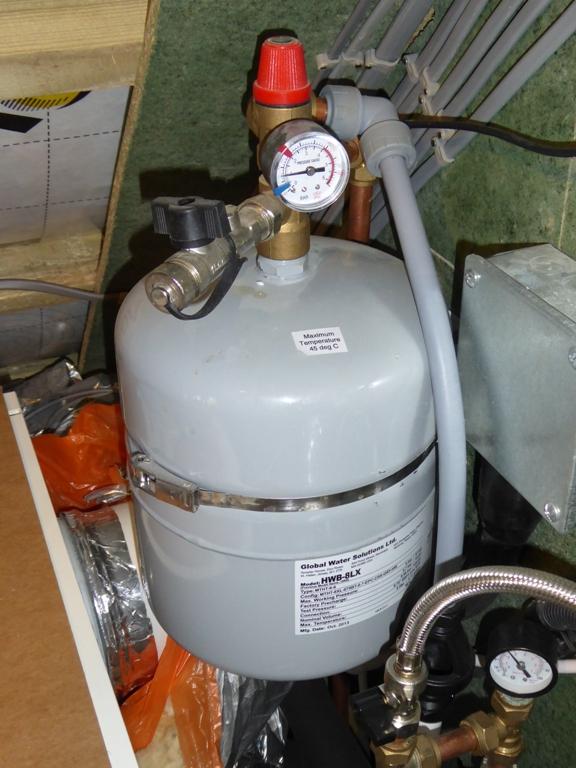

Jeremy Harris
Posted

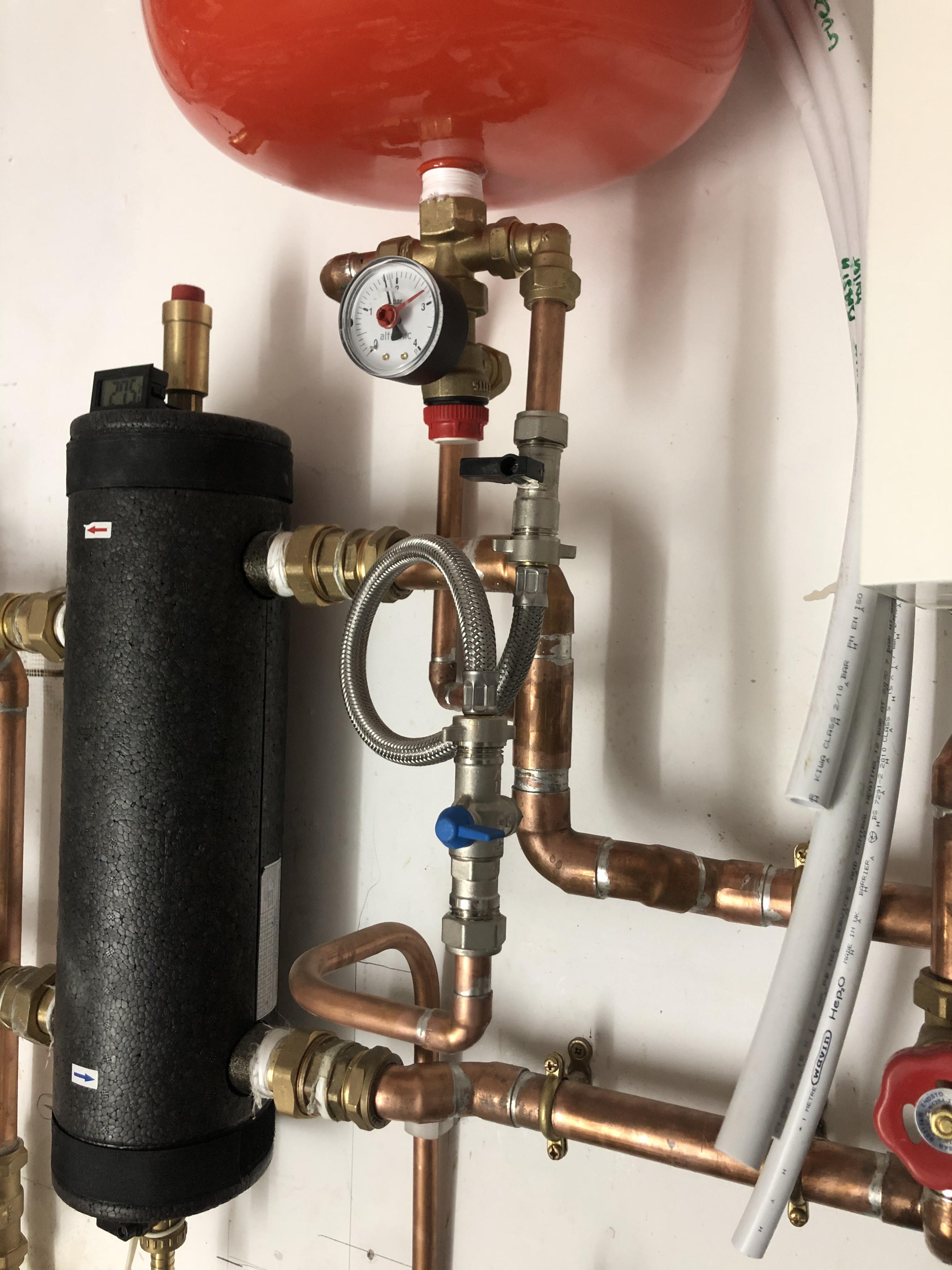

Not sure if this helps or not, but I've just taken a couple of photos of our UFH expansion vessel:
The bit with the cap on at the front is the fill loop connection.  I've added red and blue max and min markers on the pressure gauge, just so I can see at a glance if it's in the right zone.  The fill loop is the flexi that can be seen at the bottom (I use the same flexi to fill the UFH and the buffer tank, they are separate).  The feed down to the UFH is the copper pipe right at the back.  The bit of grey pipe is the overflow from the PRV, OK in this case as the maximum temperature is restricted by the ASHP, so plastic is OK in this case.  If there is a risk that the temperature could get very high then the overflow needs to be in copper.  The black plastic tundish can just be seen at the bottom of the pic.  Here's another view showing the tundish fitted to the waste pipe:
The drain from the tundish feeds down to a large diameter drain that runs through a trap downstairs.  This trap is kept topped up by the water that is drained from the water softener, so cannot dry out.  The same drain is also used for the PRV outlet on the buffer tank (that one is set to 1.5 bar, because of the tank limit) and again plastic is OK as the buffer cannot ever exceed the ASHP maximum temperature (the ASHP cannot ever get hotter than about 60°C even under fault conditions).  For Willis heaters I think you would have to assume that, under fault conditions, the water could exceed 100°C (because of the pressure) and so make sure that the overflow, tundish and drain followed the requirements in the regs for the safe discharge of boiling water and steam.  Details are in Part G3:
  • Like 2

Thanks @Jeremy Harris ! Will have to take worst case scenario with the willis setup i.e. copper all the way. What I don't get is how some of these 2-in-1 (dry trap and a tundish combined) tundish products state that you can plumb them in "allowing water to be safely discharged to a soil or waste pipe" i.e. no need for external drain. If the water is near enough to 100C, then that tundish isn't going to reduce that temperature down by much or at least down to a level where the plastic waste pipe isn't going to get impacted.

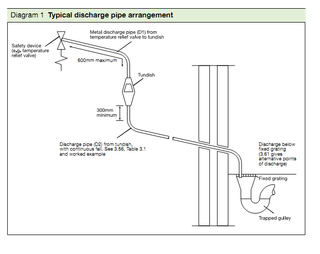

It comes down to the maximum volume of water in the unit/system, I think.  I'll see if I can dig out the relevant bit of the regs later, it'll be buried away in Part G somewhere.
Edited to add:
Found it.  The regs are relaxed for systems with a total water volume of less than 15 litres, which is how the boiling water taps etc can get away with not having to run vent pipes as shown above (I think the boiler on ours holds about 5 litres, or thereabouts).  A UFH system with a couple of Willis heaters is probably going to be over 15 litres.  As a rough guide, 100m of 16mm UFH pipe holds about 11.3 litres of water.  Not sure what the volume of a Willis heater is, but the chances are that you've got more than 133m of UFH pipe, anyway, so will be over 15 litres system volume.

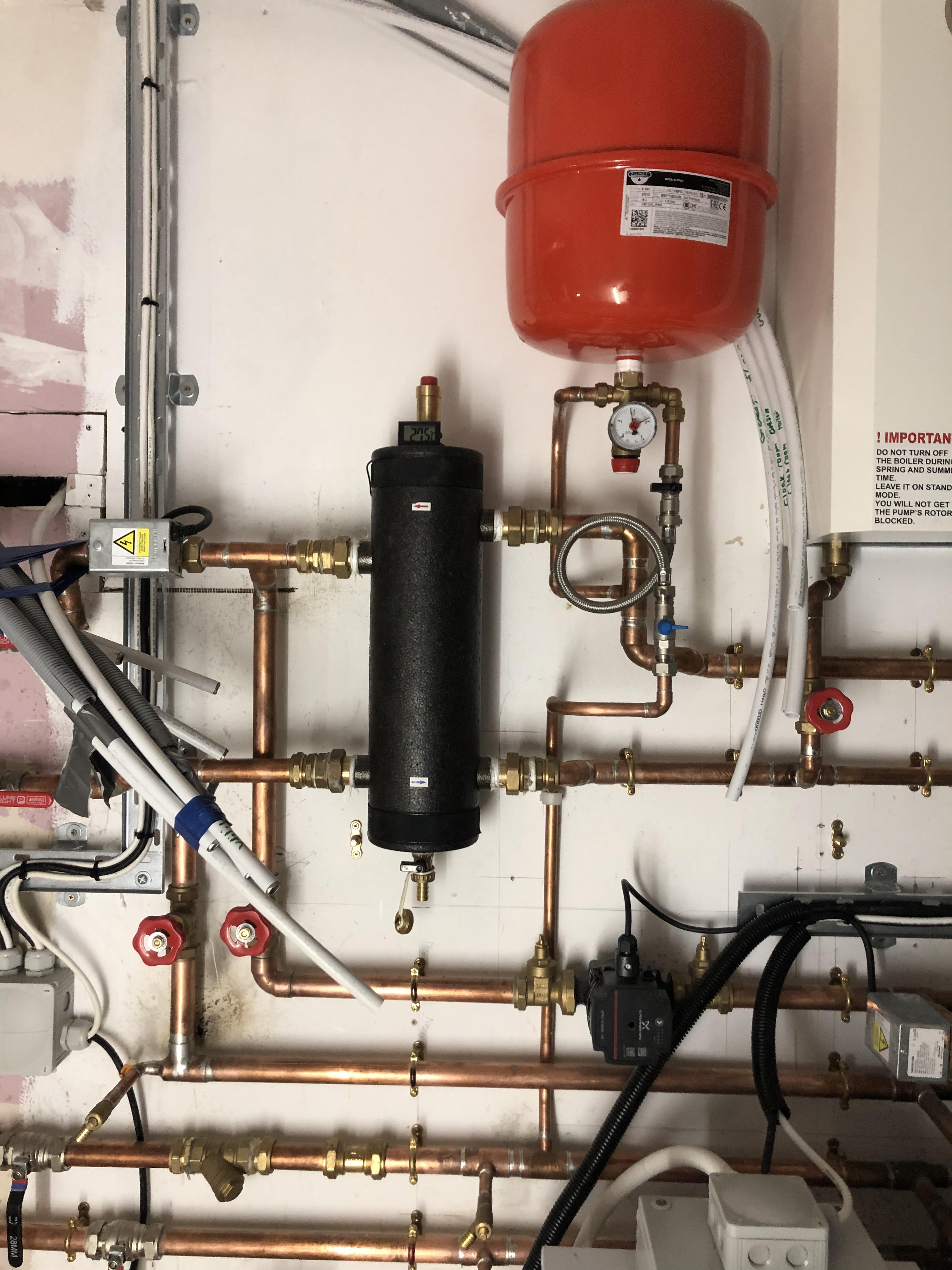

Nickfromwales
Posted
Yes, it’s time / volume / temp that dictates the permissible discharge regs.
Also, iirc, all modern plastics can tolerate high temp for quite long durations. That’s how communal UVC’s ( dozens of them ) can be connected to a foul water riser without issue.
1DC3ABE2-5EA1-4CE2-9553-EF1434D646AC.thumb.jpeg.95797009c0174ec96c2cc31dfcf2ede5.jpegD895A75C-5528-4E6E-A36B-F382B8657ABC.thumb.jpeg.41fde855e11a14187fd39f782d56b343.jpegD65E19C3-B55B-4445-A016-3A21551AB65D.thumb.jpeg.484a77f88af1cbac4ba57974abcca3b8.jpeg
Some more pics of a sealed / expansion setup. PRV yet to be connected. That’s the port at the rear of the angled brass union with the small red cap
  • Like 1

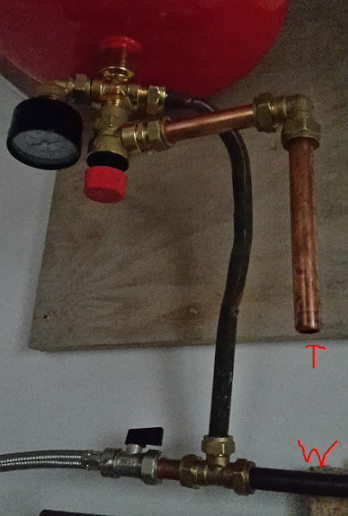

Okay, so have tee'd off and this is what I have:
T = Tundish position (15mm in /22mm out)
W = pipe from willis set up.
Fill loop will be disconnected and valve shut off so that willis feeds into expansion vessel. I'll also have a check valve on the incoming water mains that the fill loop is connected to so there's no contamination.
FYI - Pipe from tee going up is only to illustrate set up - that will be replaced after I find the pipe bender!

You don’t really need the tundish as it’s not potable.
Change it to a waterless trap if you’re getting draughts coming up ;)
  • Like 1
Jeremy Harris
Posted
I thought that the tundish was a requirement in order to provide a visible indication of the PRV letting by?
Nickfromwales
Posted
On an UVC always, but, you can get away without one on primary circuits as it’s just the volume of expansion to get rid of. BCO’s never chase on that but are all over D1 & D2 on potable as it’s drinking quality water being ‘lost’.
There are several waterless traps ( sealed ) which are transparent, so you can use one of those if a visible discharge is required internally.
Where it runs to an outside wall you can rely on that as means of visible discharge.
  • Like 2

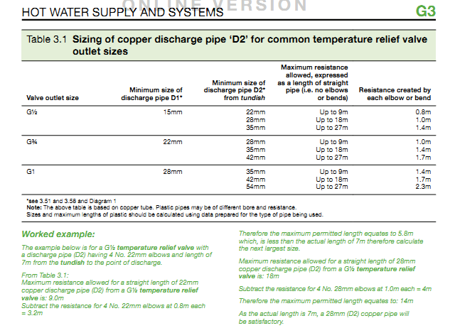

ProDave
Posted
On the new build I am on I noted today, that the D2 pipe has 9 bends or elbows in it. 22mm pipe.  That would reduce it's allowable length to just 1.8 metres.  but it must be at least 6 metres long.
What's the betting BC never notice.  The plumber is not always right.
Nickfromwales
Posted
I always go to 28mm if there’s anywhere near that many bends. In honesty I can only recall a couple, where they were 22mm for a couple of metres and straight out, where I didn’t upsize.
