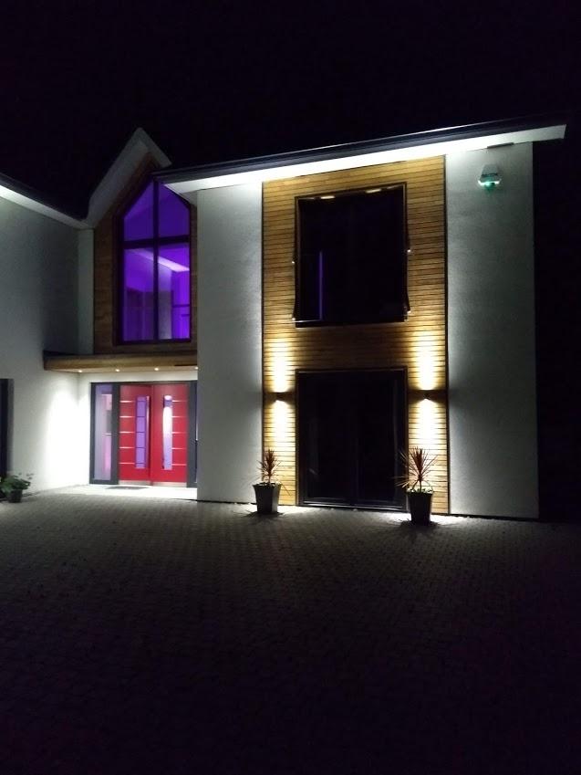

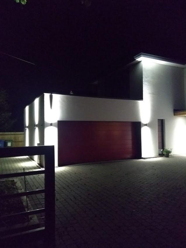

No problem - I would have thought you had some external lights and fittings, such as satellite dishes, aerials, CCTV cameras and Security Alarm?  but maybe not?
My house has all of these and they required wall penetrations = see pictures
  • Like 1

Thanks again, Herb. Your lights are lovely!
We have to keep external lighting to a minimum but we need some. I had better get my skates on with thinking that one through.
