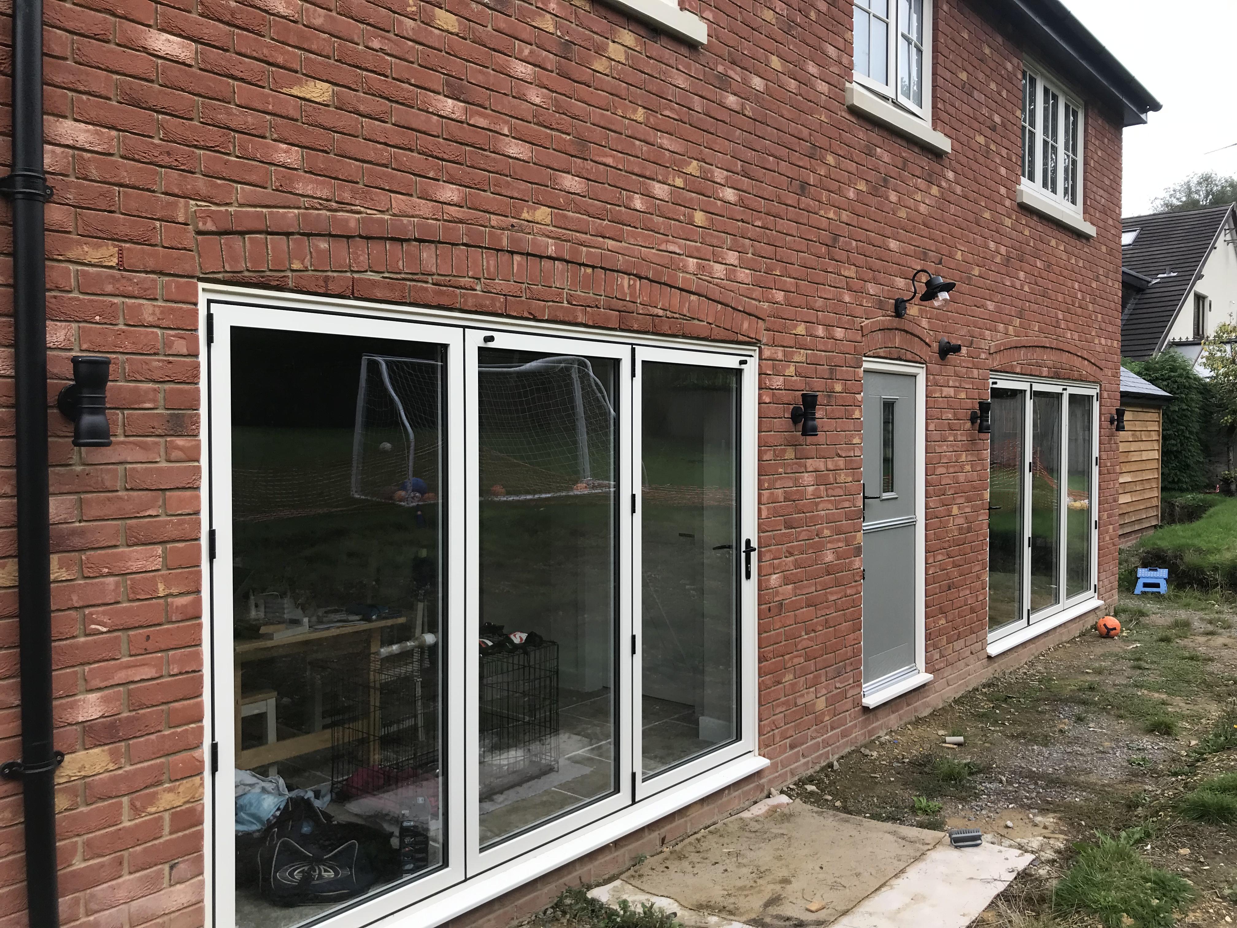

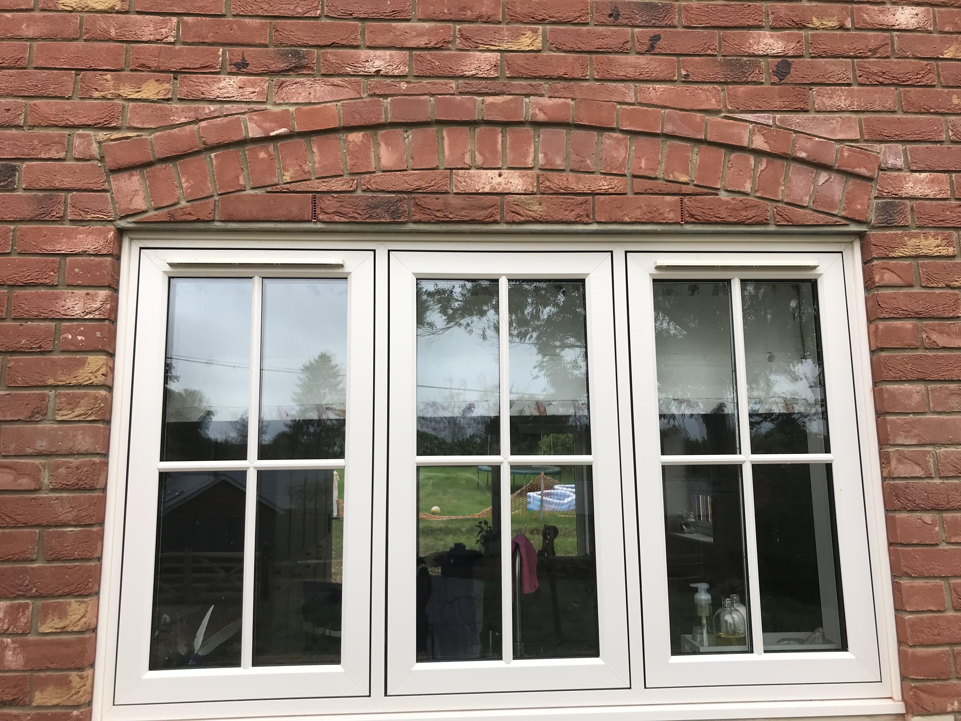

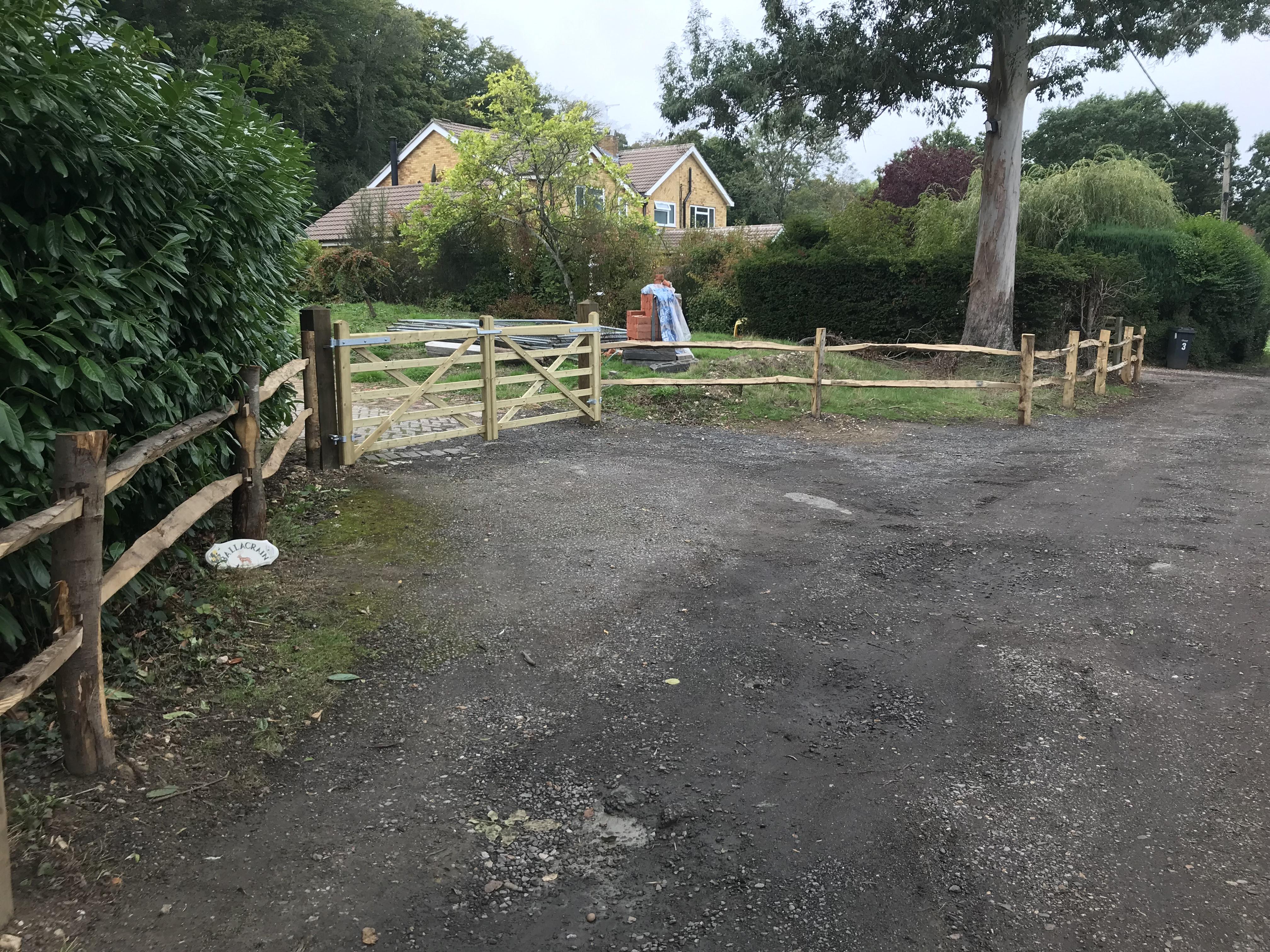

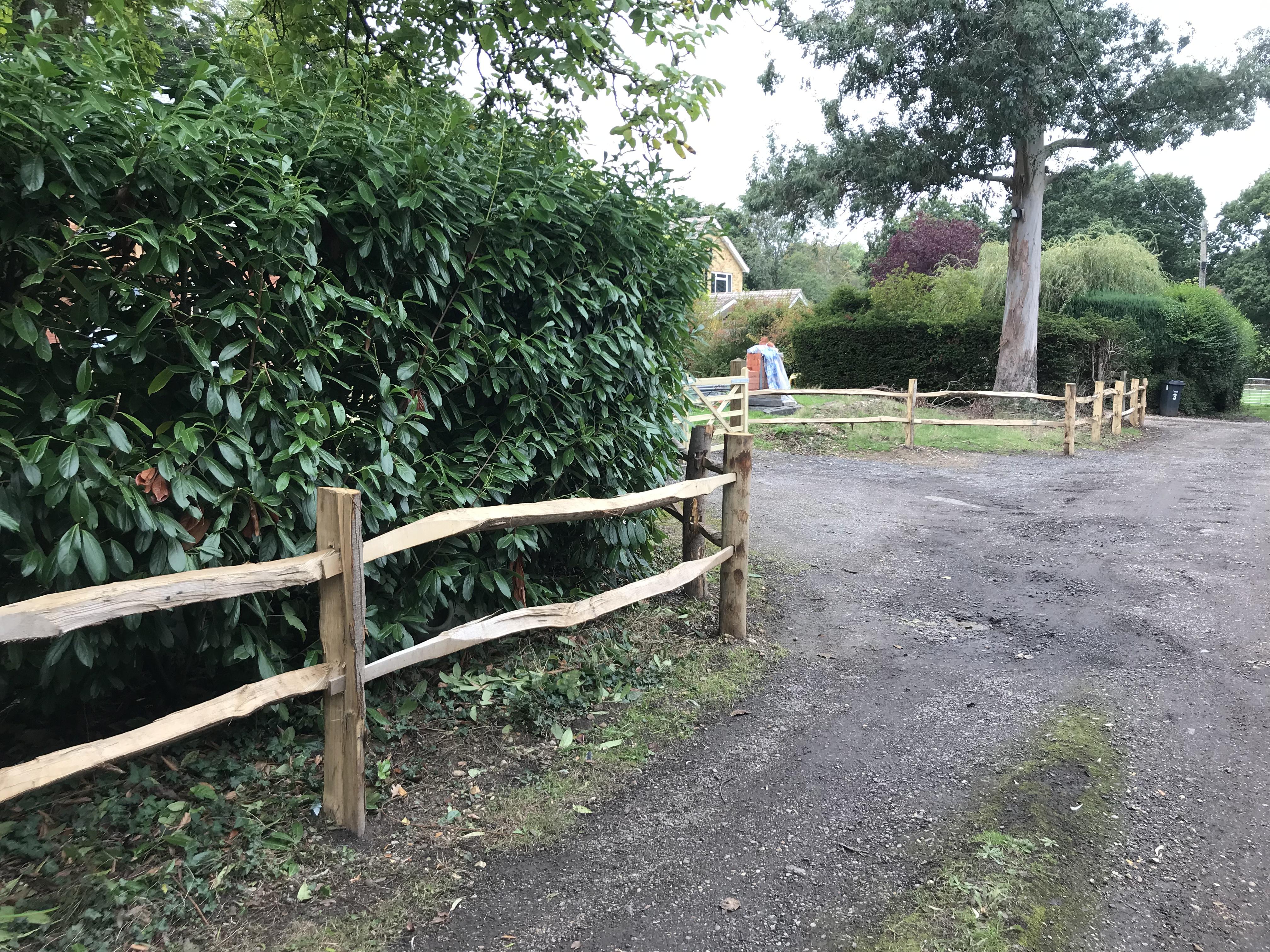

Dan1983 Posted October 4, 2022 Author Share Posted October 4, 2022 Arch infill finally completed, really struggled to get these sorted Last quote was £3700 plus VAT which I thought was crazy. in the end a local company that specialises in traditional brickwork did it and for a fraction on the cost! Chestnut fencing complete along with a pair of 6ft gates. 1 Link to comment Share on other sites More sharing options...

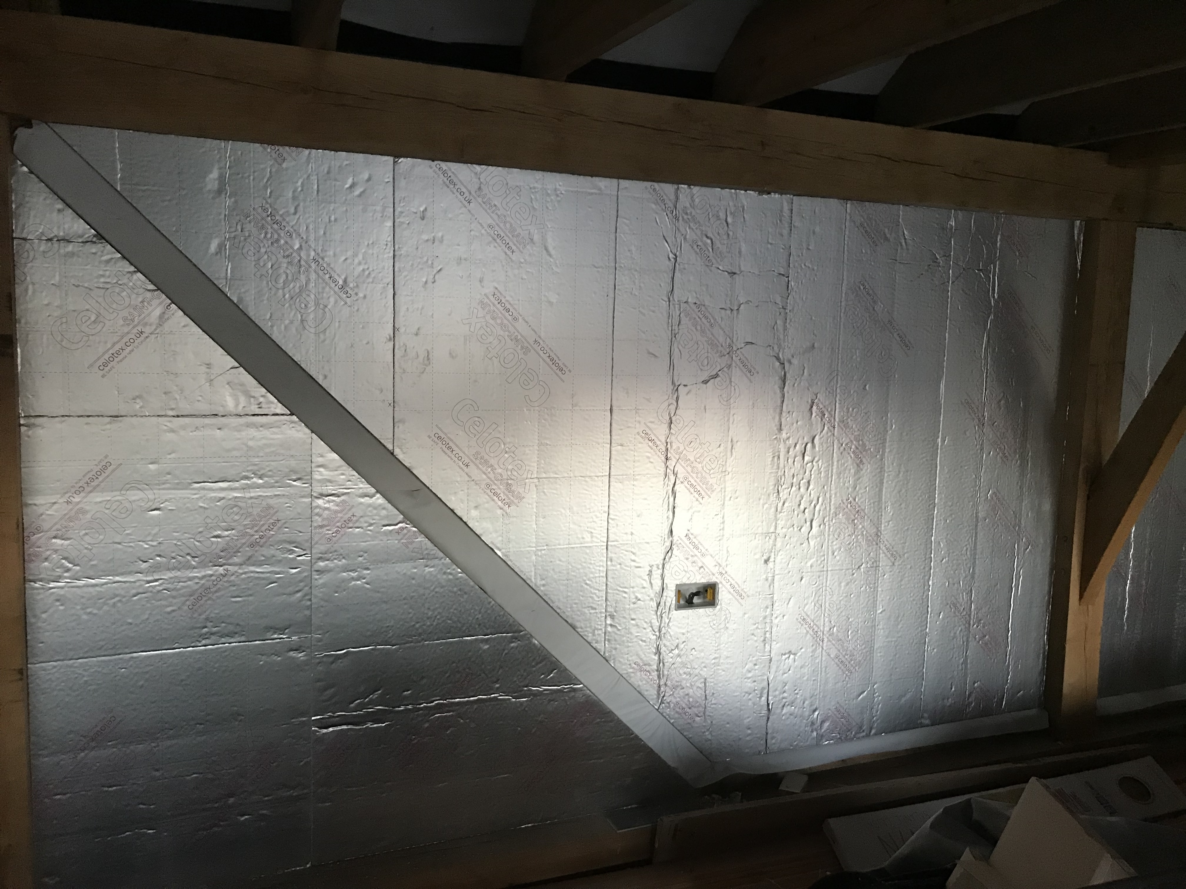

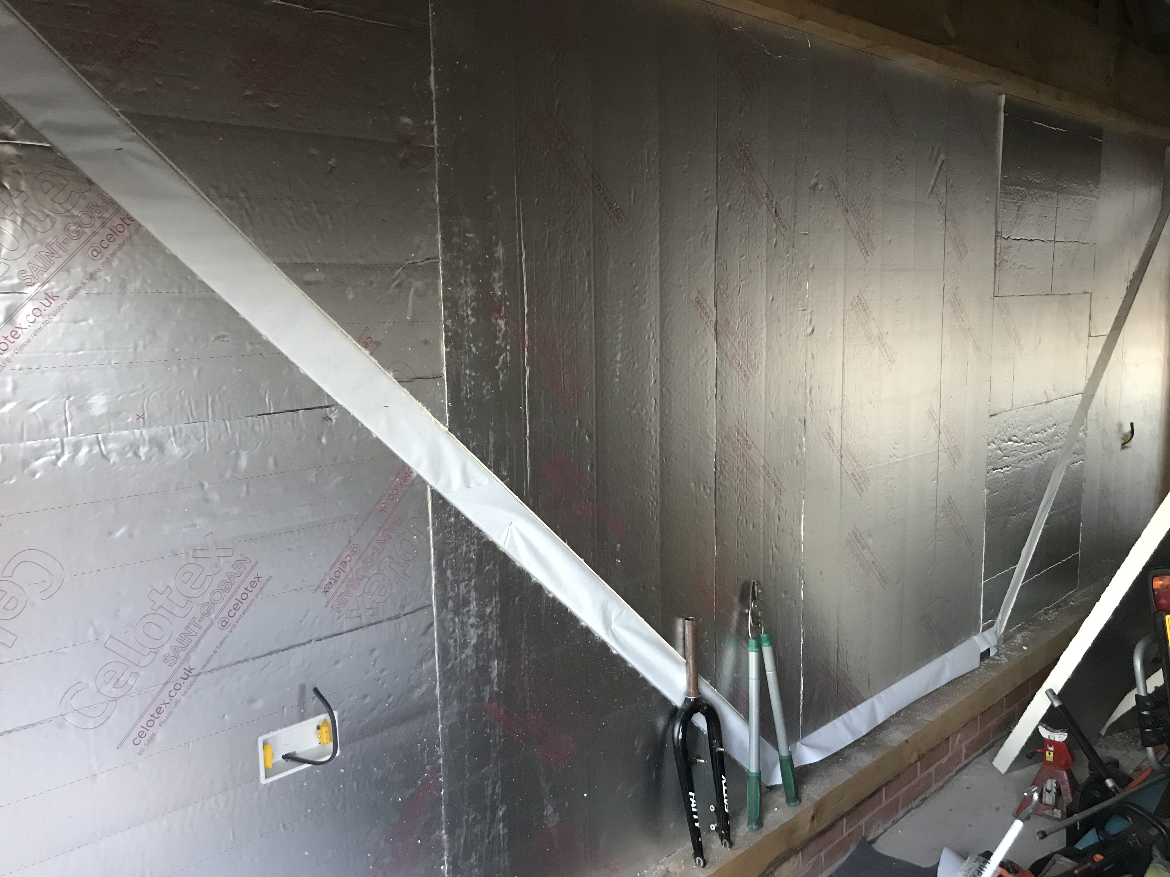

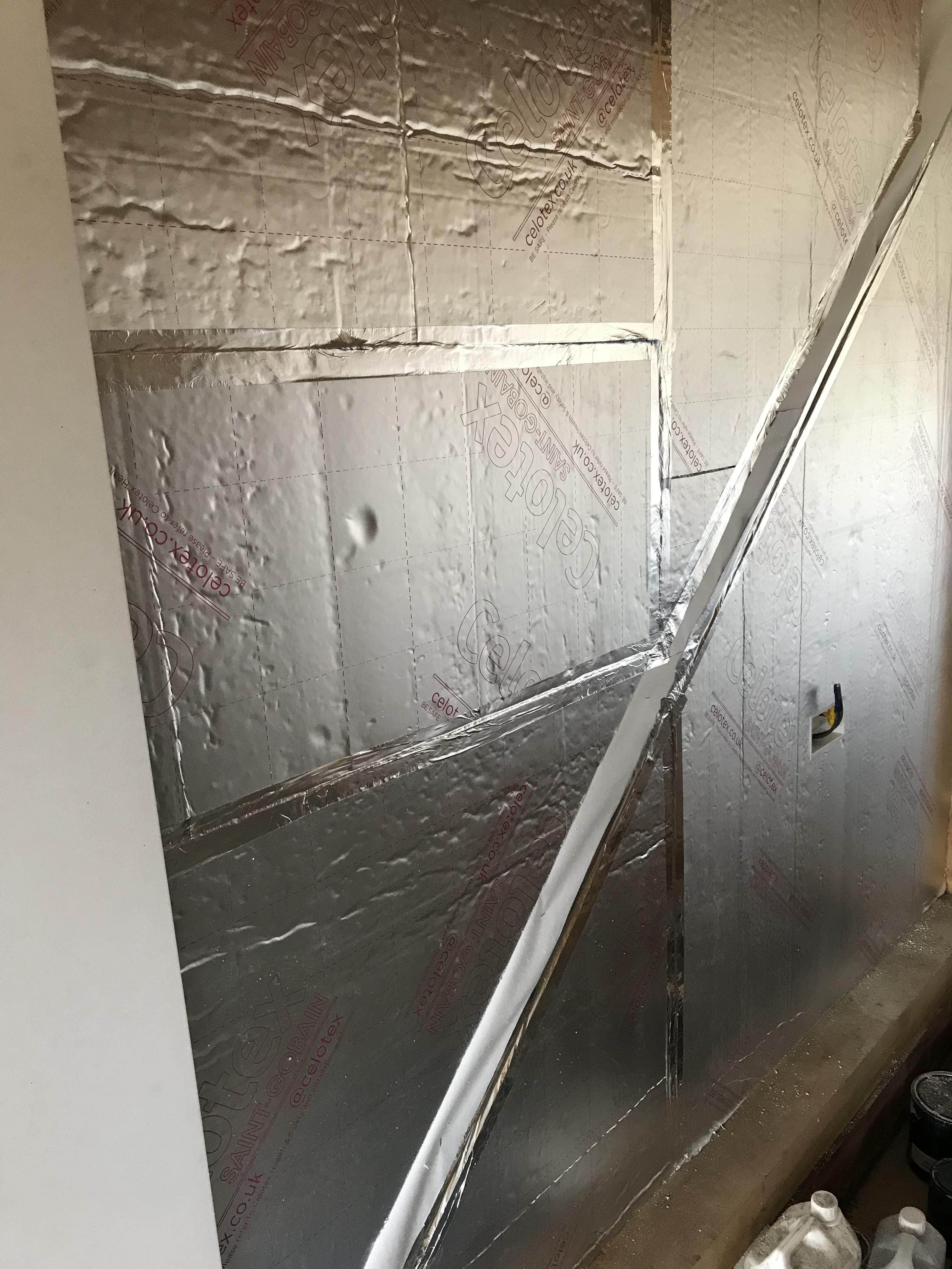

Dan1983 Posted December 6, 2022 Author Share Posted December 6, 2022 Just in the process of making a start on the garage. 50mm celotex and then plasterboard going over the top 1 Link to comment Share on other sites More sharing options...
eandg Posted December 8, 2022 Share Posted December 8, 2022 Looks great - particularly love the chestnut fencing. 1 1 Link to comment Share on other sites More sharing options...

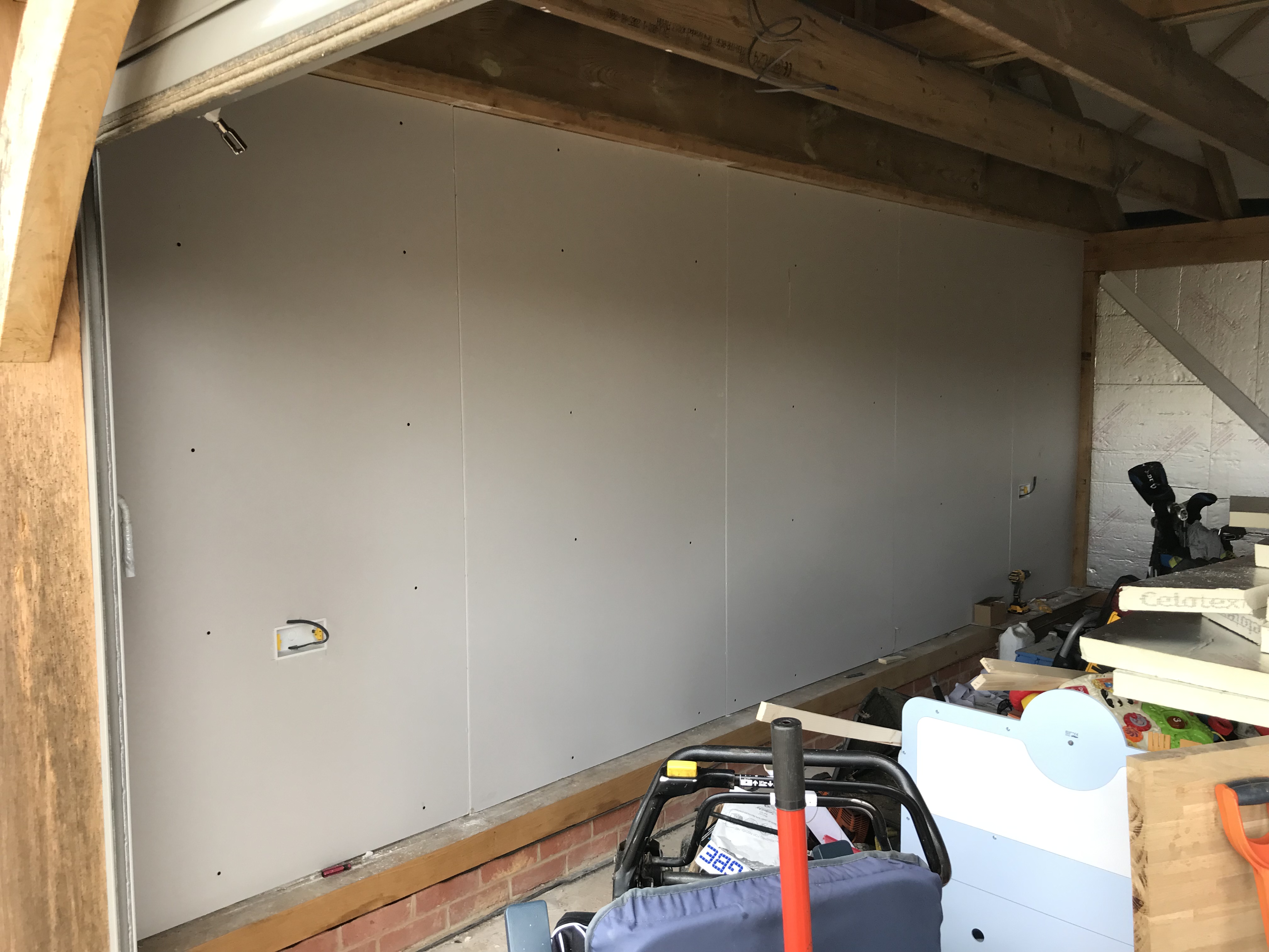

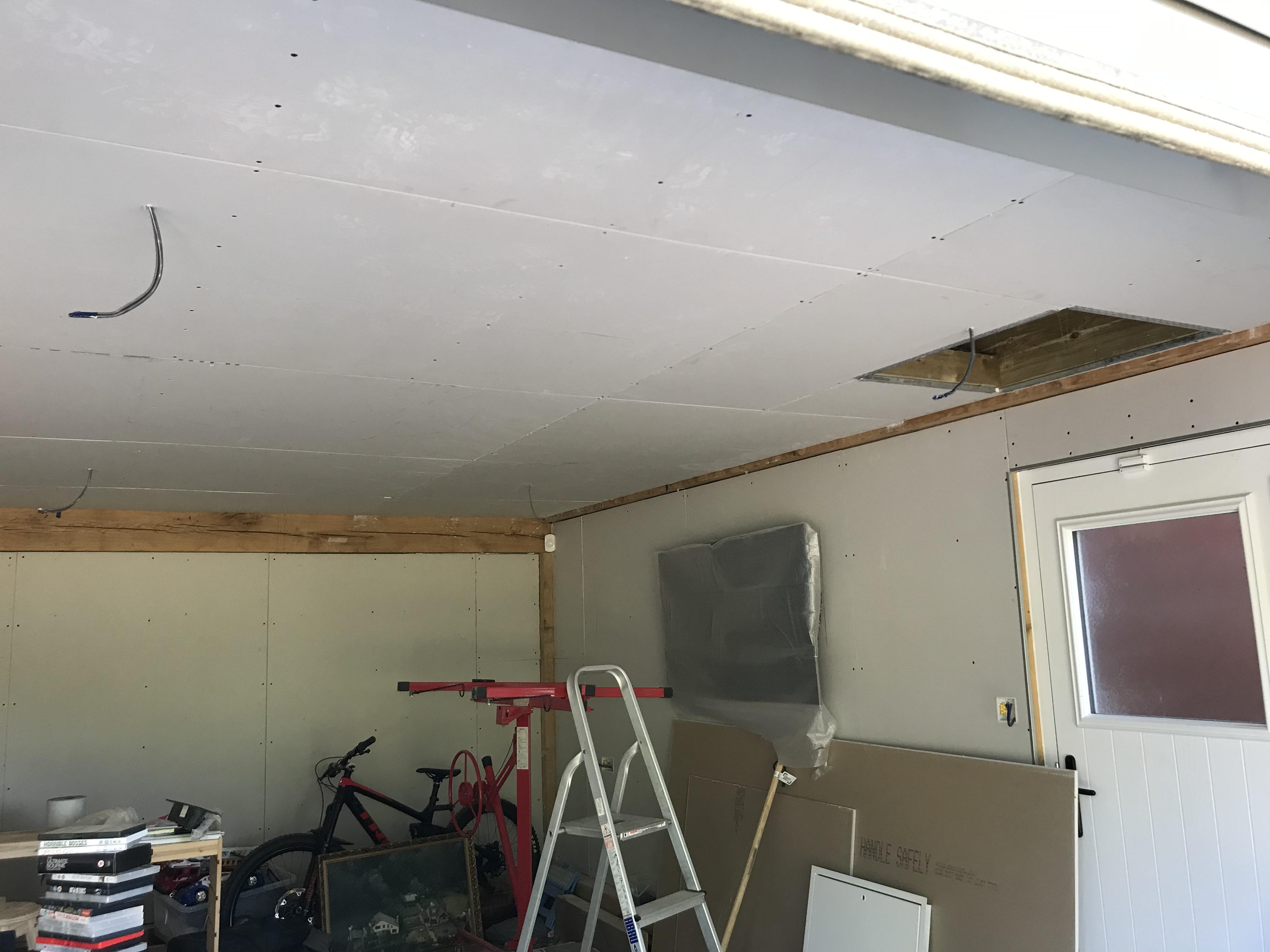

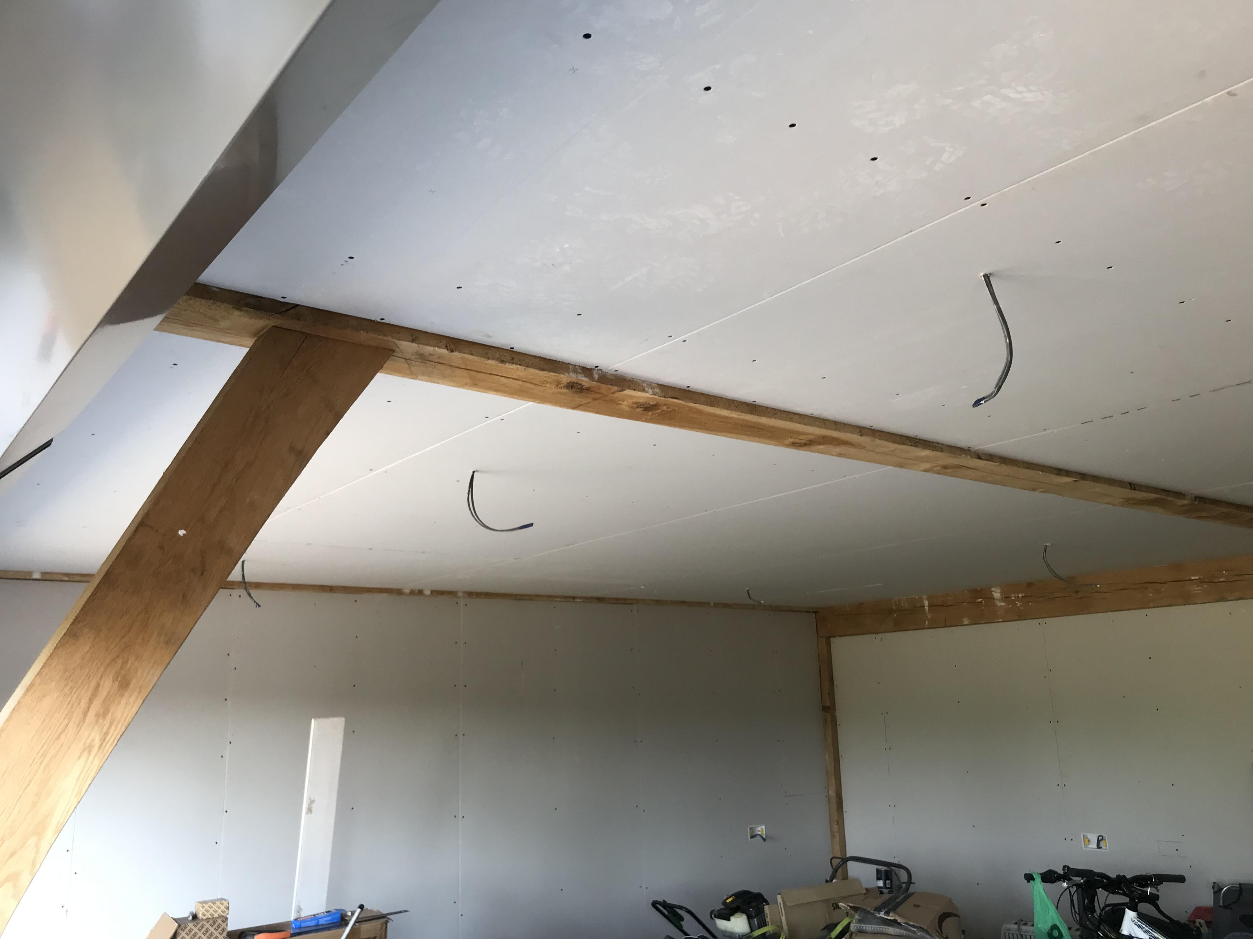

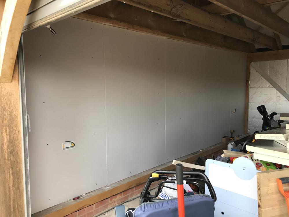

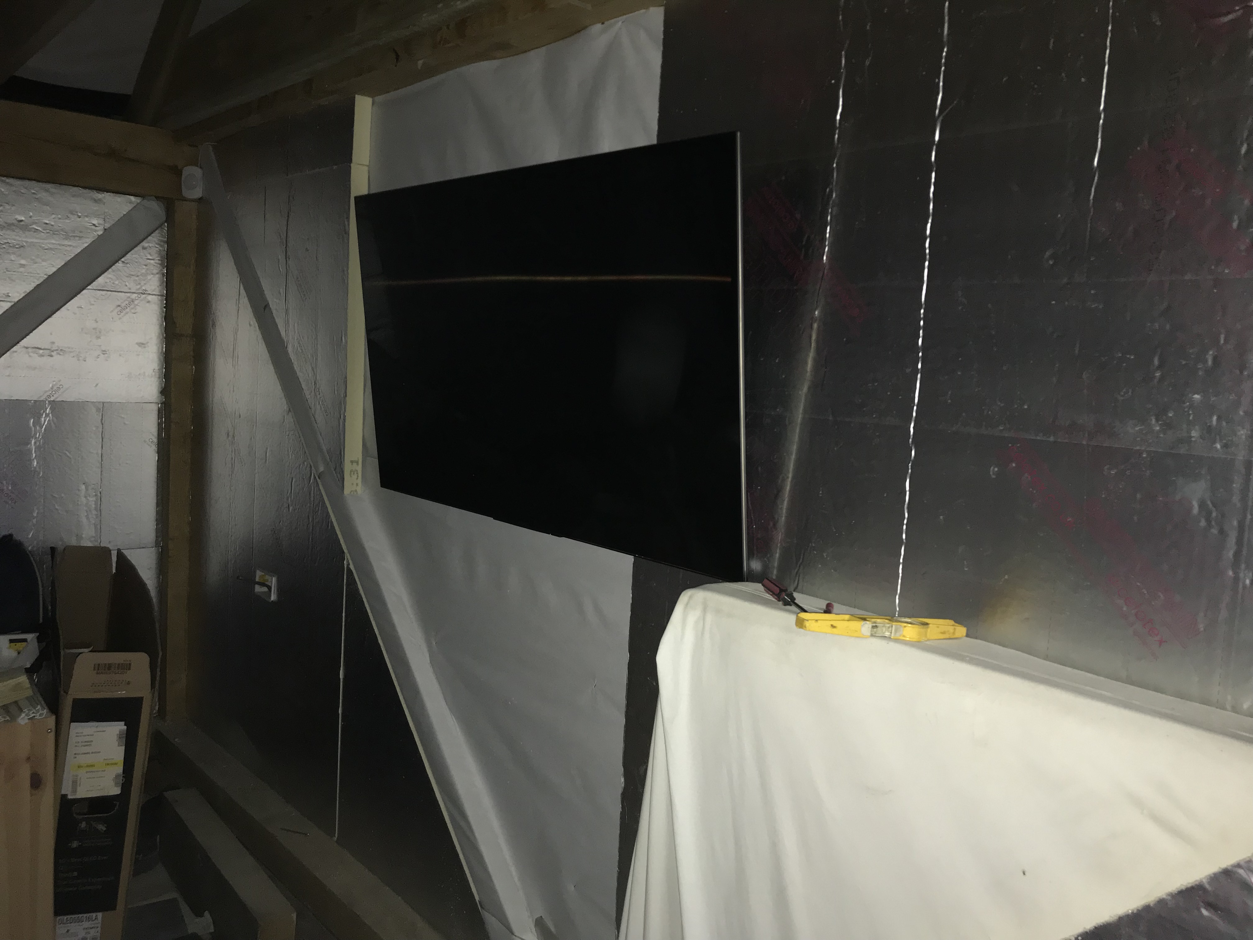

Dan1983 Posted February 21, 2023 Author Share Posted February 21, 2023 Back in the garage the last two days. Mocked up the tv so that’s sorted. Now starting to board out in prep for plastering. Not sure how much cracking will occur as the oak frame dries out, it’s been in approx 16 months now Link to comment Share on other sites More sharing options...

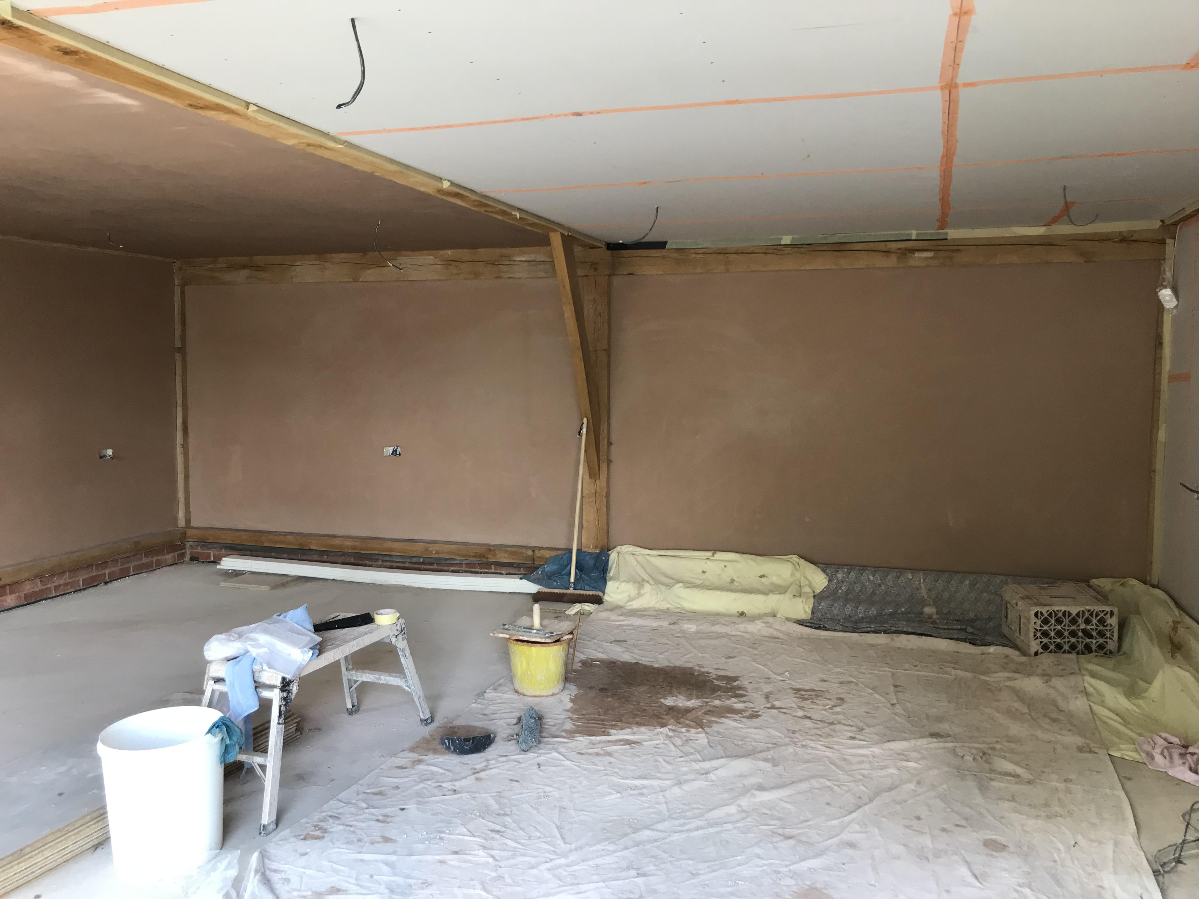

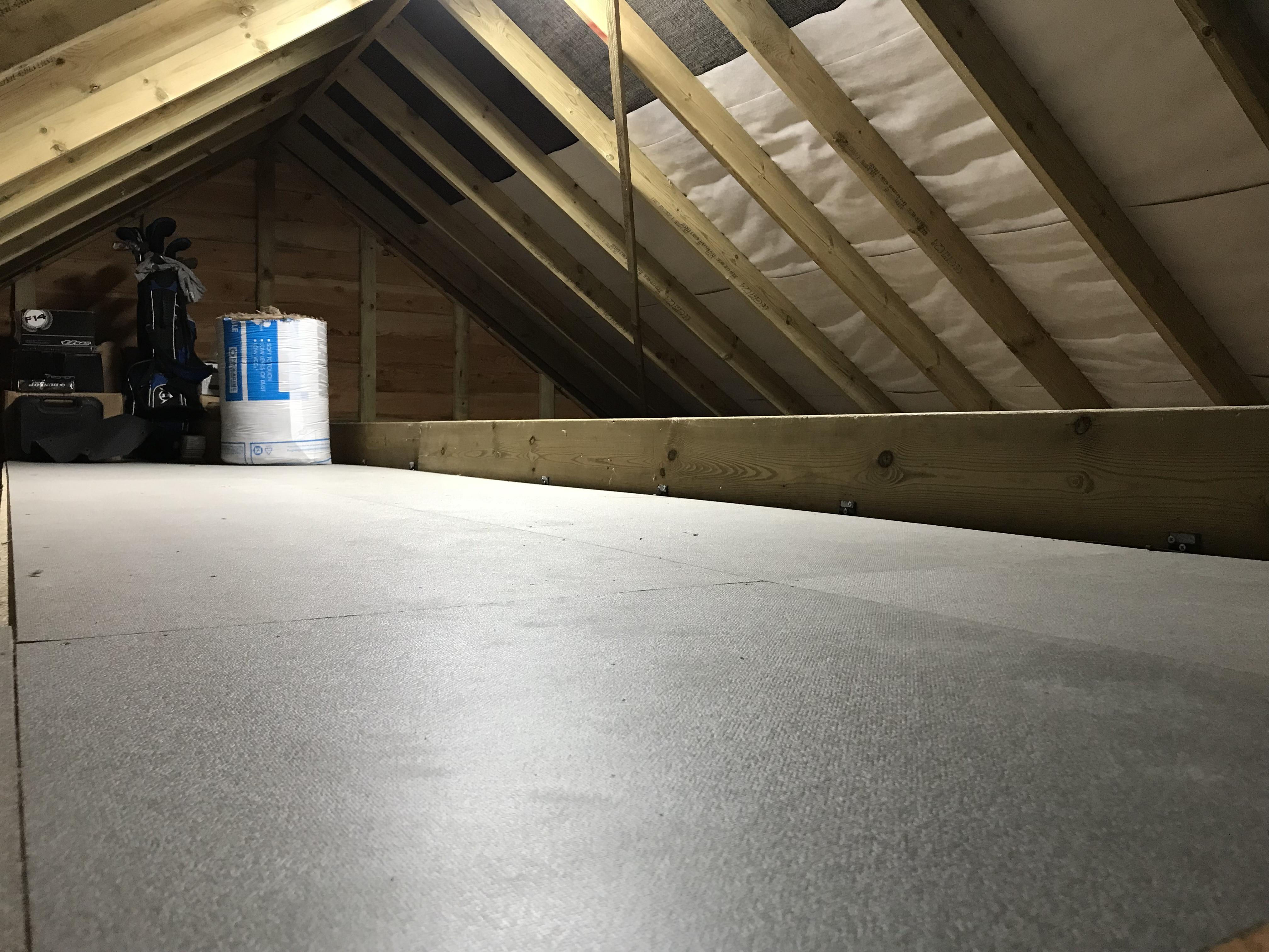

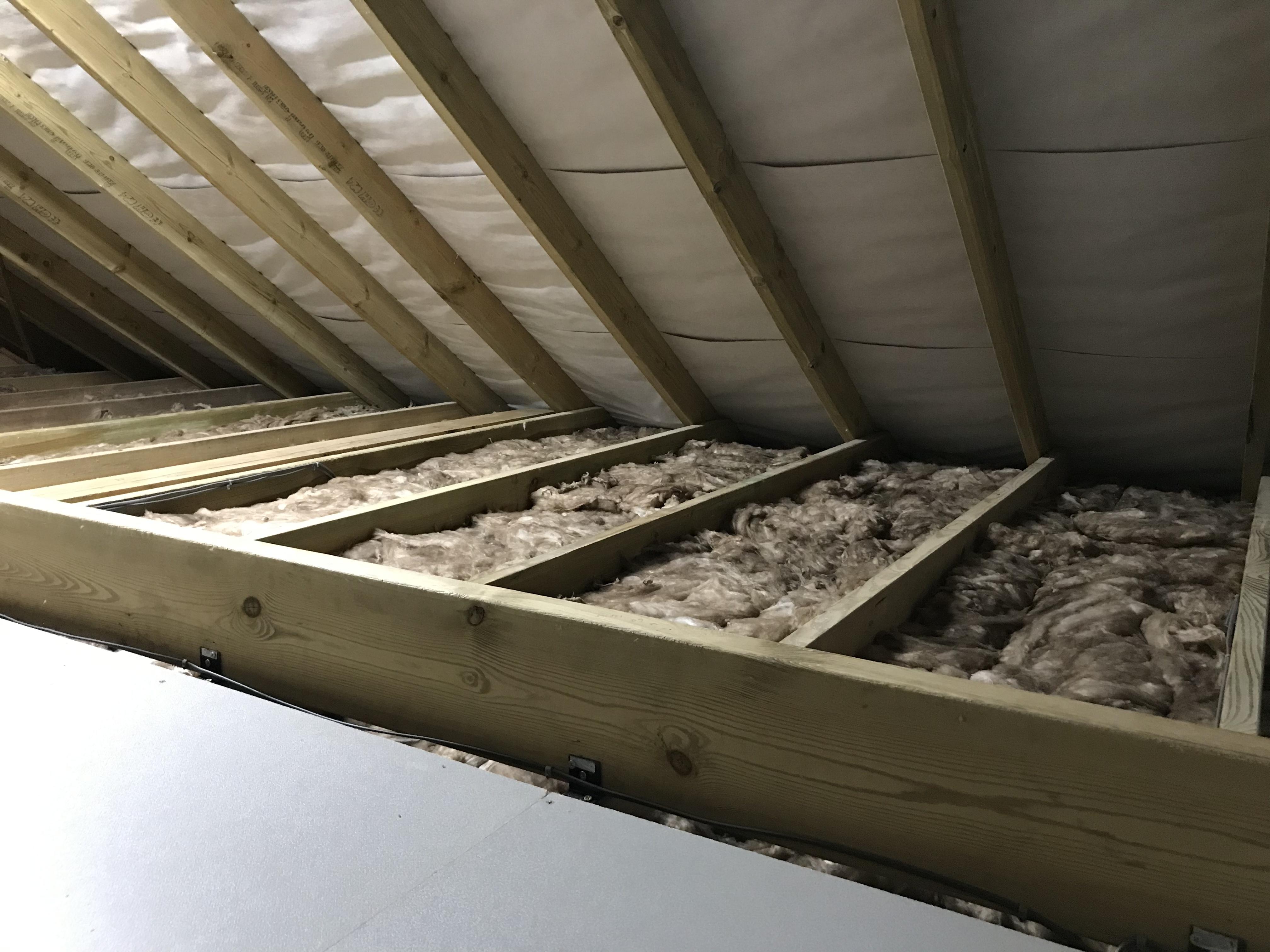

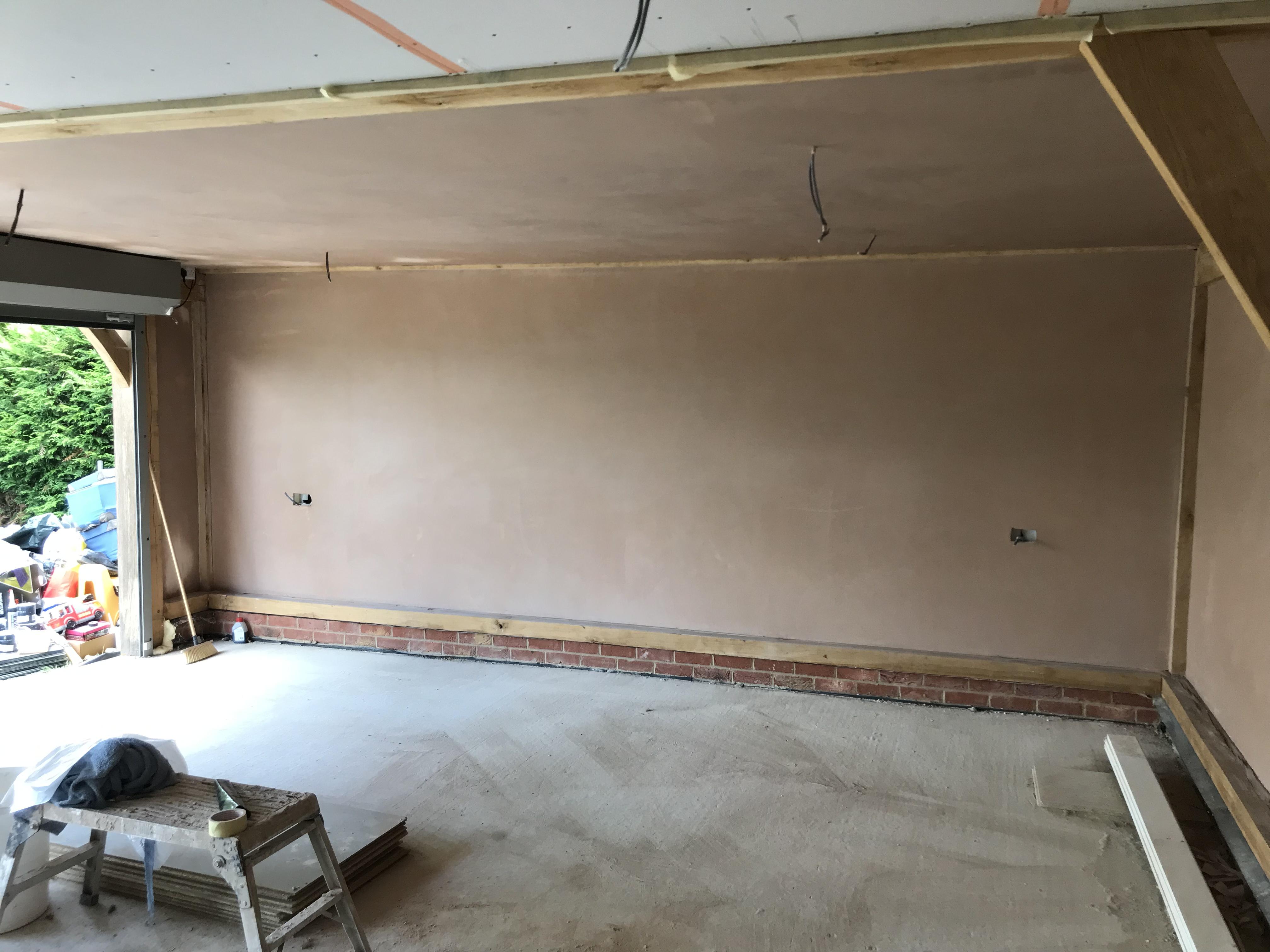

Dan1983 Posted June 13, 2023 Author Share Posted June 13, 2023 Plastering finally finished, don’t fancy doing that again in a hurry! That meant I could lay the 200mm insulation on the roof. decided to use Egger 22mm flooring so we have some storage. Only did 2 rows in the end as was concerned about the extra weight (although roof beams are 250mm) Link to comment Share on other sites More sharing options...
Dan1983 Posted June 13, 2023 Author Share Posted June 13, 2023 Also added an led light up there which seems to work well! Time to get some plastering quotes! Link to comment Share on other sites More sharing options...

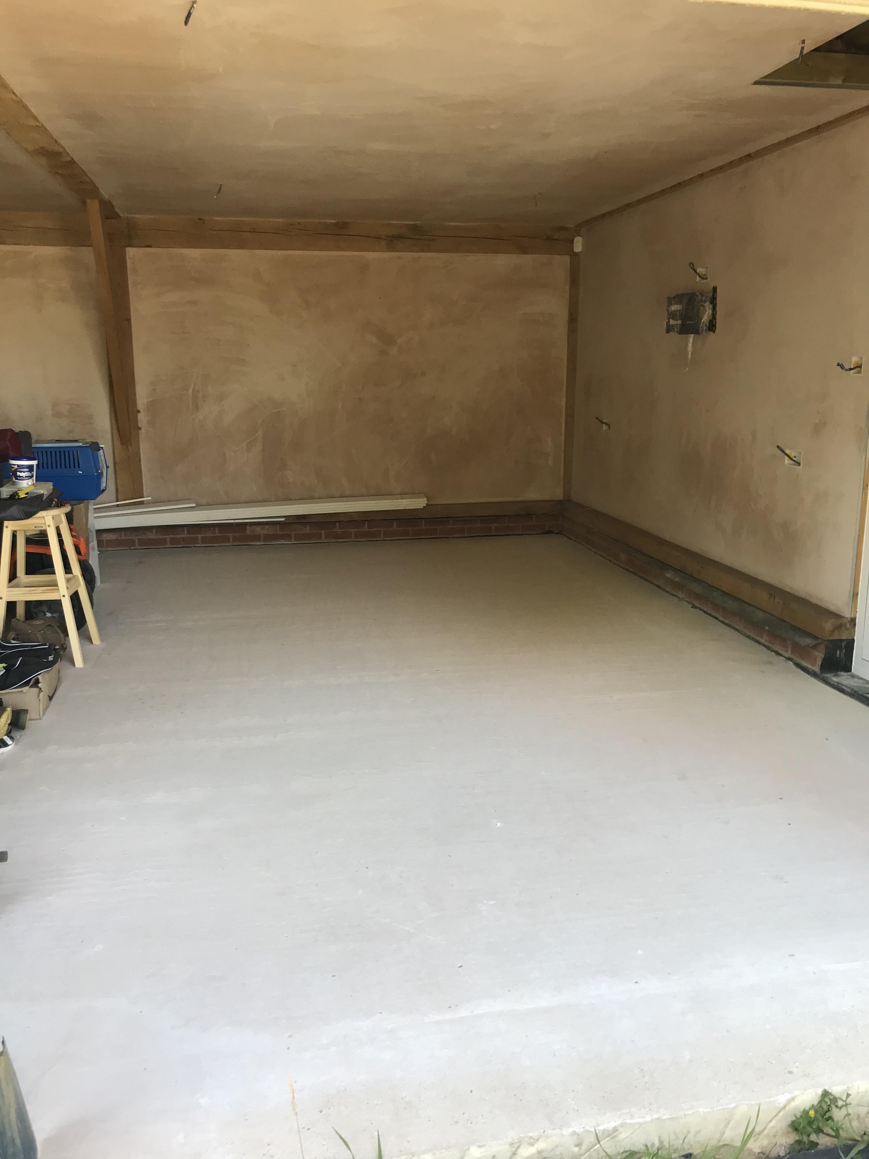

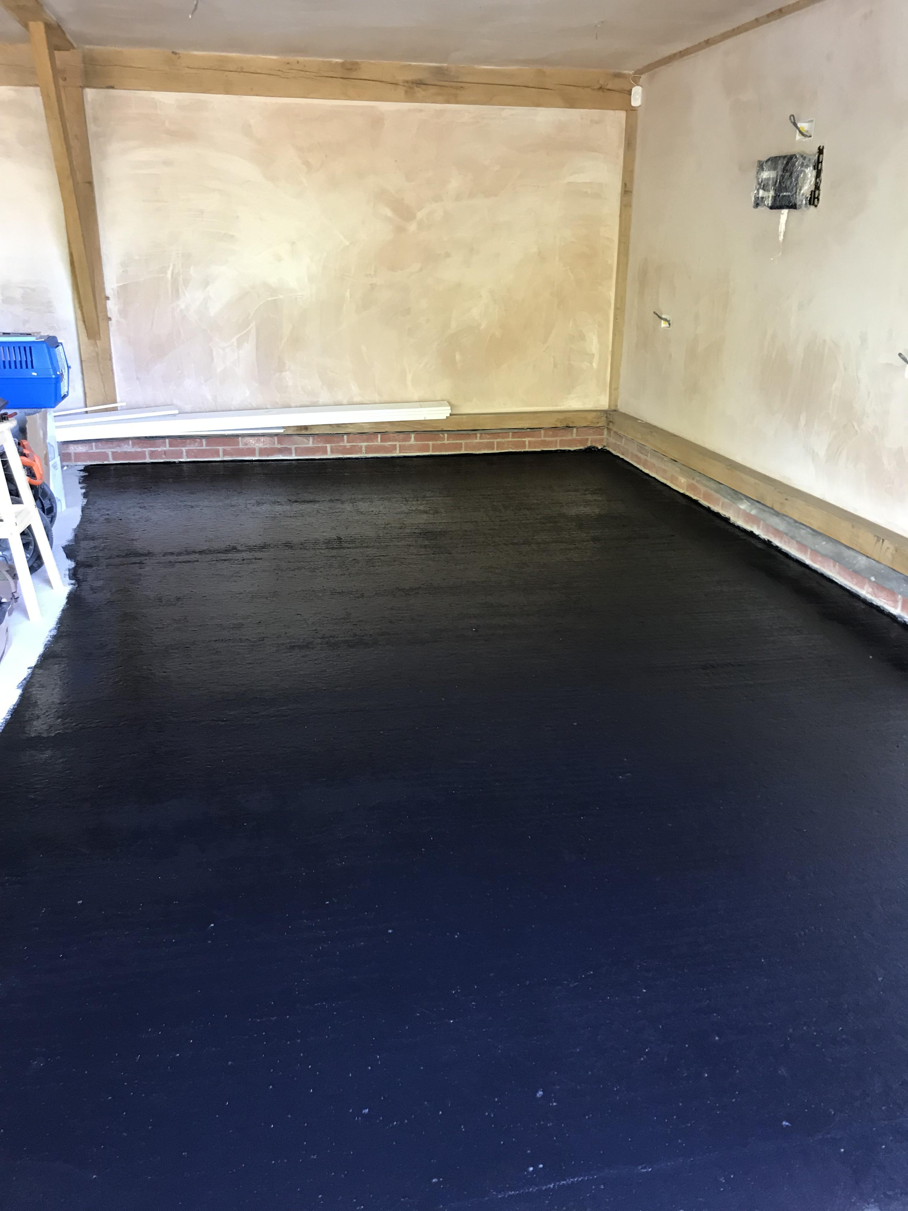

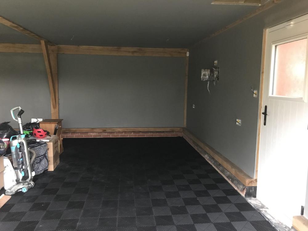

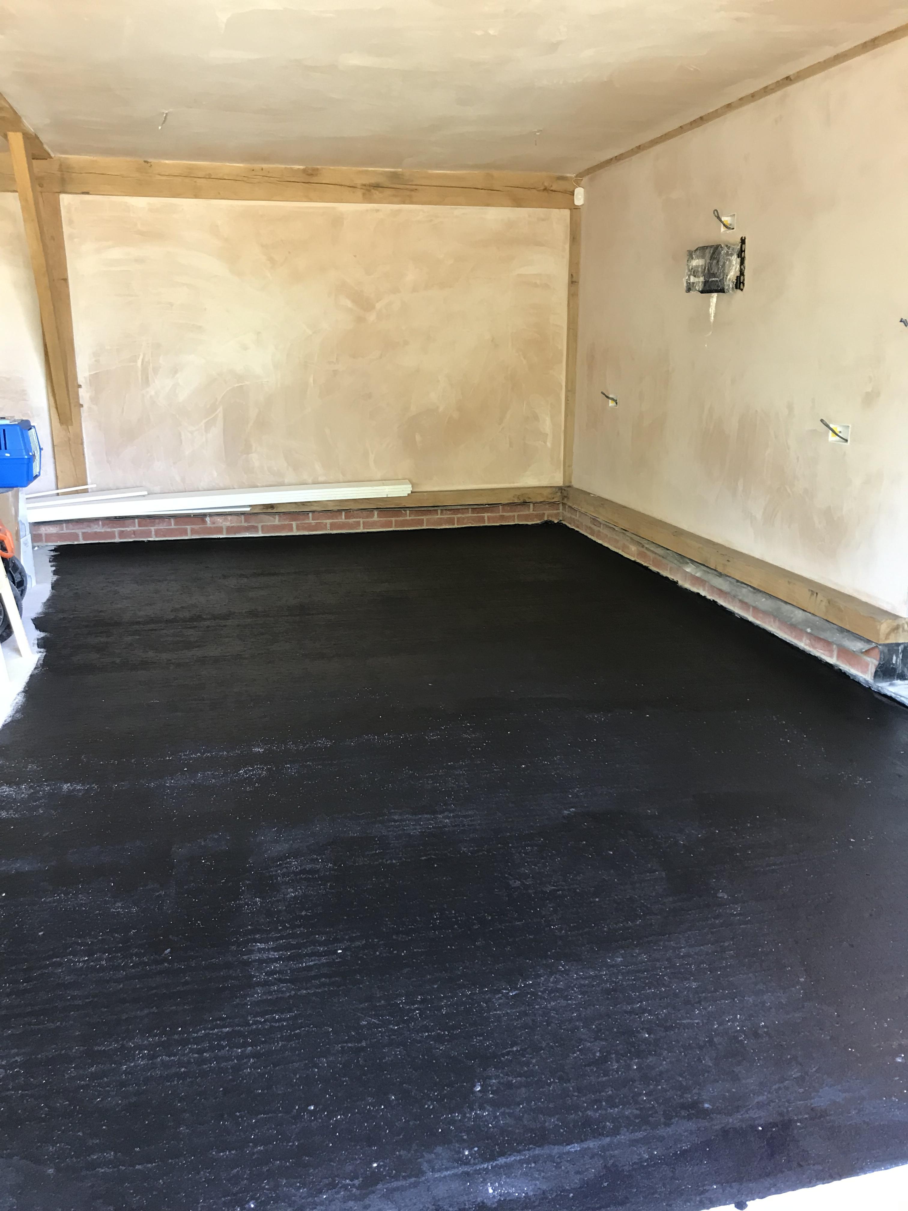

Dan1983 Posted September 4, 2023 Author Share Posted September 4, 2023 Floor prep for tuff tiles, as they are vented didn’t want the concrete colour showing through! Link to comment Share on other sites More sharing options...
Kelvin Posted September 4, 2023 Share Posted September 4, 2023 Looking great. I need to decide how to finish my garage floor and considering the tuff tiles. What did you paint the floor with? Link to comment Share on other sites More sharing options...
Dan1983 Posted September 4, 2023 Author Share Posted September 4, 2023 Thanks Kelvin, i used this stuff as meant I did not need to PVA the floor prior. Just watered it down 40/60 ratio for first coat second coat on now so that will do! Hopefully tiles will be here start of next week. Will get that half laid then switch all the junk from the other side and paint that. Link to comment Share on other sites More sharing options...

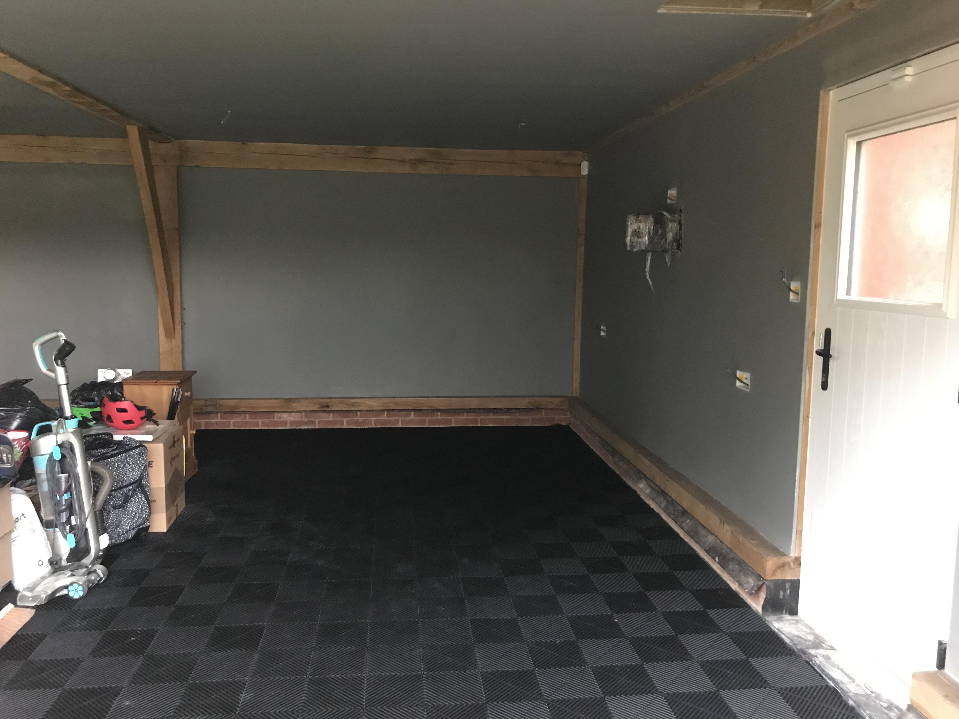

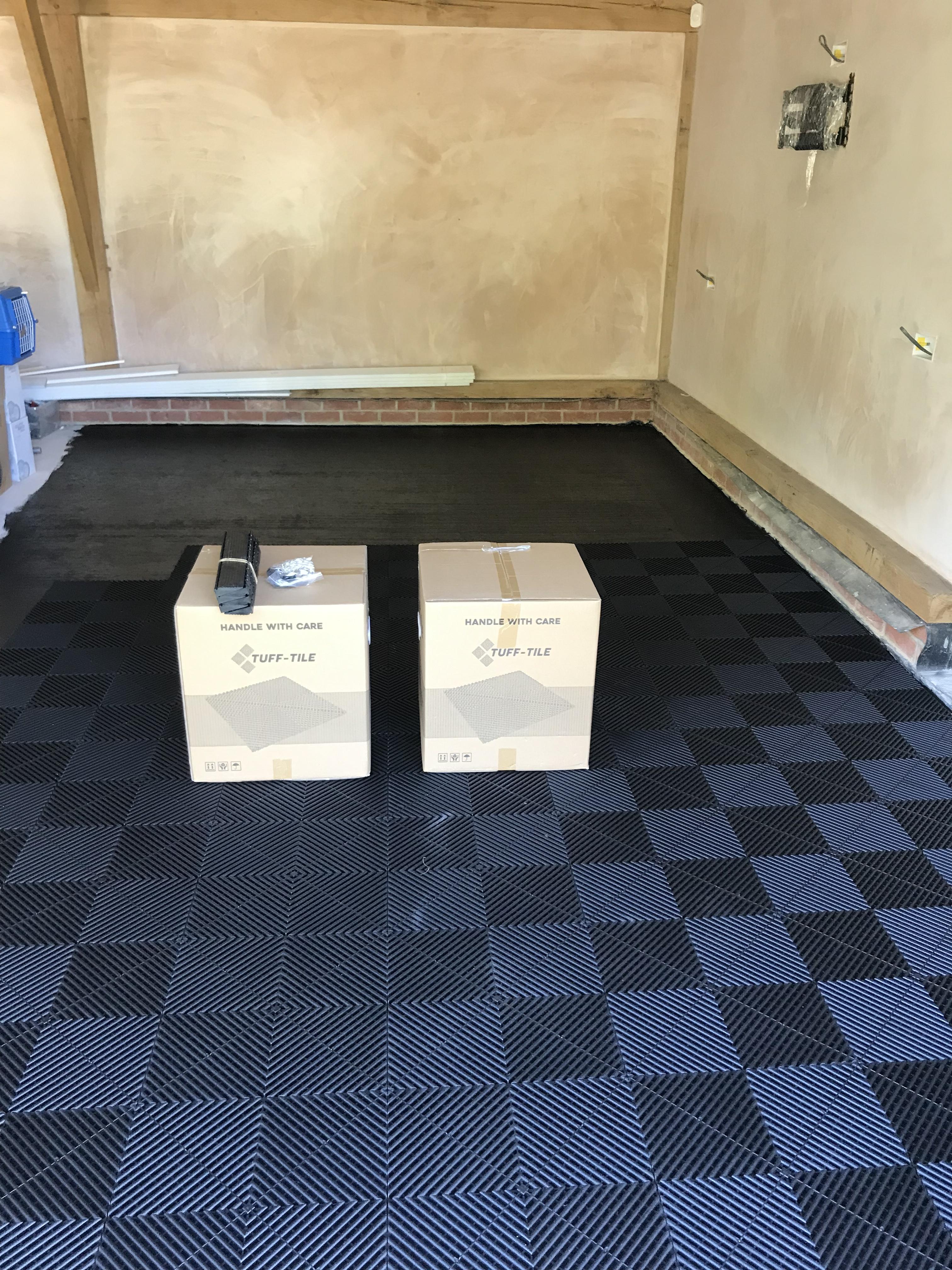

Dan1983 Posted September 7, 2023 Author Share Posted September 7, 2023 Started installing the tuff tiles today but ran out of time to continue the first bay! Excellent service from Brendan thoroughly recommended if anyone is considering them! https://tuff-tile.com/contact-us/ Link to comment Share on other sites More sharing options...
Dave Jones Posted September 8, 2023 Share Posted September 8, 2023 whats the m2 cost of them ? Link to comment Share on other sites More sharing options...
Dan1983 Posted September 8, 2023 Author Share Posted September 8, 2023 They are £4.75 per tile at 400x400 Dave, managed a small discount also on the final price 1 Link to comment Share on other sites More sharing options...

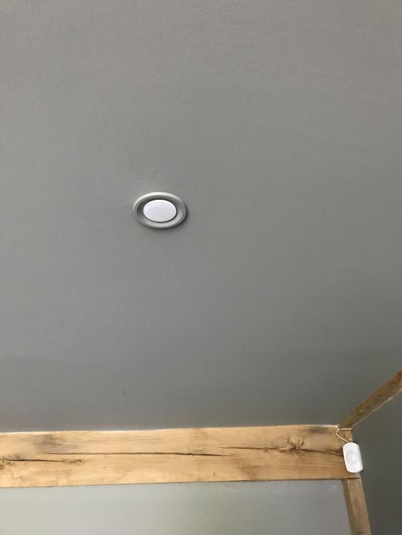

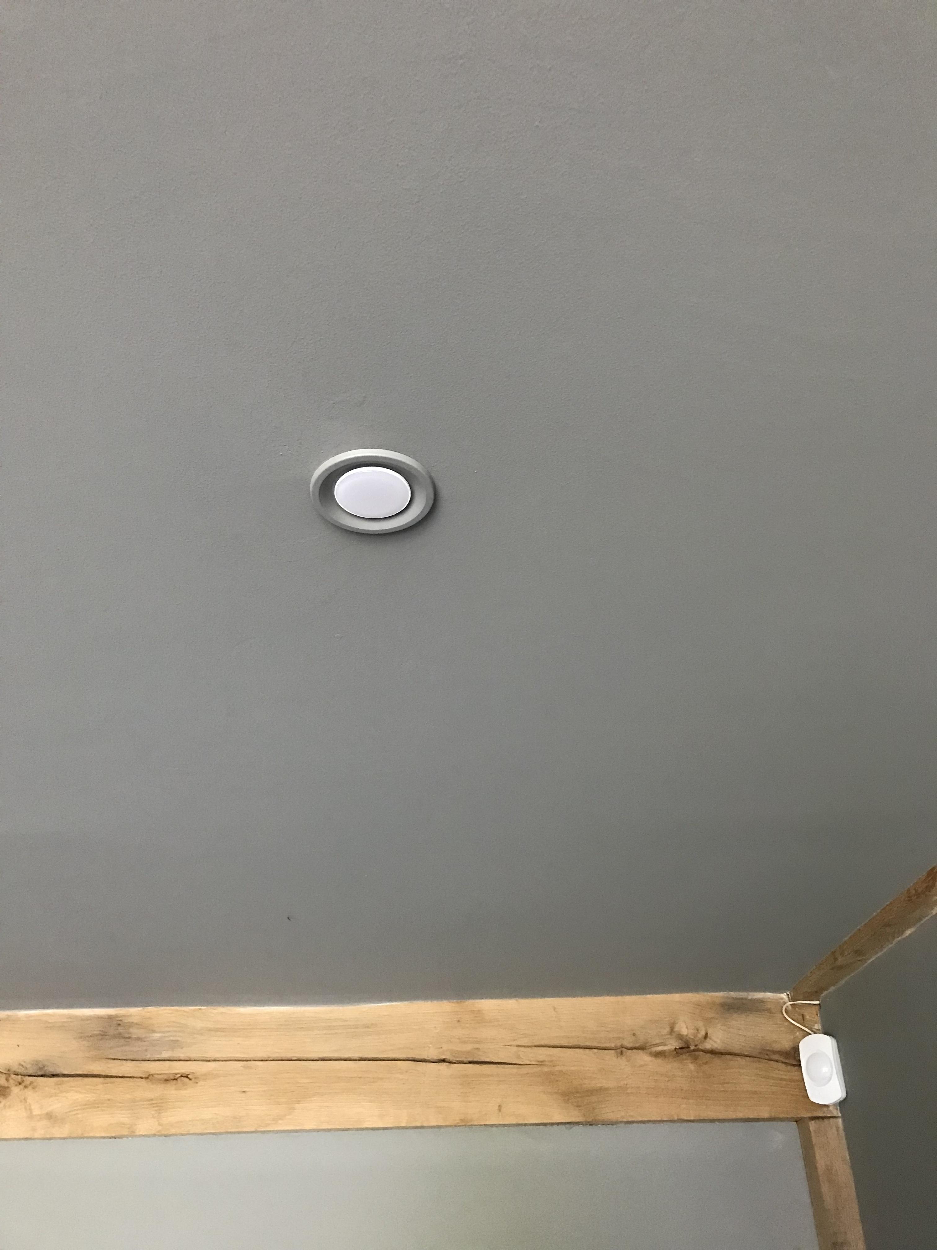

Dan1983 Posted November 13, 2023 Author Share Posted November 13, 2023 Lighting all connected up now and decorated (last coat going on now) went RAL 7030 to match the house doors and garage roller doors on walls and ceiling. Hope to get the sockets in tomorrow and tv working etc Fingers crossed wifi booster socket gives enough signal Link to comment Share on other sites More sharing options...

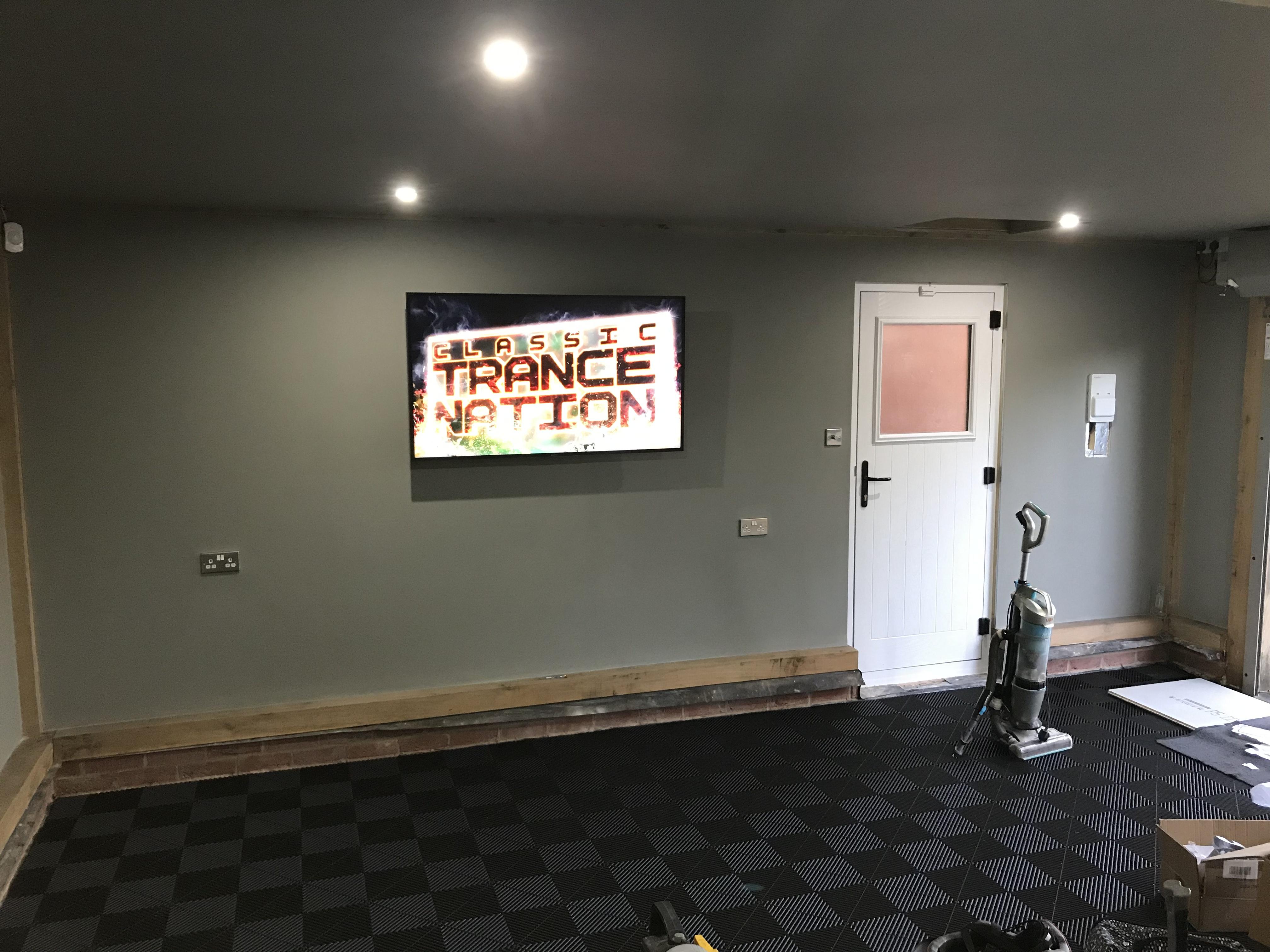

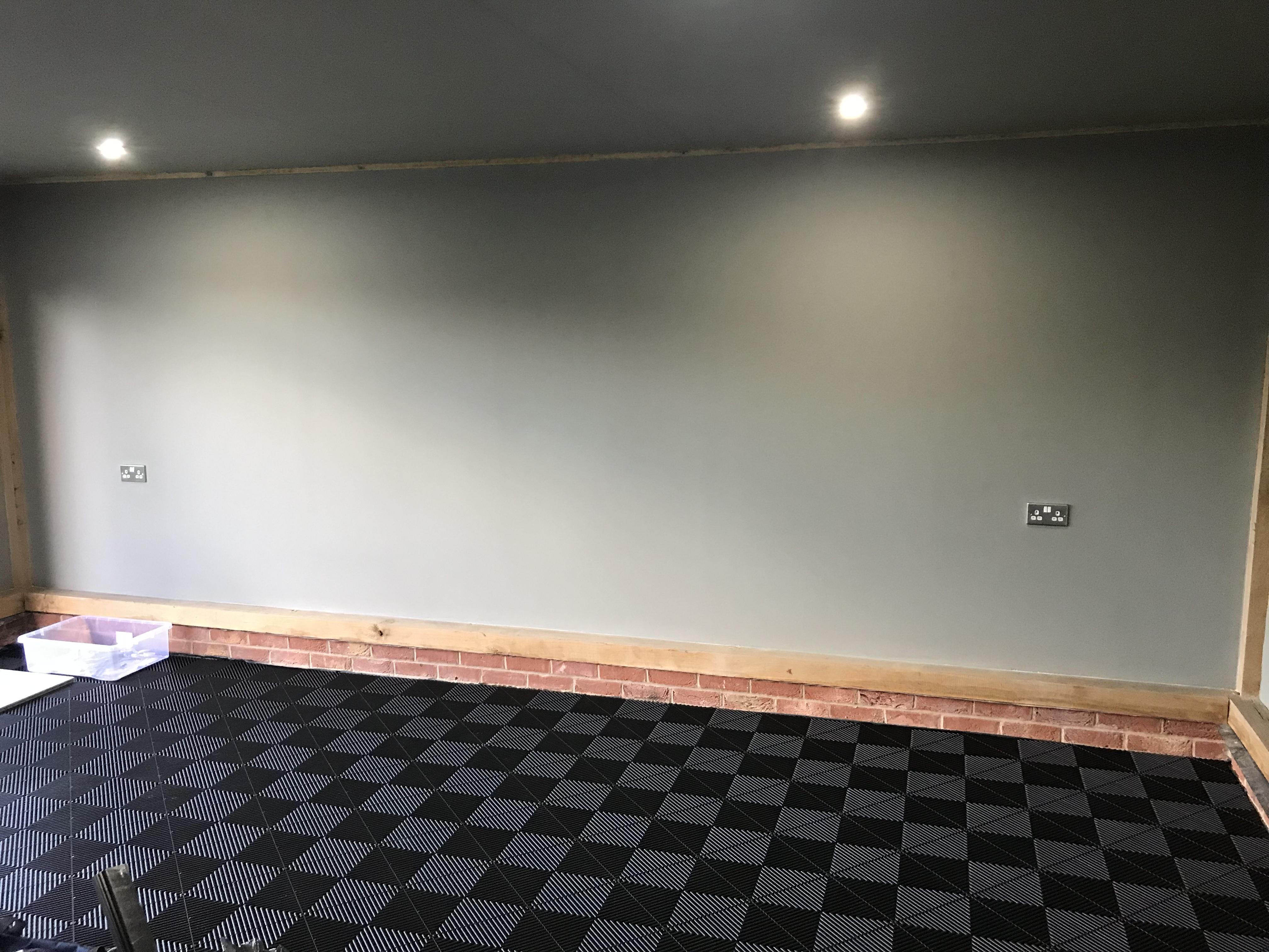

Dan1983 Posted November 14, 2023 Author Share Posted November 14, 2023 2nd fix now complete so all up and running Slightly annoying TV is not center of sockets but was stuck with batten position, if it annoys me too much I will ditch the right hand socket Link to comment Share on other sites More sharing options...
joe90 Posted November 14, 2023 Share Posted November 14, 2023 21 minutes ago, Dan1983 said: Slightly annoying TV is not center of sockets Ooh, that would bug me!!!! 1 Link to comment Share on other sites More sharing options...
markc Posted November 14, 2023 Share Posted November 14, 2023 Just now, joe90 said: Ooh, that would bug me!!!! @Dan1983 I bet that makes you feel loads better lol 2 Link to comment Share on other sites More sharing options...
Dan1983 Posted November 14, 2023 Author Share Posted November 14, 2023 Haha, it’s massively annoying me! Thinking about getting rid of that right hand socket skimming over and repainting the wall Link to comment Share on other sites More sharing options...
