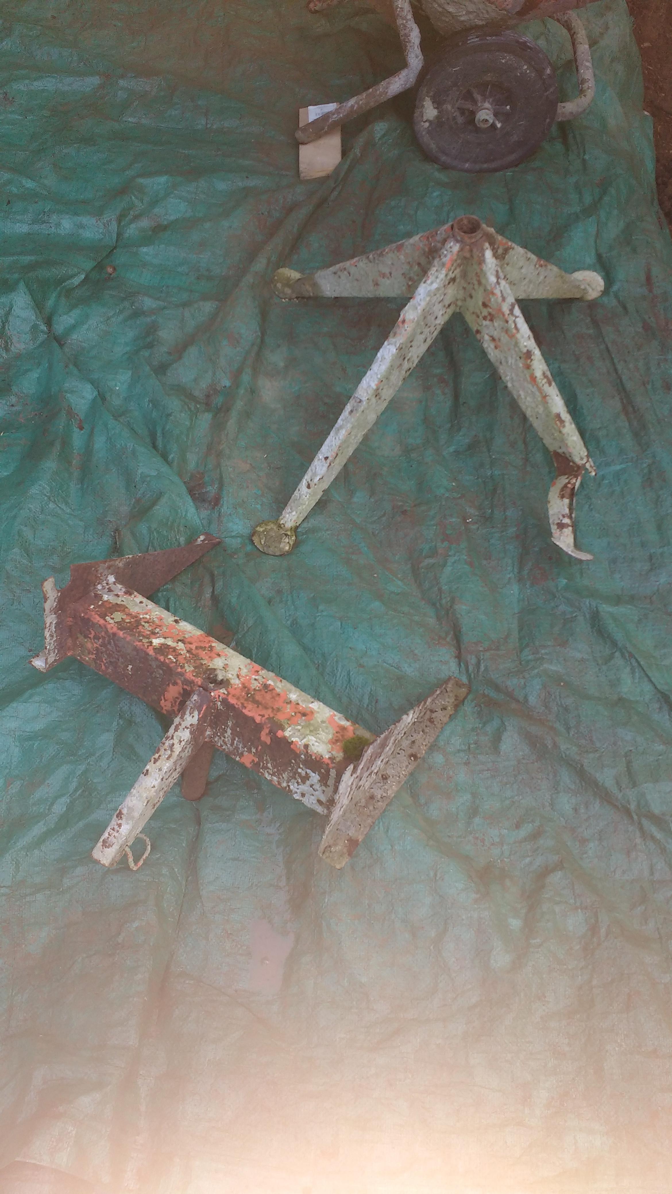

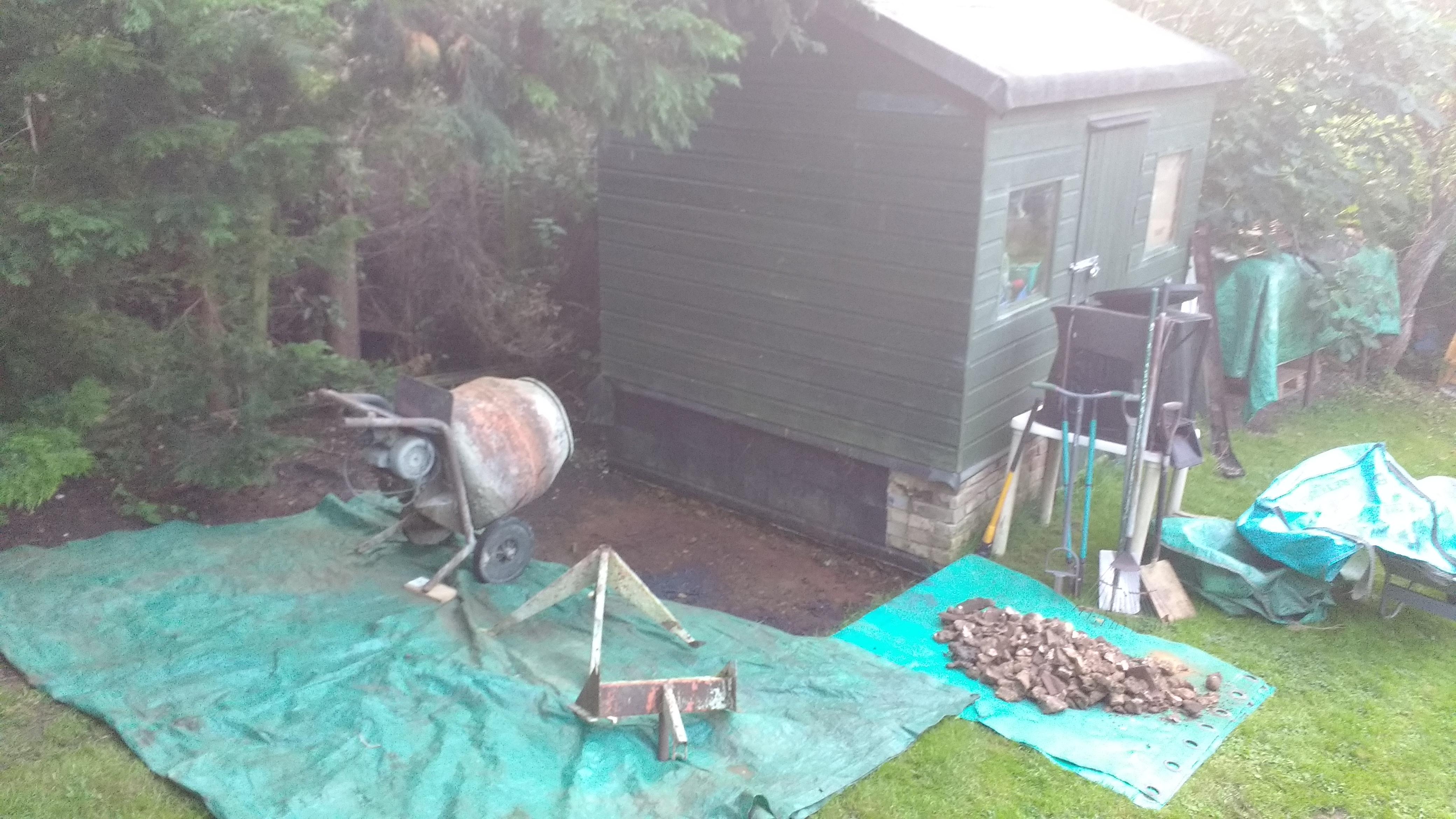

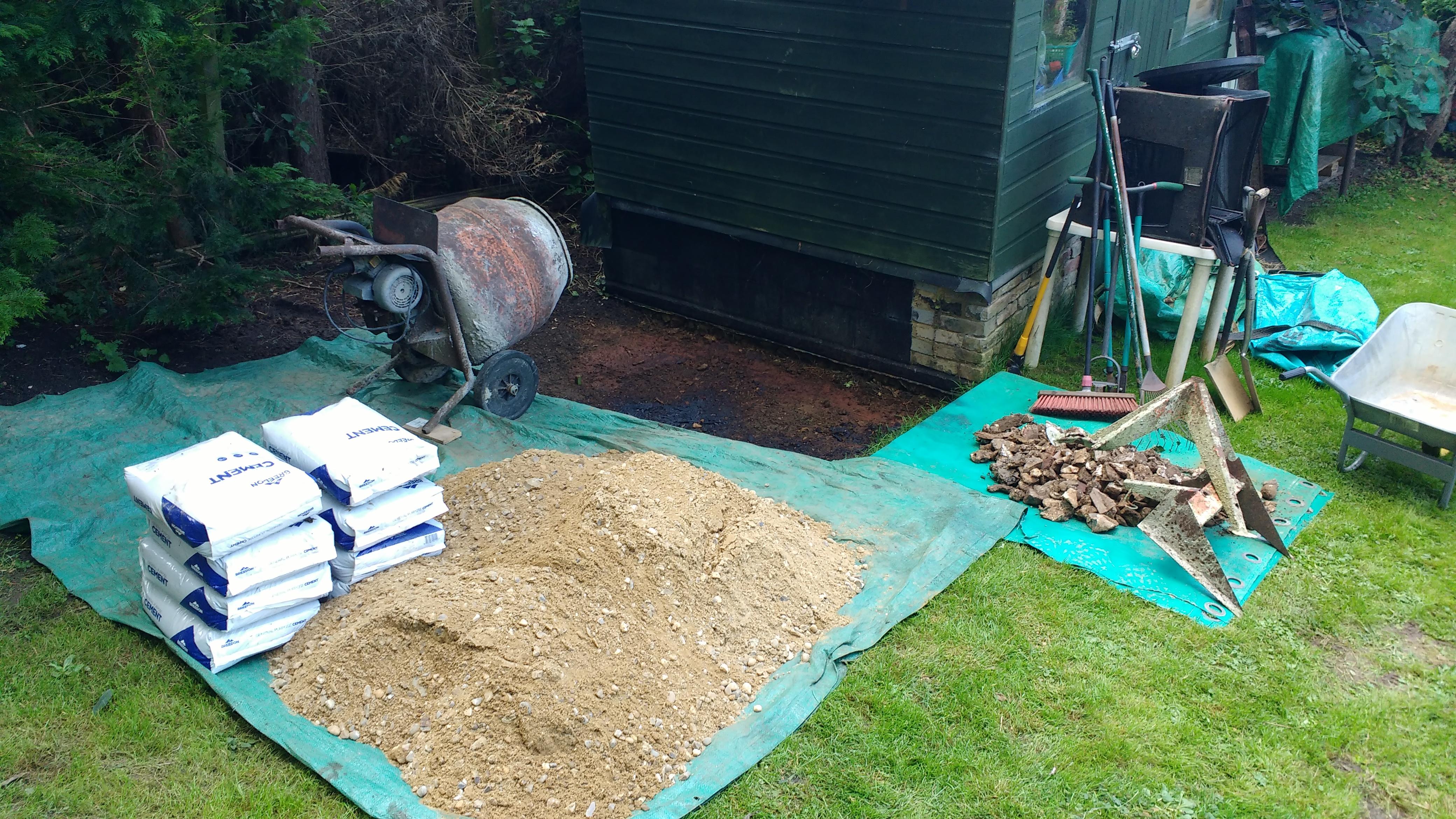

Onoff Posted September 15, 2021 Author Share Posted September 15, 2021 Not sure where I'm going but I've started getting ready. Got a jumbo bag of ballast and 8 bags of dust. Mixer needs some work... Link to comment Share on other sites More sharing options...

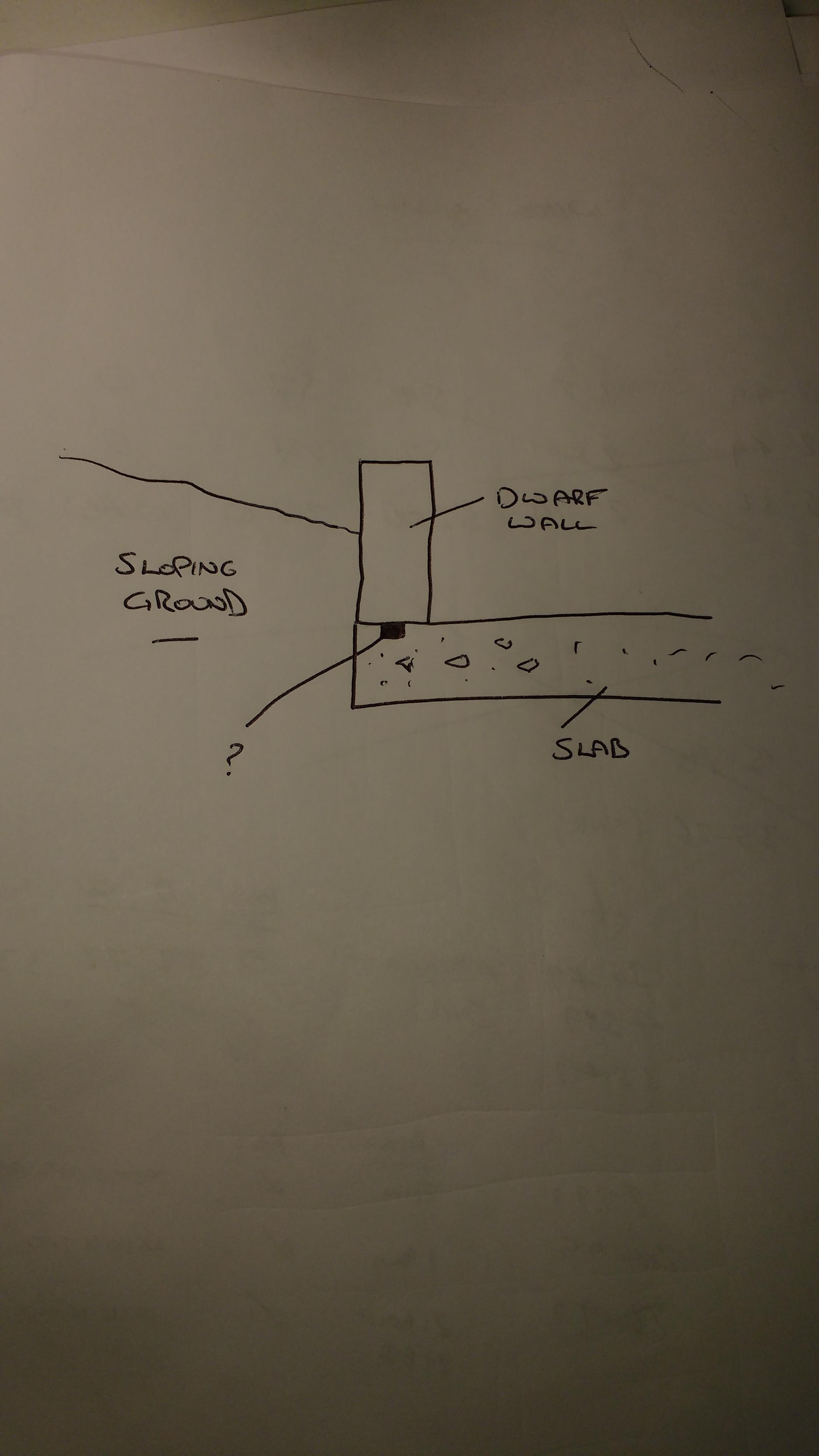

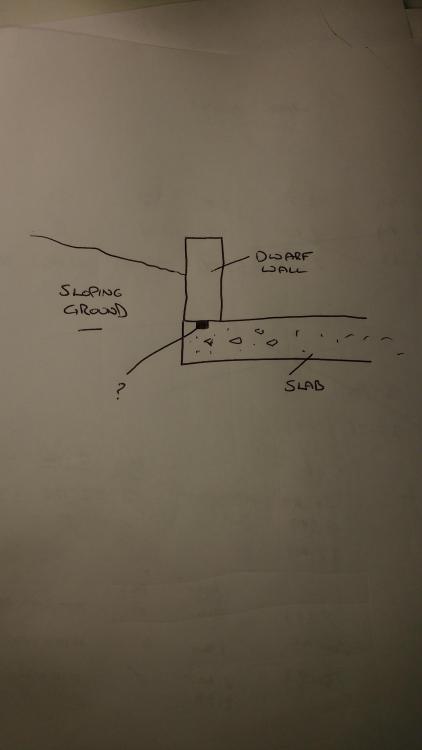

Onoff Posted September 16, 2021 Author Share Posted September 16, 2021 I'm going to cast a base. It'll be done with integral waterproofer and a sheet of A142 mesh I have here. Is there any poor man's technique to do a water bar detail? If I leave a groove in the slab where the dwarf wall is going? In all honesty I'll likely just leave a 6" gap, stick a membrane against the dwarf wall so it goes down past the slab and back fill with pea shingle. 1 Link to comment Share on other sites More sharing options...

Onoff Posted September 16, 2021 Author Share Posted September 16, 2021 1 hour ago, Gone West said: Well that'll make you feel knackered if the Covid doesn't. Just done the half bag up the slope, did I say half bag? ? Sweat pouring out of me, gasping and my left side chest weakness saying hello! What doesn't kill me etc! Bloody trooper I am! Suppose I'd better check for levels, dig out a bit if necessary and find some shuttering. To some extent that's going to be dictated by what I make the walls from. I'm rather tempted to shutter and cast the dwarf walls once I get the base down. Or I could hunt round for some stainless bolts and resin some studs into the old slab edge..... Link to comment Share on other sites More sharing options...

saveasteading Posted September 16, 2021 Share Posted September 16, 2021 6 hours ago, Onoff said: stick a membrane against the dwarf wall so it goes down past the slab and back fill with pea shingle. Yes that is simpler and better. Otherwise your water bar will have to be cast into base and wall. Easy enough but weakens the wall and seems unnecessary. Water goes the easy way. A nicely rough surface at the joint will help a lot too. Doesn't even need to be stuck. If it is held between the gravel and the concrete it will do..Not polyethene as it will react to light and fall apart. Assuming that this is all an external construction, not the wall of a building. Link to comment Share on other sites More sharing options...

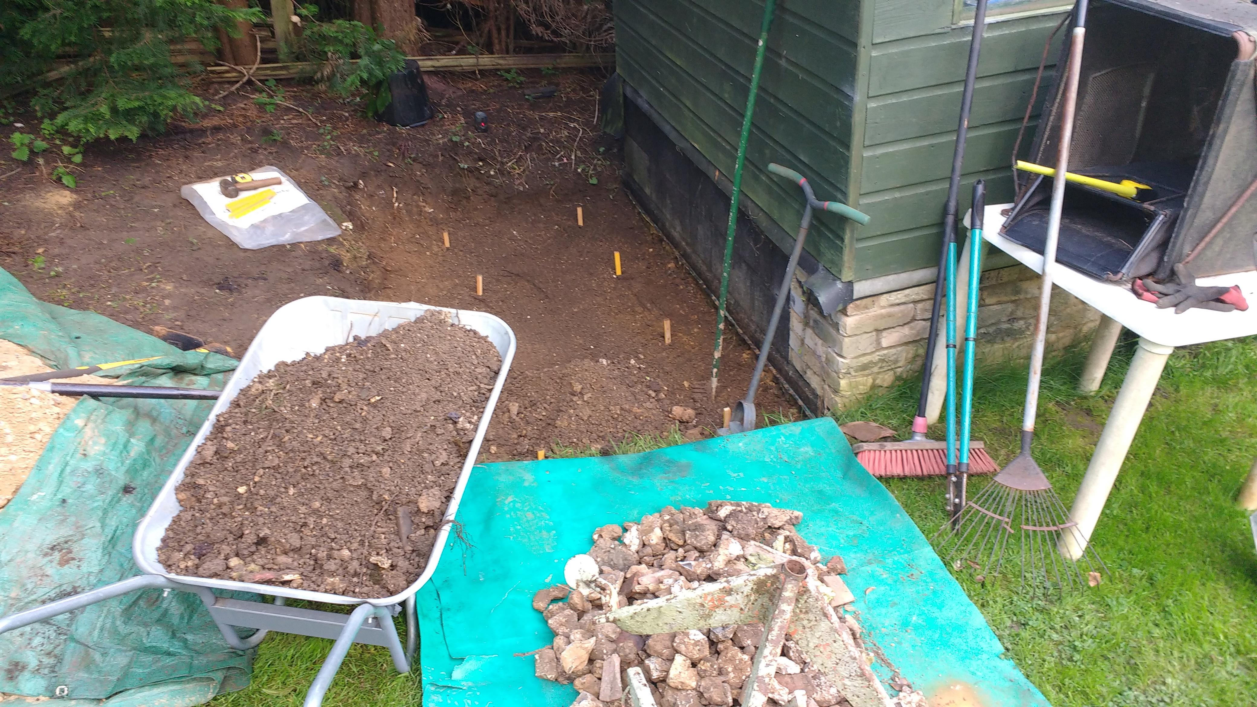

Onoff Posted September 16, 2021 Author Share Posted September 16, 2021 Throw nothing away! I knew that bag of yellow painted, batten off cuts would come in handy when I put them in the existing shed, (to take up space), 10 years ago! All level pegged, I'll get a nom 3" of hardcore in there which I'll whack down. A couple more barrows of soil to be taken out from off the high spots. Link to comment Share on other sites More sharing options...
