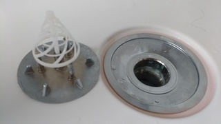

Auchlossen Posted September 13, 2016 Posted September 13, 2016 On 08/09/2016 at 22:24, Nickfromwales said: With a picture maybe ? On 08/09/2016 at 21:14, Auchlossen said: Ahaha... at the risk of subverting the thread, herein lies an important issue: what is the best trap? In my temporary abode, I have Roman shower with conical filter set at the front of the shower. Excellent easily removed and almost self emptying conical filter that seems to let the water through pretty effectively. Does anyone recognize this item and can identify it? On the tin, it says it is a Matki waste outlet. It is the sort of quality piece of kit that every home cleaner [that's me too] would thank you for.

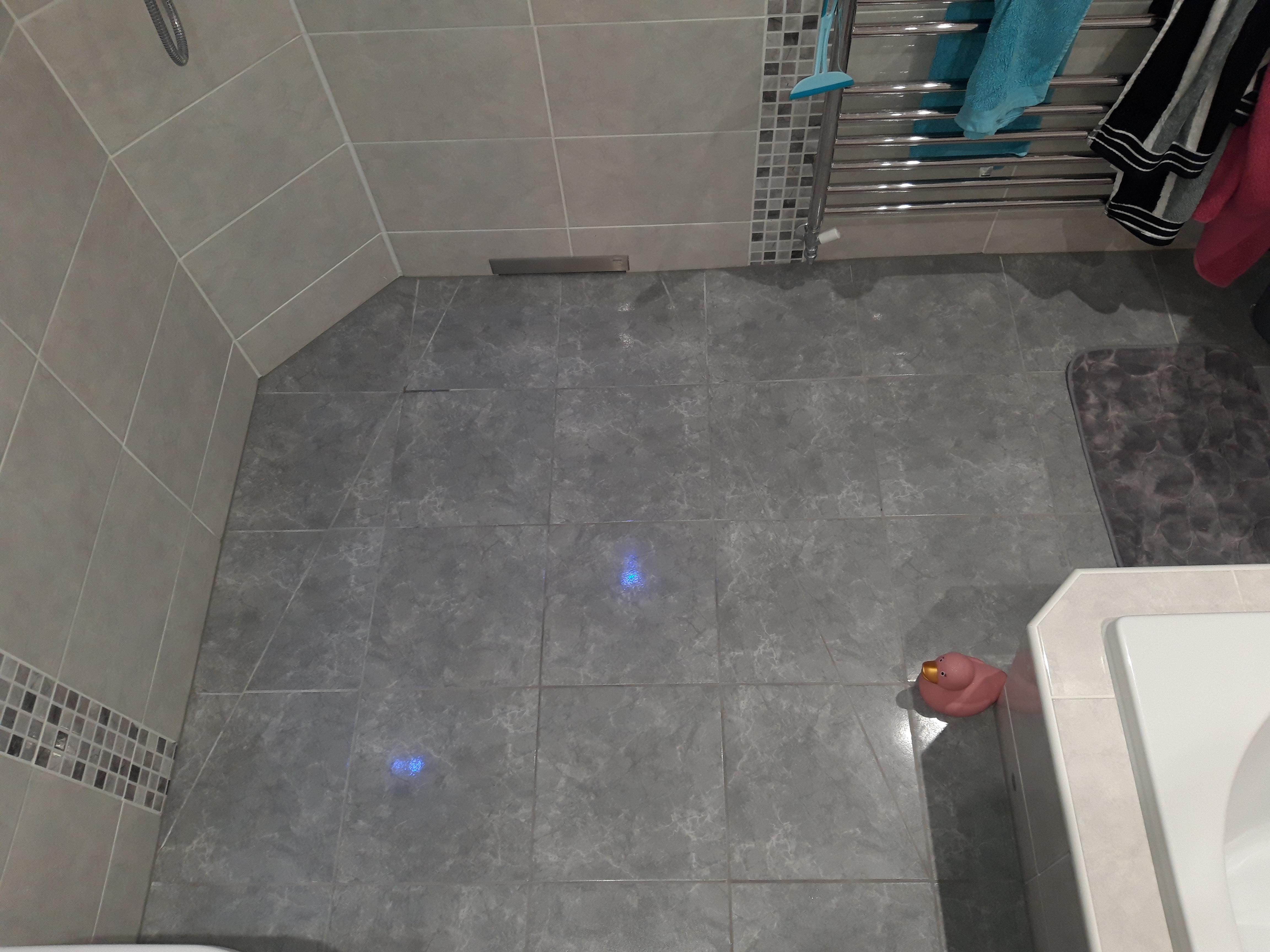

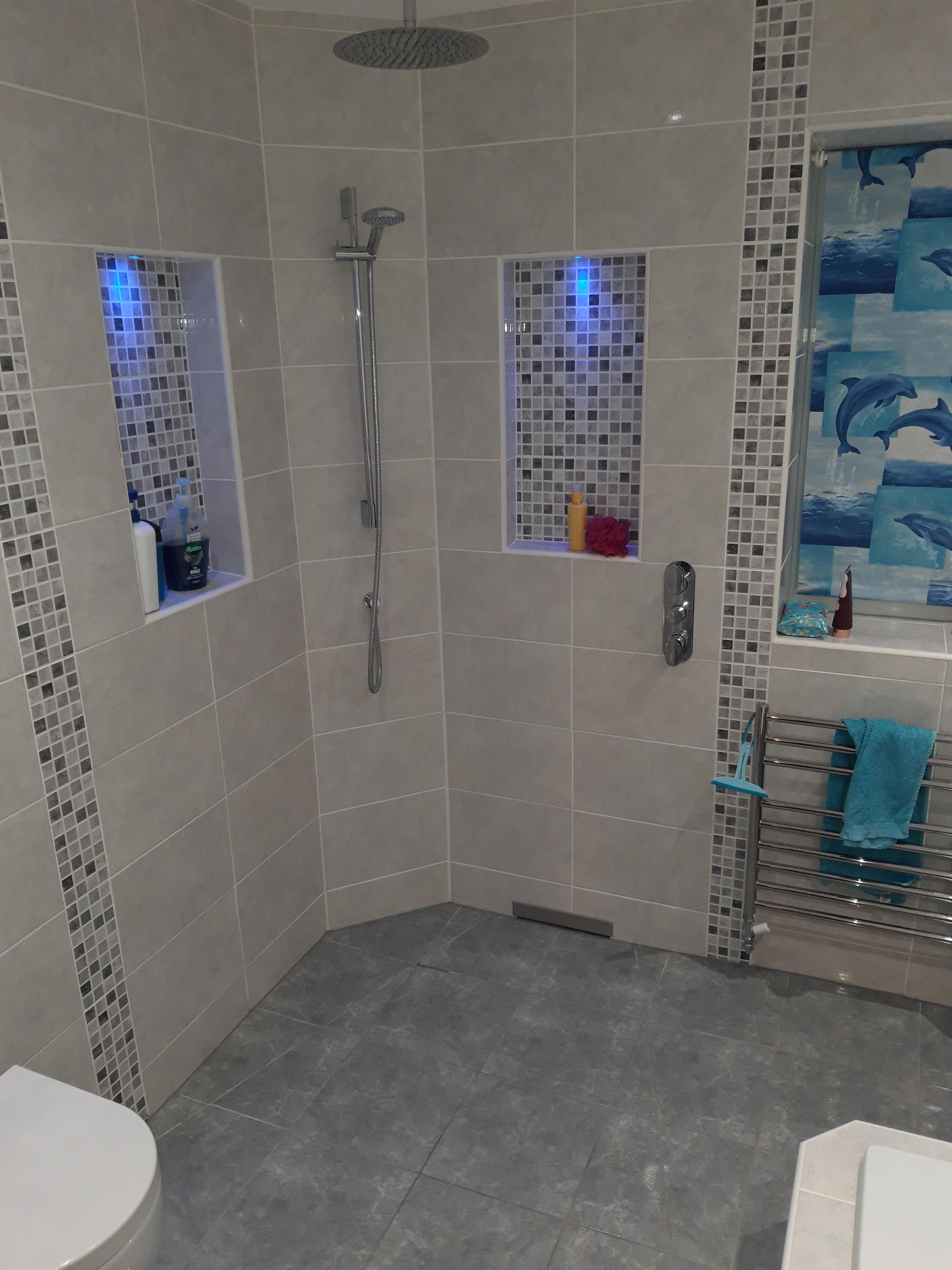

Onoff Posted June 26, 2019 Posted June 26, 2019 On 07/09/2016 at 08:43, Nickfromwales said: This is an infold door, just two of them. If you zoom in on the tray edge you'll see a chrome threshold that I butted up to the raised floor tile. That is about as frameless as you can get without having a Wetroom. Those doors came with the receiver that would have gone opposite so it could be fitted in an alcove. They got ditched and the square magnetic strips got switched out to ones which were at 45o. Both got supplied as it's an universal setup eg it could have also gone against a fixed glass side panel . Nick, any chance of a PM pls where you got these doors from + some idea of cost too for a two door kit like the pic. SWMBO and the kids well happy with the wet room corner but I don't like the albeit slight over spray that goes 1 tile beyond the falls area if you're not careful. The UFH, body dryer and venting will help I know I just want options. You know me, my mind's going off on an exotic forced air curtain / force field at the mo! 1
Nickfromwales Posted June 26, 2019 Posted June 26, 2019 The doors were from Novellini . The company rep was an arsehole and the manufacturers literature was incorrect. As I had to get those doors mm perfect to get the two magnetic seals to be parallel, plumb and true, I was less than happy when I discovered that the dimensions in the technical literature were all one size out per line. The 720mm was on the 740mm line and so on all the way through to the 980mm option I chose ( off plan before even starting the room ) which was actually only 960mm when sat midway into the wall profiles. ? Result was the two doors fully opened and sat perfectly at 90 degrees to the walls, and the two magnetic strips sat waving at each other, 40 odd mm across from each other. Peter the Novellini rep in Swansea was a condescending prick and I ejected him from the customers house when he just started blaming me. So, long and short, check what you get BEFORE fitting it so you don’t get screwed over. I think you’ll be ok as you don’t need yours to meet in the middle? 1
Onoff Posted June 26, 2019 Posted June 26, 2019 1 hour ago, Nickfromwales said: I think you’ll be ok as you don’t need yours to meet in the middle? I tried giving a laugh / thanks AND like. Best supplier REVIEW ever, still laughing. Splash zone reaches the duck if you're not careful. I'd need them to meet. Compounded by the mixer position. Rhs doors would clout it? Tbh I'm not overly bothered as I tanked everything but NOT the side of the bath, though I did the bath "deck". We squeegee the floor afterwards and I at least kick my used towel around the floor as you advise people I believe. Whatever, the experience is very nice. The rainfall is great. Being 6"5" it's great to be able to stand up straight under it.
Nickfromwales Posted June 26, 2019 Posted June 26, 2019 Yup. I took my scabby existing 8.5kw electric shower and hooked up a rainfall head and I'd never look back. Had a client with 2 power showers ( the guy I fitted the horizontal UVC for in the attic, and when I finally persuaded him to go for the bar mixer all-in-one rail, handset and rainfall head, he was chuffed. 1 hour ago, Onoff said: Being 6"5" it's great to be able to stand up straight under it. I had you pegged at not a jot more than 6' 4&3/4".
