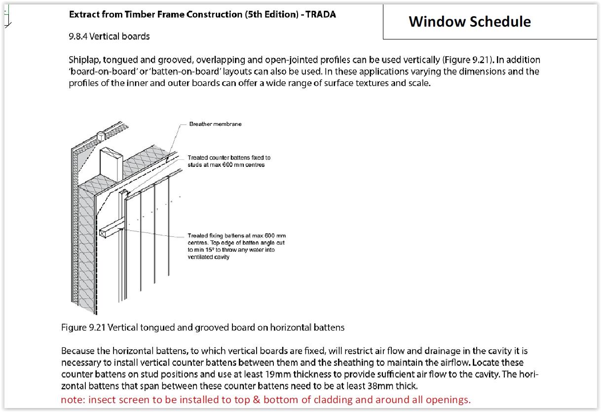

Simplysimon Posted June 3, 2019 Share Posted June 3, 2019 pic of cladding 1 Link to comment Share on other sites More sharing options...
