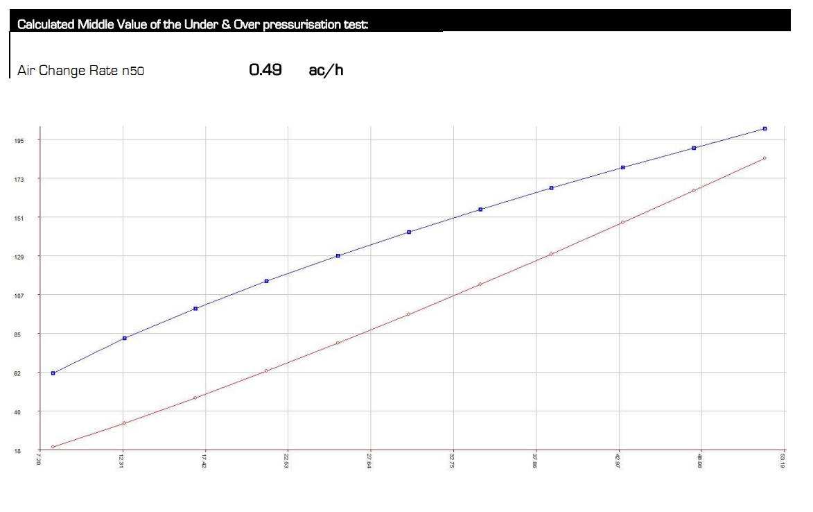

Jeremy Harris Posted May 22, 2019 Posted May 22, 2019 Just a thought, but are we looking at different measurement units here? The UK is a bit weird, in that our building regs don't use the near-standard air leakage/ventilation measurement system that pretty much everyone else in the world uses. In particular, the standard expression for air leakage/ventilation rate in the passive house world is air changes per hour at 50 Pa pressure differential. (ACH for short). The UK building regs specify this in m³/m²/hour, where m³ is the air leakage and m² is the total internal wall/floor/ceiling/roof area at the location of the airtight layer. The maximum allowable air leakage rate is 10m³/m²/hour. There can be a difference between ACH and m³/m²/hr, depending on the design of the house. For example, our air test was done by an Irish company, and they used the "normal" units, ACH at 50 Pa. I then had to convert this to m³/m²/hr for building control. Our ACH measurement was 0.49 ACH at 50 Pa, but the UK building regs figure was 0.6m³/m²/hr at 50 Pa.
Gone West Posted May 22, 2019 Posted May 22, 2019 3 minutes ago, JSHarris said: There can be a difference between ACH and m³/m²/hr, depending on the design of the house. For example, our air test was done by an Irish company, and they used the "normal" units, ACH at 50 Pa. I then had to convert this to m³/m²/hr for building control. Our ACH measurement was 0.49 ACH at 50 Pa, but the UK building regs figure was 0.6m³/m²/hr at 50 Pa. Strangely ours was exactly the same at 0.47, for both measurements, which surprised me.
Jeremy Harris Posted May 22, 2019 Posted May 22, 2019 18 minutes ago, PeterStarck said: Strangely ours was exactly the same at 0.47, for both measurements, which surprised me. Interestingly, if we'd not had the tall vaulted ceilings upstairs, but had taken the airtight layer just behind conventional height ceilings, then our building regs figure would have increased to about 0.67 m³/m²/hr. We had a measured air leakage volume at 50 Pa of 166m³/hr pressurised and 199m³/hr depressurised, so a mean of about 182.5m³/hr.

Ed Davies Posted May 22, 2019 Posted May 22, 2019 12 hours ago, SteamyTea said: I wonder if that result takes into account that the pressure was at 60 Pa, rather than 50 Pa. It should do. The standard way to do it is to measure the airflow at a range of positive and negative pressures and fit a formula then use that to work out the leakage at 50 Pa.
Jeremy Harris Posted May 22, 2019 Posted May 22, 2019 7 minutes ago, Mr Punter said: With @joe90's house does anyone know approximately what difference to annual running costs the difference between this test result and, say 0.6 would make? Does 1.0 really make much difference? Probably very little, unless the house is in an exposed area. Although PHI set the air leakage rate at 0.6 ACH, and the target under building regs for a house with MVHR is 1m³/m²/hr, in reality I doubt that there's a massive benefit from getting much below about 1.5 ACH or so, especially if the house isn't in an exposed location. Wind seems to play a pretty significant part when it comes to heat loss, though, so any house in an exposed area is likely to have a higher heat loss than one in a sheltered area, and would probably benefit more from being well-sealed. Where we are it's very sheltered, so I suspect it's debatable whether our low air leakage really makes a massive difference in practice. 1
Jeremy Harris Posted May 22, 2019 Posted May 22, 2019 6 minutes ago, Ed Davies said: It should do. The standard way to do it is to measure the airflow at a range of positive and negative pressures and fit a formula then use that to work out the leakage at 50 Pa. This is the plot from our air test, with pressure differential (Pa) on the X axis and air leakage volume (m³) on the Y axis:
