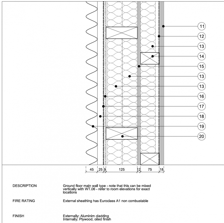

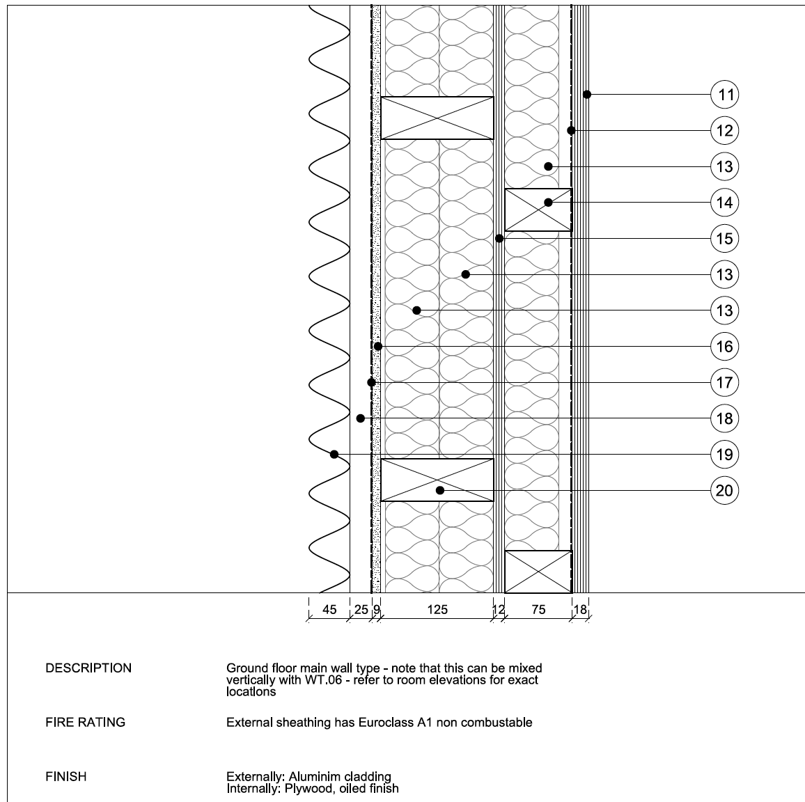

 (at the moment our architect added quite a bit! more than 220mm PIR).
what type of construction are you doing?
Typical section drawing here :
Timber frame construction, Plywood internal finish, Corrugated aluminum exterior. Kingspan K112 Framing Board 60mm x 3 =180mm total
@Tony C there's a lot of care going to be required with all those 60mm sheets to avoid any gaps and potential cold areas. possibly worth considering i beam or twin stud construction with a blown insulation.
