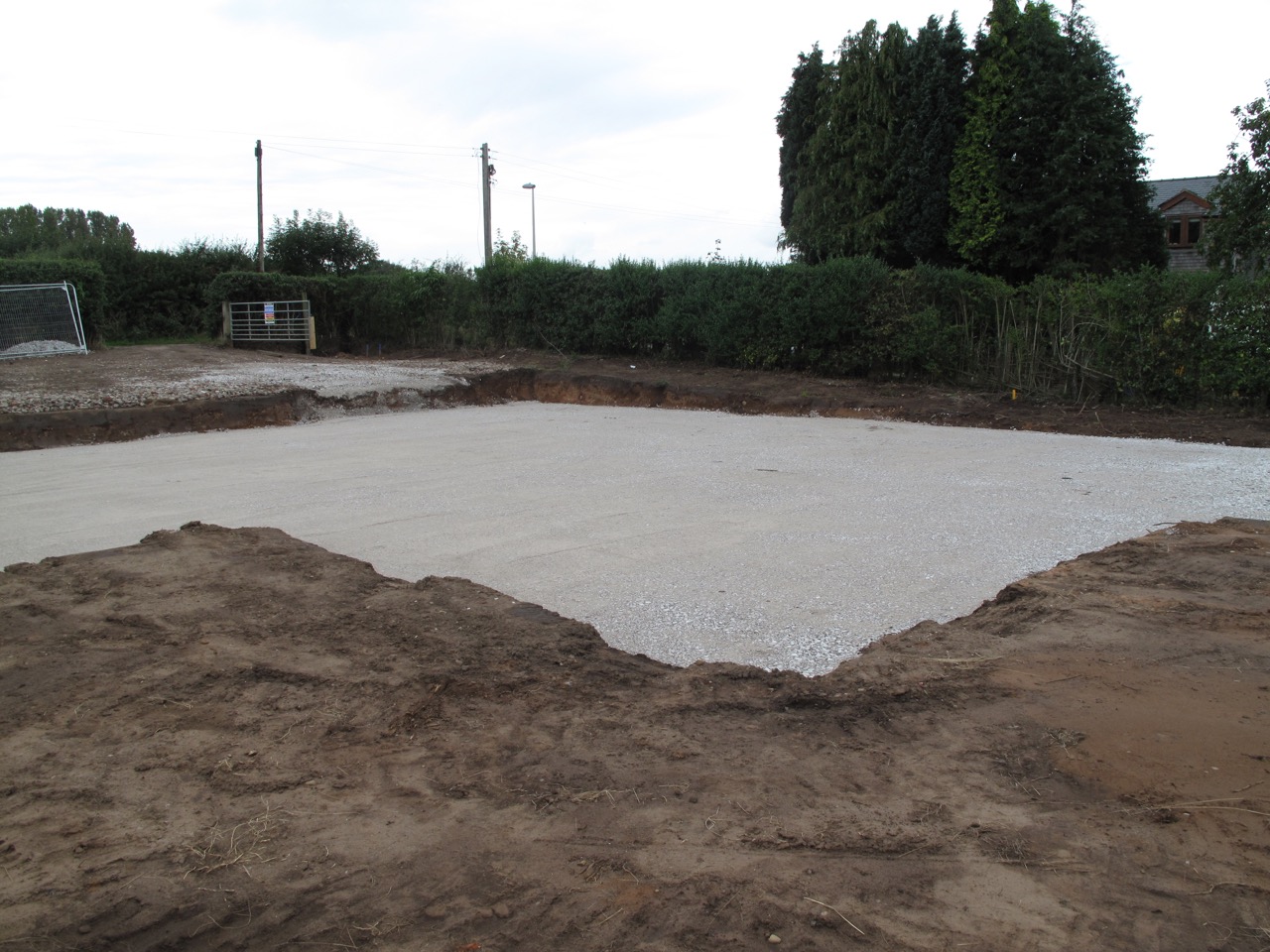

worldwidewebs Posted September 11, 2016 Author Posted September 11, 2016 Ooh, first lot of groundworks finished! More info on the blog https://selfbuildnoviceblog.wordpress.com

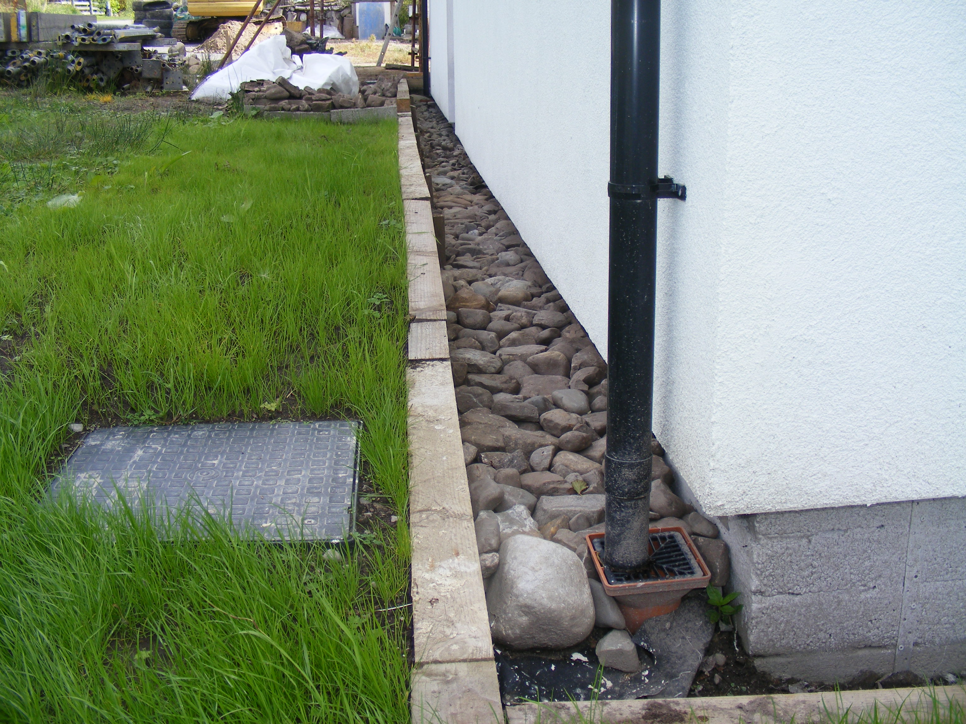

ProDave Posted September 11, 2016 Posted September 11, 2016 20 minutes ago, worldwidewebs said: Ooh, first lot of groundworks finished! More info on the blog https://selfbuildnoviceblog.wordpress.com Reading your blog and your "FFL" being 150mm lower than the ground level. We have a similar situation, not regards to FFL but regards to DPC level (strip foundations) that are some way below FFL. I have solved this by digging a trench around the front, making a little retaining wall out of railway sleepers, and filling the inside with rocks, to form a sort of French Drain that will go all along the front and down one side of the house. I have to go out just now but when I get back I will take a photo and post it here
ProDave Posted September 11, 2016 Posted September 11, 2016 Here's how I dealt with the ground level at the front of my house. I dug a trench and made a retaining wall of railway sleepers, just 3 sleepers high, topped off with a 4" fence post on it's side so the top edge on show is not as clunky as a sleeper.(and I wouldn't have had enough sleepers) The house side is then filled with stones to make a French Drain. The DPC is level with where the rendered wood fibre board stops, the course of blocks immediately below the DPC has air bricks so the stones are built up to just below the level of the air bricks. this French Drain will get continued along the side of the house where the ground is much lower.
