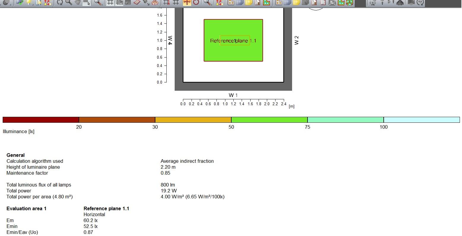

Carrerahill Posted May 8, 2019 Share Posted May 8, 2019 (edited) 58 minutes ago, epsilonGreedy said: I started ordering bits for the garden shed electrics job and this was the lowest power @800 lumens led strip light I could find at Screwfix. The shed has standing headroom under a pitched roof, will it be too bright? https://www.screwfix.com/p/luceco-weatherproof-led-batten-10w-800lm-2ft/2138t 800Lm will not give you much light at all. I have run you a quick calc using an 800mm batten. Results show an avg. of 60Lux - to put that into perspective CIBSE would recommend a WC is lit to a minimum of 100lux!! If it was me I would want at least 200lux average in this space, I would say about 2500 Lumens is what you need. Edited May 8, 2019 by Carrerahill 1 Link to comment Share on other sites More sharing options...

epsilonGreedy Posted May 9, 2019 Author Share Posted May 9, 2019 15 hours ago, Carrerahill said: 800Lm will not give you much light at all. I have run you a quick calc using an 800mm batten. Results show an avg. of 60Lux - to put that into perspective CIBSE would recommend a WC is lit to a minimum of 100lux!! If it was me I would want at least 200lux average in this space, I would say about 2500 Lumens is what you need. Thank you for running the calculation, I had not realized lighting levels could be determined through a room specific formula. The consensus here is that 10 watts led is not too much which was my concern and probably insufficient. Last night I assessed the lighting needs by dangling my 180LM Makitta torch from the shed ridge and the lighting level was not half bad. Anyhow I now have a good idea of the reasonable range when I go shopping for a light. Link to comment Share on other sites More sharing options...

epsilonGreedy Posted May 21, 2019 Author Share Posted May 21, 2019 Feedback: I went ahead with a 10W LED strip light and it is fine for finding things in an 8x6 shed at night and operating the washing machine. In the end I thought an under spec light was more suitable on a dark building site with trip hazards between static caravan and shed because eyeballs will be less dazzled after leaving the shed. @Carrerahill's lux calculations are still valid, I notice the shed is dingy on an overcast day with the light on (like a B&Q store), so any more focused work than pressing washing machine buttons requires double or treble the lighting intensity in a shed or workshop. The Luceco light I linked to earlier was a pleasure to fit. Link to comment Share on other sites More sharing options...
