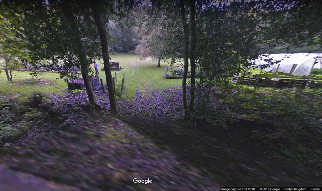

Piers Posted May 5, 2019 Posted May 5, 2019 Does anyone know whether planning permission is required for making alterations to an existing access? I have a rural house with 2 accesses - the main one which has gates, tarmac etc and a secondary entrance straight into the garden. This secondary entrance had originally been made of crushed hardcore but after years of leaf-fall was a bit muddy and our car would get stuck in winter. So, about a month ago as I had a digger hired, we dug out the mud and put down some fresh hardcore. At the same time we took down a pair of holly trees on one side of the entrance and removed the stumps, widening the access by around a metre. Today I received a letter from the LPA telling me I'm being investigated for a potential breach *gulp* The allegation is that I've created a new access and laid a hard surface. I know that the first part is untrue (but I might have to prove it and who takes pictures of an old dirt track!) and the second part depends on the definition of "hard surface". I understand that usually means non-porous (such as tarmac) so I should be ok with crushed hardcore. Nonetheless it's a worry and I'm conscious that I might just be trying to reassure myself.

Piers Posted May 6, 2019 Author Posted May 6, 2019 11 hours ago, AliMcLeod said: Have you checked google street view (assuming the secondary access entrance is accessed from a road)? Yes, the streetview from 2010 isn't great but shows (IMO) the entrance. 1 hour ago, PeterStarck said: I would say it was repair work to an existing entrance. Thanks @PeterStarck and @joe90, sounds like good advice. The LPA have asked me to arrange a site visit. I'd thought of sending them Google streetview and satellite pics and tell them that it's an existing entrance and save themselves the trip. Or do you think I should welcome them to visit? I'm keen not to annoy them, we have our informal pre-app meeting tomorrow for our house replacement application - this couldn't have come at a worse time.
PeterW Posted May 6, 2019 Posted May 6, 2019 Send them the pictures. If you’re not in a conservation area then the trees are irrelevant. Also include the history - it’s a field gate from the looks of that anyway so a hardcore base isn’t a problem and doesn’t need PP.
Ferdinand Posted May 6, 2019 Posted May 6, 2019 (edited) I think your explanation should be fine. It is a repair. There may be a clearer overhead view in bing.com - photography is sometimes clearer. But are those actually offences, since it is porous? This could just be for form as someone complained. There is also the case that if this is an entrance directly to a field from an unclassified road, you may have the right to create one anyway (or they may not have the right to stop you creating one, even if they do cry into their sarsaparilla). In which case even if it wasn't a repair (which it is) they are whistling in the wind anyway trying to enforce nothing. Perhaps ask what they would enforce on (if you need)? Ferdinand Edited May 6, 2019 by Ferdinand
Ferdinand Posted May 6, 2019 Posted May 6, 2019 (edited) "Dear XYZ Thank you for your letter. Whilst I always enjoy visits from Council Officers, in this case I was simply maintaining an existing access into my field, for convenience and in order to prevent mud being spread onto the lane by vehicles - thus preventing a potential hazard. As it is a field entrance, I am entitiled (required?) to carry out such maintenance. I enclose a screenshot from Google Earth, and also a photograph taken this morning. You are, of course, welcome to visit in any case. Rgds etc Basil II, the Bulgar-Slayer, Founder - Varangian Guard" Edited May 6, 2019 by Ferdinand 1

Piers Posted June 4, 2019 Author Posted June 4, 2019 On 06/05/2019 at 11:34, Ferdinand said: There is also the case that if this is an entrance directly to a field from an unclassified road, you may have the right to create one anyway (or they may not have the right to stop you creating one, even if they do cry into their sarsaparilla). In which case even if it wasn't a repair (which it is) they are whistling in the wind anyway trying to enforce nothing. Perhaps ask what they would enforce on (if you need)? By way of update the LPA inspector did his drive by and then wrote to us pretty much saying what @Ferdinandsaid. You'd have thought that they'd know which roads are unclassified without needing to come on site, but hey ho. He did write, that whilst we didn't require PP as the road is unclassified, that was so long as there was no "engineering" involved. He'd adjudged that our entrance repair had not been engineered. Not sure I know what that means, nor whether I care that much. Thanks all for your support and advice. I'm almost looking forward to next time we're reported! As we're currently building a PD outbuilding on a slope, with eaves at lowest point of slope around 4m, I imagine it won't be too long. 1
