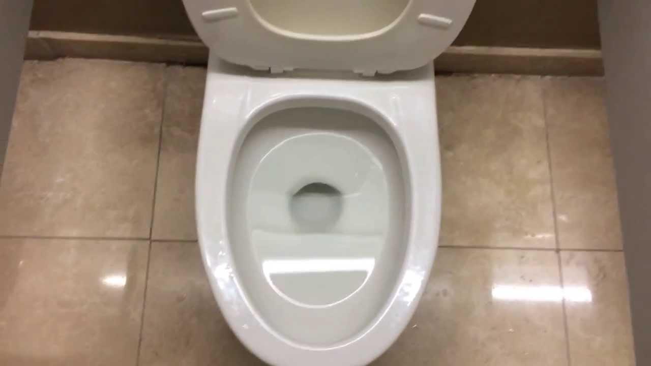

puntloos Posted May 4, 2019 Share Posted May 4, 2019 Is there such a thing as a Ferguson? Slightly more seriously: I want toilets that: - Self-clean a flush should hit every nook and cranny matter should not have a chance to stick, so it should not hit any dry area - Refill quickly not sure if this is 'up to' the toilet, or it's just a matter of a good water line - Are as water efficient as possible Happy to have a partial and a full flush .. and happy to hear other things to look out for For one I have the impression that the American system, where there's a considerable amount of water in the bowl at all times, and a flush pulls all the water out of the bowl is the better approach than the UK one with the small hole. And for example the American Standard Siphonic takes between 3.5 and 6 liters which is fairly reasonable I think? Link to comment Share on other sites More sharing options...

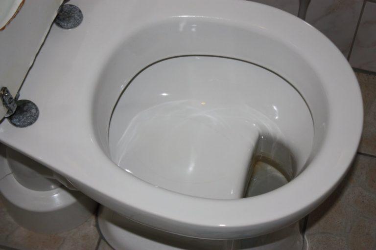

ToughButterCup Posted May 5, 2019 Share Posted May 5, 2019 21 minutes ago, Ferdinand said: [...] I once had a *huge* lecture from a German housemate on this subject, including a thorough examination of the insufficiently cleansed loo. [...] And why am I not surprised? This design was common in Germany when I was a kid : less so now. No matter what your reaction to the design is - it does make you clean the bowl. As an aside, I had German relatives ask me in all seriousness how to use a UK design loo without getting a wet bum. The design nickname was Splash Loo (Plumpsklo). I took great delight in telling them that - to keep their bums dry - they had to sit facing the wall and aid the straining process by holding the downpipe with both hands. I explained (lied) that high level cisterns were provided for that very purpose ; I offered to fit a spare bike handlebar to the downpipe as a 'training device'. (Ubungsgerat) Yes, the inevitable happened. One relative completely missed the pan.God, I was in bad odour for a while. I'm almost sure my mum stopped my pocket money for a while after that incident. 1 2 Link to comment Share on other sites More sharing options...

puntloos Posted May 5, 2019 Author Share Posted May 5, 2019 Yup, inspection shelf toilet at my parents' place (netherlands). Still there. Only solution is to apply toilet paper to the bowl before you do your thing. So what 'pan style' is best? Is anyone with me on the theory that a large pool of water is helpful, and the inspection shelf is not? I've noticed that the Japanese Toto ultramax II has all these, and there is actually an UK company - CPHart - that stocks toto (but not the UMII.. yet?) Link to comment Share on other sites More sharing options...
Jeremy Harris Posted May 5, 2019 Share Posted May 5, 2019 18 minutes ago, puntloos said: Yup, inspection shelf toilet at my parents' place (netherlands). Still there. Only solution is to apply toilet paper to the bowl before you do your thing. So what 'pan style' is best? Is anyone with me on the theory that a large pool of water is helpful, and the inspection shelf is not? I've noticed that the Japanese Toto ultramax II has all these, and there is actually an UK company - CPHart - that stocks toto (but not the UMII.. yet?) I found the more complex Japanese toilets mind-numbingly complex to use, especially when they didn't have an English translation for all the controls. I did like the washing feature though, although I can't say I ever got used to the blast of air from the drying function. The other things that was less than ideal in the middle of the night was the little tunes some of them play. Apparently the idea is to mask any embarrassing noises. Frankly I'm inclined to think that having music coming from the toilet was more embarrassing. The large pool of water is a mixed blessing, in my view. It helps keep the pan clean, but increases the problem of splashing, so works best if a "everyone has to sit down to pee" policy is enforced. We've found that a D shaped toilet (European style) with a near-vertical rear internal face, seems to be self-cleaning to some degree, certainly better than a standard UK style pan. Best feature by far is to just add a shattaf spray. Not only is it a lot more hygenic, but it also works well to clean the pan if need be. I'm a great fan of these things, and cannot understand the British obsession with using loads of toilet paper. Link to comment Share on other sites More sharing options...
AliG Posted May 5, 2019 Share Posted May 5, 2019 I travel all the time to America for work. Our toilets work much better I find as their's don't send the flush water down fast enough. We have Porcelanosa toilets with their matching Noken hidden cisterns 6/3l flush. As far as I can see they are identical to Grohe/Geberit concealed cisterns. They send the water down much faster than the toilets in our previous house so are much better at cleaning out the pan. I do not know if this is due to the in wall cisterns being higher above the WC or them being set to take the maximum amount of water before they overflow. As an aside the half flush to save water I find pointless as often it doesn't flush properly then needs flushed multiple times so ends up actually using more water. Link to comment Share on other sites More sharing options...
puntloos Posted May 5, 2019 Author Share Posted May 5, 2019 7 minutes ago, JSHarris said: I found the more complex Japanese toilets mind-numbingly complex to use, especially when they didn't have an English translation for all the controls. I did like the washing feature though, although I can't say I ever got used to the blast of air from the drying function. The other things that was less than ideal in the middle of the night was the little tunes some of them play. Apparently the idea is to mask any embarrassing noises. Frankly I'm inclined to think that having music coming from the toilet was more embarrassing. The large pool of water is a mixed blessing, in my view. It helps keep the pan clean, but increases the problem of splashing, so works best if a "everyone has to sit down to pee" policy is enforced. We've found that a D shaped toilet (European style) with a near-vertical rear internal face, seems to be self-cleaning to some degree, certainly better than a standard UK style pan. Best feature by far is to just add a shattaf spray. Not only is it a lot more hygenic, but it also works well to clean the pan if need be. I'm a great fan of these things, and cannot understand the British obsession with using loads of toilet paper. Ha, to be clear I'm not really into "cleansing wands" and all these other gizmos - I know the Japanese have a tendency to over-engineer their stuff =) True about the possible splash with the water level, although just laying down a sheet of paper on the water would fix it.. (mostly) Hmm. good point about Shattaf being able to clear the pan. That said, err, have to ask: who/what cleans the shattaf if it gets... shattaffed on? Link to comment Share on other sites More sharing options...
puntloos Posted May 5, 2019 Author Share Posted May 5, 2019 1 minute ago, AliG said: I travel all the time to America for work. Our toilets work much better I find as their's don't send the flush water down fast enough. Perhaps I misunderstand but the american ones are hoping/assuming the waste is in the 'water bowl' and pretty much no force is necessary. But indeed if something is outside the bowl, the flow to clear that up is very weak.. 1 minute ago, AliG said: We have Porcelanosa toilets with their matching Noken hidden cisterns 6/3l flush. As far as I can see they are identical to Grohe/Geberit concealed cisterns. They send the water down much faster than the toilets in our previous house so are much better at cleaning out the pan. I do not know if this is due to the in wall cisterns being higher above the WC or them being set to take the maximum amount of water before they overflow. As an aside the half flush to save water I find pointless as often it doesn't flush properly then needs flushed multiple times so ends up actually using more water. Yup, although surely the half flush can be configured properly to be say 3/4 and save a little without the risk of leftovers? Link to comment Share on other sites More sharing options...
