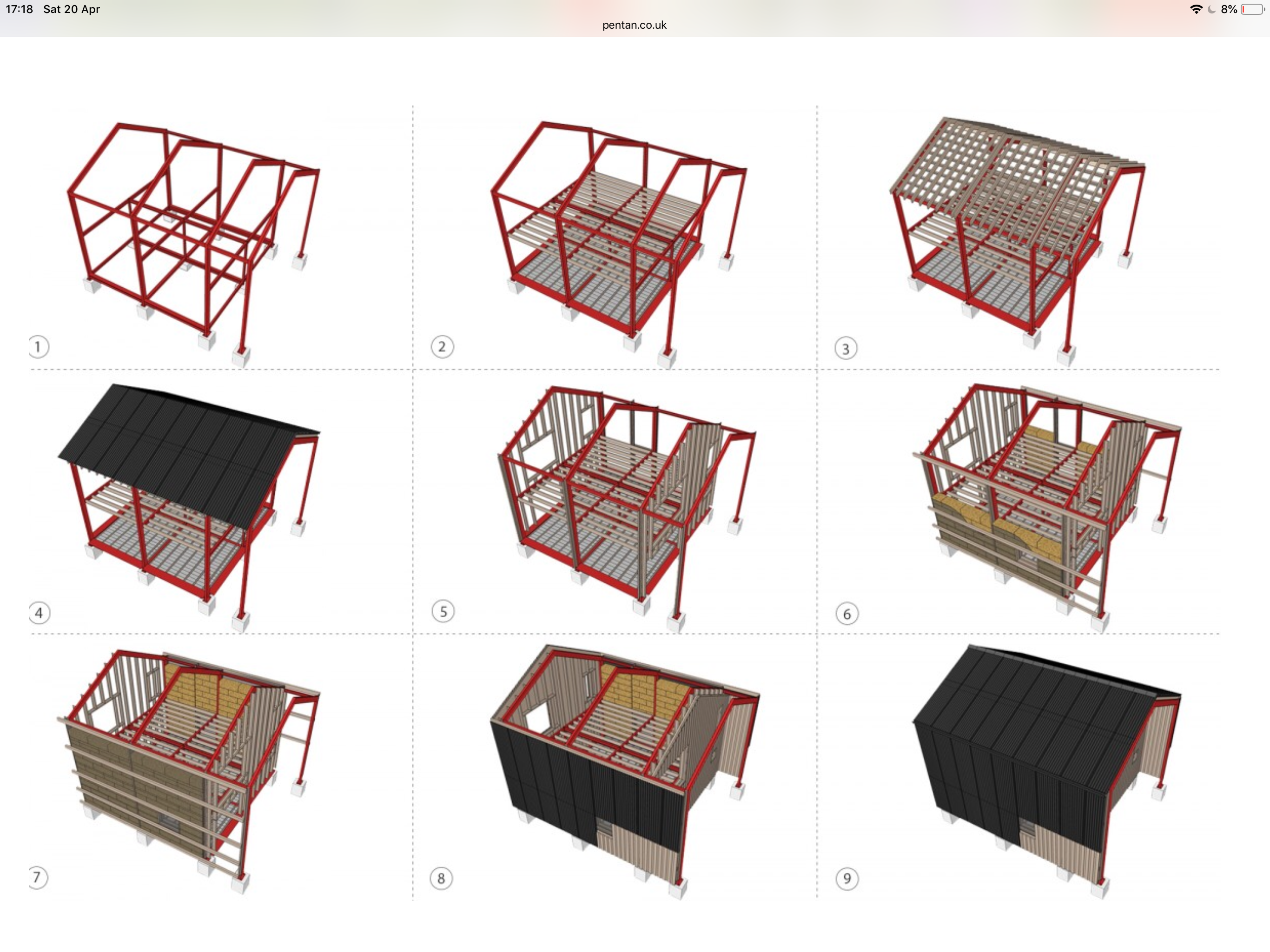

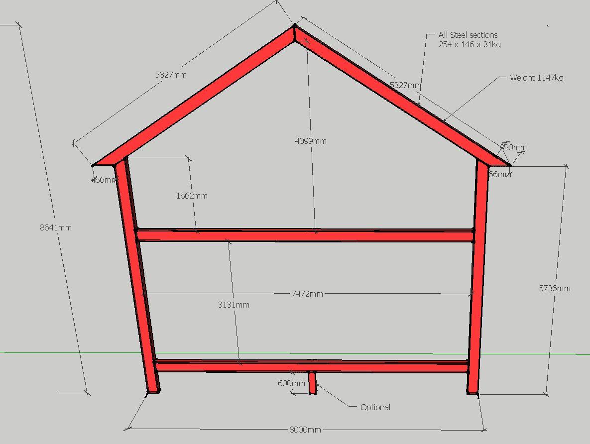

I have seen a few threads on here regarding converting existing portal frames into houses. But none on building with a new one like the barnhaus concept.
Would it be a issue getting a house like this to meet building regulations?
It looks like a huge saving in foundation cost.
A steel portal frame would cost less than my quotes for feature trusses.

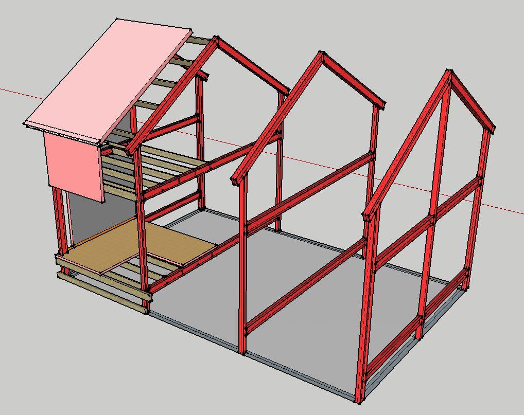

This is the sort of design we are planning to use. I cannot see an issue with building regs as this is how many new offices are built.
What were the concerns you had about the regs?
Link to comment
Share on other sites

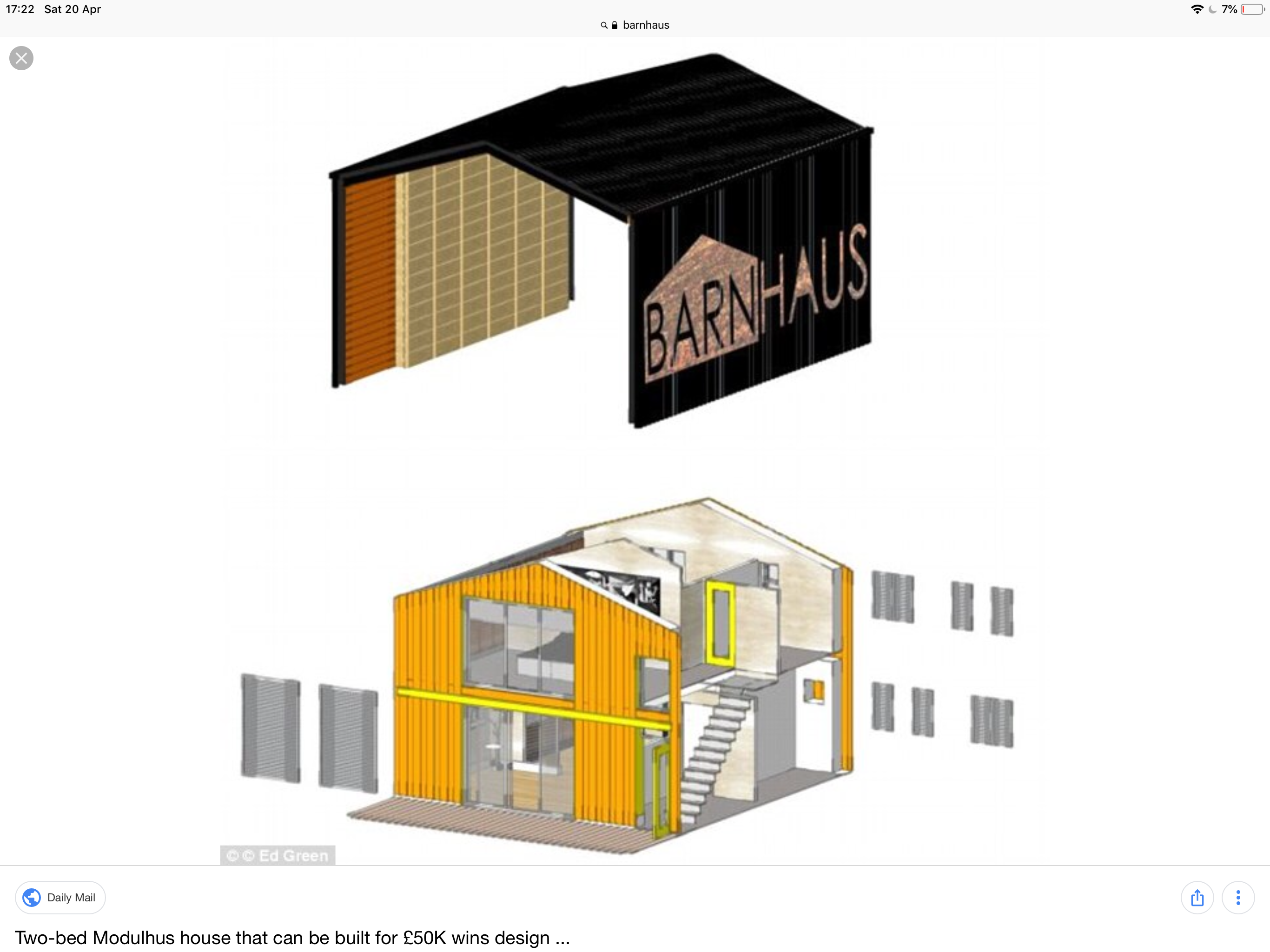

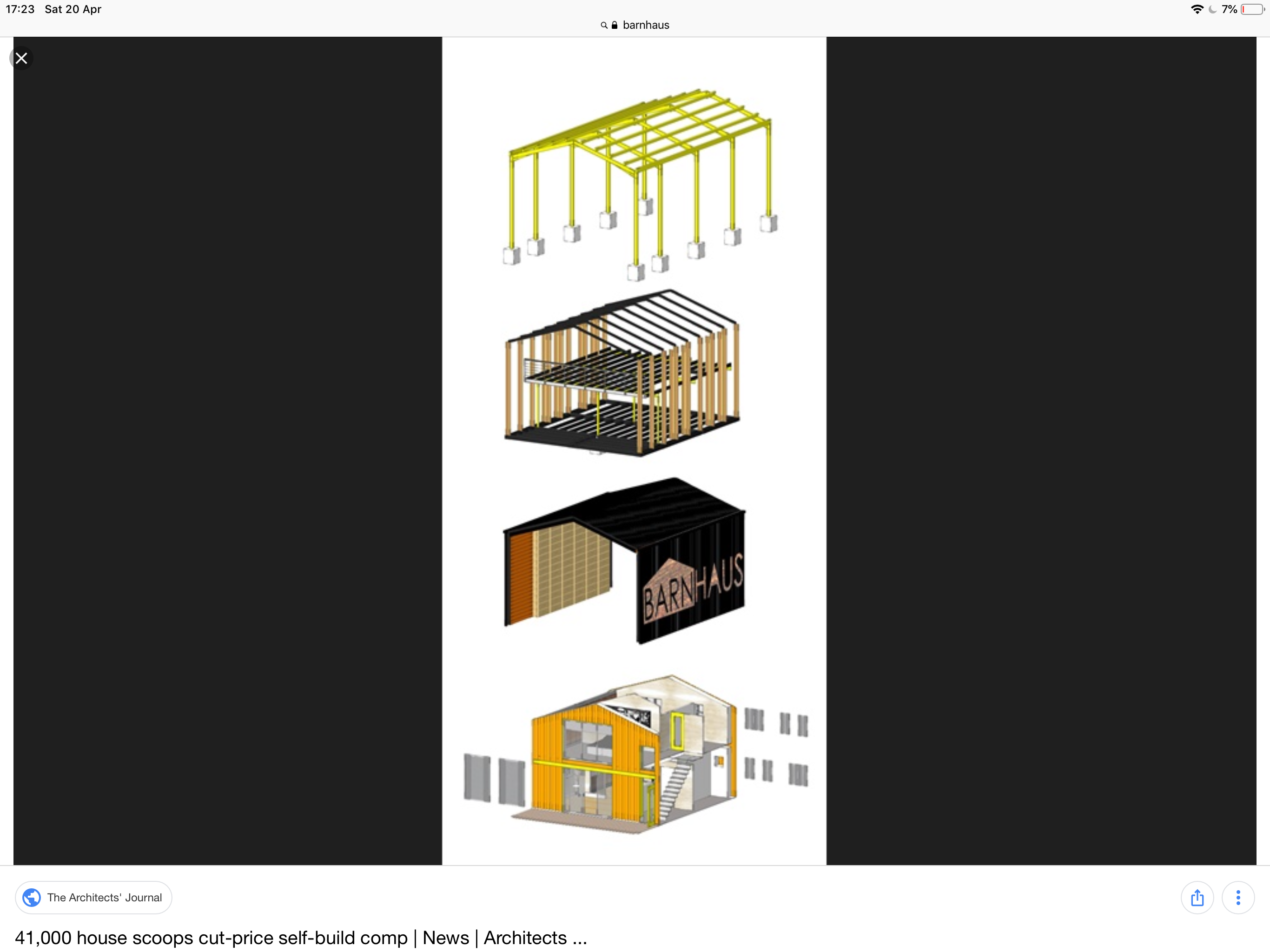

We are building with a new hot-rolled steel frame like this, though technically it is as a part of a 'conversion'. Frame supplier is one that usually builds barns and sheds.
AFAIK there is no inherant building regs issue with a hot rolled steel frame and loads of buildings of all kinds are made this way, though it will need all steel protected from fire e.g. by being enclosed or intumesent painted.
The Barnhaus is an interesting concept to provoke discussion, and I think in general these kinds of building methods should be more widely considered for residential, however I'm skeptical about the barnhaus pricing and some of the details. I'm not clear whether the specific design has been ok'd from a structural, insulation, or longevity perspective. The steels are whopping thermal bridges which might lead to condensation problems, and the combination of straw and steel seems dubious and a gimmick. It's unclear how they'd planned to insulate the roof. Better I would have thought to have the insulation layer on the exterior e.g. via standard insulating sandwich panels like the Kingspan KS1000RW (which we are using).

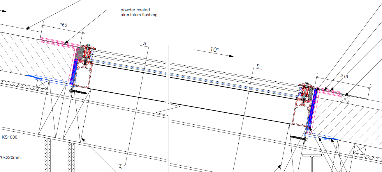

Putting opening rooflights in seems to be an issue, all the panel manufacturers are very resistant to that (although this place has two already installed!

You are correct about opening roof lights. No one likes them in the industry, but you can do them and if you are doing that I have a contact who is pretty much the best of the best at fixing and sealing them, so happy to pass details if you need.
That's very helpful thanks, though I think now we mentally switched to the KS1000 DLTR 0.8s we will probably stick with them. We only need light not ventilation. The plan wasn't for regular opening rooflights but for a 1x20m strip of glass roof set above a long corridor. The plan was to use lamilux PR60 glass roof set into the panels for this, but
a) expensive
b) lots of teeth sucking about how to fit it. There was a solution but no-one was confident (see below)
c) big solar gain problem that can't easily be mitigated
So we're instead planning on using 6 or so KS1000 DLTR 0.8 panels. You really can't see through them, but they are much cheaper and easier to fit, and have a diffuse light without as much solar gain.

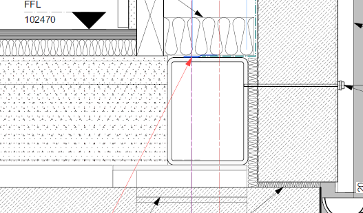

Thinking about using a steel portal frame for my build. I see you mentioned thermal brakes to prevent heat transfer into the steel within the building. Have you got as far as getting a price quote for the thermal brakes. Trying to get a cost per column for my costings sheet. Cheers

Hello, only just got initial costing for these. Expensive. Estimated price is £7,000 for about 24 x 50mm thick armatherm FRR pads. So £350 per pad. Seems *quite* a lot. This was an estimated price from the steel frame supplier. Our building is unusual in that it has so many, so would be less of a cost in something more a normal shape.
Link to comment
That is expensive, i was looking at the Armatherm 500 product for the thermal break in a concrete block wall, and got a direct quote from Armadillo (01274 591115) yesterday for 100m length total.
2000mm x 100mm x 50mm Blanks of  500-160 - £20 per unit + VAT
2000mm x 100mm x 50mm Blanks of  500-250 - £30 per unit + VAT
I can't see how 50mm FRR pads is that much more expensive, i would contact Armadillo directly

Im a newby, attracted by my search for information on Steel Portal Frame for residential use.
I am a retired Carpenter/joiner and looking for a way to build a live/work (Hobby use)  property for my remaining 40 years.
I loved the idea of 4 or 5 Steel portal frames at 8m wide and 3-4m spaced giving me 100m2 workshop+ 1st floor of same for living.
Quick to fabricate, minimum footing pads, quick erect + composite panels roof and walls.
Much like others here above I believe.
As a Carpenter I initialy looked at Timberframe but wanted an idea of Steelframe costs to compare.. and that is where I got stalled.. 10years ago..
As I had Sketchuped my simple designs.. I spent an hour showing it to a Technologist. He never got back to me and screened my calls.
Next.. an Architect & Engineer.. same again..  and then again... and again...
No one will talk to me...   and because they wont talk to me I have no idea.. Why???         Truly exasperating and I learned nothing..
I do still keep trying occasionally, changing my story each time a bit until it's almost total rubbish..
Perhaps, as is mentioned here, Portal Frame is considered only Agri or Commercial and..  well.. different folks for different strokes..
I've been turned away by Steel Fabricators (Show me your Drawings..) and Kit suppliers..  (Not for Residential use).. etc
It's been a couple of years in this thread so I am curious if any success has been had and what hoops had to be jumped through..  Particularly PDR in
Herefordshire and to enquire whether your services are for hire..
Thanks

Hello Marlin and welcome.
You'll get plenty help here.  There are a few folk that have joined since this thread was started. It's a guess, but some will be along shortly to contribute in terms of how you design this structurally for a domestic application and a few tips and hints on the insulation details and so on... and many more.
In terms of structural design the main difference between agricultural design and domestic design is the deflection limits you work with. In terms of detailing you have a bit more work to do to reduce cold bridging, detailing around the openings and damp proofing, all surmountable though. Think of it like an office building.. meets the same standards very much as a house requires in terms of environment and insulation.
Ok. To get you a bit further what about posting your sketches, make sure you dimension them; include the roof pitch,  show windows / doors and the heights you want internally, where you want the openings and how big you would like them to be. Also show the ground levels as this impacts on the column height down to the found as that is one key parameter when determining the steel section sizes. What kind of ground do you have, clay / chalk / rock etc.
If you want.. provide your location. You can give just the first part of your post code. Then we can see roughly where you are in the country. Also provide the site altitude and if close to the sea.. if next to a cliff or at the top of a long exposed hill let us know that and then we can get a handle on the wind and snow loading This will allow for example for folk to give you a rough steel size for the main portals and a ball park size / spacing for your steel purlins and wall rails.
There are many variants but you need to start somewhere! For your steelwork you can go the whole hog and work all this up to a full set of fabrication drawings, material and bolt list with numerical control files and then start farming that out to fabricators. All they need to then is to fabricate as they have no design input at that point. The numerical control files are a text file that is accepted by the software on most advance cutting and drilling set ups. Having these lets you go to big fabricators for a price too. But the NC files are not essential as most smaller fabricators just want a good set of drawings.
A good set of drawings comprises. General arrangement drawings. What are called assembly drawings.. these are drawings that show say beams with their end plates say and the weld information, a plate and shaft set of drawings. These are drawings of each individual plate and beam. Small fabricators may buy in the plates and shafts and make their money on the welding / painting/ supplying the bolts and so on.. again many variations on how you can go about this. Now that is a lot of drawings but we use software to do a lot of the heavy lifting and drawing production.
In terms of PDR the planners are interested in what it looks like from the outside rather than the skeleton of the building which is often covered?
Keep posting.. interested in your ideas.

Hi and thank you for your comments.
Hi Gus,
My initial design for this project was very vague.. intentionally..  thinking the Designer would manipulate it into whatever it needed to be for the
permissions.  I have a plot in mind but have not approached the landowner until I had some sort of Drawings to show..
I had assumed everything above ground could be designed and within reason be 'signed off' but if I chose a new location this would only affect the Foundation..
I do not intend to build in any kind of extreme environment..  Regular flat(ish) ground probably.. Clay..  Nothing weird..  Probably a knockdown..  In the South east.
I refer you to my middle comment..     I cannot find a Professional to do the Design work for me..
I am moderately competent with Basic Sketchup and have tinkered with other 2d CAD programs
or even Revit/Tekla but the learning curve is massive and assumes a knowledge level of Maths/formulaes I just do not possess.  I cannot design this myself and I had no idea
it would prove so difficult to employ somebody..
Saveasteading..  Are you in Construction.. Or the design side..        I am certainly interested in peoples experiences and choices/build details made (and indeed have my own list of preferences
which one day I hope to implement).
I dont know if Barnhaus succeeded as it was a 'Concept' contest I believe.. I think they are still going in Cardiff.

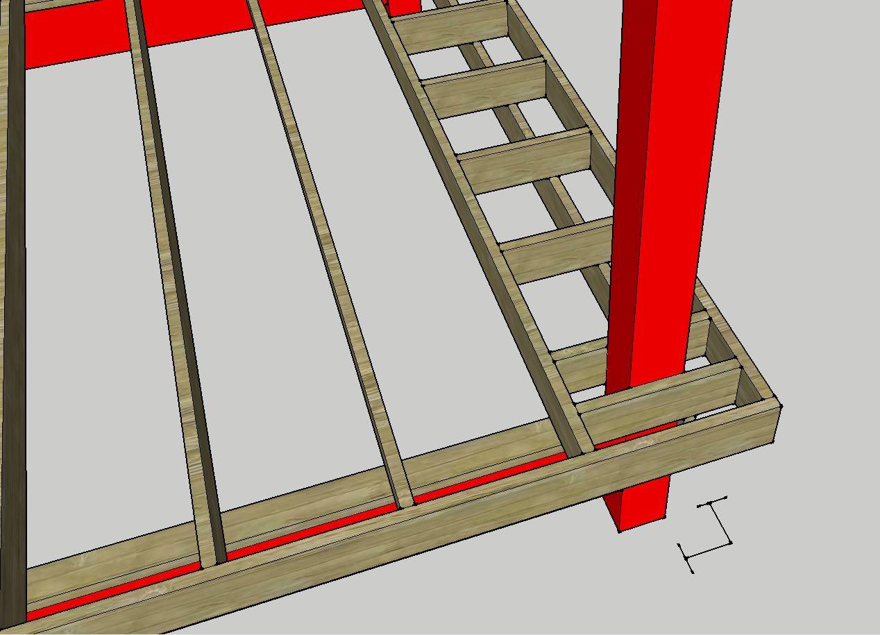

I'll try to attach some jpegs of my Portal Frame with my guesses at Steel sizes.  No particular consistency here..   Certainly beefier than Agricultural.
