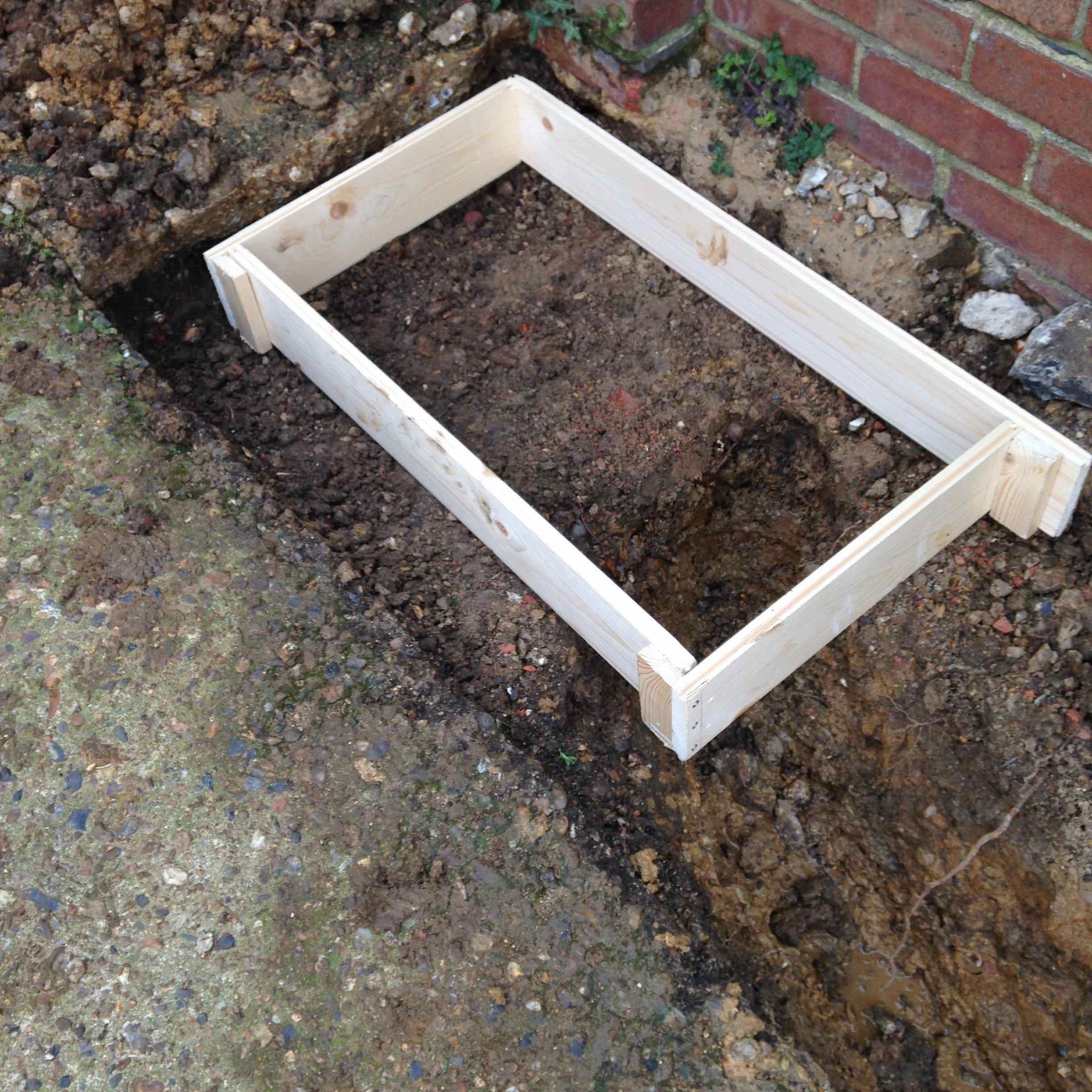

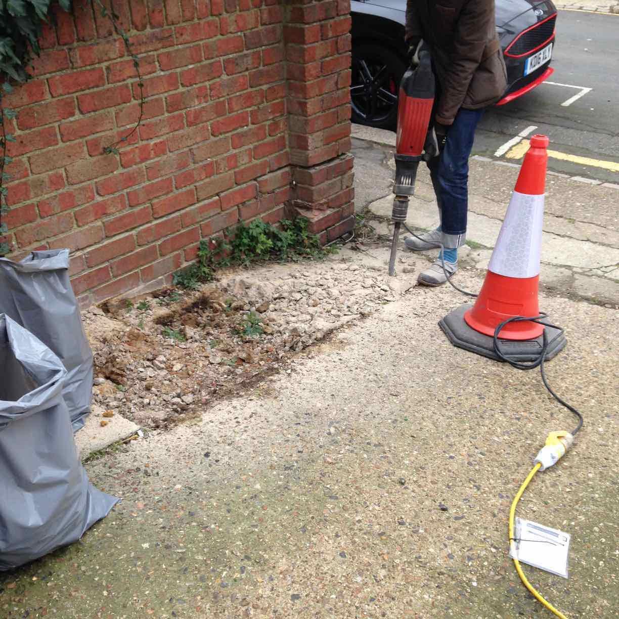

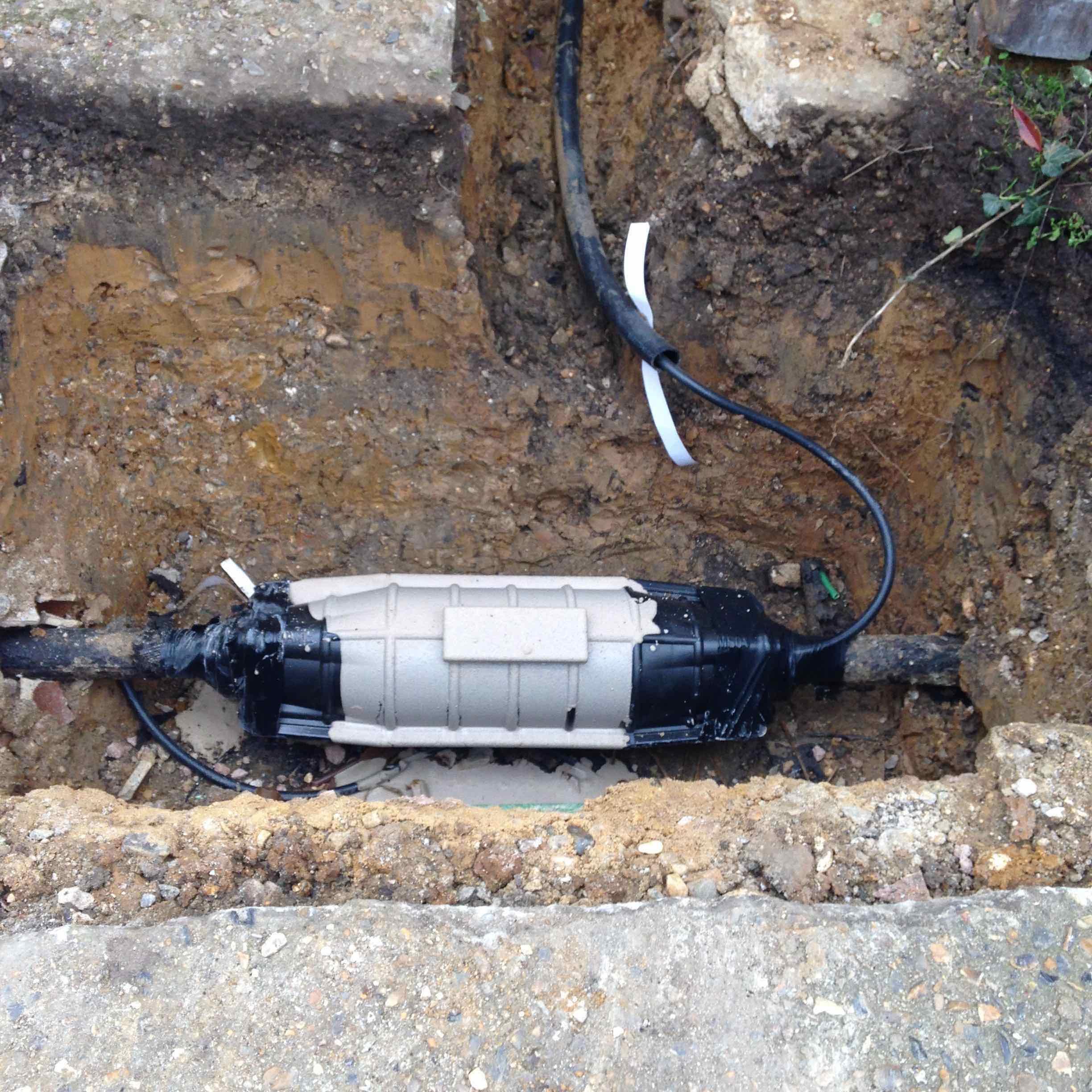

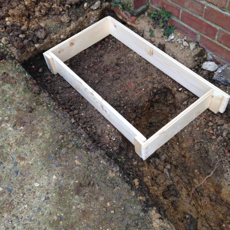

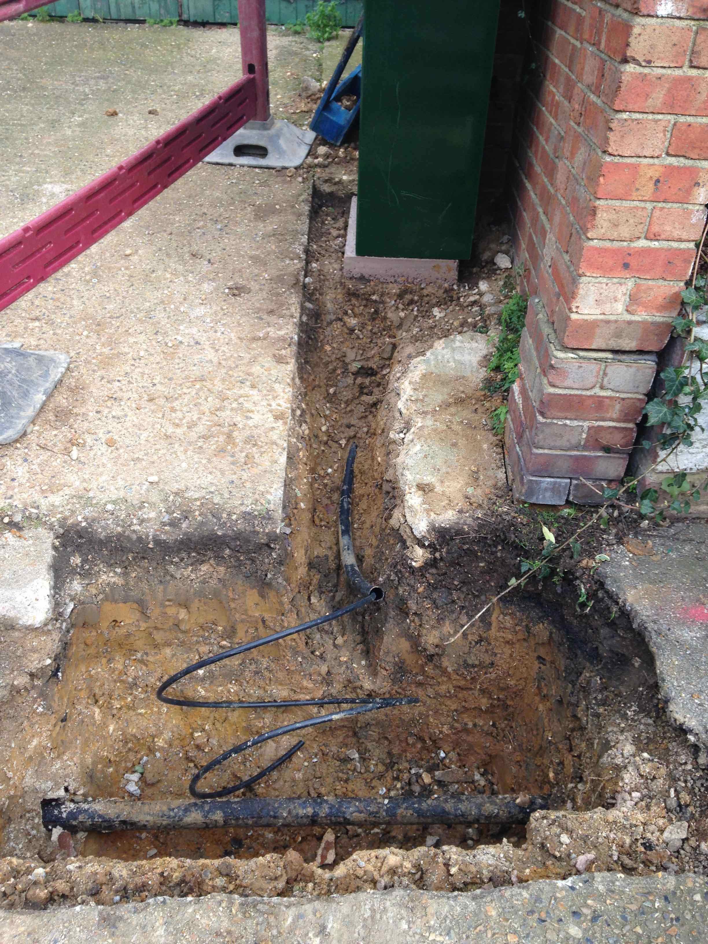

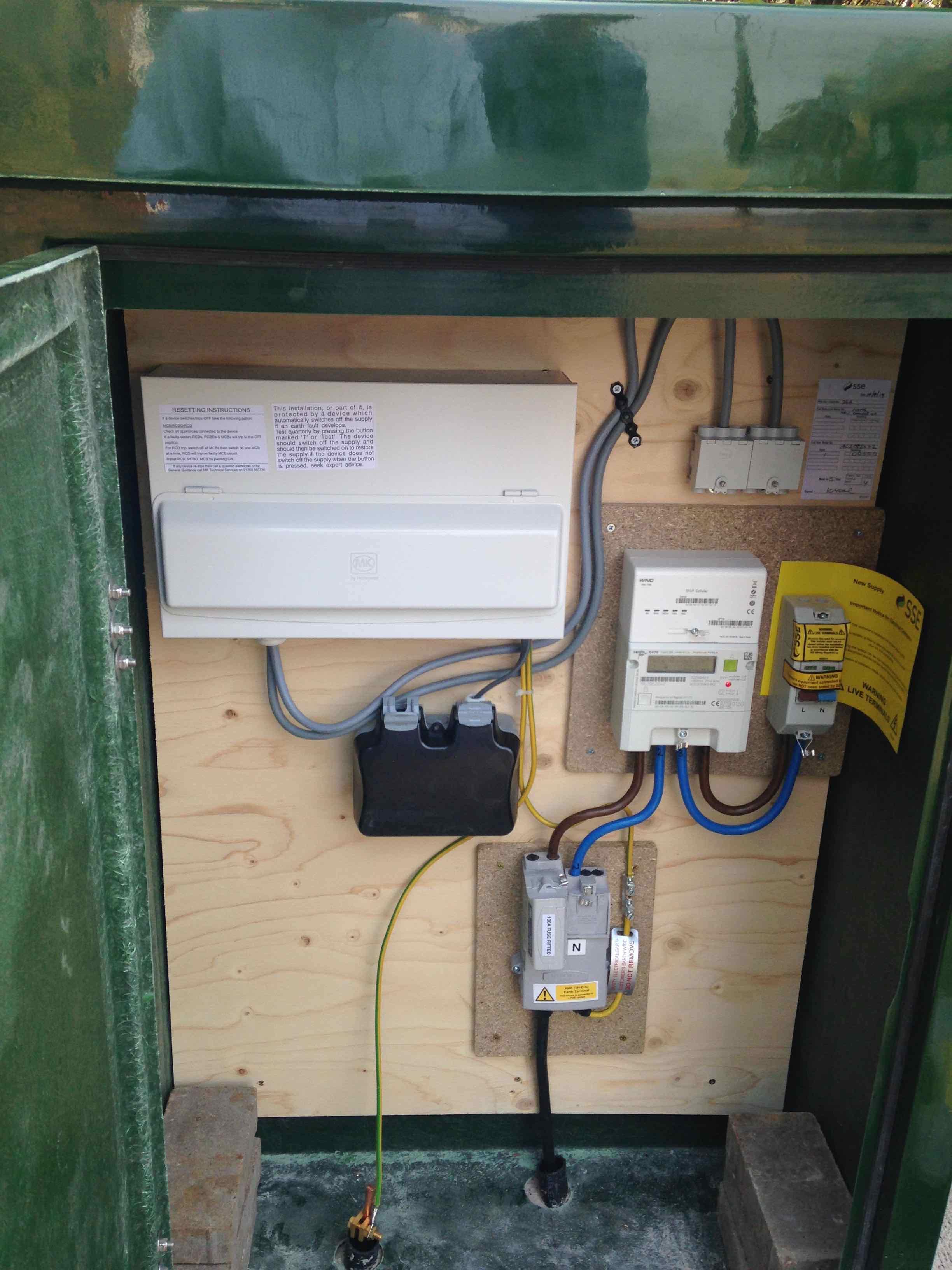

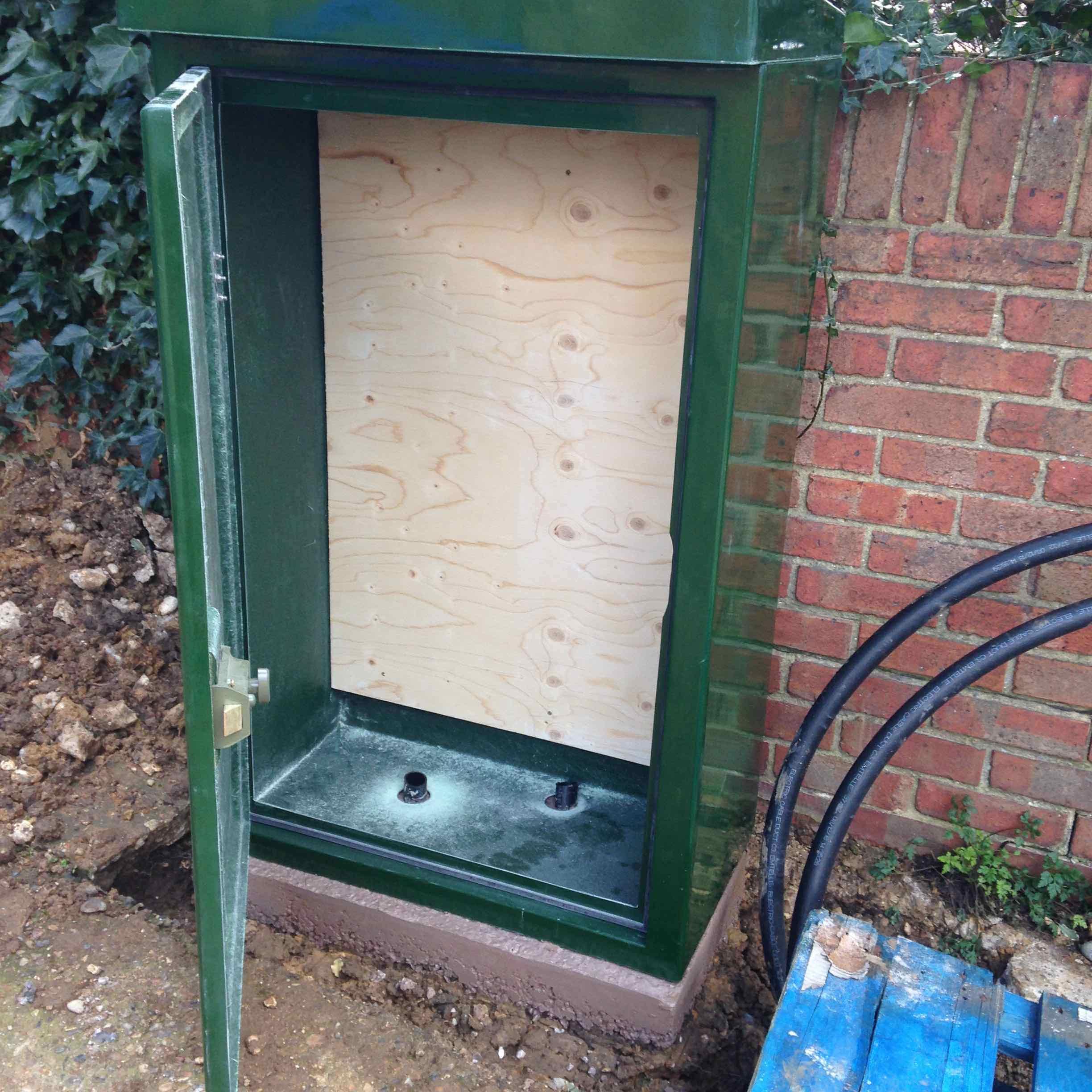

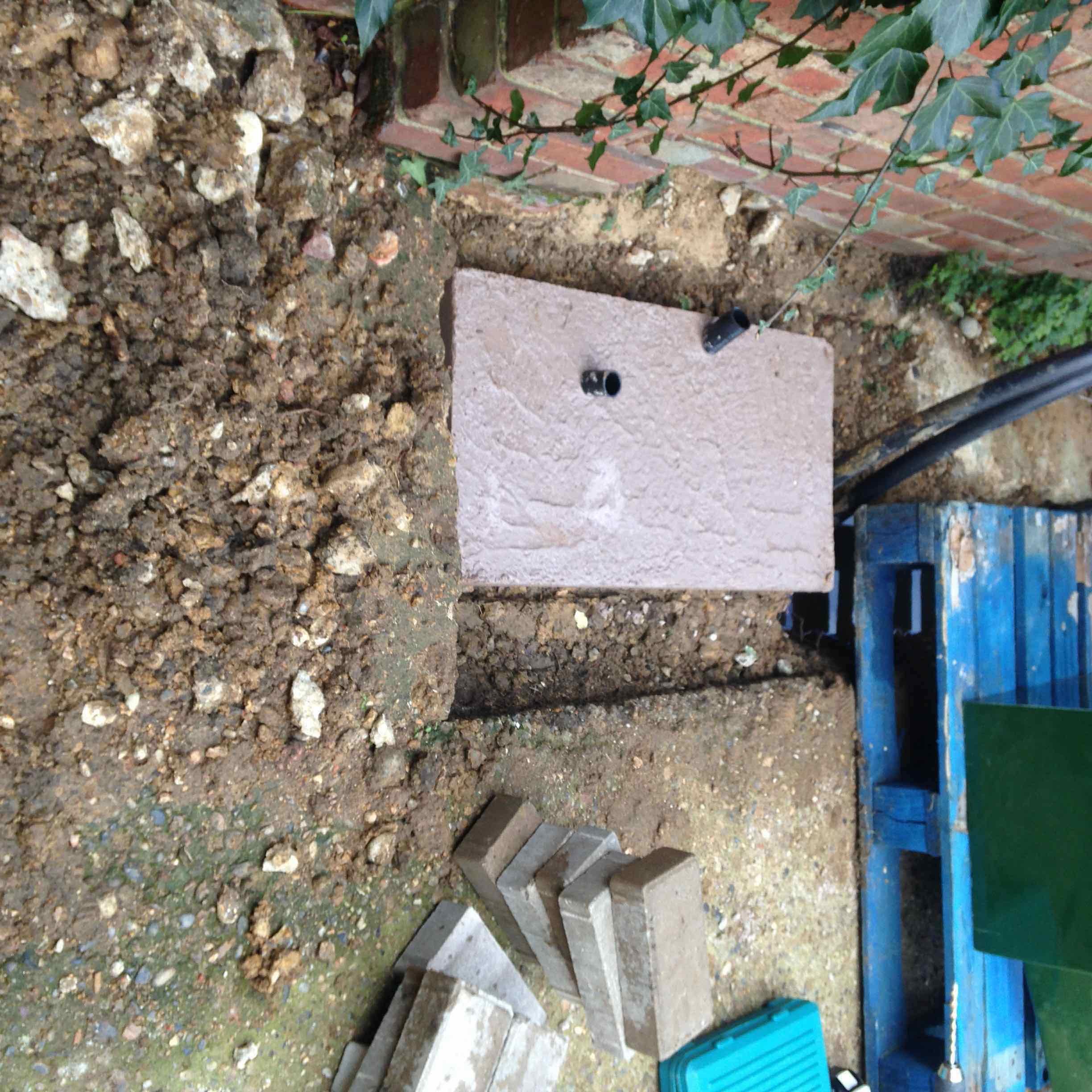

Tony C Posted April 17, 2019 Posted April 17, 2019 Hi, we have just installed temp builder supply with DNO UK power networks for the first step of our build! This is how it went and the cost explained. 1.UK power networks cost - £2257 to bring the electricity from the pavement. 2. DIY digging - breaking up the concrete with Hilti 1000 (bought from ebay £350, planning to sell again after the build). Hiring the generator to power Hilti £48. Digging the trench 600mm deep. 3. Made box for casting the concrete base - using cheap pine floor boards from selco. Place the pipe (supplied by DNO) for the connection (right), also the short pipe (left) so we can place the earthing rod through to the ground. Pore the concrete mix (ready mix type, 3 bags) and waited a day to set. Material for above £38 from selco. 4. Screwed down the GRP box bought from ebay (£320 + VAT, but we could sell this on ebay for £180, so the real cost would be £160) UK network specify larger GRP box than this, but they confirmed that this size (W750xD450xH1250) is fine. 5. DNO came and installed the power cable though. They came 3 times - day1= digging only. day2= make connection, day3= filling back and make concrete surface (including our side as well, kindly) 6. We got SSE to install the meter (free), and electrician to install the consumer box and a socket. (installation £250) Toolstation - MK consumer box £58, double socket £12 Screwfix – eatrhing rod £2.50 Screwfix - Earth Rod to Lug Clamp 3/8" £1.80 We have put large MK consumer unit as this will be moved to the house once it built. I would not recommend SSE, as they did not turn up twice and wasted our time...! They are now installing 2nd Gen smart meter, which is much better than 1st one, you can move supplier and smart meter would work with the new supplier. 2 1

epsilonGreedy Posted April 17, 2019 Posted April 17, 2019 2 hours ago, Tony C said: We have put large MK consumer unit as this will be moved to the house once it built. I wanted to do the same but the electrician said it would not be possible in a standard size meter cabinet sized to fit within a cavity wall.
ProDave Posted April 18, 2019 Posted April 18, 2019 10 hours ago, Tony C said: We have put large MK consumer unit as this will be moved to the house once it built. You do know you don't have to have the supply moved. You could do as many of us have, and leave the meter there, and just run your own cable from that box into the house. At those prices it will probably save you a lot of money. 1 1
Tony C Posted April 18, 2019 Author Posted April 18, 2019 Yes, it is expensive for the connection less than 1 m away. But not much we could do.... We thought about installing the supply where it will be going in the end, but logistic wise it was not possible. (The GPR would be on the access way, as we are building one house on the street front, one more house on the back of the site.)

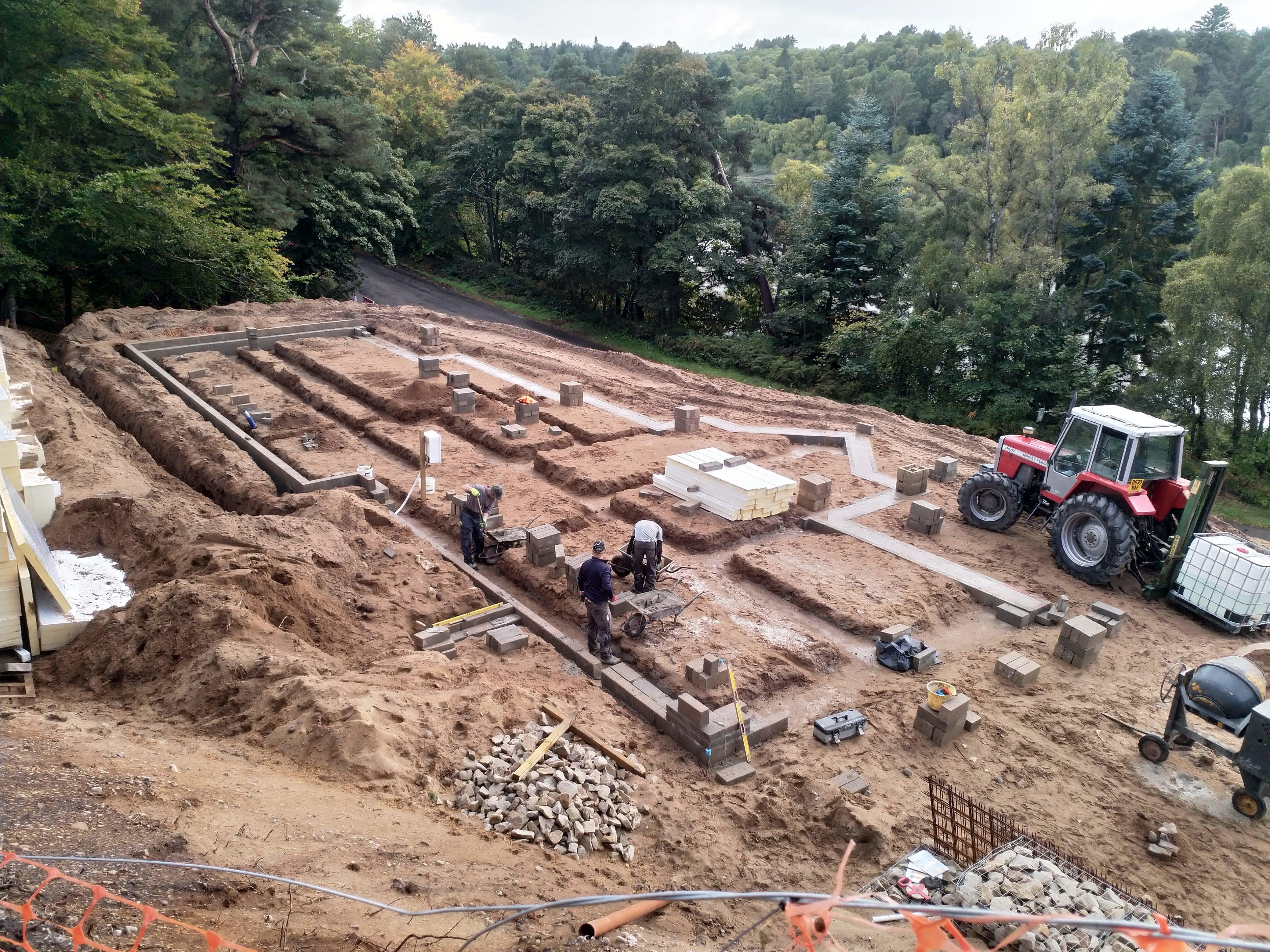

JohnMo Posted May 14, 2022 Posted May 14, 2022 This what I did. Had supply run to close to where I wanted it prior to digging foundation trenched. Temporarily buried cable. Completed the trench concrete pour. Had SSE connect to meter and screwed the whole lot on a wooden post inside the location of the hall cupboard where the meter would live. A double socket was added by electrician. White box by guy with yellow gloves. Second photo shows stub walls up and box still on post but now sat on the stub wall to allow next concrete pour. Bit of a faff but was ok.
