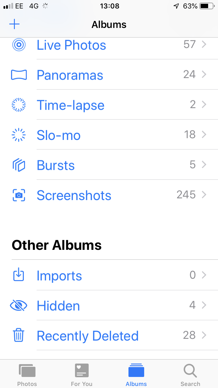

newhome Posted April 20, 2019 Posted April 20, 2019 15 minutes ago, Nickfromwales said: Need to see if there’s a way of recovering lost pics off iCloud. Gutted They should be in the ‘recently deleted’ album in iCloud (or on her iPad). 1

PeterW Posted April 20, 2019 Posted April 20, 2019 2 hours ago, Nickfromwales said: Need to see if there’s a way of recovering lost pics off iCloud. Gutted. Go to your pictures on your phone scroll down and you’ll see a folder marked recently deleted ... should still be in there 1
