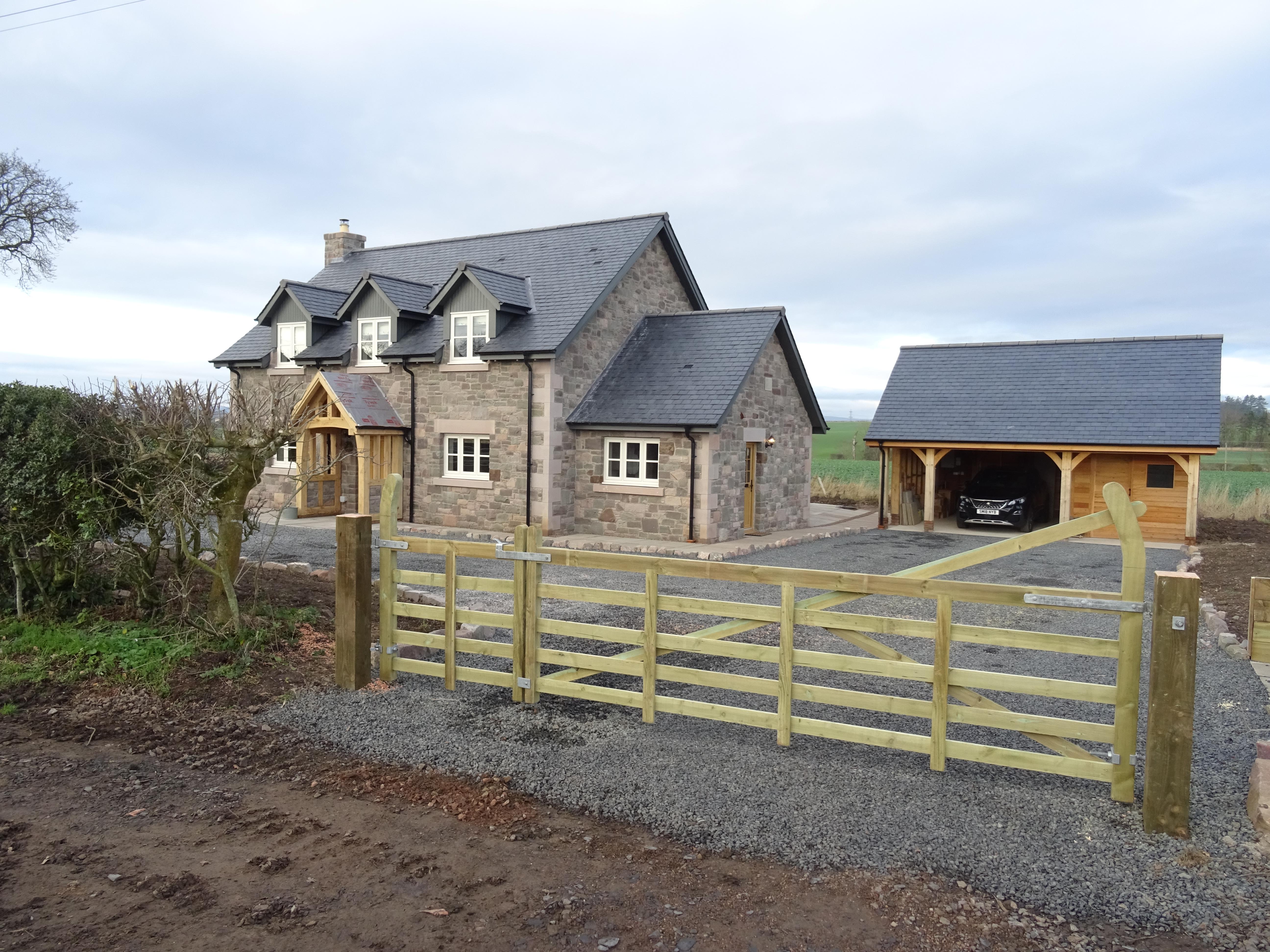

zoothorn Posted April 13, 2019 Share Posted April 13, 2019 Hi chaps- be great to get help on a "typical" wood driveway gates job (maybe oak if I can stretch). Doubles, with bracket looping over to join & a pole into a ground hole to fix @ the join..? And 60 / 40 bc my car can't go back far (ie the 40 on the RHS so I can just get my car in the spot below). This sort of basic thing at a quick glance.. https://www.huwsgray.co.uk/shop/sawn-tanalised-5-bar-field-gate.html Here's the vacancy. I'm not looking for 'the best type' neccessarily, more affordable.. but still need to be of decent quality. Thanks, zoot schmootser Link to comment Share on other sites More sharing options...

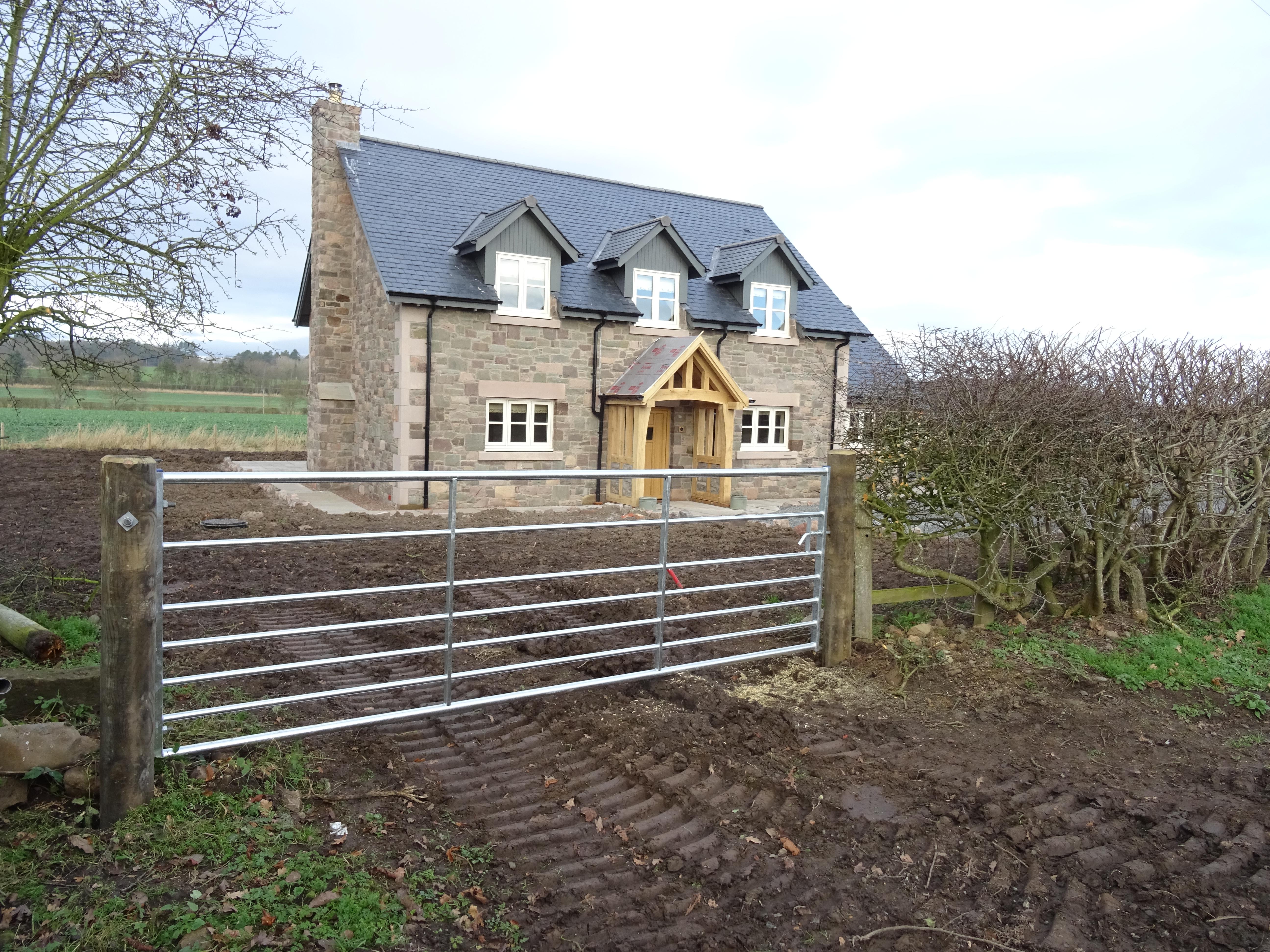

Ferdinand Posted April 13, 2019 Share Posted April 13, 2019 What are your constraints and budget? Looking at your setting, I would probably suggest a pair of farm pedestrian gates from an agricultural stockist would fit in well. Just been looking into it for a neighbour who is on a budget, and a pair of hunky-chunky (ie the bloke reversing into it will lose the damage war) metal hanging posts, plus a pair of 5ft metal farm gates, comes in at under £200 including VAT for 5 bar gates, or about £250 including VAT for wooden ones from my usual stockist. Because they are likely to have a range of sizes you can probably do your 60:40. Link to comment Share on other sites More sharing options...

Ferdinand Posted April 14, 2019 Share Posted April 14, 2019 (edited) (From the other thread, with a bonus bit.) What are your constraints and budget? Looking at your setting, I would probably suggest a pair of farm pedestrian gates from an agricultural stockist would fit in well. Just been looking into it for a neighbour who is on a budget, and a pair of hunky-chunky (ie the bloke reversing into it will lose the damage war) metal hanging posts, plus a pair of 5ft metal farm gates, comes in at under £200 including VAT for 5 bar gates, or about £250 including VAT for wooden ones from my usual stockist. Agree with Peter on posts - my supplier does metal or wooden, and the metal ones come in 3.5" or 4", and are about 8-9ft when they arrive, and I normally set them 24-28" into the ground. They survive anything smaller than a hit from a 4 or 6-wheeler. Your link has a good range of sizes so you can probably do your 60:40, or whatever you want. The thing that would need to be sorted here is mountings for wooden gates on the posts, and some form of fastening in the middle. In my experience, metal ones come with mounting kits. For wooden they tend to be extra as you need a thing like a hairpin which attaches to the horizontals in the gate and to the posts. I have used normal galvanised farm gates, sometimes Hammerite-d for years, and they work perfectly for appearance even within a mixed residential street. In a village setting with those informal hedge you can do whatever you want. They should last 25-30 years without a tremor. Two things to watch are that agricultural places are unlikely to deliver (bung somebody £20 if you need), and you need to make sure they cannot swing out into the road. My best choice would be go galvanised, and possibly paint them. I tend to avoid painting them for the same reason I avoid painting walls ... the one thing you can guarantee is that they will need painting again at some future time; Ockham says no. F Edited April 14, 2019 by Ferdinand Link to comment Share on other sites More sharing options...

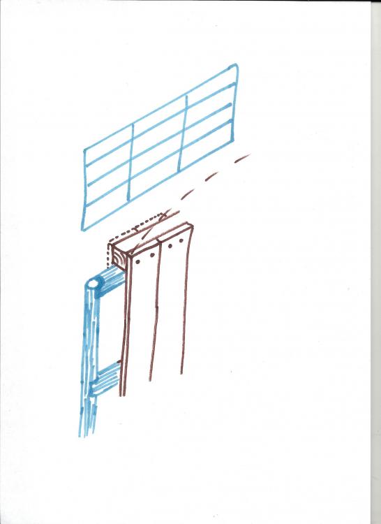

zoothorn Posted April 14, 2019 Author Share Posted April 14, 2019 Morning chaps- many thanks for the replies & information. Onoff those dragon gates!! (I'm getting a bigger picture of you now- & you get a smaller picture of me in rtn <). they look distinctly california US ott, so not thinking your back door gates! One other thing crops up, due to another invasion of privacy here y'day/ 2 n'bors waltzing thru entry area ^.. suddenly appearing whilst Im in garden & Im fed up with it.. so want a bit more 'barrier' now to my gates, but, not full Onoff look. Just maybe an extra bar like a 6-bar gate, & make to posts a bit bigger to hold. I'm going into all places tmrw (prolly only 2 most) to see what's available. Budget? let say £350 maybe? I'm not quite getting the 'clad-the-galvanised-gate' idea, Ive never seen or heard of this. Any eg's? thanks zoot schmoot. Link to comment Share on other sites More sharing options...

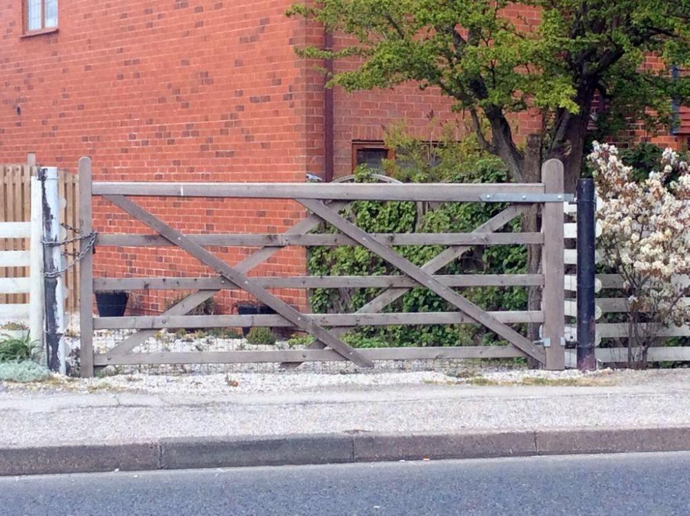

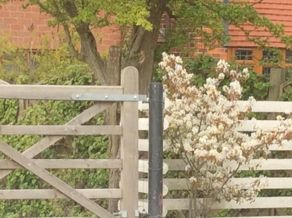

Gone West Posted April 14, 2019 Share Posted April 14, 2019 These are our gates when we put them in a few years ago. They are from Jacksons Fencing. Link to comment Share on other sites More sharing options...

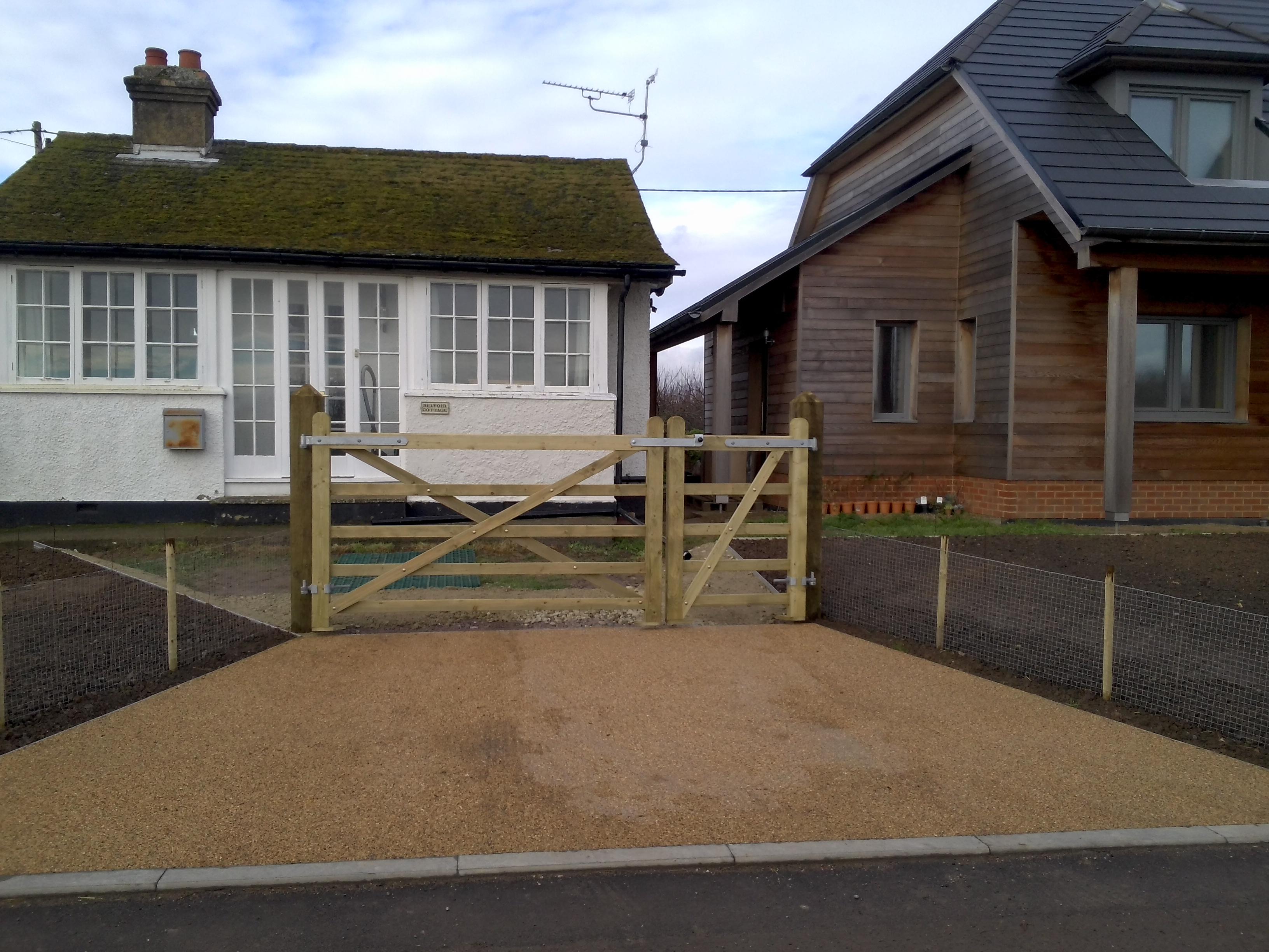

Redoctober Posted April 14, 2019 Share Posted April 14, 2019 32 minutes ago, zoothorn said: Budget? let say £350 maybe? You will do well to get a wooden type gate on that budget unless of course you intend to fit them yourself, I would suggest. As mentioned above, try and source a local supplier. I paid £710 for both these gates to be supplied and fitted. [Jan 2019]. He supplies all the local farms in the area. Link to comment Share on other sites More sharing options...

zoothorn Posted April 14, 2019 Author Share Posted April 14, 2019 (edited) @Redoctober those look splendid as does your fine abode- lovely! And a great reference point cheers. Yes the idea is me to fit them.. saving ~approx £350 on your fine job there (as a guess let's say/ my '60' section not as looong). And I do like your bendy edge verticals: is the idea here the RHS one needed for structure/ extra bracing.. & the LHS one on the small side there solely to match the look of RHS one (rather than functional)? @Onoff I can't believe the lengths you go to- amazing, incredibly ambitious project that. Just a mite out of reach for me perhaps! Edited April 14, 2019 by zoothorn Link to comment Share on other sites More sharing options...

Redoctober Posted April 14, 2019 Share Posted April 14, 2019 5 hours ago, zoothorn said: @Redoctober those look splendid as does your fine abode- lovely! And a great reference point cheers. And I do like your bendy edge verticals: is the idea here the RHS one needed for structure/ extra bracing.. & the LHS one on the small side there solely to match the look of RHS one (rather than functional)? Thanks, I think the look is called Yeoman Gates and you are right - the LHS gate has a curve to tie in with the RHS. Nothing more. Link to comment Share on other sites More sharing options...

zoothorn Posted April 14, 2019 Author Share Posted April 14, 2019 8 hours ago, PeterStarck said: These are our gates when we put them in a few years ago. They are from Jacksons Fencing. Those look great too & pretty much my size. Is that "60/40"? and what distance between your posts? Link to comment Share on other sites More sharing options...
Gone West Posted April 14, 2019 Share Posted April 14, 2019 1 hour ago, zoothorn said: Those look great too & pretty much my size. Is that "60/40"? and what distance between your posts? IIRC they are 0.9m and 2.1m. We bought the posts, hinges etc from Jackson as well. https://www.jacksons-fencing.co.uk/fencing/entrance-gates/traditional Link to comment Share on other sites More sharing options...
