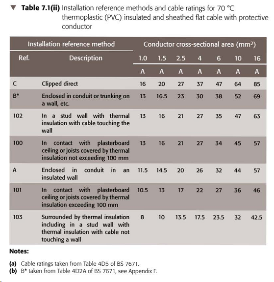

Nelliekins Posted May 4, 2019 Share Posted May 4, 2019 We have approx 1200m of LSZH twin and earth installed in our ICF build. Costs a chunk extra, to be sure - first, because its roughly 30% more expensive to buy 6242b cable than the same thickness of the usual grey 6242y cable; second because you're embedding the cable in insulation, you have to derate the cable. That means you end up running radials and rings in 4mm2 cable instead of 2.5mm2. Here's an idea of the hell I am in with cabling... That will one day be a home automation system, with DMX controlled lighting and power circuits, and either Loxone or Unipi managing it all. For now, it's just my nightmare that comes true every time I visit site. ? 1 Link to comment Share on other sites More sharing options...

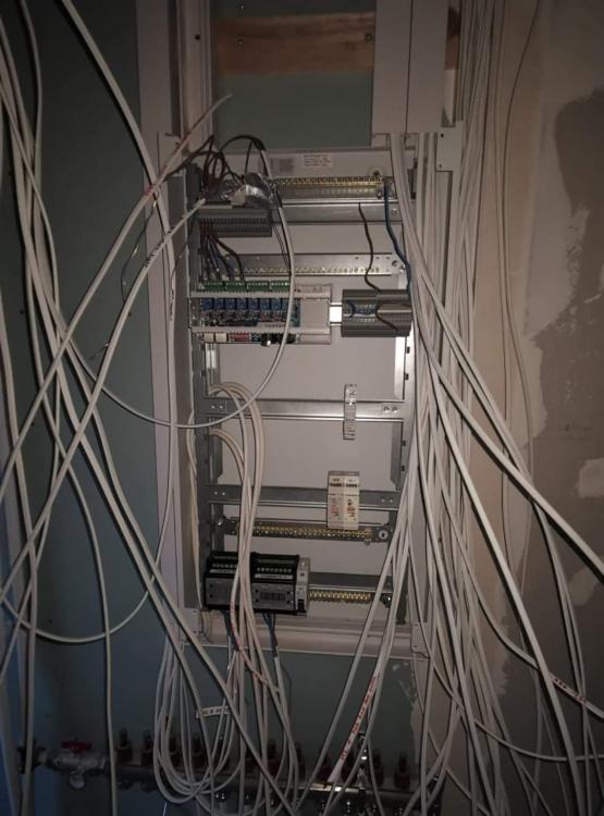

Nelliekins Posted May 6, 2019 Share Posted May 6, 2019 On 05/05/2019 at 09:09, scottishjohn said: @Nelliekins maybe it would end being cheaper to run std cable in ducting ? as well as making it easy to pull another cable later you didn't think you would need? that picture looks like a good reason to use ducting,at least part of the way to make it neat and tidy @scottishjohn if you look carefully you will see there is 50x50 trunking already installed all around the cabinet. Where it's needed I have installed it. As for running cable in conduit, you still have to put the conduit somewhere. If that "somewhere" is in the EPS then it will still derate the cable, albeit not quite as badly. From recollection (I don't have the 7671 guide at home, cos it's living at site at the mo) clipped direct gives 27A limit, in conduit in EPS would give 18.5A or thereabouts (although some argue that the derating isn't valid if you're talking about conduit that is also touching the plasterboard, the regs don't give a firm steer either way so I play safe). Besides which, the lifetime of the mains cable for sockets (which is all that I am chasing into the EPS anyway) is probably longer than my remaining years on this planet, and sockets don't tend to need additional cables pulled ? 1 Link to comment Share on other sites More sharing options...
Jeremy Harris Posted May 6, 2019 Share Posted May 6, 2019 5 minutes ago, Nelliekins said: @scottishjohn if you look carefully you will see there is 50x50 trunking already installed all around the cabinet. Where it's needed I have installed it. As for running cable in conduit, you still have to put the conduit somewhere. If that "somewhere" is in the EPS then it will still derate the cable, albeit not quite as badly. From recollection (I don't have the 7671 guide at home, cos it's living at site at the mo) clipped direct gives 27A limit, in conduit in EPS would give 18.5A or thereabouts (although some argue that the derating isn't valid if you're talking about conduit that is also touching the plasterboard, the regs don't give a firm steer either way so I play safe). Besides which, the lifetime of the mains cable for sockets (which is all that I am chasing into the EPS anyway) is probably longer than my remaining years on this planet, and sockets don't tend to need additional cables pulled ? Snapshot of the rating table from the OSG for the 18th: 1 Link to comment Share on other sites More sharing options...

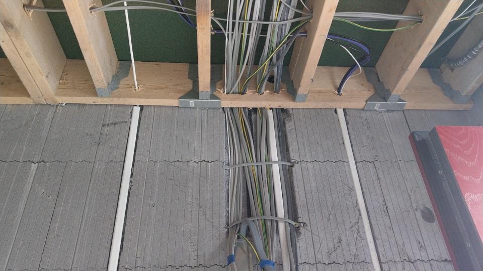

magnethead Posted May 5, 2020 Author Share Posted May 5, 2020 Is this a bad idea, or should the tops of the wire be protected too? Electricians first time with ICF, reckons it'll be fine of course Is that Inch of exposed wire going to explode in the long term? Should I be wrapping some foil tape around the tops of every one of these? These have yet to get their 20mm wavin pipe, but I imagine it'll be up to the same level as the picture above Thanks Link to comment Share on other sites More sharing options...
