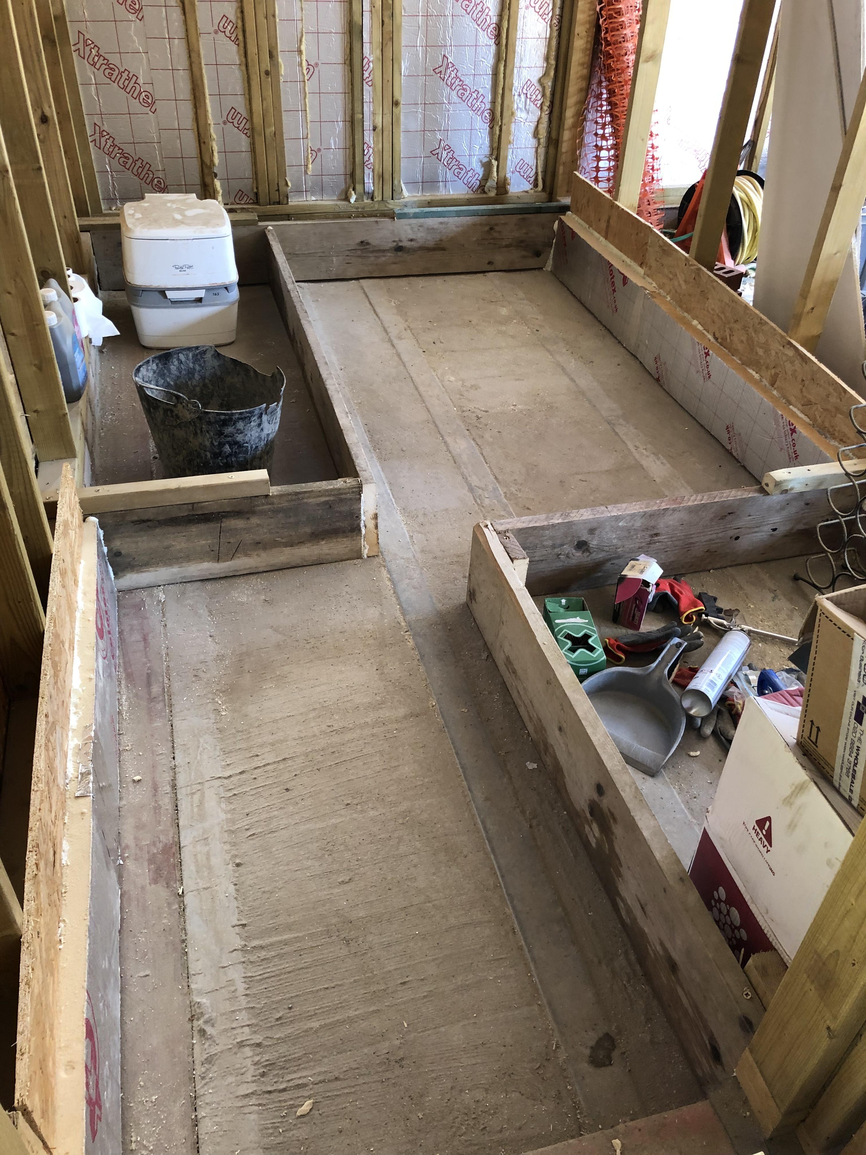

Pocster Posted April 11, 2019 Author Posted April 11, 2019 So here’s the bathroom At far end shuttered section for inner timber frame for hidden cistern Directly in front where Porto loo is - the bath section . To the right shower tray area Plan is ufh and screed only go in the other area . So cistern , bath , shower dealt with at a later date ( like years from now ? ) Bit like brexit tbh ?

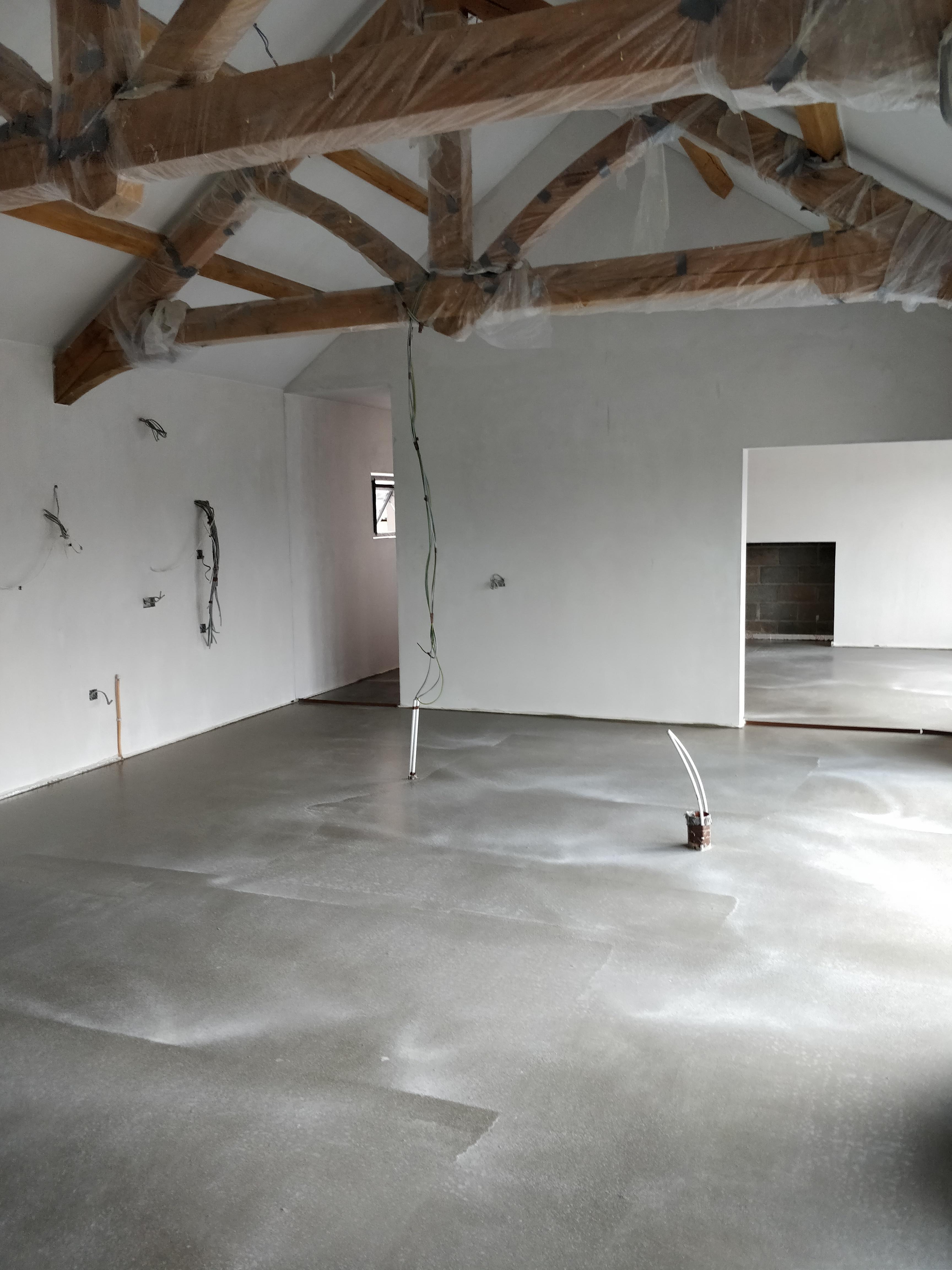

Pocster Posted April 11, 2019 Author Posted April 11, 2019 47 minutes ago, Mr Punter said: @pocster if you have the depth you could get a sand / cement screed laid at 75mm which could work out cheaper and will take tiles without needing to prime or clean. Yeah I’m not sure what I should have to be honest . i was allowing 150mm insulation 50/60mm screed and ufh Then 20mm ( ish ) for tile and adhesive I also assumed a liquid self levelling screed . Screeder looking tomorrow see what he says ?
vfrdave Posted April 15, 2019 Posted April 15, 2019 On 11/04/2019 at 15:14, pocster said: I also assumed a liquid self levelling screed Cemfloor if you can get it over there is a great job. Had mine done last Thurs. 1
Pocster Posted April 16, 2019 Author Posted April 16, 2019 Well ! screeders been He said sand and cement barrowed in ! ? I assumed he would suggest liquid screed like everyone uses in grand design . Apparently liquid screed material cost is naturally more expensive and isn’t as level as people think ! He was implying that the labour is cheaper than the material therefore use cheap materials ! what do we all think ? . He also said sand and cement screed has to be at least 60mm with ufh to avoid tikes cracking
Pocster Posted April 16, 2019 Author Posted April 16, 2019 Costs in materials and labour 130m sq sand cement £2200 60mm Liquid £2400 50mm Thoughts ???

Mr Punter Posted April 16, 2019 Posted April 16, 2019 If they are good I would have sand cement. I thought 70mm was standard, not 60mm. Does it have fibres?
Pocster Posted April 16, 2019 Author Posted April 16, 2019 2 minutes ago, Mr Punter said: If they are good I would have sand cement. I thought 70mm was standard, not 60mm. Does it have fibres? No idea about fibres - i’ll Ask . Why would you choose sand / cement over liquid @Mr Punter ?
Mr Punter Posted April 16, 2019 Posted April 16, 2019 (edited) 5 minutes ago, pocster said: No idea about fibres - i’ll Ask . Why would you choose sand / cement over liquid @Mr Punter ? You don't need to do any prep before you tile it and if the screeder is good it is smooth and flat enough to lay any flooring (LVT etc) whereas sometimes you can get little ripples and bubbles with liquid. https://www.ukscreedsltd.co.uk/preparing-liquid-screed-floor-tiling/ Edited April 16, 2019 by Mr Punter 1
Pocster Posted April 16, 2019 Author Posted April 16, 2019 7 minutes ago, Mr Punter said: If they are good I would have sand cement. I thought 70mm was standard, not 60mm. Does it have fibres? Just googled screed depth and got a variety of answers .... It’s unbonded and we will assume fibres in it .
