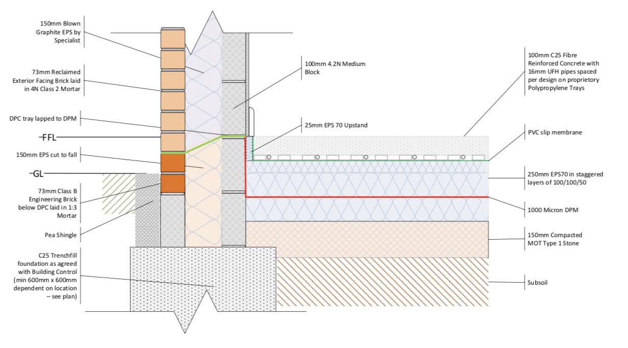

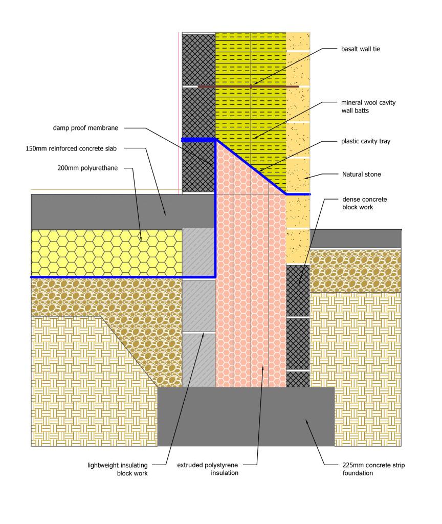

MarkyP Posted April 1, 2019 Share Posted April 1, 2019 (edited) Or chat your BCO and see if they will agree to dispense with the lean fill altogether. In my case ours was fine and I used 150mm eps to full fill the cavity below the tray formed by the dpm down to top of the footing. If I recall the leanfill detail is to prevent high loads from vehicles or high earth build up from pushing the block/brickwork and collapsing into the cavity. I think it's a bit of a belt and braces old fashioned detail unless there really is a build up of earth or risk of crushing. In our case the soil was 150mm above footing, sometimes less. Insulating to top of footings will improve the thermal performance of the wall by extending the heat loss path of the inner leaf. Edited April 1, 2019 by MarkyP Link to comment Share on other sites More sharing options...
joe90 Posted April 1, 2019 Share Posted April 1, 2019 (edited) I too had insulation right down to the strip foundation, it was part of the insulation buildup to alleviate a cold bridge. I forget the name of the house that I copied this from on the internet but here is a drawing I supplied the BCO and they passed it with no question. Edited April 1, 2019 by joe90 1 Link to comment Share on other sites More sharing options...
MarkyP Posted April 1, 2019 Share Posted April 1, 2019 I think I got the idea from the Denby Dale passive houses. Mine looks exactly like your picture, albeit with a lower external ground level. Link to comment Share on other sites More sharing options...
Cambs Posted April 1, 2019 Share Posted April 1, 2019 4 minutes ago, joe90 said: I too had insulation right down to the strip foundation, it was part of the insulation buildup to alleviate a cold bridge. I forget the name of the house that I copied this from on the internet but here is a drawing I supplied the BCO and they passed it with no question. Golcar passivhaus by Green Building Store, methinks.... they have some good case studies and information on their site under the ”Free Resources” tab https://www.greenbuildingstore.co.uk/golcar-passivhaus-ground-floor-foundations/ Link to comment Share on other sites More sharing options...
PeterW Posted April 1, 2019 Share Posted April 1, 2019 Done exactly the same as @MarkyP and @joe90 but used 120mm EPS with 20-30mm of weak mortar down the brick face side as the bricks are reclaims so getting a perfect 150mm cavity was near impossible. Link to comment Share on other sites More sharing options...

joe90 Posted April 2, 2019 Share Posted April 2, 2019 We had two damp courses!!!, one as per the above diagram but on the internal wall at floor level (which meant it was below ground level on the outside wall), the second was just in the outside wall level with the internal floor level. The reason fir this is my builder, who has done as per the above diagram, found the internal plaster cracked at the damp course level internally which was above the skirting board, by lowering it and providing a second DPC this problem was sorted. Link to comment Share on other sites More sharing options...
epsilonGreedy Posted April 2, 2019 Author Share Posted April 2, 2019 16 hours ago, joe90 said: here is a drawing I supplied the BCO and they passed it with no question. Did you use basalt wall ties as per the diagram? Link to comment Share on other sites More sharing options...
PeterW Posted April 2, 2019 Share Posted April 2, 2019 Detail from a previous submission here Not sure why wall ties are shown in the Denby Dale one unless they used it for SAP calcs also. Link to comment Share on other sites More sharing options...
PeterW Posted April 2, 2019 Share Posted April 2, 2019 And the insulation under the slab was changed to 150mm PIR on 25mm EPS. Link to comment Share on other sites More sharing options...
Simplysimon Posted April 2, 2019 Share Posted April 2, 2019 i'm surprised at these well insulated floor/wall sections, yet they all show no thermal break in the inner leaf. 3 hours ago, PeterW said: Not sure why wall ties are shown in the Denby Dale one unless they used it for SAP calcs also. are you saying they are now building two single leafs and not using ties or is it just the basalt ones? Link to comment Share on other sites More sharing options...
joe90 Posted April 2, 2019 Share Posted April 2, 2019 3 hours ago, epsilonGreedy said: Did you use basalt wall ties as per the diagram? No, someone did some sums for me and the thermal bridge was very small and in my opinion not worth the expensive price of basalt ties. I spent the money on more insulation in the roof ? 1 Link to comment Share on other sites More sharing options...

PeterW Posted April 3, 2019 Share Posted April 3, 2019 14 hours ago, Simplysimon said: . are you saying they are now building two single leafs and not using ties or is it just the basalt ones? Sorry wasn’t clear - I meant it’s unusual to see them in section drawings, they are normally in the notes section. Link to comment Share on other sites More sharing options...
