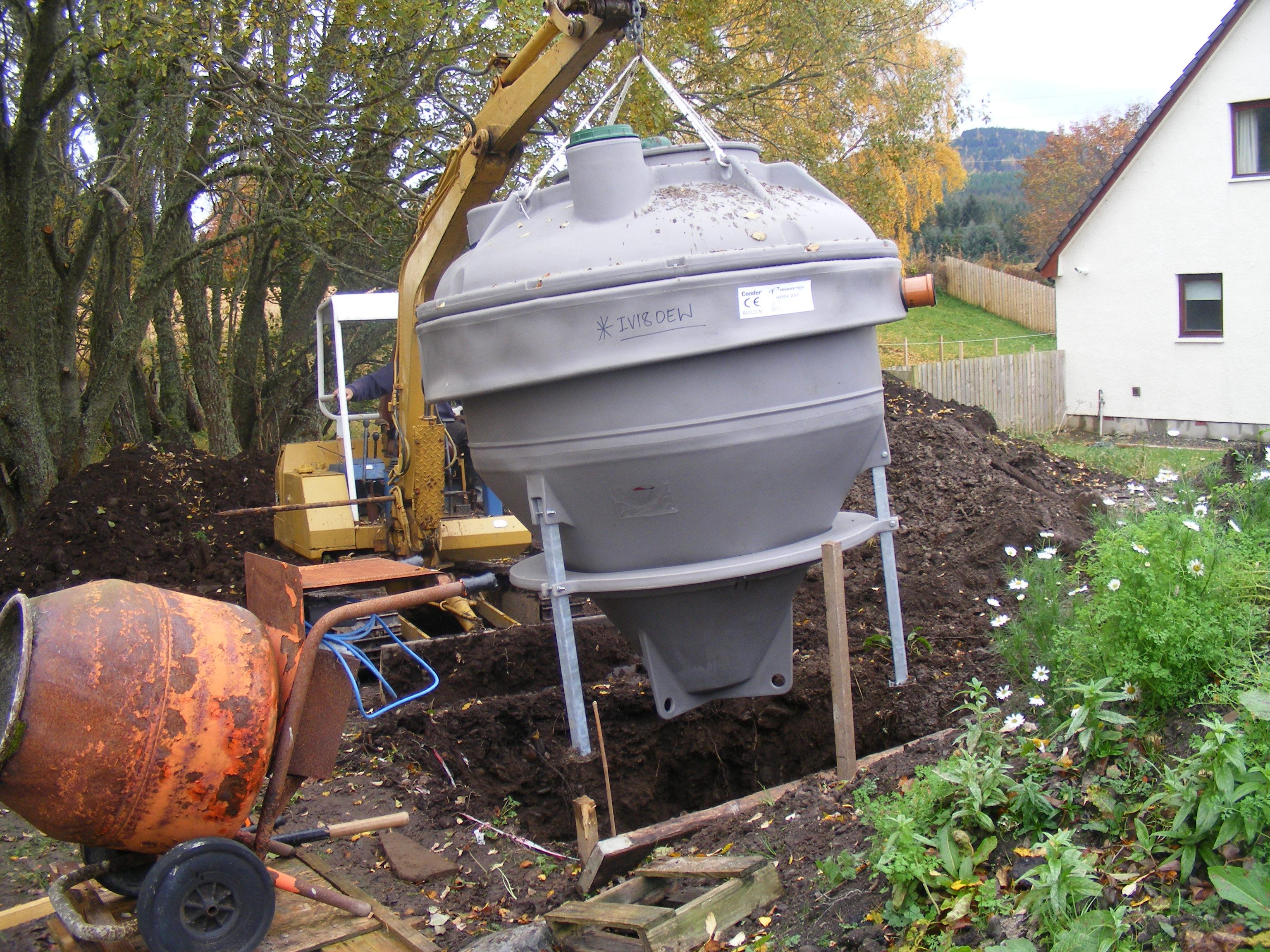

ProDave Posted March 31, 2019 Share Posted March 31, 2019 21 hours ago, Sue B said: We looked at sewage treatment works and have got down to 2 contenders Bio Pure or a concrete one that will solve issues with our high water table. I have not heard of the concrete one. Any details? I imagine the extra weight makes install a little harder? We went for the Conder, concreted into it's hole because of our high water table. Very similar to the Biopure and also based on the air blower principle Link to comment Share on other sites More sharing options...
ProDave Posted March 31, 2019 Share Posted March 31, 2019 9 hours ago, Sue B said: Peter loves the concrete one but we just can’t find the bit of paper with the prices that we wrote on. It won’t require any concrete to hold it in place which we have to add to the BioPure to compare cost properly (to stop the bobbing bouy scenario). It also needs a pumping station because of the high water table and the slight incline out to where the discharge pipe will end which comes neatly in the biopure pumped version. I would go for the Biopure one but he will be digging the hole so more discussions to be had yet. Look at the Conder as well, I chose that because it is slightly easier to concrete in than the Biopure. I think that is also available with an inbuilt pumping system. Re the floatation issue. That is only an issue when you have it pumped out. In normal use it remains full of "stuff". At our last house we were badly advised and that has a septic tank set in pea gravel. That is okay as long as you only ever get it pumped out in summer after a long dry spell when the water table is low, and them immediately refill it with water. That has been done like that every 2 years without problem. Link to comment Share on other sites More sharing options...
Sue B Posted March 31, 2019 Share Posted March 31, 2019 http://treatment-tanks.com/product/waste-water-treatment-tanks-england-wales-uk/ We have sent an email asking for the price again. The price is a supplied price - they come with a crane to get it on site. Gravel underneath to get it level and back fill with what came out. It is a big beastie. The salesman hasn't had his emptied in 4 years apparently FWIW. Link to comment Share on other sites More sharing options...
Sue B Posted March 31, 2019 Share Posted March 31, 2019 Is the Conder easier because it has "legs" to stabilise it while pouring the concrete in so that the concrete holds it in place lower down? Does that mean the hole has to be bigger as the BioPure hole is smaller at the bottom and steps up looking at the pretty pictures? Link to comment Share on other sites More sharing options...
ProDave Posted March 31, 2019 Share Posted March 31, 2019 The Conder has legs, and a "ring" round the bottom. When in the hole, you have to concrete it up to at least the level of that ring to anchor it down. Link to comment Share on other sites More sharing options...
