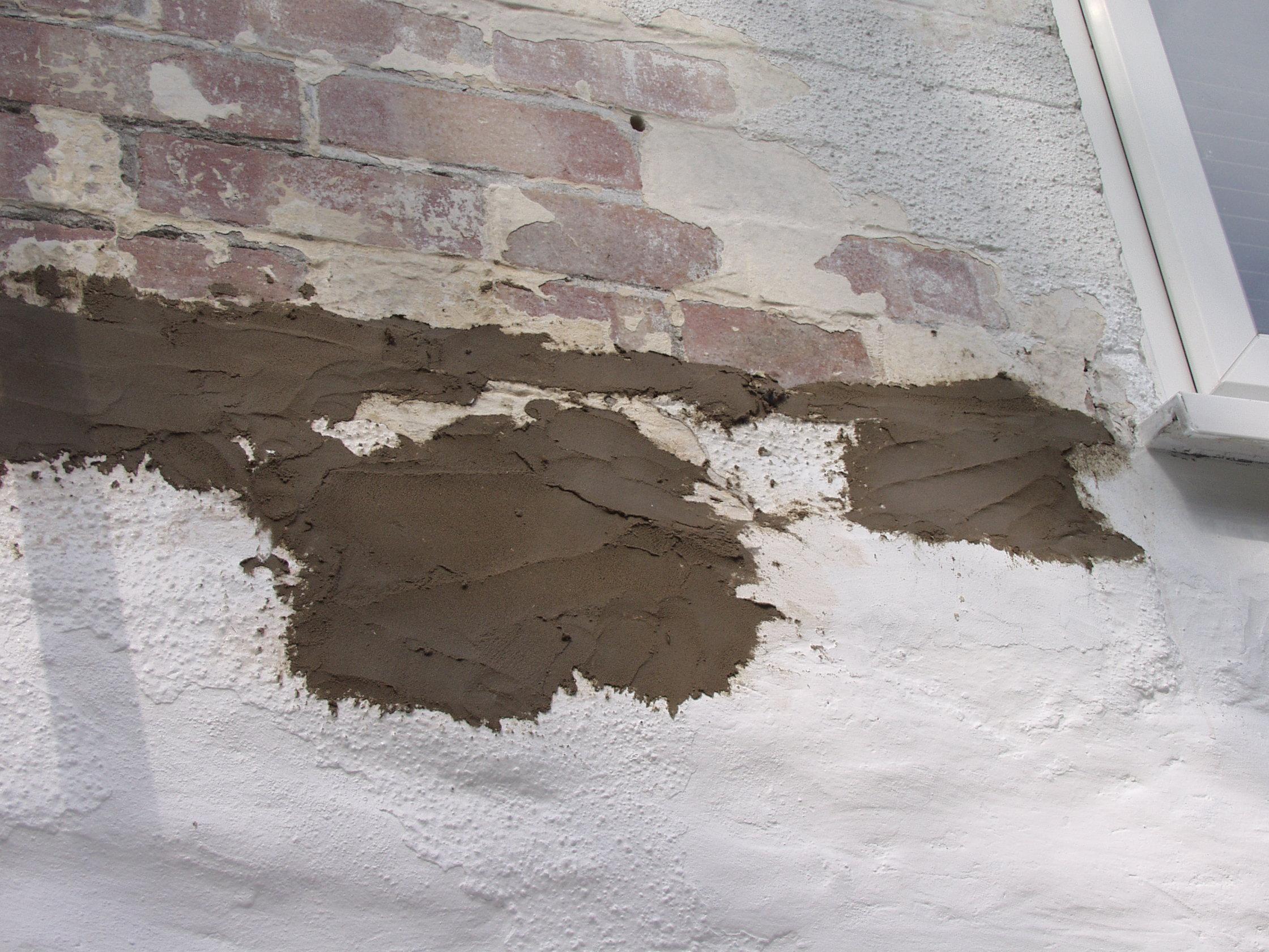

Declan52 Posted March 31, 2019 Posted March 31, 2019 10 minutes ago, zoothorn said: Onoff.. Ive whacked on the mix: I found very tricky to A) get right consistancy/ still no idea or confidence here (slightly slid off trowel.. when it stuck only a tad of movement 45*,, it just felt way too dry) B) didn't seem to adhere well, half fell out C) i just cannot do 2 coats (Im WAY up a ladder/ for me its high, & at edge of wall wind coming in).. so just has to be one coat.. for safety if anything. Ok so I can see it going off slightly, but its got trowel marks over, even smoothing off as best I can. Its not appalling, but it aint good.. & marks will be clearly visible once masonry painted. So Id like to get smoother. Can you please just refresh me as tp what I can do now, to smooth it, & when to do so. You have to let it sit. It won't go smooth with a float until it has dried out a tad. How long you wait will depend on how much water is in your mix plus how warm it is and wind all help in speeding up the drying out.

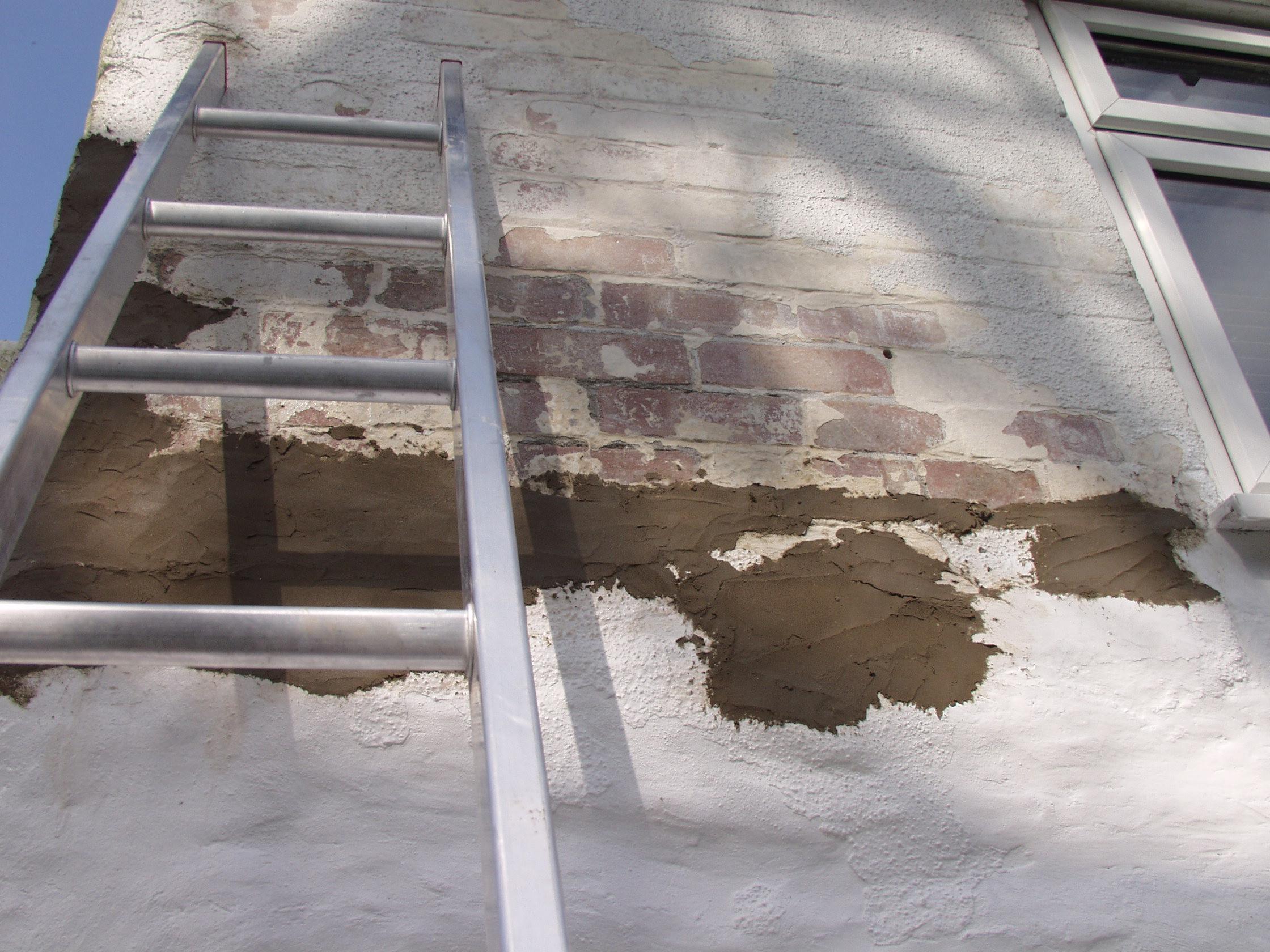

zoothorn Posted March 31, 2019 Author Posted March 31, 2019 Thanks all for replies Declan, nod, newhome, PeterW, Onoff et al.. I'm a bit ashamed to show results after the help, apologies! its not great, but best I can do up my ladder one handed. If I can smooth it, it might pass as just acceptable & stay on for a while. A tough lesson this for me, a D+ only. Ive got to figure out this consistancy thing as I don't know what's going on.. scrap tests on a free day.

zoothorn Posted March 31, 2019 Author Posted March 31, 2019 4 minutes ago, Declan52 said: You have to let it sit. It won't go smooth with a float until it has dried out a tad. How long you wait will depend on how much water is in your mix plus how warm it is and wind all help in speeding up the drying out. I couldn't use a float, just a trowel (one with the rounded tip, not the pointy ones) so had to try & smooth thus far inch by inch. Its contoured/ not a smooth flat surface, this would be nigh on impossible for me to acheive, so it goes in & out where the brick faces had badly dmgd ~3cm in. Its got sun on at the mo, & a dry wind too.. shall I spray water on to stop it drying too fast? seems like its drying quick.

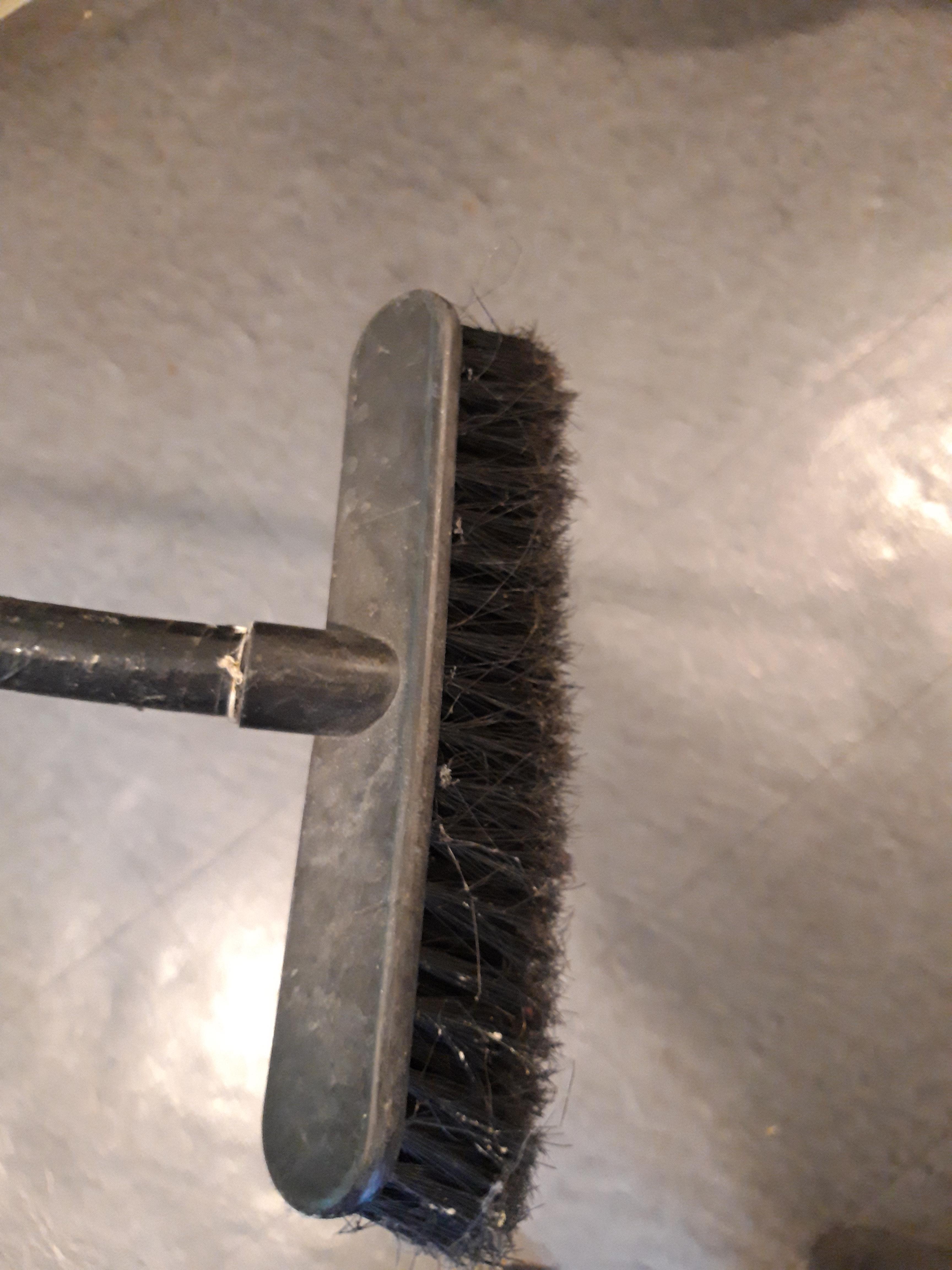

PeterW Posted March 31, 2019 Posted March 31, 2019 So keep damping it with a big wide paint brush. If you haven’t got one then an ordinary soft sweeping brush will do, and it will help smooth it off too. Slow, damp not wet, and very little pressure ..!!!
jfb Posted March 31, 2019 Posted March 31, 2019 a slightly damp sponge can smooth off a lot of the ridges - just have to catch it when there is still some movement in the render but not too soft.
Declan52 Posted March 31, 2019 Posted March 31, 2019 22 minutes ago, zoothorn said: I couldn't use a float, just a trowel (one with the rounded tip, not the pointy ones) so had to try & smooth thus far inch by inch. Its contoured/ not a smooth flat surface, this would be nigh on impossible for me to acheive, so it goes in & out where the brick faces had badly dmgd ~3cm in. Its got sun on at the mo, & a dry wind too.. shall I spray water on to stop it drying too fast? seems like its drying quick. The float is easier to use. Like grand master mister miyagi you do the wax on wax off movement. Don't apply much pressure. Your just touching it and Polish it up. When you say trowel with a rounded top are you using a gauging trowel?? https://www.screwfix.com/p/forge-steel-gauging-trowel-7/1191c

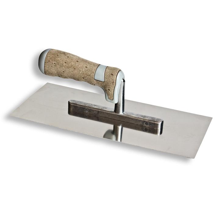

Onoff Posted March 31, 2019 Posted March 31, 2019 Totally the wrong trowel I'm afraid! This sort, the type you use for plaster is what you what. The action of using it to apply also pushes the render into the bricks and helps it stay there. A cheap 11" long one would do you. Fwiw your attempt looks the right colour and that it's staying there at least. You can use a small offcut of timber just big enough that you can hold with outstretched fingers...say square beer mat size to gently rub over the surface of the patch of render once it's gone off. If the wood takes the render off then its not yet dry enough to "buff". I've even used a bit of tile batten on occasion. Another trick as above is to unscrew the head off a cheap plastic broom and sort of brush it all in when slightly gone off.
zoothorn Posted March 31, 2019 Author Posted March 31, 2019 All understood Onoff.. but really its the only one I could use, up there on the ladder, doing all with one hand: the bigger flat trowel I couldn't get into the tub anyway & 2 hands needed: not safe. Its far from a pro job this ever going to be: its contoured below the brick upper floor, so getting it flat never was the plan- I just need it to stick, get into the cracks & gaps, which my curved point trowel was ideal for. I just couldn't use a corner of that big one to force into my tricky in-outs. Its like my chopsaw for my pine forraged 5" dia logs: on paper wrong tool yes sure, but in practise actually -the- perfect tool for the job. thanks alot.

Onoff Posted March 31, 2019 Posted March 31, 2019 That picture with the ladder against the wall... Is it rendered up so far then some sort of textured paint above? What's the plan for the exposed brick areas, just repaint?
