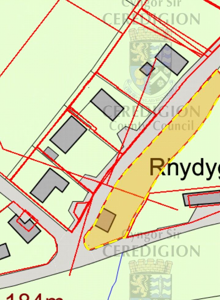

newhome Posted March 28, 2019 Share Posted March 28, 2019 10 hours ago, zoothorn said: I was wondering if I could add a photo of my area in Q, & someone could help. Many of the 'boxes' I can tick though.. like adjacent to house, floor area are ok. Yes, post a photo as it’s too hard to envisage without. Was the plan that @PeterW posted on the other thread your house? If so post it here too and show where you want the workshop to go. Link to comment Share on other sites More sharing options...
PeterW Posted March 28, 2019 Share Posted March 28, 2019 6 minutes ago, newhome said: Yes, post a photo as it’s too hard to envisage without. Was the plan that @PeterW posted on the other thread your house? If so post it here too and show where you want the workshop to go. Yep @zoothorn isn’t this the area ..?? from what I can work out, you have planning permission to put a box on the top end of that shaded box in the bottom end. You can pretty much put anything you want in the area that has the red/yellow dotted outline. Shed / garage / workshop is fine, keep 2m from the boundary and keep the ridge below 3m. Up to 30sqm you don’t need planning or building regs. 1 Link to comment Share on other sites More sharing options...

zoothorn Posted March 28, 2019 Author Share Posted March 28, 2019 Morning guys- @PeterW great help! yes that's my yellow sausage (& I'm alot more endowed there too). Right, now down at the 'balls' end, I've got PP for an extention. Why not put it up along my shaft?! I hear you say spitting rice krispies over your keypoard.. well bc I've an 80's extention/ kitchen, then lawn.. then shaft to tip is very tricky ~unstable area (45* slope across). Link to comment Share on other sites More sharing options...

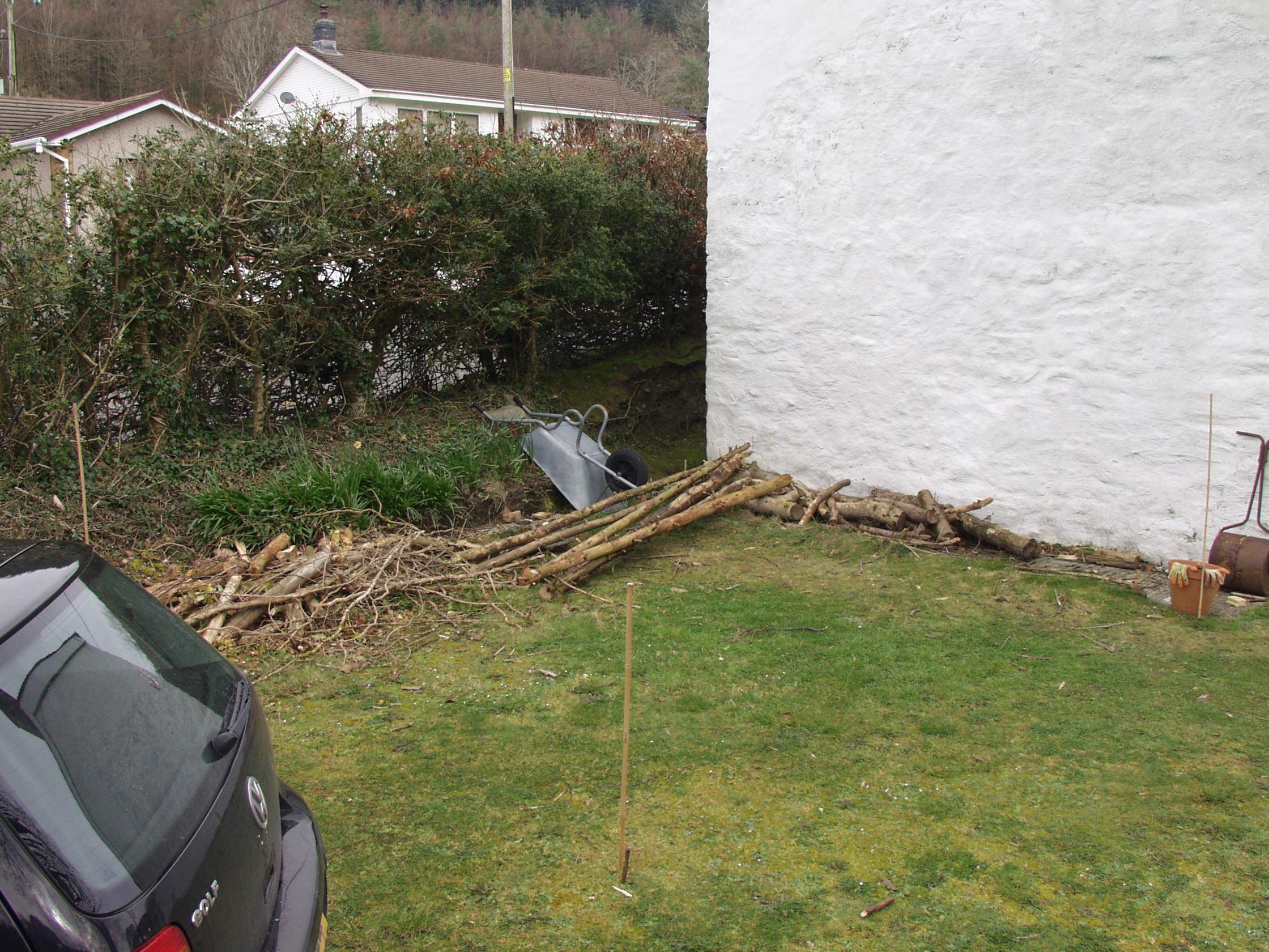

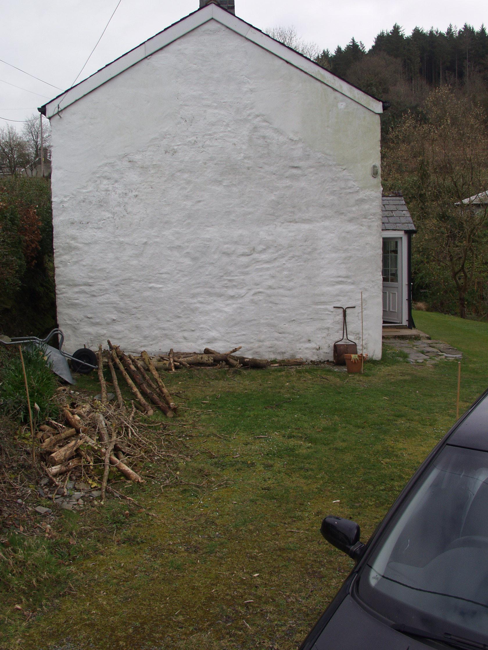

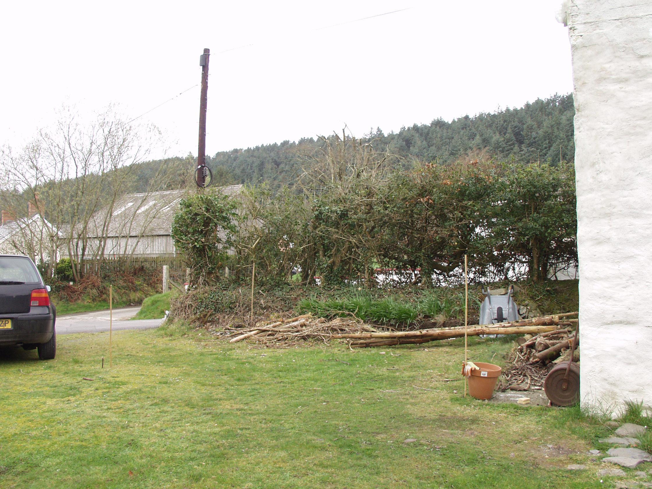

zoothorn Posted March 28, 2019 Author Share Posted March 28, 2019 Photos of area in Q. So, on my yerrow sausage its onto the -south- end, the lowest side (so twds my butth*le). The canes are approx corners, so, it needs to tuck right up to the 2m-from-road (just behind hedge) at this LH corner. Link to comment Share on other sites More sharing options...
zoothorn Posted March 28, 2019 Author Share Posted March 28, 2019 Am I allowed to build onto this obvious house wall (as my extention was going to be).. or does it have to be separate? If separate, does the roof (nearest bit to house) have to be a certain distance from house here anyone know? Link to comment Share on other sites More sharing options...
zoothorn Posted March 28, 2019 Author Share Posted March 28, 2019 @PeterW I must have missed you posting this map before.. on another thread? and that is by far the best/ biggest image Ive seen (the one I paid for from wherever it is, would've been a tiny lentil-size in comparison.. with same-size red lines as yours/ hopeless. Where got from? really appreciated btw. Link to comment Share on other sites More sharing options...

PeterW Posted March 28, 2019 Share Posted March 28, 2019 Boundary is the bit you own - so if you have a hedge its usually measured from the middle of this. A duo-pitch roof can rise at 45 degrees or steeper to a maximum of 4m as long as the eaves are no more than 2.5m at the 2m boundary. The quickest way to work out what you can build where is get a garden cane 2m long and a can of cheap spray paint. Walk round the garden, every few feet just poke one end the end of the cane at the boundary and mark the other end. You'll end up with a dotted outline of where you can build what you want. If you start building outside the 2m exclusion zone then it affects the materials you use - they have to be non-combustible. Inside the zone you can build with whatever you want. Up to 30sqm (that is external and a 5x6m building is BIG) then its no building regs either... Link to comment Share on other sites More sharing options...

zoothorn Posted March 28, 2019 Author Share Posted March 28, 2019 Ok now I'm in the middle of the confusion. Boundaries, roads, this 2m figure.. & from where it is measured from. I need to establish this. Ok as you can see, my house is in the crux of two b-roads (single-lane). The lower one can be discounted, I'm far enough away from this, as can be the junction. They're both quiet minimal traffic, with passing places etc. Which leaves the nearest one, the upper one. It is from here, relative to my nearest corner lof build (the btm LHS cane in my photo) I need to establish. My PP accepted plan, was pretty much to the very same corner point. So can I not simplify this confusion.. by saying if it was ok to build to this point within the agreed PP, it must be ok to build (my smaller) my separated-from-house box with simple roof etc, to this corner point too? Link to comment Share on other sites More sharing options...
zoothorn Posted March 28, 2019 Author Share Posted March 28, 2019 In my 1st photo, its the cane highest in the photo I'm talking about.. to the left of the barrow. In my 2nd photo, its sticking out my car top (in 3rd pic its stuck in the sticks, the second cane along LtoR). The barrow's wheel, is approximately the other 'top' corner point. So joining these = my back wall.. ~parrallel to road just over the hedge. The slightly near-to-the-road of the two corners.. is the cane. The whole build rests on establishing the -maximum- I am allowed, to push this point twds the hedge. Link to comment Share on other sites More sharing options...

Ferdinand Posted March 28, 2019 Share Posted March 28, 2019 (edited) 24 minutes ago, zoothorn said: 've tried to get a location map.. but useless cos its so small scale. PeterW's very kind addition/ map above (where is this from??) is better as its alot larger (I printed & went into my council offices with it today, but the PP dept is in another town 25m away alas).. but even this scale isn't exactly ideal for establishing the precise location of this one corner relative to the road behind It is from the graphical display of Planning History in the interactive map in the Planning Section of the Council website. You get to it by searching for a PP in your postcode area or street, then selecting the map display, or possibly via a service such as My Council which will talk about council services to your address. They usually have somewhat-buried tick box options for displaying various Layers of data. F Edited March 28, 2019 by Ferdinand Link to comment Share on other sites More sharing options...
