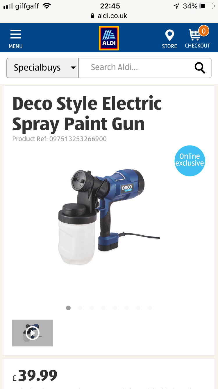

Weebles Posted March 26, 2019 Posted March 26, 2019 After rolling paint in one room I realised my shoulders weren’t going to make it. So I invested in this Aldi paint sprayer. It’s not an industrial one so coverage is only marginally quicker than a roller. But you don’t have to keep dipping into a tray and there are no streaks. And it’s brilliant for applying a mist coat onto fresh plaster where the ceilings and walls have the same paint. Best £40 I spent in a long time. Progress much quicker now and my shoulders are surviving. Takes about 5-10 mins to clean it for the next use. Took a few mins to get used to the ‘controls’. Still available online and free delivery. Still reckon we have 8 weeks of painting ahead of us. 1-2 hours a night after work just isn’t enough. But I love my spray gun? 1

vivienz Posted March 27, 2019 Posted March 27, 2019 The Aldi ones looks better. It's more powerful withh 500W rather than the Lidl machine's 400W. It also has an extra paint reservoir and more nozzles. The Lidl one will do, but it gives a much more textured finish than a more powerful machine, also having to constantly refill the reservoir is a pain.
