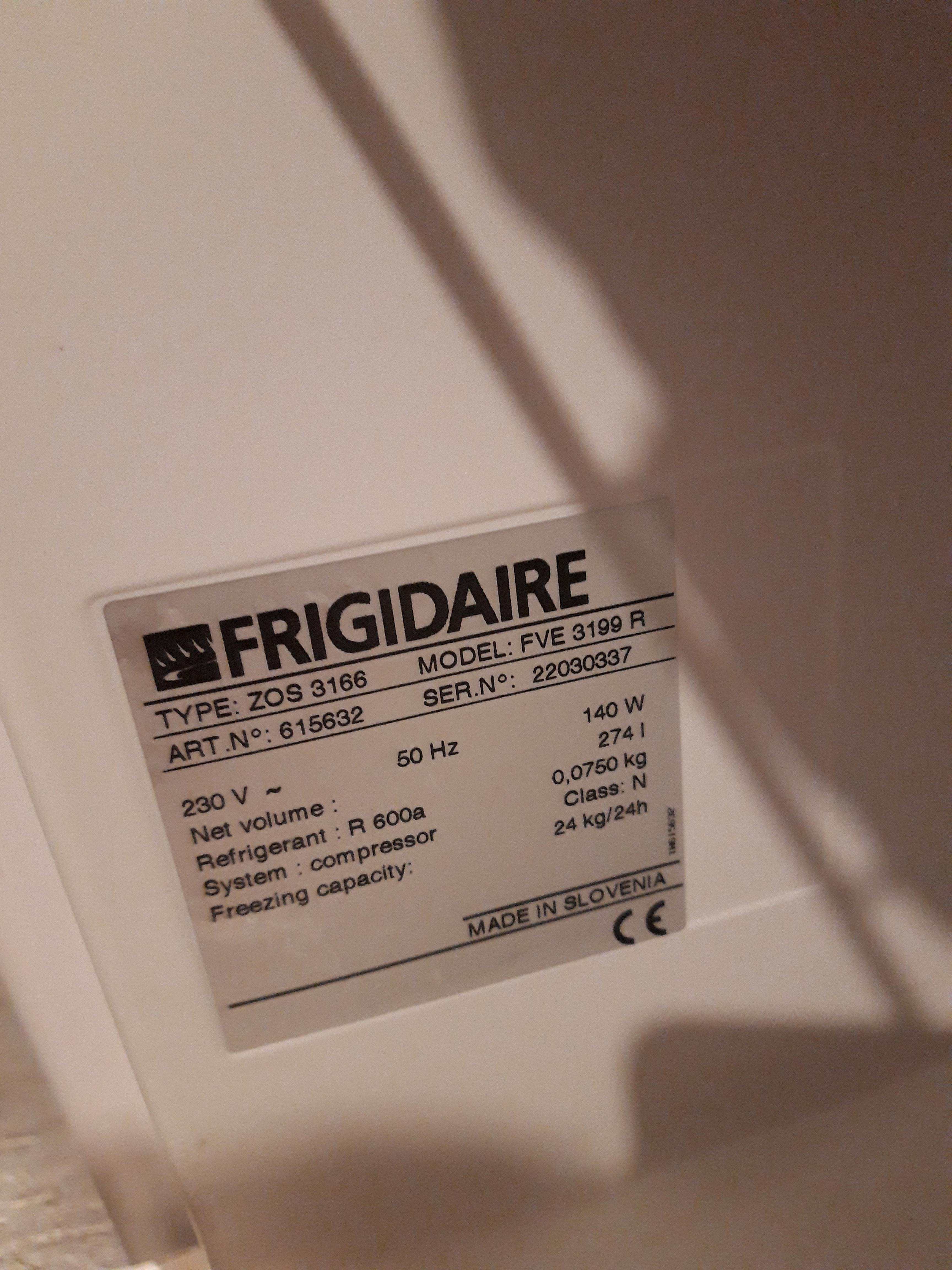

Onoff Posted March 18, 2019 Share Posted March 18, 2019 (edited) Freezer packed up! Temp at around 10deg. Switching to Super Freeze drops it to about -2 and compressor seems to kick in. Thinking evaporator fan maybe duff? As I understand it on Super Freeze compressor runs constantly? SWMBO reckons the freezer has "been making weird noises lately". The usual ruse to get a new one. She HATES it when I fix a domestic appliance! Can't seem to find the fan motor as a spare yet. Might get a number off it when I access it. Left SWMBO decanting anything salvageable to friends and family and cooking anything that can be. Tomorrow night's job. Bed now! Told her to buy a Bosch all those years ago! Edited March 19, 2019 by Onoff Link to comment Share on other sites More sharing options...

ProDave Posted March 19, 2019 Share Posted March 19, 2019 Is it a posh one with a display and an error code? Agree a thorough defrost is the first thing. Freezers that use fans are prone to the fan icing up and jamming so a simple defrost may be all you need. Link to comment Share on other sites More sharing options...
Onoff Posted March 19, 2019 Author Share Posted March 19, 2019 17 minutes ago, ProDave said: Is it a posh one with a display and an error code? Agree a thorough defrost is the first thing. Freezers that use fans are prone to the fan icing up and jamming so a simple defrost may be all you need. Cheap as chips no error code display. I'll drag it out and take a look tonight with a meter; stat, relay, cap etc along with the fan. SWMBO started defrosting it Monday morning so chances are if the fan blades were frozen they weren't by the time I got home. Link to comment Share on other sites More sharing options...
