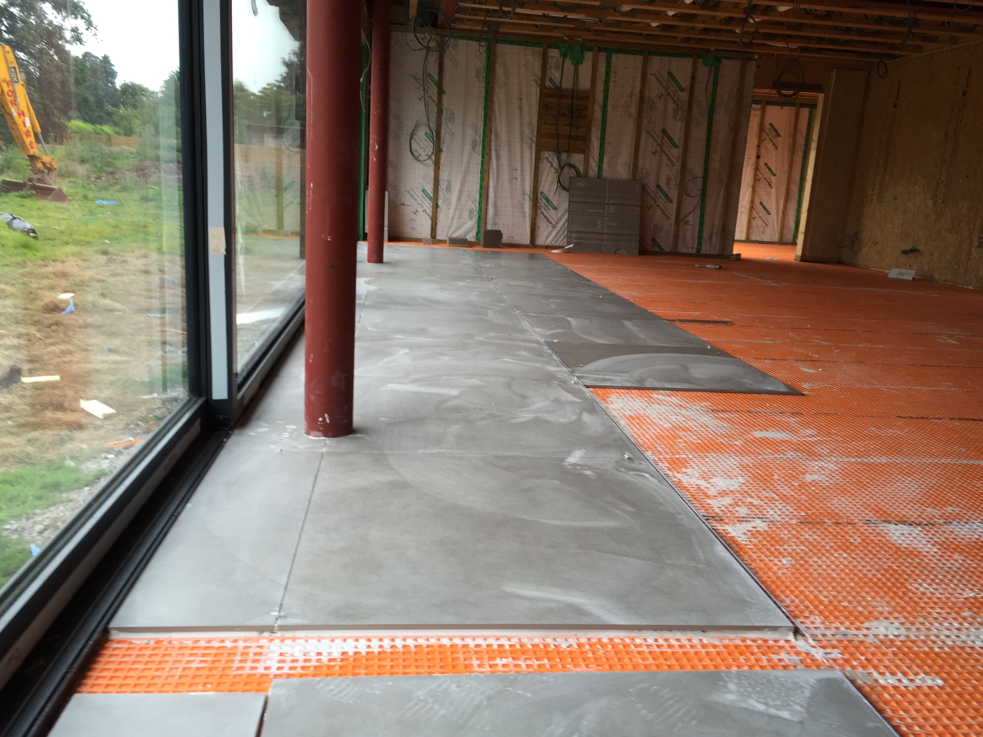

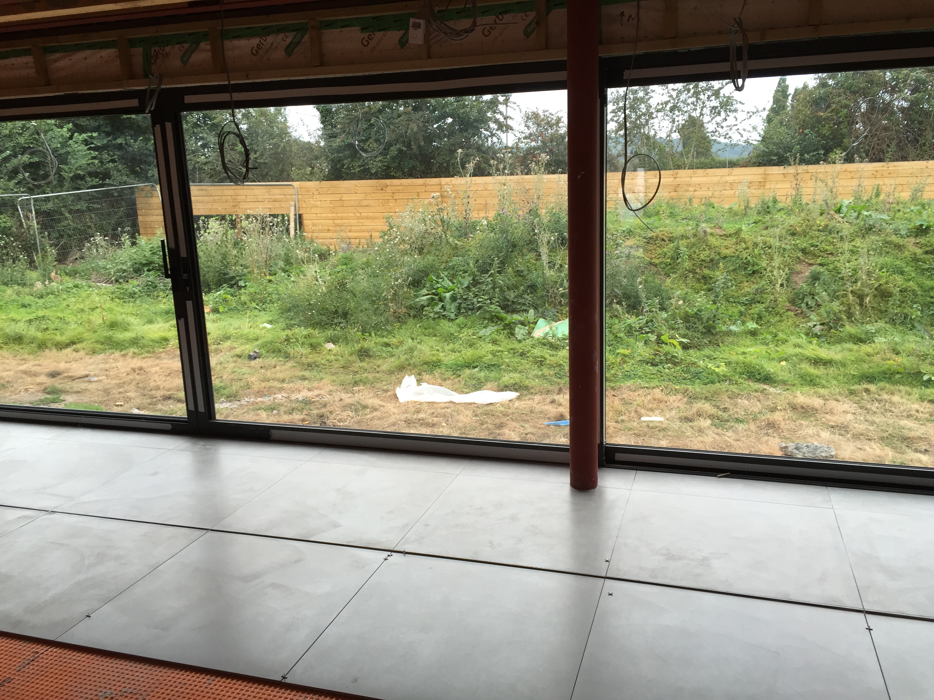

Trw144 Posted August 24, 2016 Share Posted August 24, 2016 I ve gone for 900 x 900 - I haven't had to lay them but they certainly are heavy and its not a job I d fancy on the assumption I want to walk the next day. Link to comment Share on other sites More sharing options...

Nickfromwales Posted August 24, 2016 Author Share Posted August 24, 2016 Good to see you went with the DITRA mat. The job I was on a while back ( oil heating and hot water ) had the builder and his son doing a stand up job of fitting 900x900x20mm porcelain. Cuts were with a wet fed Stihl petrol disc as nothing else would touch it. I took the opportunity to 'test drive' my Rubi 900mm scribe and snap cutter as it states up to 900mm tiles at 20mm thick. Got 850mm of ot to cut straight but the last 50mm curved off. Probably down to the wrong wheel tbh, but not bad going for a £370 tile cutter I thought They laid them perfect and grouted with a like coloured grout. The wife walked in at the end of the day and just said "I don't like the grout colour, can you take it out and use a different colour?". I felt for those guys that day, grouting is a pita, but taking it out is even worse ( without damaging £18k worth of tiles that was ). Id have said "give it a few years luv, the colour will grow on you" Link to comment Share on other sites More sharing options...

Trw144 Posted August 24, 2016 Share Posted August 24, 2016 Yes, 155m2 of tiling so wanted the belts and braces approach of ditra. Also have expansion joints at all doorways and one in the kitchen as its almost 70m2. Link to comment Share on other sites More sharing options...
Nickfromwales Posted August 24, 2016 Author Share Posted August 24, 2016 Glad I quoted you £50 a tile now. Think I dodged a bullet there ?? Link to comment Share on other sites More sharing options...
