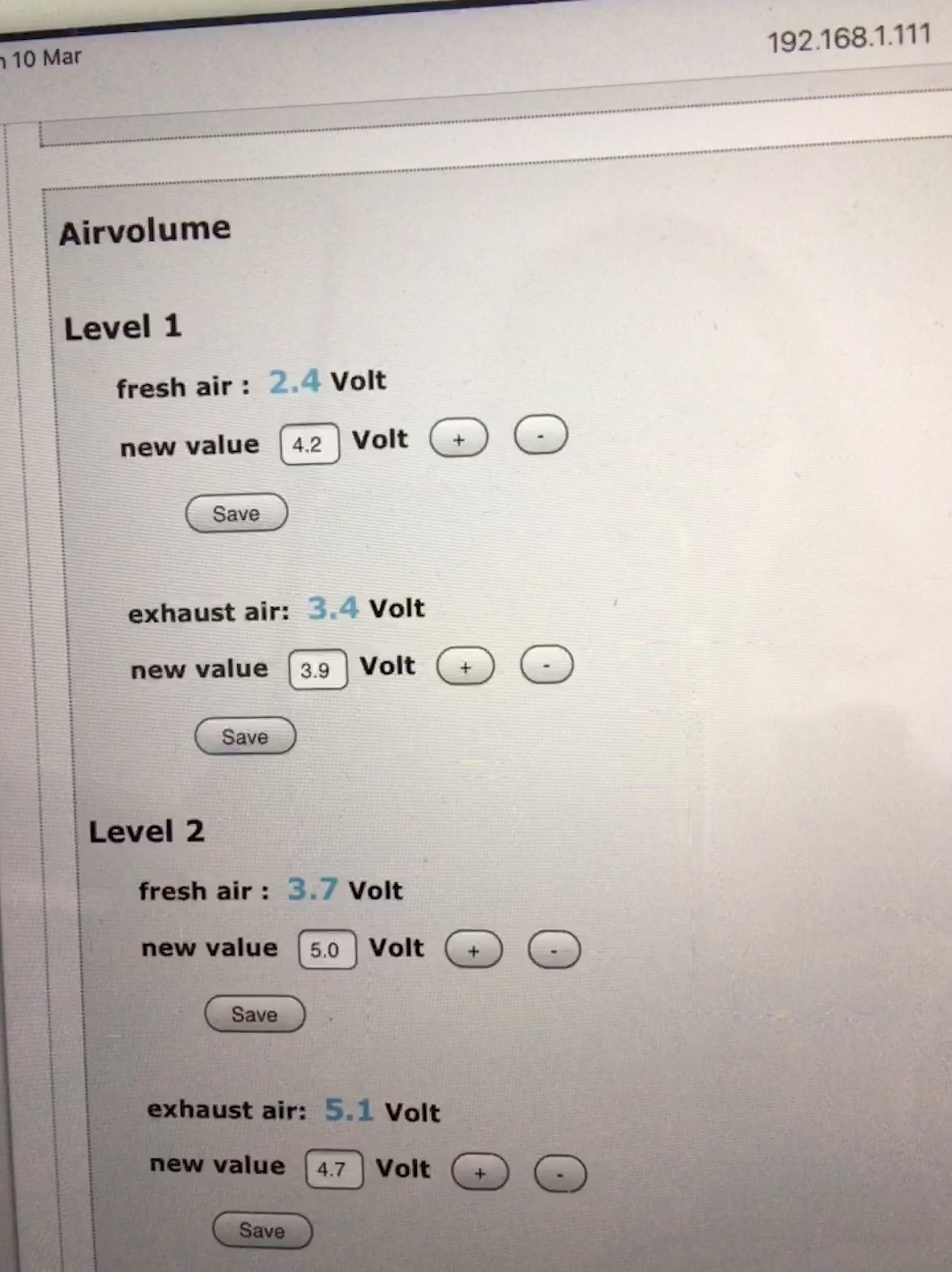

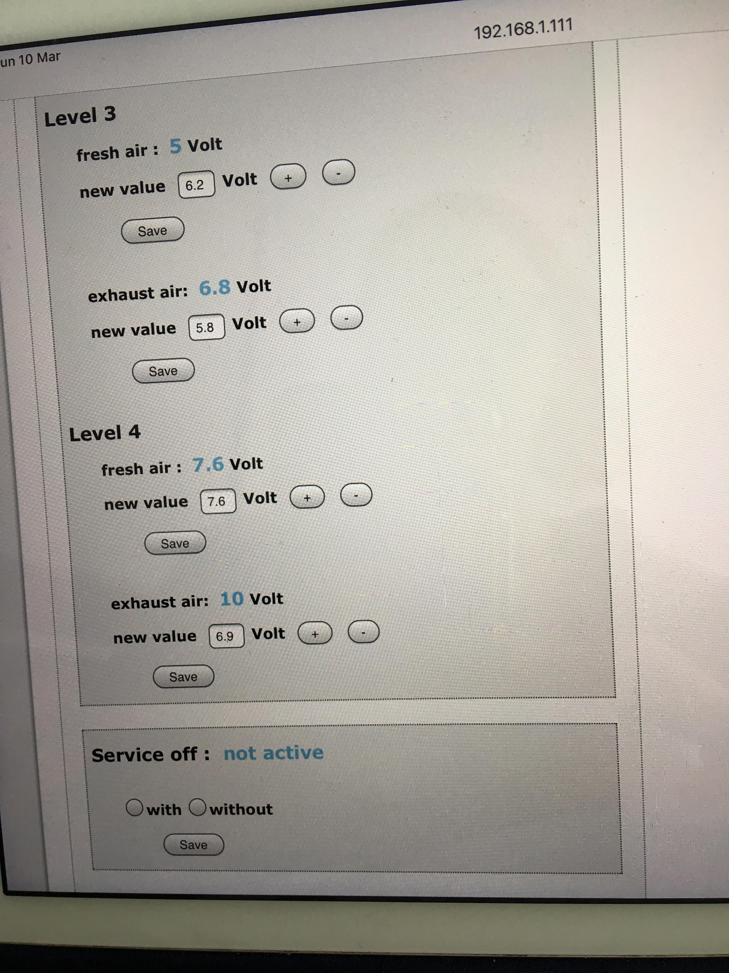

lizzie Posted March 10, 2019 Posted March 10, 2019 Me again.....I am belatedly trying to educate myself before the man comes on Tuesday and hopefully resets everything. For the sake of my sanity I need to try and understand a bit before he comes. I don't have a commissioning report the space in my book is blank. I have managed to get into the set up system via password now so can see what air flow rates I have. It gives me the rates for each level but I can't find the rates for individual rooms. These flow rates have been set, I presume, with reference to a standard starting measurement e.g building regs. They were set for the default F5 filters but I am using F7 and the handbook says there will be a pressure drop so it needs to be reset for that too. I only changed to F7 after about the first 6 months and have not noticed any difference in air pressure. My current settings and factory defaults in the handbook....see attached.. look quite different so it has been set up for my house not left at default. The attached is the comparison table I have done plus the planning drawing for the system with volumes etc plus the relevant bits from the manuals. The manual talks in volts not flow rates or air changes per hour just to confuse things even more. Can anyone help me make sense of it. mvhr parameter settings.pdf air flow details.xlsx MV36106 - MVHR Layout A2.pdf set up defaults.pdf
Jeremy Harris Posted March 10, 2019 Posted March 10, 2019 The air flow rates can't be measured by the MVHR, they need to be measured using an air flow meter at every room terminal. Sadly, I suspect that many, many MVHR systems may be installed and "commissioned" without bothering to set them up properly, let's hope yours is an exception, despite the room terminal readings not having been recorded. The process is to start by setting the MVHR to the background ventilation rate (the rate it runs at most of the time) and then go around every terminal using an air flow meter to measure the flow rate either in to, or out of, the terminal, and write the reading down. Here's a photo of me measuring one of our terminals that shows how it may be done (there are different types of air flow meter): Once a set of baseline readings for every terminal have been done, the first thing is to add up the rates from all the supply terminals, then add up all the rates from the extract terminals. The total air flow for all the supply terminals must equal (more or less) the total airflow from all of the extract terminals, this ensures that the system is balanced and operating at best efficiency. If the system isn't balanced then the terminals need to be carefully adjusted to get the system in balance, or restrictor rings have to be fitted if the system uses that type of flow balancing. Once balanced, the air flows need to all be measured again and the total background ventilation rate must equal or exceed the rate given in Part F, calculated from the house area. If all's well so far, the the next stage is to increase the MVHR fan speed to boost and check the extract flow rates to ensure that the minimum room extract rates for the kitchen, bathrooms, WCs, utility room etc can be met. Those rates are in table 5.2 in Part F IIRC. The chances are that the whole house background ventilation rate may already exceed the required extract rates, in which case there's no need to do this second set of tests. When everything is completed you should have a balanced system with the measured air flow rates at every terminal listed on the commissioning report. Adjusting the whole house ventilation rate up or, most probably, down, after commissioning shouldn't upset the balance, so you can adjust things for the best comfort level without needing to go around re-doing all these measurements. The measurement process is a bit tedious and time consuming, it took me the best part of a whole day to get our system balanced and set up properly. 2

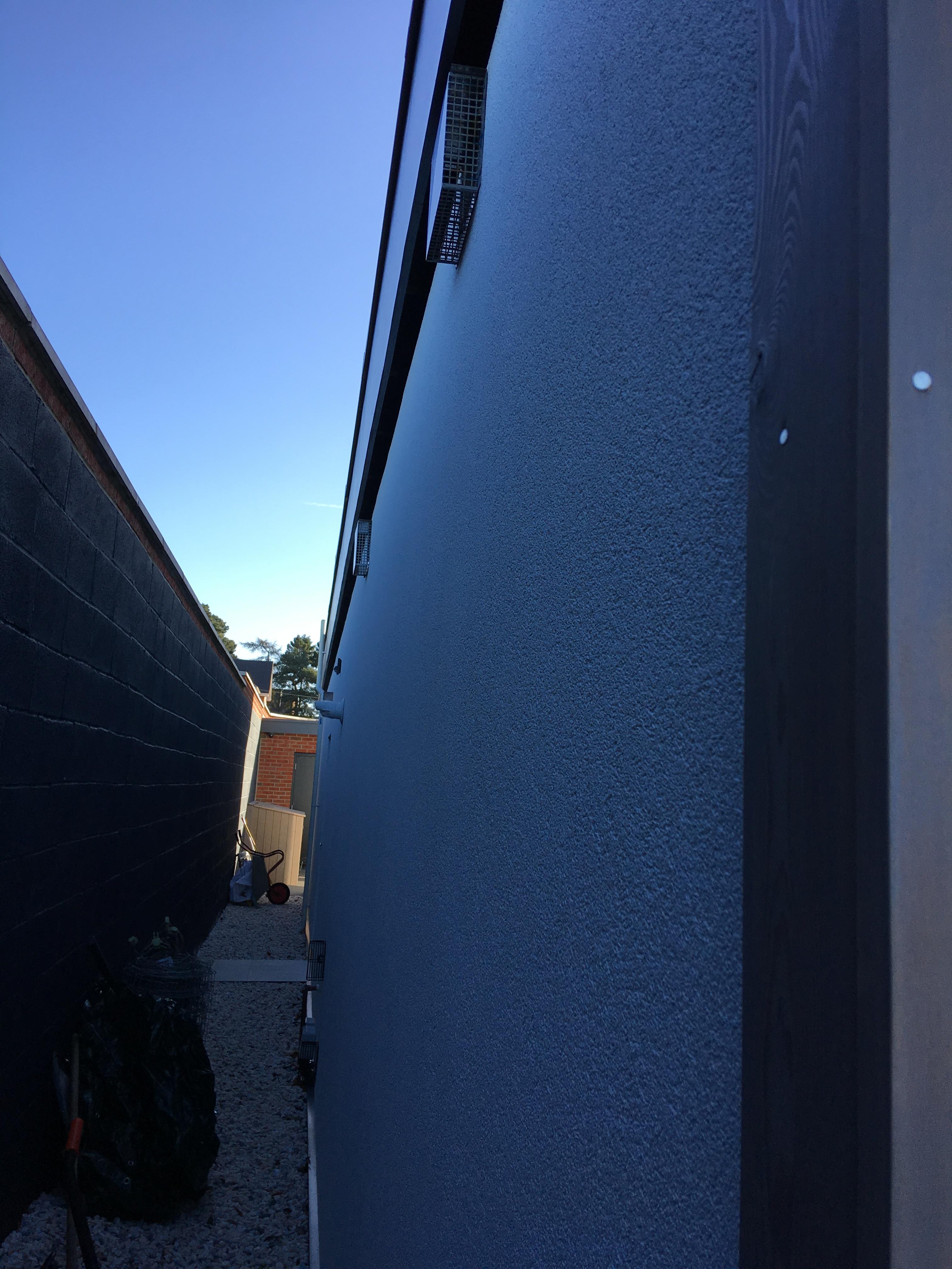

lizzie Posted March 11, 2019 Author Posted March 11, 2019 5 minutes ago, PeterStarck said: Where are the intake and extract vents on your house? Are they on the same wall and does that point in the direction of the prevailing wind? Are you far from the sea? They are on the same wall about 2m apart. They are on the north wall of the house there is only about 1m between the back (north) wall of the house and the huge retaining wall we had to build....thats almost as high as the house only the top of the roof peeps over. We are single storey. Sadly I am a long way from the sea right in the middle of England so just about as far away as you can get. The wind comes in from the west over Wales hits the Malvern Hills then shoots straight up the valley (circa 30 miles) and hits us not a lot in between to slow it down but we have great views!
Gone West Posted March 11, 2019 Posted March 11, 2019 2 minutes ago, lizzie said: They are on the same wall about 2m apart. They are on the north wall of the house there is only about 1m between the back (north) wall of the house and the huge retaining wall we had to build....thats almost as high as the house only the top of the roof peeps over. We are single storey. Sadly I am a long way from the sea right in the middle of England so just about as far away as you can get. The wind comes in from the west over Wales hits the Malvern Hills then shoots straight up the valley (circa 30 miles) and hits us not a lot in between to slow it down but we have great views! I can't see a real problem with that setup. 1

Jeremy Harris Posted March 11, 2019 Posted March 11, 2019 I believe the different MVHR manufacturers have different terminology for the settings. Our Genvex can have the four speed settings programmed to various percentage flow rates, with extract and supply being individually programmable. The recommended set up is for level 2 to be the normal background ventilation rate with level 3 being the normal boost rate. Level 4 is a sort of super boost (100%) and level 1 is a trickle ventilation option for when the house is unoccupied. Being able to adjust extract and supply individually is useful, as if it is hard to get the system to balance from just adjusting the terminals/restrictors in each duct, then the system can be fine tuned to fix a small imbalance, say a couple of % or so. Getting the system to balance well does mean ensuring that the design is correct, though. As extract flow rates will generally be higher than supply flow rates then it's normal to have slightly fewer extract terminals than supply terminals, for example. This also helps to keep any slight flow noise down, as this is most noticeable in rooms that would normally have supply terminals, like bedrooms and living rooms. A little bit of flow noise is often more tolerable in a kitchen or bathroom.
HerbJ Posted March 11, 2019 Posted March 11, 2019 (edited) +1 to @JSHarris I've just a quick look at the info you attached earlier 20 hours ago, lizzie said: The attached is the comparison table I have done plus the planning drawing for the system with volumes etc plus the relevant bits from the manuals. The manual talks in volts not flow rates or air changes per hour just to confuse things even more. Can anyone help me make sense of it. mvhr parameter settings.pdf air flow details.xlsx MV36106 - MVHR Layout A2.pdf set up defaults.pdf So, you have 4 settings, pretty similar to that described by @JSHarris Setting 1 is your unoccupied house setting - named "moisture protect" in your details - this should be set set at 30% of BR Flow, - currently it set at 50% of Setting 3 Setting 2 is named "low" setting - this should been set at 70% of the BR Flow - currently it set at 74% of Setting 3 Setting 3 is named "living" - the BR flow rates , which I believe that was used for all the flow volumes measured - BR Flow = 100% and the subsequent setting for Setting 1, 2 and 4 - Setting 4 is your "boost " setting - this should be set at 130% of the BR Flow - currently it set at 152%% of Setting 3 All your Design info is on your layout drawing, including design flow rates for each supply and extract outlet, together with m2 area of each room ventilated. In short you have supply rate in total of ( 4x40 + 25 + 30) = 215 m3/hr extract rate in total of (4 x 20+2 x 22 + 2x45) = 212 m3/hr It seems you have been operating at Setting 3, which is the 100% BR rate and that is greatly overventilating the house. A better setting for day to day living would be Setting 2, with Setting 3 only used when you are cooking or drying clothes or having a party. Setting 4 should be used when using bathrooms etc. I don't know who created the "air flow details" spreadsheet? was this your installation/commissioning man after he commissioned the system? This requires reviewing against as some of the settings do not seem to be consistemt with the recommendations in the manual extracts you attached. Best of luck Edited March 11, 2019 by HerbJ Didn't finish
Ed Davies Posted March 11, 2019 Posted March 11, 2019 It's odd that the factory default settings for levels 1, 2, and 4 don't follow the 0.3, 0.7, and 1.3 x level 3 settings guide, either. They're not bumping against the 1.8 and 10 volt limits.
