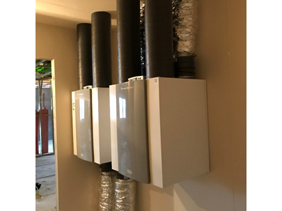

I have 2 x MVHR units, one for downstairs and one for upstairs.  The units are both located in the plant room, 1st floor, with downstairs feeding up into one and out to the attic/outside and the 1st floor one both top fed.

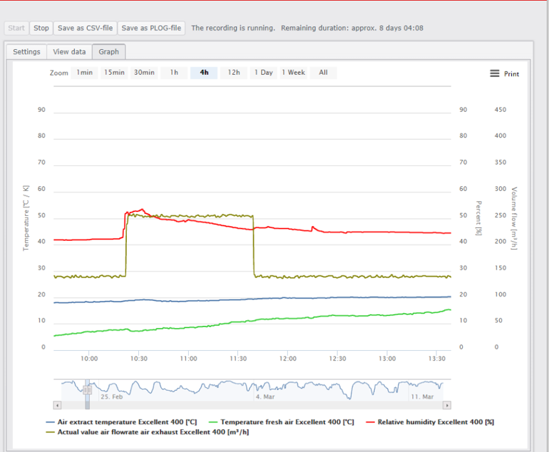

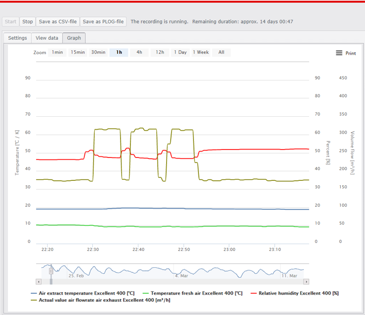

below is a sample of the system going onto boost (automatically) during a shower:
This is the first floor unit, it does 6 minute pulses (ususlly 3) until it decides the RH is no longer rising and then the RH will drop back to the baseline over the next few hours.
The ground floor unit stays on for about 1 hour then ramps back as RH drops.
Don't know why the different behavior, different duct lengths and they are slightly different units (top/bottom feed) but it works.  The steam oven in the kitchen will also trigger it when opened.
