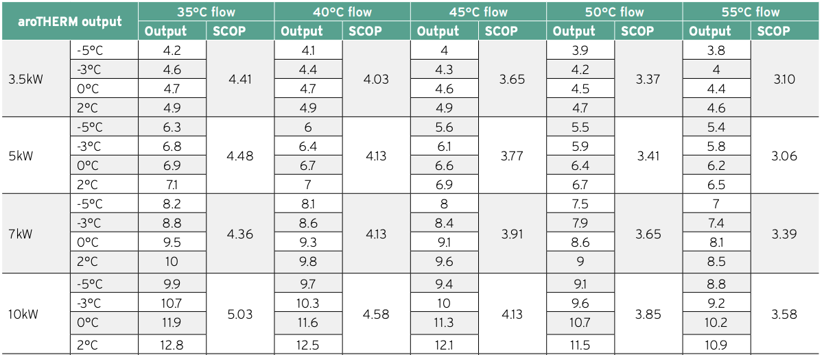

DenkiJidousha Posted October 20, 2020 Share Posted October 20, 2020 Resurrecting an old thread, but if heat loss calculations or historic usage puts you on the cusp of two size models of ASHP (in this case 7kW or 10kW), is the rule of thumb always go large? Sadly the larger capacity unit in this case would be significantly larger in terms of the outdoor unit (two fans vs one, I think), noisier, and adds about 10% to the capital costs (combi replacement), but is in theory more efficient. Aesthetics and wallet say go small, but is this a bad idea? Link to comment Share on other sites More sharing options...

Dan F Posted October 20, 2020 Share Posted October 20, 2020 (edited) 2 hours ago, DenkiJidousha said: Resurrecting an old thread, but if heat loss calculations or historic usage puts you on the cusp of two size models of ASHP (in this case 7kW or 10kW), is the rule of thumb always go large? Sadly the larger capacity unit in this case would be significantly larger in terms of the outdoor unit (two fans vs one, I think), noisier, and adds about 10% to the capital costs (combi replacement), but is in theory more efficient. Aesthetics and wallet say go small, but is this a bad idea? I was looking at exactly this same issue, with exactly the same ASHP model a while ago. Still not decided which one to go for though. What I would say, is look at the power table, as the 7kW is only 7kW at -5C/55C. I'm not sure where you are based, but we are in the south-east and don't expect -5C. The other difference is that: - 10kW version has a "scroll compressor" instead of a "rotary piston". - 10kW version I assume has a higher minimum power Edited October 20, 2020 by Dan F Link to comment Share on other sites More sharing options...
DenkiJidousha Posted October 21, 2020 Share Posted October 21, 2020 We're in Scotland, near Dundee. Sustained cold spells below zero are rare but have happened, like the winter of 2010/2011: https://en.wikipedia.org/wiki/Winter_of_2010–11_in_Great_Britain_and_Ireland Good point that only in those extremes (when you need most heat) does the Vaillant areoTherm plus' output fall to 7kW, or below if making even hotter water. At power level A7/W55, and 1m away, they quote 47 dB(A) for the 7kW and 52 dB(A) for the 10kW - neither is as good as the 42kW for that Mitsubishi Electric Ultra Quiet Ecodan example (assuming this is a fair comparison). I don't have a feel for how loud these actually would be in situ. Link to comment Share on other sites More sharing options...
Dan F Posted October 21, 2020 Share Posted October 21, 2020 11 hours ago, DenkiJidousha said: Nneither is as good as the 42kW for that Mitsubishi Electric Ultra Quiet Ecodan example (assuming this is a fair comparison). I don't have a feel for how loud these actually would be in situ. Not sure how the "1m away" calculation works. If you compare the sound power of each, they doesn't seem to be too much in it: aroTHERM plus 7kW: 55dB. aroTHERM plus 10kW: 60dB Ecodan R32 8.5kW: 58dB Ecodan R32 11.2kW: 58dB Link to comment Share on other sites More sharing options...

SuperJohnG Posted April 13, 2023 Share Posted April 13, 2023 On 20/10/2020 at 22:04, Dan F said: I was looking at exactly this same issue, with exactly the same ASHP model a while ago. Still not decided which one to go for though. What I would say, is look at the power table, as the 7kW is only 7kW at -5C/55C. I'm not sure where you are based, but we are in the south-east and don't expect -5C. The other difference is that: - 10kW version has a "scroll compressor" instead of a "rotary piston". - 10kW version I assume has a higher minimum power @Dan F what did you get in the end? In reality the 7kW unit will be more than enough. But unsure if a rotary piston is better than a scroll type? Link to comment Share on other sites More sharing options...
Dan F Posted April 14, 2023 Share Posted April 14, 2023 2 hours ago, SuperJohnG said: @Dan F what did you get in the end? In reality the 7kW unit will be more than enough. But unsure if a rotary piston is better than a scroll type? 7kw. The rotary piston may technically be better, but the minimum output on the 10kw unit is a significantly higher and wouldn't have been suitable. 1 Link to comment Share on other sites More sharing options...
