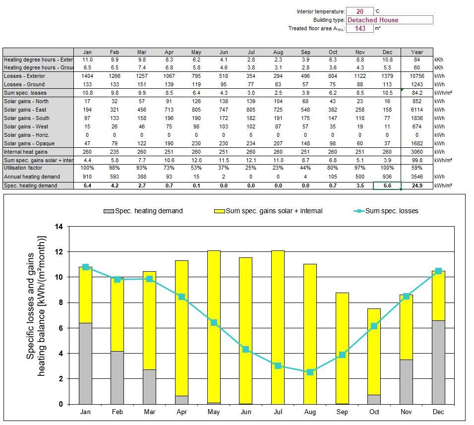

andy Posted March 3, 2019 Share Posted March 3, 2019 Hi all I'm struggling to match the PHPP data in the screen shot below with the sizing requirements for an ASHP. If I have a peak heating load of 6.6kWh/m2 for December for a floor area of 142m2 = 937.2kWh, how do I marry that with working out the ASHP requirements (with an appropriate overheard added just in case)? I am quite sure I'm missing something blindingly obvious here but any education (as ever!) gratefully received ? 1 Link to comment Share on other sites More sharing options...
ProDave Posted March 3, 2019 Share Posted March 3, 2019 So December needs 973.2KWh that is 31.39KWh per day or an average power 24/7 of 1.3Kw You probably don't want to run the heating 24/7 so assume it is on half the time it will need to produce 2.6Kw of heat for that time. A 5KW ASHP should do you comfortably. 1 Link to comment Share on other sites More sharing options...
PeterW Posted March 3, 2019 Share Posted March 3, 2019 More scientifically you need to look at the low for the month. So if you get the Met Office data for your area and look at the min OAT figure, you’ll see that January may be colder than December. I would expect to get to an average, there is a minimum that is 30-40% lower than the mean so you will have at some point a loss of 60KWh on a day. Running an ASHP for the 7 hours of the E7 period (assuming no solar) means you need around 8.3Kw/h input heat, so a 9Kw ASHP would do this with no peak usage. As @ProDave has said though, a 5Kw would work however there is no consideration for hot water provision. @JSHarris spreadsheet is much easier to use btw ..!! 1 Link to comment Share on other sites More sharing options...
ProDave Posted March 3, 2019 Share Posted March 3, 2019 My observation from my own ASHP is that is spends typically 4 half hour busts each day doing hot water, so it is "out of service" as far as heating is concerned for that period. Yes you do need to consider what energy regime and if you want to do it all over night on E7 then the output for that period will need to be higher. And good point for allowing extra for particularly cold spells. Link to comment Share on other sites More sharing options...
PeterW Posted March 3, 2019 Share Posted March 3, 2019 I’d be inclined to just leave it on in really cold periods as there is no point in being cold in a house ..! Think I worked out that the 9kw I installed recently is using about £1.12 per day on E7 to keep at 19.5c, but that is all overnight heating. Link to comment Share on other sites More sharing options...
Jeremy Harris Posted March 3, 2019 Share Posted March 3, 2019 We've only been running our ASHP overnight on E7 since early January. Despite some pretty cold (for here) weather the house has maintained a fairly steady temperature of around 22°C. It seems that with the slab being charged up overnight it can easily maintain the house at a comfortable temperature all day. I've not accurately worked out the cost, but would guess that the worst case has been around £0.60 per day (at E7 off-peak rate), with quite a few days when the heating hasn't come on at all. Link to comment Share on other sites More sharing options...
andy Posted March 3, 2019 Author Share Posted March 3, 2019 See it was really simple and makes perfect sense now!! Thanks all, I think a 9kW ASHP would cover worst case scenario and running it at a lower demand should give a better CoP I hope. I will be having PV and battery storage (later) so would need to do the maths about E7/10. Link to comment Share on other sites More sharing options...

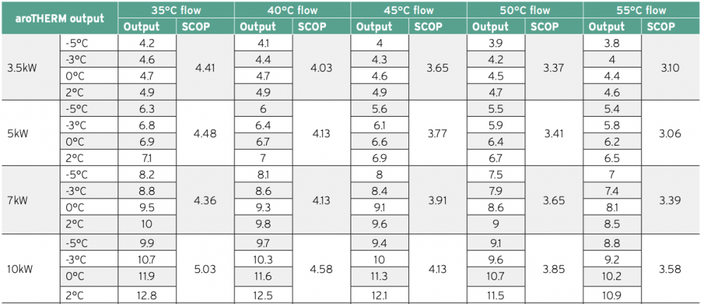

DenkiJidousha Posted October 23, 2019 Share Posted October 23, 2019 (edited) Had to google that, PHE = plate heat exchanger, which can be used to transfer heat into the hot water tank (especially with a low temperature heat pump), versus using a traditional coiled pipe running though the bottom of the tank (with a high temperature heat pump)? Getting this back to the original topic, ASHP sizing, I'm looking at replacing our mains gas combi boiler which provides domestic hot water (DHW) and under floor heating (UFH) to our three bedroom two story approx 125m2 mid terrance house, built about 2005 with reasonable insulation (EPC rating C). We have 5kW of solar PV and a time of use electricity tariff. I'm still chasing local installers to get multiple quotes, but the first one back suggests (before doing an on site visit) a 12kW monoblock HT heat pump (space will be tight so the monoblock makes sense), no thermal store for the UFH, and a 250 litre slimline cylinder or SunAmp for the hot water. I'm wondering if a 12kW ASHP is too about right or too big, and what the trade offs are. Too small a heat pump: Have to leave it running more hours a day (problematic with time of use electricity tariffs), or in extreme cases would need supplementary heating. Too large a heat pump: Wasted capital cost. Would only be on in bursts, making it less efficient (short cycling issues)? Would this strengthen the case for a thermal store for the heating side (again higher capital costs)? In terms of data, I have about a year's worth of hourly gas usage via a Loop Energy Saver (since replaced with a smart meter). Looking at peak daily usage, and peak hourly usage, and counting on the morning and evening hot water demand spikes to be spread out with the storage, I think a 12kW heatpump should be more than up to the demands - perhaps even overkill. Edited October 23, 2019 by DenkiJidousha Added keyword short-cycling 1 Link to comment Share on other sites More sharing options...
PeterW Posted October 23, 2019 Share Posted October 23, 2019 13 minutes ago, DenkiJidousha said: Had to google that, PHE = plate heat exchanger, which can be used to transfer heat into the hot water tank (especially with a low temperature heat pump), versus using a traditional coiled pipe running though the bottom of the tank (with a high temperature heat pump)? PHE is overkill here as they are good for multiple sources or where it’s not a “clean” source. You would still need a coil on the tank as otherwise you’ll need a Thermal Store and that needs much higher temperatures. They also have more moving parts and you need an additional pump. Link to comment Share on other sites More sharing options...
