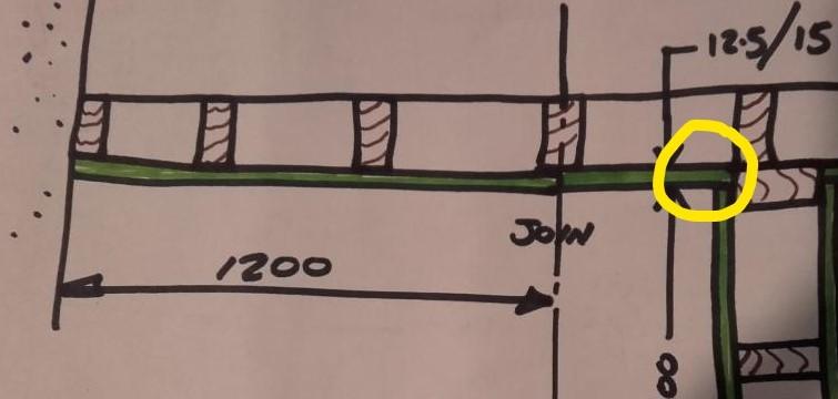

PeterW Posted February 23, 2019 Share Posted February 23, 2019 I think @Russell griffiths And me are talking the same thing ... Link to comment Share on other sites More sharing options...
Russell griffiths Posted February 23, 2019 Share Posted February 23, 2019 @recoveringacademic what you need to do is mark out on the floor ALL YOUR WALLS, don’t build one wall and then add another this will bite you later layout your sole plate and mark all junctions, corners. Then mark them on your sole plate. The distance between studs is completely irrelevant, apart from the studs your plasterboard joins on i couldn’t give a hoot if there 457.5mm apart, it is only the corners and junctions and board joins that are important. Think about these 3 points and do not worry about the other being out by 10-20 50mm it is not important. Link to comment Share on other sites More sharing options...
Russell griffiths Posted February 23, 2019 Share Posted February 23, 2019 @PeterW is with me, you also need to do something similar at a corner, you can look it up on YouTube, look up framing. If you look up California corner that might help with a corner you need to make sure you can support your boards on the external corner as well as internal corner. That one will mess with your head. Link to comment Share on other sites More sharing options...

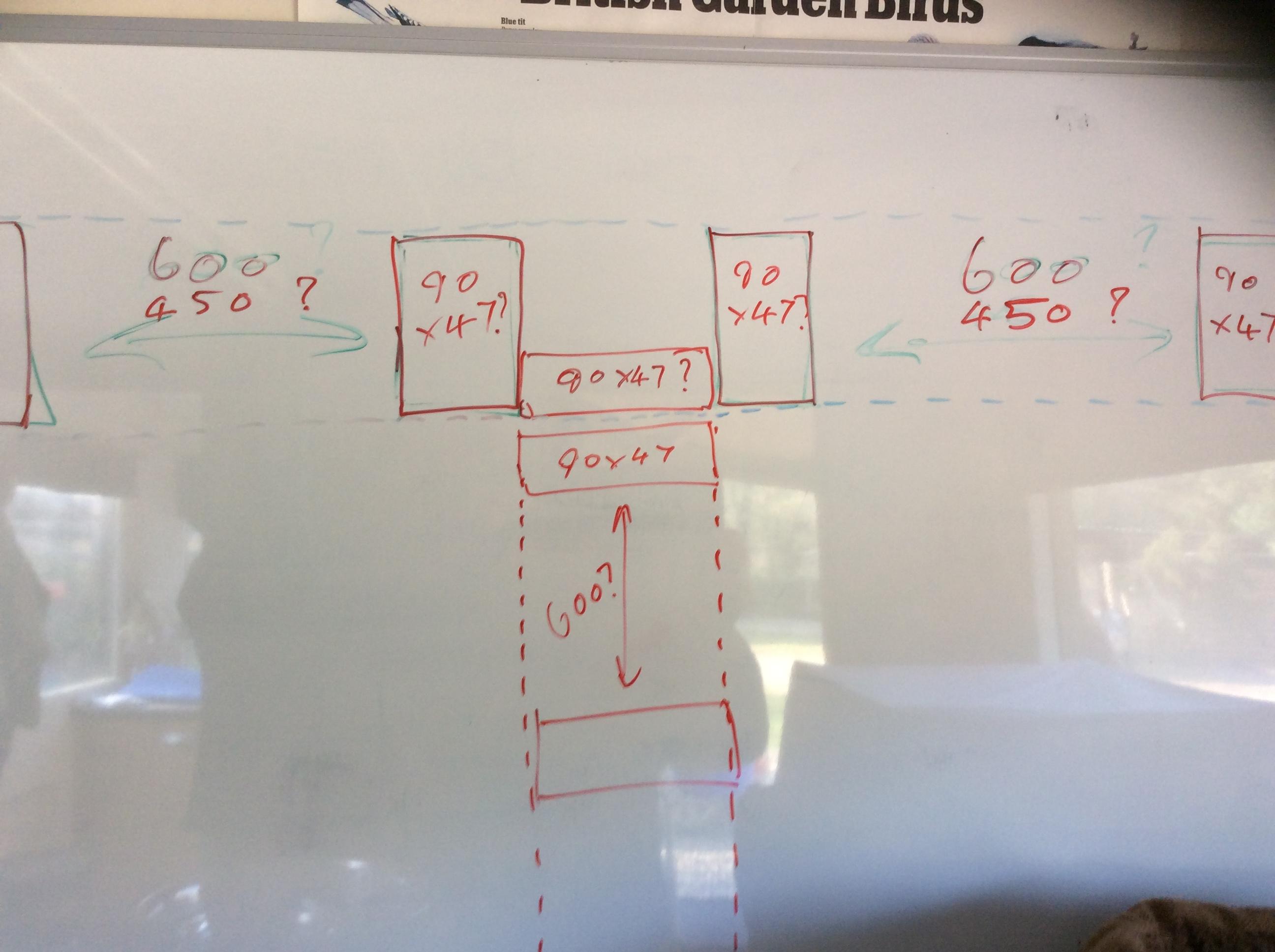

PeterW Posted February 23, 2019 Share Posted February 23, 2019 My picture is not worthy, and @Russell griffiths has a white board which is the ultimate in site office accessories ..! @recoveringacademic does that make sense to you now ..?? Link to comment Share on other sites More sharing options...

Russell griffiths Posted February 23, 2019 Share Posted February 23, 2019 So I’m sitting in the bath. STEADY LADIES. and thought I would see what I could find to help our ol mate @recoveringacademic Out off out later to practice my John travolta moves, so check that out and get that wall set out. 1 Link to comment Share on other sites More sharing options...

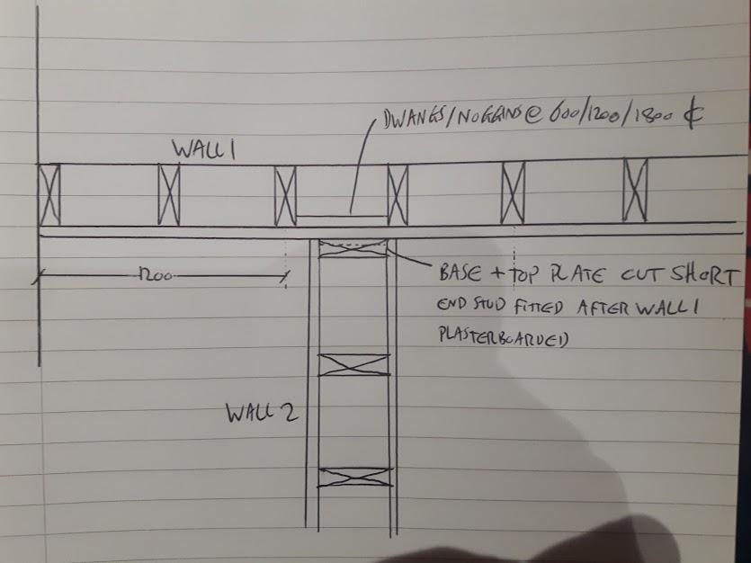

Hobbiniho Posted March 10, 2019 Share Posted March 10, 2019 (edited) the way that we do it up here is to completely plasterboard all the long walls in 1 continuous run, these are usually ones along corridors etc then plasterboard the smaller ones, hopefully this picture will make it easier to understand, you have the benefit of using fewer studs edit: drawing is obviously not to scale Edited March 10, 2019 by Hobbiniho Link to comment Share on other sites More sharing options...
Mr Punter Posted March 10, 2019 Share Posted March 10, 2019 2 hours ago, Hobbiniho said: the way that we do it up here is to completely plasterboard all the long walls in 1 continuous run, these are usually ones along corridors etc then plasterboard the smaller ones, hopefully this picture will make it easier to understand, you have the benefit of using fewer studs edit: drawing is obviously not to scale Using this approach, is there any issue with sound travelling between the rooms - along the plasterboard? Link to comment Share on other sites More sharing options...
