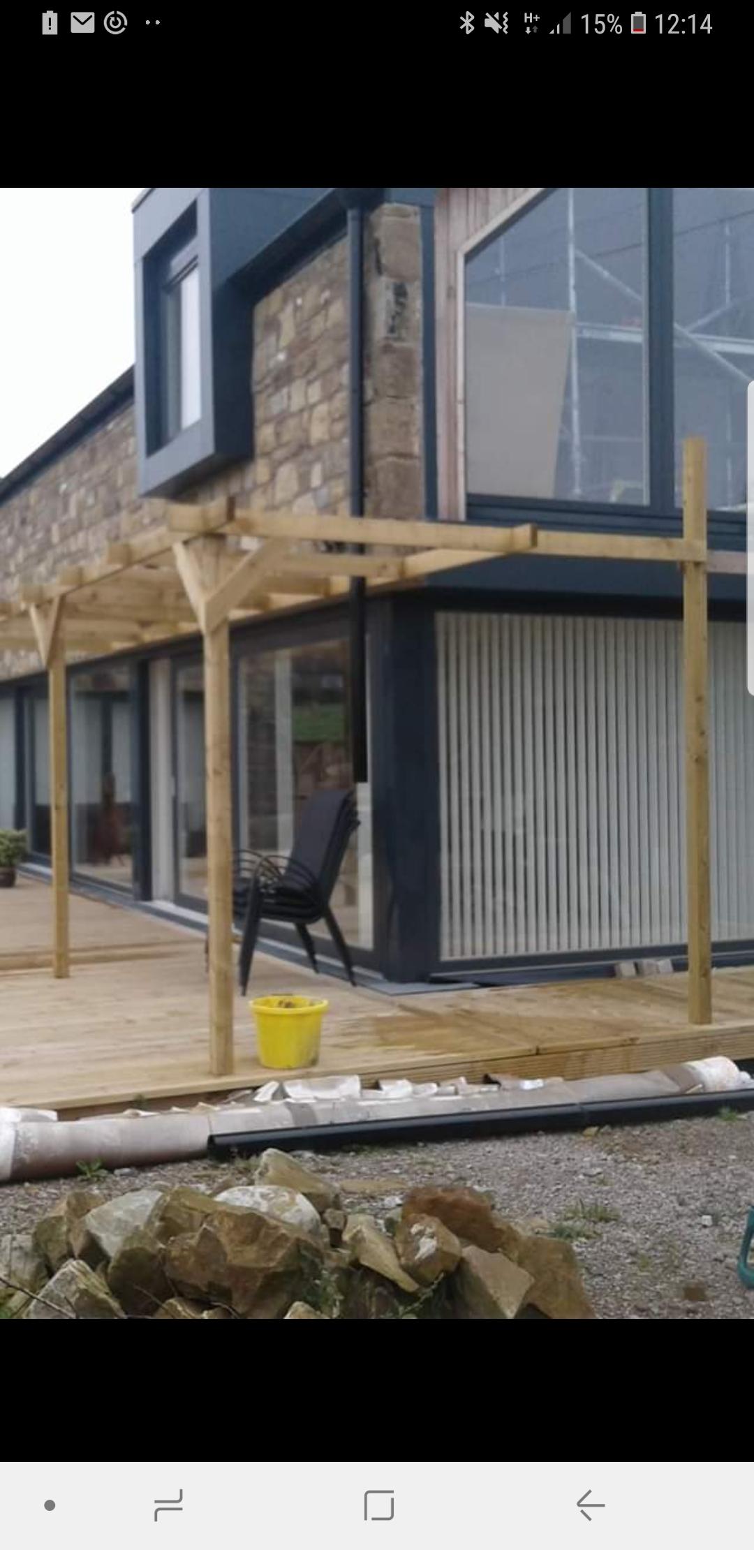

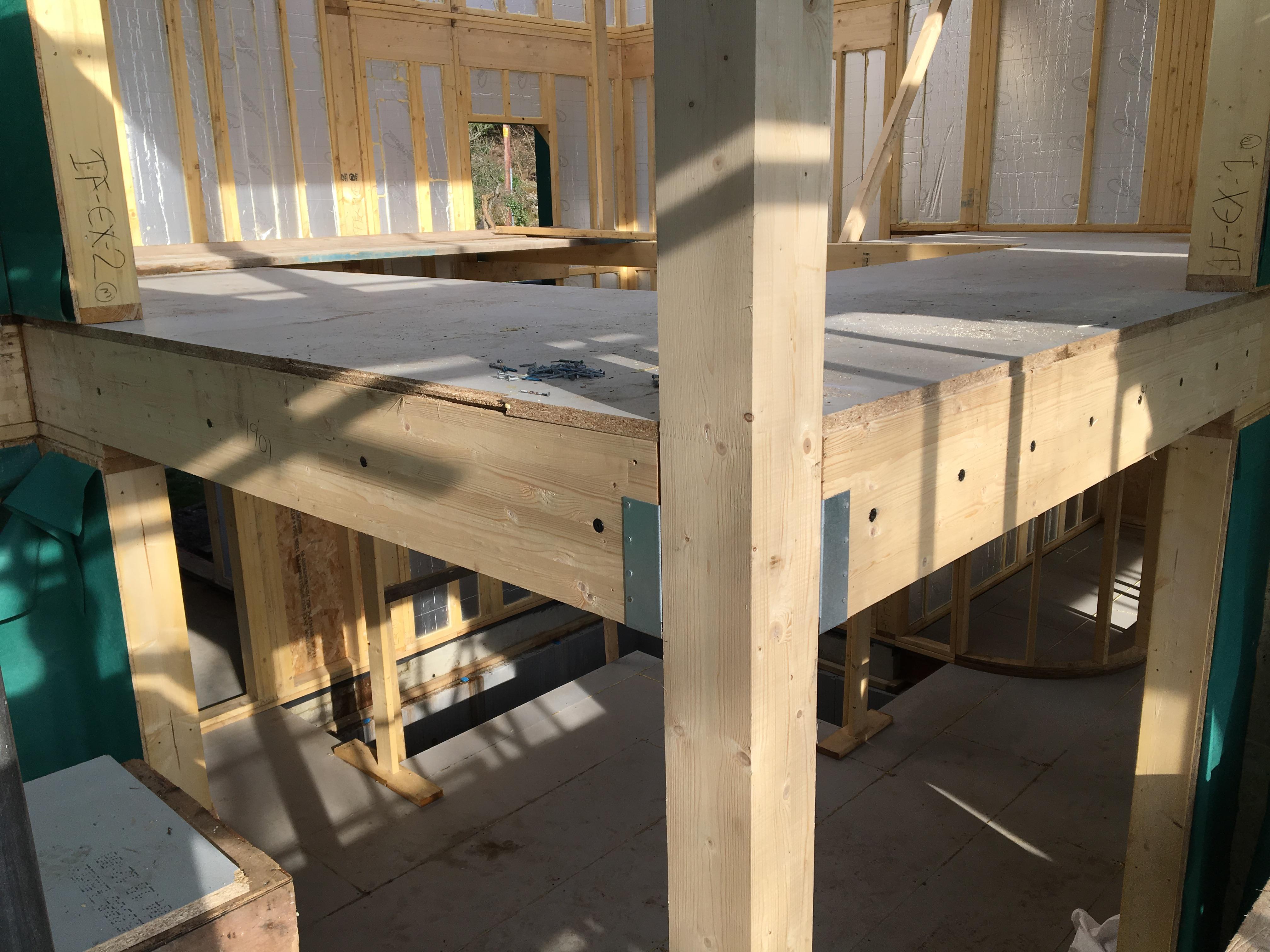

Triassic Posted February 23, 2019 Author Posted February 23, 2019 Here’s an example of a corner window that’s causing me sleepless night. I’ve neasured up the size of the holes for the windows, simple! Next question, how do I cover the horizontal and vertical timber elements? Does each window need a chill or is their a preparatory cover peice to link the windows? The window company don’t appear to have covered this detail on their quote! Suggestions and photos of how you did it welcome.

Triassic Posted February 23, 2019 Author Posted February 23, 2019 Thanks for the offer, however the windows measurement fine, it’s how to cover the corner post and the horizontal timber in a manner that looks good i worrying about.
Jeremy Harris Posted February 23, 2019 Posted February 23, 2019 I had problems with getting firm details for window vertical and horizontal joints on our glazed gable. That has four vertical window-to-window joints, plus one horizontal joint (5 windows plus a glazed door, all joined together. I don't know if there's a universal answer, as all I managed to glean in the end (after a lot of unsatisfactory correspondence with the window supplier) was that the vertical joints would use a slim aluminium cover piece, that would be integrated into one of the windows and then sealed during installation to its neighbour. The horizontal joint used a stacking cill, the details of which were never made clear prior to installation, best I got was a very scruffy faxed (!) drawing that turned out to be completely wrong anyway.

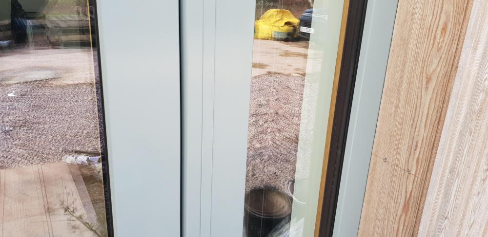

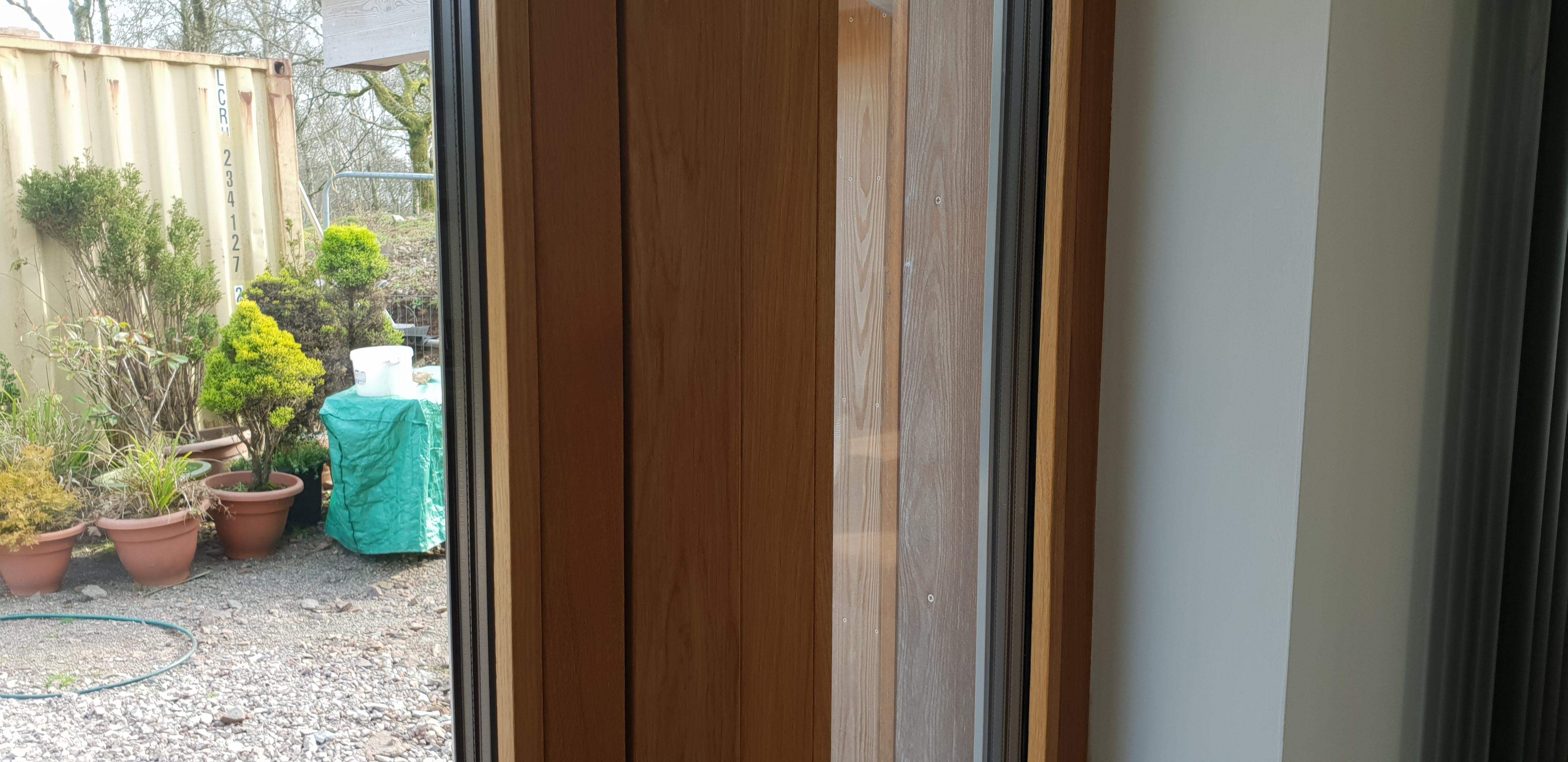

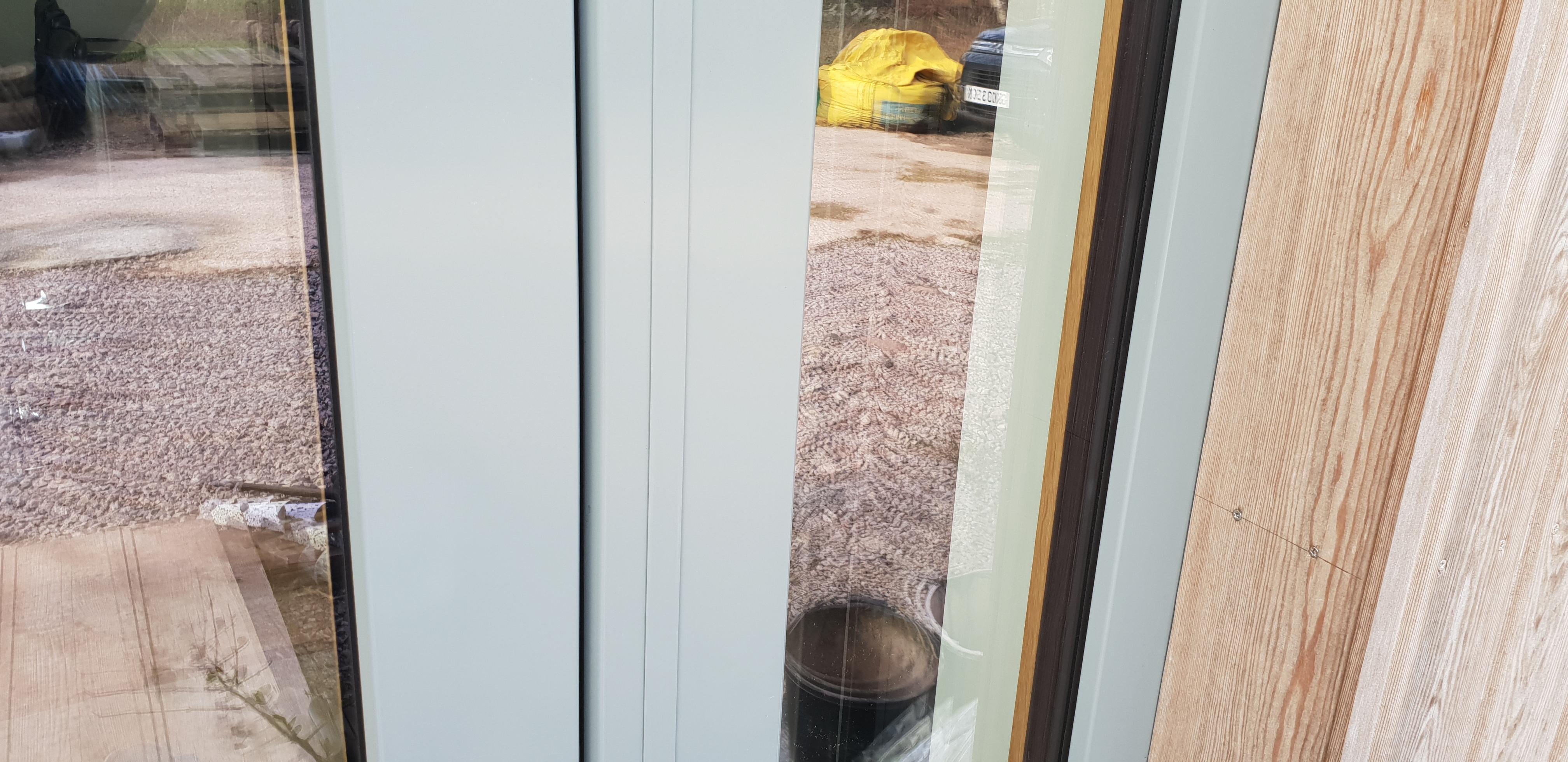

iSelfBuild Posted February 23, 2019 Posted February 23, 2019 (edited) 1 hour ago, Triassic said: Thanks for the offer, however the windows measurement fine, it’s how to cover the corner post and the horizontal timber in a manner that looks good i worrying about. As in two units intersecting? Here is our French doors with stand alone side lights. They don't require cover trim internally, they just connect with tongue groove and I glued and added brackets top and bottom on site. Externally we added a little T trim on the aluminium to make it neat and watertight. For corner posts or just windows as a set they should be specified like that and the window company should have a tried and tested detail to make it look seamless. Just ask for photos on how they finish it. Here is some sliders in Arkholme which have an external aluminium cover trim. Edited February 23, 2019 by iSelfBuild

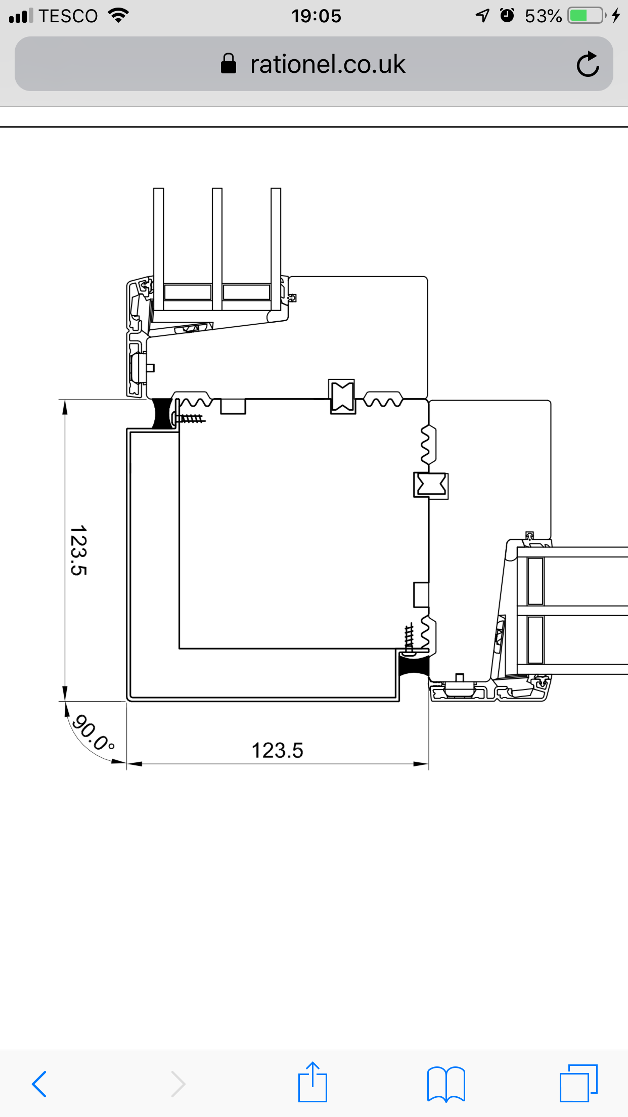

craig Posted February 23, 2019 Posted February 23, 2019 (edited) Does the aluminium cladding on the windows have a groove running vertically for a 2mm thick aluminium flashing to fit? If not, not a biggy you can detail the flashing in, whats the dimension of the timber post? Where at the windows sitting within the opening and can you insulate behind the flashing? Do you have a detail in PDF/DWG? Would be happy to draw up a detail for you. What window system are you using? More importantly, are they fixed/T&T/casement/sliding etc? Edited February 23, 2019 by craig
Triassic Posted February 23, 2019 Author Posted February 23, 2019 I've not got the windows yet, they are Rationel Ali-clad windows, no idea if they have grooves or not. The only detail I have is the brochure and anything on their web site? Most windows that link through the three storeys are fixed. The timber posts are structural and 100mm square.
craig Posted February 23, 2019 Posted February 23, 2019 Ignore the fact that the drawing shows a supplied corner post, the priciple is the same. I’ve assumed Auraplus? It doesn’t have grooves on the cladding and this detail shows a return on the cladding creating a shadow gap. The principle would be the same for using your own post. If your not comfortable with the depth, rather than returning back onto the post and fixing, you could return it behind the cladding of the fixed jamb. You could also have it sit slightly prouder and then fix it ontop of the fixed frame cladding. 1
