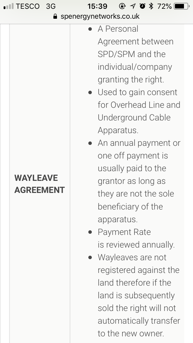

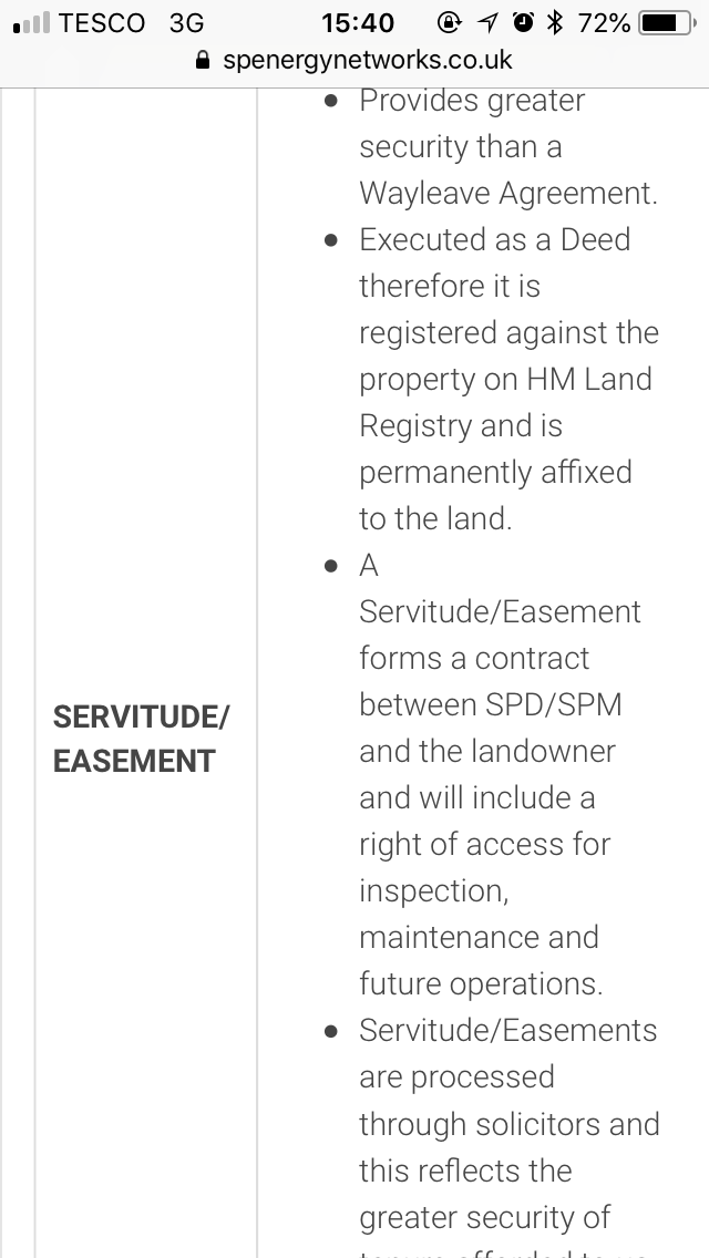

recoveringbuilder Posted February 15, 2019 Share Posted February 15, 2019 (edited) Oh well then SP energy must be wrong Edited February 15, 2019 by Christine Walker Add photos Link to comment Share on other sites More sharing options...
ToughButterCup Posted February 15, 2019 Share Posted February 15, 2019 1 hour ago, Christine Walker said: [...] I find this repeatedly that the person on the other end of the phone knows less about things than you do yourself! [...] Its quite normal. In situations like this I sometimes ask; "Well, since you know your internal systems, and the facts of this case - if you had this problem, what would you do now?" 1 Link to comment Share on other sites More sharing options...
scottishjohn Posted February 15, 2019 Share Posted February 15, 2019 (edited) not trying to be funny - -but the term servitude was not used until now --yes that is totally different thing than an easement I suspect what you have found is a gather up of scottish +english law terms written by someone who is not competent in both legal systems. very few solicitors who work in both english +scottish law . but hey I,m only going on what my solicitor has told me ,and in 35 years of very complicated sales of land and property,both domestic and company dealings he has never steered me wrong to me common sense says DNo would not want to keep making new deals everytime the property changes hands and would write in such a way it did keep in force when land changed hands Edited February 15, 2019 by scottishjohn Link to comment Share on other sites More sharing options...
Randomiser Posted February 15, 2019 Author Share Posted February 15, 2019 5 hours ago, scottishjohn said: Ok checked with my man --easement is an english thing -not in scottish law wayleaves do transfer with land so first thing is to check if there is one +get sight of the paperwork John I did check with the DNO and there are no legal agreements on file. So no paperwork to get sight of. Randomiser. Link to comment Share on other sites More sharing options...
