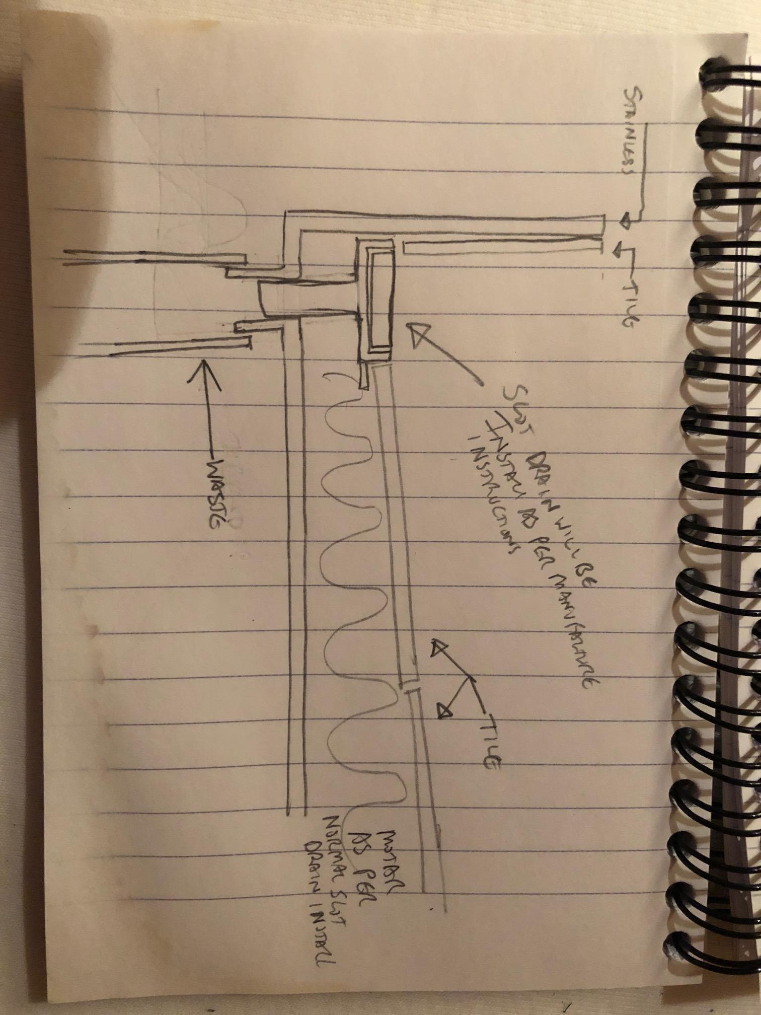

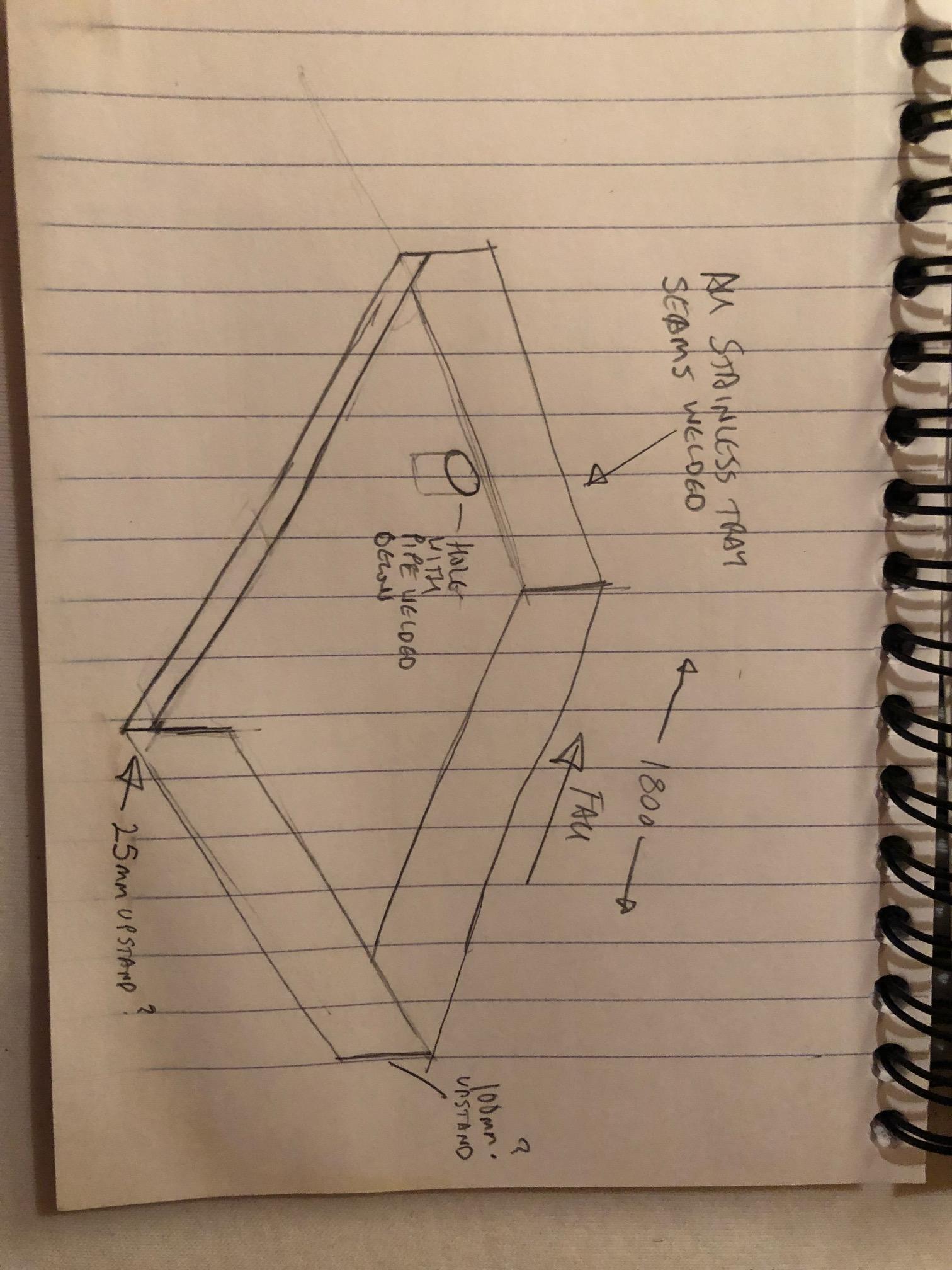

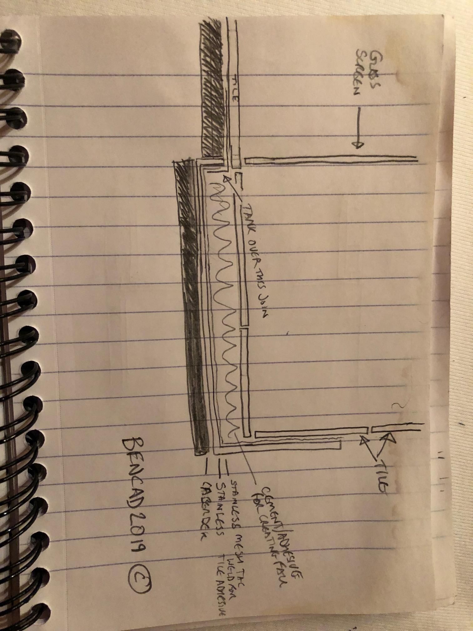

divorcingjack Posted February 14, 2019 Posted February 14, 2019 So, for our upstairs master bath, I would like a semi-wetroom, i.e. tiled showering area with small glass screen not sealed to the floor. We have an awkwardly sized showering space now due to having to build out the wall to accommodate various gubbins. Large, highflow shower. Not much money left. Linear drain, no diagonal cuts in 600x400 tiles, so the former needs to have 2 falls, not the standard 4. The only option I can find for a former is an impey linear 2, which is £600 just for the tray! Noooooo. So, my husband has come up with this plan. The architect says it's good. The joiner and steel fabricator think he's mad. The plumber is remaining noncommittal. He is 100% convinced that he has created a work of genius. The substrate is posi joists, overboarded with OSB. Was planning on marmox boards for walls (and floor?). Tiles are 15mm jura limestone. Plans below. Judge away!
Carrerahill Posted February 14, 2019 Posted February 14, 2019 I like it. As an engineer I design things everyday and coming up with new or unique solutions is what I enjoy best. The joiner and fabricator are just typical unimaginative "no" people who lack the ability to come up with new ideas and just follow blindly. Notice the person who likes it is the one who designs and creates new things for a living. The fabricator just need to be given a spec and told to build it, I really wouldn't care what anyone thought of it, the plumber probably secretly loves it because it should be an easy enough thing to connect up and shouldn't leak. Just check the dims with your plumber for the waste pipe stub - I would probably use SS pipe TIG welded to the tray that will push-fit or compression fit onto a standard waste connection - I am sure this has been thought of but get the plumber to help with that aspect to get what he would like to see - they you get him on board with it. Alternatively have them simply core the SS tray and then fit a standard type waste - I would ask them to punch a waste type "dimple" into the steel so it was the lowest point too. People will comment that you could just tank the floor and build it up with off the shelf materials, however, I think the saving on install time and the sure fire water tightness will help balance this out. Give your husband a pat on the back and compliment him on his creative thinking - this is exactly the sort of thing I would come up with. Got for it.
Jeremy Harris Posted February 14, 2019 Posted February 14, 2019 I think it's a good idea, too. My only concern would be how to ensure that the stainless tray is very well supported over the whole of the load-bearing area. It's quite probable that the stainless sheet will end up with some slight ripples in, as a consequence of welding the seams, and I think it will be important to ensure that whatever is underneath it is able to both bond the tray down well and take up any very slight unevenness. I doubt that there would be a problem in tiling over the tray, as long as it's very well supported so that it can't move. Not sure how best to bed the tray to the underlying floor, perhaps bed it on tile adhesive?

Onoff Posted February 14, 2019 Posted February 14, 2019 Needs TIG'ing for sure. Not sure how whatever mortar will adhere to the st/st. How about have the st/st exposed and making from chequerplate? Would need to be 316 and the welds acid cleaned. Pathology table anyone?

Onoff Posted February 14, 2019 Posted February 14, 2019 40 minutes ago, scottishjohn said: I don,t think you know how much that would cost .LOL Having worked with a fabricator who's TIG work is sh!t hot for over 30 years I think I might! Mate's rates etc... Chequer plate might actually aid in masking any distortion. I'd fold on the 4 sides and only weld there. I'd bed it down on 5 Star grout maybe. 1
Jeremy Harris Posted February 14, 2019 Posted February 14, 2019 At guess I'd say that a TIG welded stainless tray probably wouldn't cost more than a decent shower tray. Not a lot of work in folding and welding one up, and the plate cost would be somewhere around £200/m² at a guess, less if you have a local metal factor who takes cash for small quantities...

divorcingjack Posted February 14, 2019 Author Posted February 14, 2019 So, an update - we know a very good fabricator who will work for cakes and a reasonable amount of money. The stainless will not be seen in the final finish - only tiles. Although our architect has his exposed and they look great. We’re thinking to line the bottom with mesh to provide a key for tiling adhesive. I have forwarded this thread to husband for him to bask in glory.

PeterW Posted February 14, 2019 Posted February 14, 2019 I’ll go against the grain and say it’s a bad idea ... Stainless here would need to be quite thick, and you would need a serious mesh to get good adhesion (purely mechanical) to the the steel. Materials would be more than a former, and given you want to also tile it there is no real benefit over mild with 2 coats of red oxide. You could manufacture the same in fibreglass for £80-100 at most and do it in situ.
Danny68 Posted February 14, 2019 Posted February 14, 2019 Stainless costs a small fortune that's before its worked on, unless you are a fabricator or have a very good friend who would do it for the love then not really a starter imho, (I am a fabricator BTW ?) fiberglass can be fun to work with. 1
