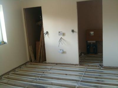

newhome Posted February 12, 2019 Posted February 12, 2019 I don’t have spreader plates. The supplier of the kit (Wunda) never specified them and we didn’t know we should have had them so the pipes were laid on foil as per the photo and then wood flooring put on top. The first thing @Nickfromwales said was ‘why don’t you have spreader plates’ but tbh now that the UFH is working ok upstairs and down it seems fine upstairs. I was told that I would feel warm bits of floor and cooler bits as the heat would spread evenly but I haven’t noticed that at all in truth. Â

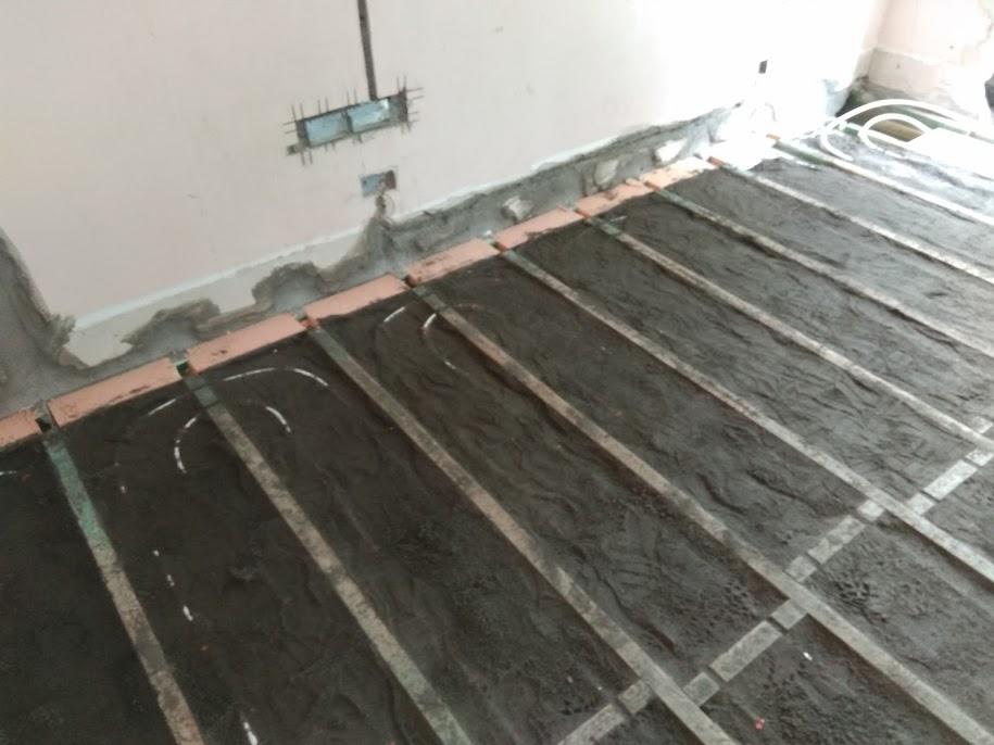

Dudda Posted February 12, 2019 Posted February 12, 2019 Oh I did something like @newhome above but I put in a dry biscuit mix (7 sand to 1 cement)  This is super cheap, easy to do yourself and acts as a thermal mass and controls the heat better than the aluminium plates and improves the sound insulation. Can't remember the cost exactly now but a guess was something like 10 bags of cement and a ton bag of sand for less than €100 for all of upstairs. Â

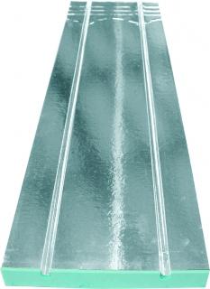

Triassic Posted February 12, 2019 Author Posted February 12, 2019 (edited) As I've also got to insulate the floor void, so I was wondering if I could simply use this grooved, between the joists, 50mm thick EPS insulation, from Pro-warm. At around £9.50 per board, it would save me spending £4.50 each on spreader plates?     Edited February 12, 2019 by Triassic 1

scottishjohn Posted February 12, 2019 Posted February 12, 2019 6 minutes ago, Triassic said: As I've also got to insulate the floor void, so I was wondering if I could simply use this grooved, between the joists, 50mm thick EPS insulation, from Pro-warm. At around £9.50 per board, it would save me spending £4.50 each on spreader plates?     was just writing what did which is similar--make them touch hard against floor. Â

Nick1c Posted February 12, 2019 Posted February 12, 2019 We put UFH upstairs in our previous house. I battened out the joists and put 50mm cellotex on it, the pipes were then put in and a mix of aggregate and cement (no sand) put in every alternate joist space. The SE didn't think there was enough strength in the spans for a normal screed over the pir. The ensuite had shorter spans so we went for standard screed. The standard screed worked best, followed by the aggregate, you could tell which were the 'alternate' joists. This was in a very leaky house though, with much lower flow temperatures in a more efficient build I am not sure how noticeable it would be (we had t&g solid wood floors). Not sure how this might work with I-beams or posijoists as battening would be problematical.Â
