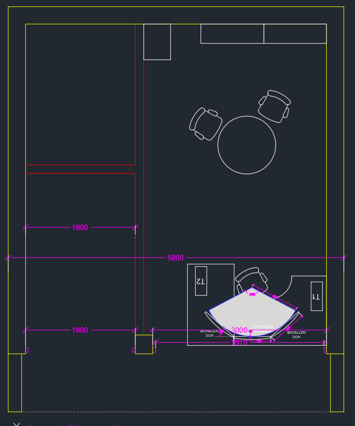

bikerchris Posted February 4, 2019 Author Posted February 4, 2019 (edited) Just in case anyone's interested, here's a rough plan so far. I've not included the fences on this view, but there's one to the back that's sort of mine, but the sides have normal 6 foot close boarded in a rickety condition. Oh, top left room is the tool store, bottom left room is her room if she wants it...otherwise more tool / workshop area for me, yey! ? And yes, not put doors in yet - minor detail on paper ? Edited February 4, 2019 by bikerchris
A_L Posted February 4, 2019 Posted February 4, 2019 Look at it from a heatloss point of view. Assuming an outside/inside differential of 20°C then with 150mm of PIR or equivalent on all six surfaces the heat loss is about 340watts, plus say 180watts for 6m2 glazing, ventilation of 0.5ach with no heat recovery is about 200watts. So about 720watts, then subtract input from solar/bodyheat/appliances. Do you really need a GSHP? 2
bikerchris Posted February 4, 2019 Author Posted February 4, 2019 23 minutes ago, A_L said: Look at it from a heatloss point of view. Assuming an outside/inside differential of 20°C then with 150mm of PIR or equivalent on all six surfaces the heat loss is about 340watts, plus say 180watts for 6m2 glazing, ventilation of 0.5ach with no heat recovery is about 200watts. So about 720watts, then subtract input from solar/bodyheat/appliances. Do you really need a GSHP? Thank you AL, that's a great perspective - thank you very much for doing the rough calcs, really kind of you. Has to be said that around 500-800 watts would be generated from the computers/monitors. The only thing that concerns me is when the temps go way down (or up), I know that Scotland can be extreme, but I can't work at 0C sitting at a desk. What I'm trying to create is a building that maintains an even temp all the time, just to preserve tools and electrical equipment as well as my own comfort. I want to be able to go in there any time of the year and be comfortable - sometimes I'd have to be in there for 10+ hours be it snowing or the hottest day of the year. The office I rent at the moment is horrible in the peak summer and only tolerable in winter. For the first time ever, I want to be able to control the ambient temperature and have it be the same all year round. The other thing I don't want, is to have to do GSHP after it's built, it would just be hassle and regret. Of course, if someone said that a GSHP config for what I want is around £5-10k, I'd walk away from the notion of having GSHP. Having an ASHP seems to be cheaper, but then you've got external noise, plus it'll look fuggly. Anymore comments really are welcome. ?
