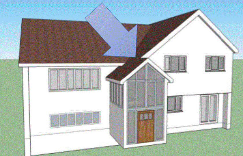

Lift span Posted January 28, 2019 Share Posted January 28, 2019 Hello all, We have a split level house with an ugly front which is in need of a re-design. The entrance way was originally via external steps up to the first floor. The lack of any proper membrane resulted in a lot of penetrating damp so I've removed the steps plus earth and rubble that was against the house and now we are damp free. I'd like a double height entrance hallway with lots of light. Attached is an idea I've had for a completely new look. What do people think? Although it looks like a bungalow the left side of the house has two storeys also as the bottom floor is sunken at the back. The entrance way would step down into this level. FrontJan2019v2.pdf 1 Link to comment Share on other sites More sharing options...
ProDave Posted January 28, 2019 Share Posted January 28, 2019 That new entrance certainly looks a lot better. A floor plan might make more sense of how it would connect to both floors. Link to comment Share on other sites More sharing options...
epsilonGreedy Posted January 28, 2019 Share Posted January 28, 2019 14 minutes ago, Lift span said: What do people think? Generally looks good for diy architecture though I am having a bad reaction to the roof angle of the dormer window. Which way does the double height entrance atrium face? Link to comment Share on other sites More sharing options...

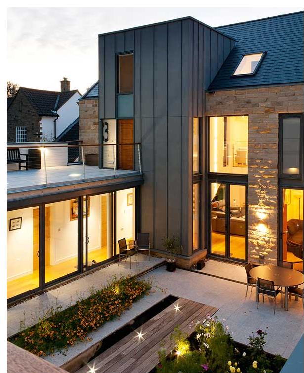

ultramods Posted January 28, 2019 Share Posted January 28, 2019 I don't like the sloped roof on the atrium, have you considered a flat roof, something like this? Link to comment Share on other sites More sharing options...
jack Posted January 28, 2019 Share Posted January 28, 2019 12 minutes ago, ultramods said: I don't like the sloped roof on the atrium, have you considered a flat roof, something like this? Beat me to it, I agree. I do like the way the double-height bit in the middle comes out from the rest of the house, but it doesn't (to my eye) work where its roofline meets the roof to the right. You could also consider whether having a dual pitched roof over the atrium might work - could be a bit fussy getting it to sit with the rest of the roof though. To my eye, the windows under the dormer look like they're too far to the right. It think they might look better moved to the left to leave some space between them and the double-height section. Not sure how that works with the dormer above. I like the mix of materials, although I'm not sure about the cladding to the bottom left. To me, cladding feels lightweight, and shouldn't sit underneath heavier-looking construction. I'm not a huge fan of the wide roof over the dormer on the left. I see why you've done it in terms of pitch-matching, but it draws more attention to itself than I think is ideal. Overall though, it's a great start - fantastic improvement over what you're starting with. Oh, and before you go too far, have you considered solar gain given how many windows are being introduced to this elevation? Link to comment Share on other sites More sharing options...

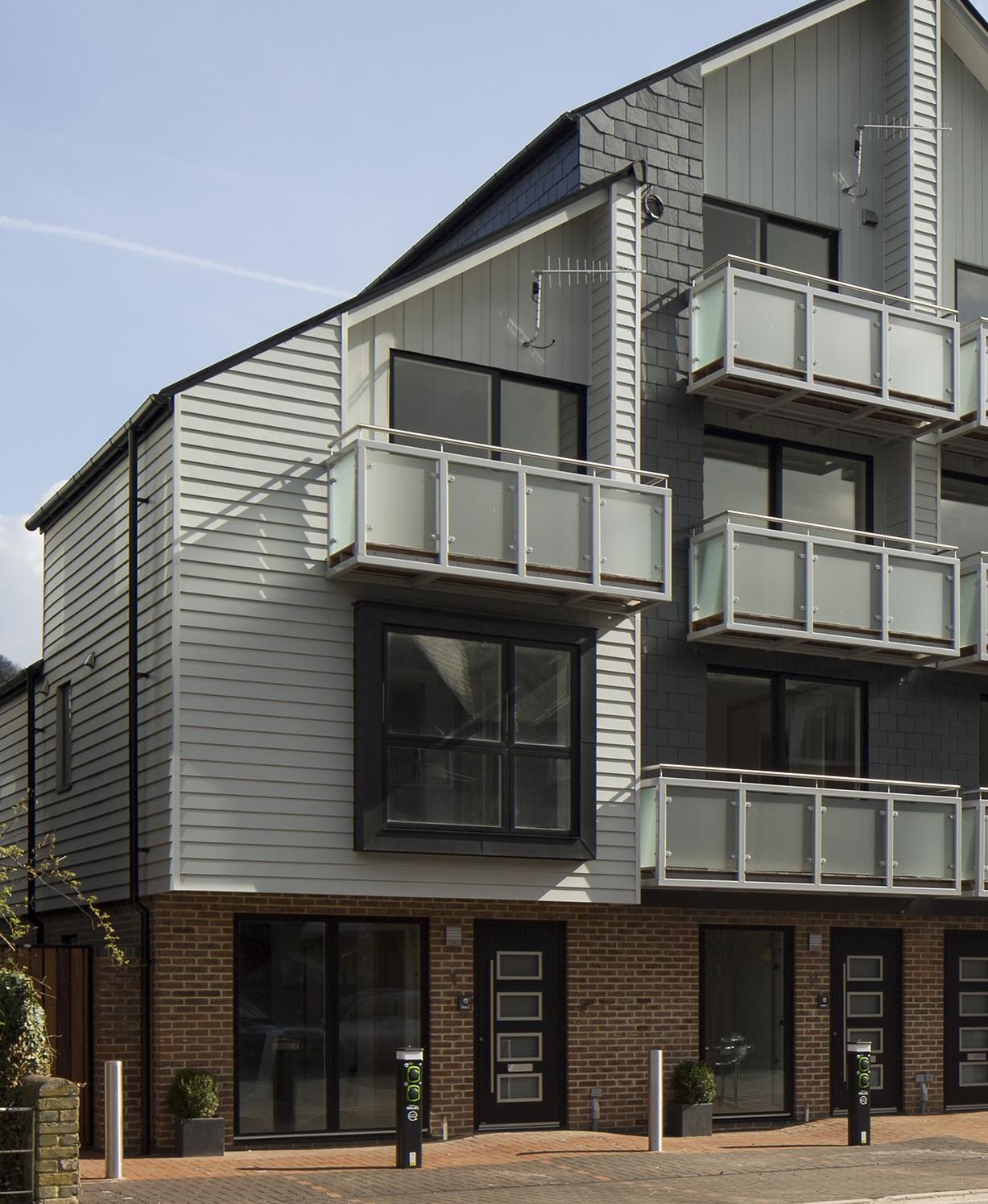

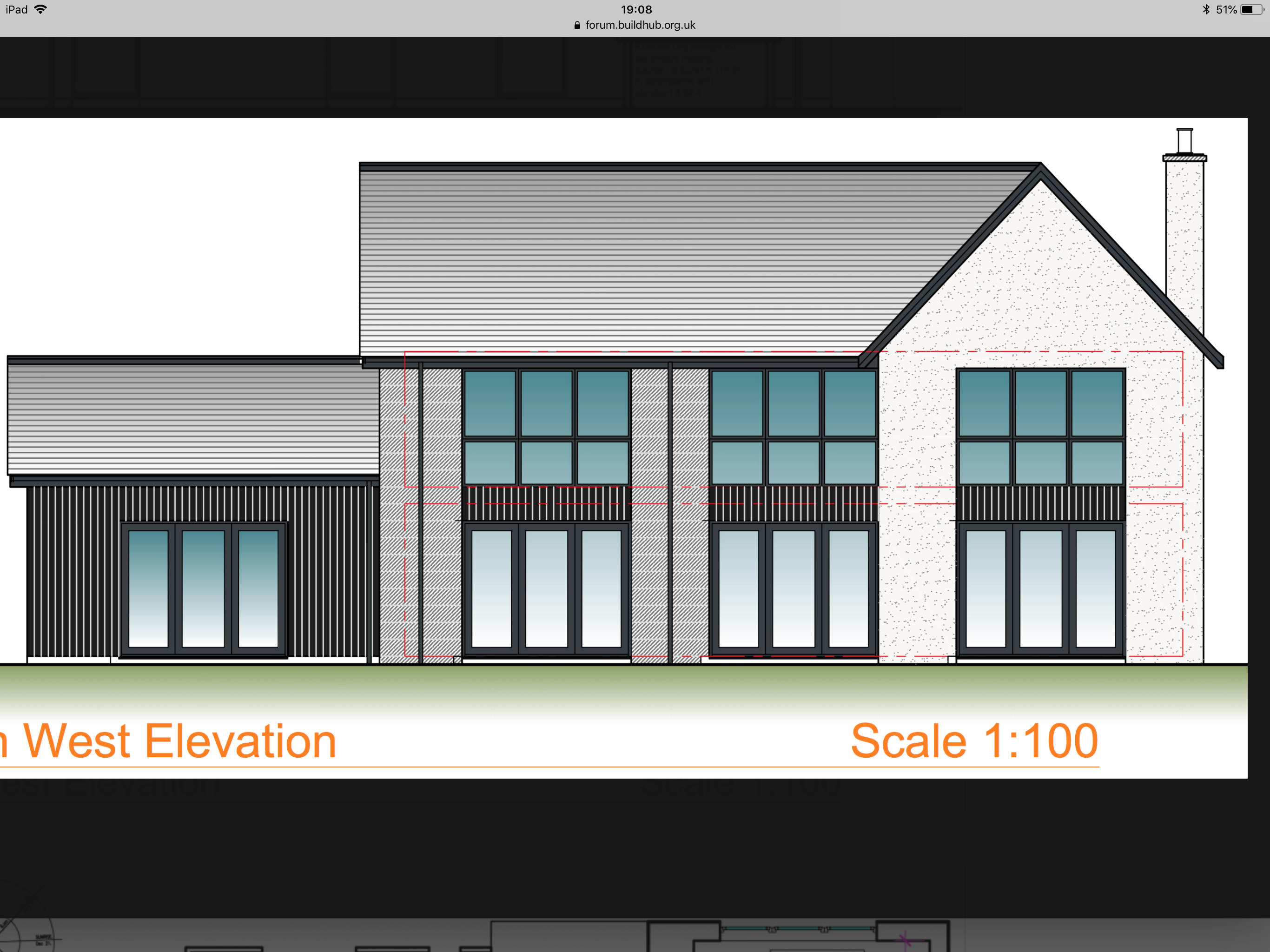

Mr Punter Posted January 28, 2019 Share Posted January 28, 2019 I am with @ProDave it looks like it was designed by Escher. The section on the left below has a monopitch roof that works OK as it is set a bit lower than the adjacent roof. Also, as @jack suggests, cladding above masonry = OK, not the other way round. Link to comment Share on other sites More sharing options...

ultramods Posted January 28, 2019 Share Posted January 28, 2019 I still don’t think it looks right. Do you need the glass section to “stick out” from the rest of the house? I have double height glass, but it’s all flush with the rest of the house. Link to comment Share on other sites More sharing options...
