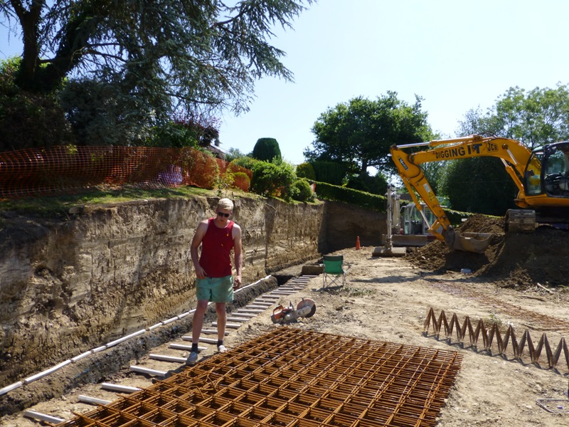

Jeremy Harris Posted January 26, 2019 Posted January 26, 2019 Yes, that 45 degree down from the outer edge of the foundations is a worst case critical angle of repose for soil (bearing in mind that the critical angle of repose is measured upwards from the lowest horizontal point, i.e. the base of the trench). The critical angle of repose for soil ranges between 30 deg and 45 deg, so as a downward angle from the foundation, measured relative to surface level, the angle translates as between 45 deg and 60 deg for normal soil. For something like compacted clay the angle is much steeper, and can be near vertical, as seen below in the up to 2.5m deep excavation we did in order to level our plot.
Mr Punter Posted January 26, 2019 Posted January 26, 2019 You are looking rather fit in that picture Jeremy. 3
Declan52 Posted January 26, 2019 Posted January 26, 2019 6 minutes ago, Mr Punter said: You are looking rather fit in that picture Jeremy. The before picture before the stress of a self build had took its toll. 2
