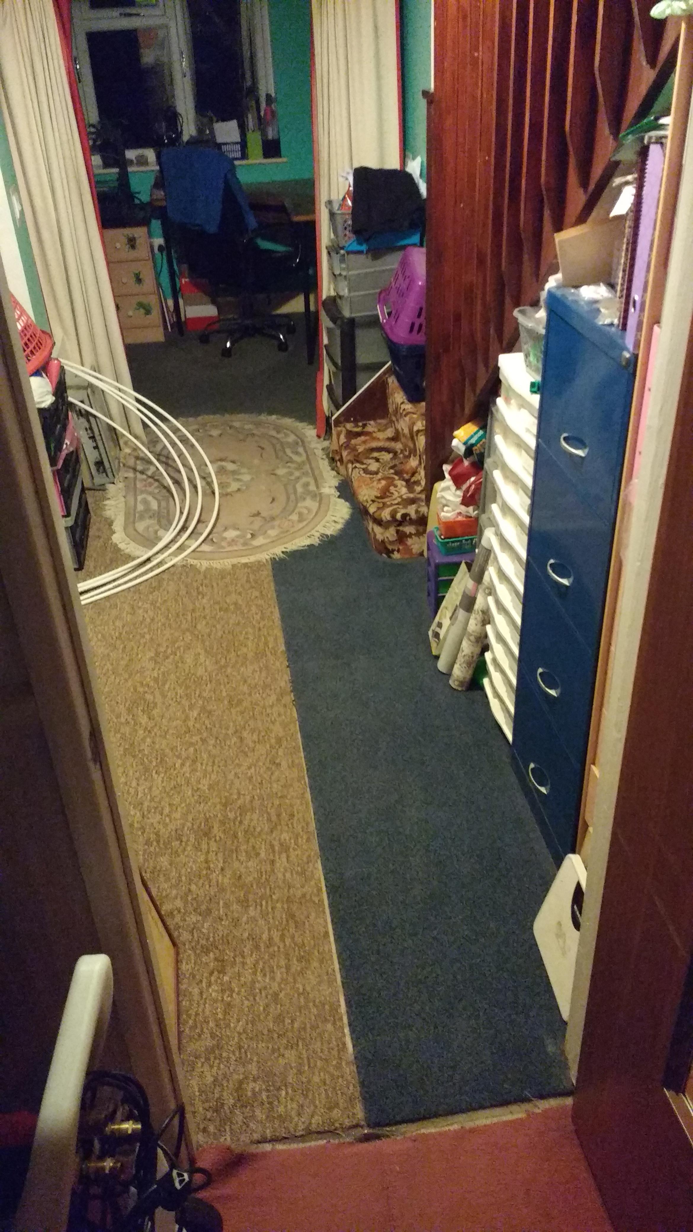

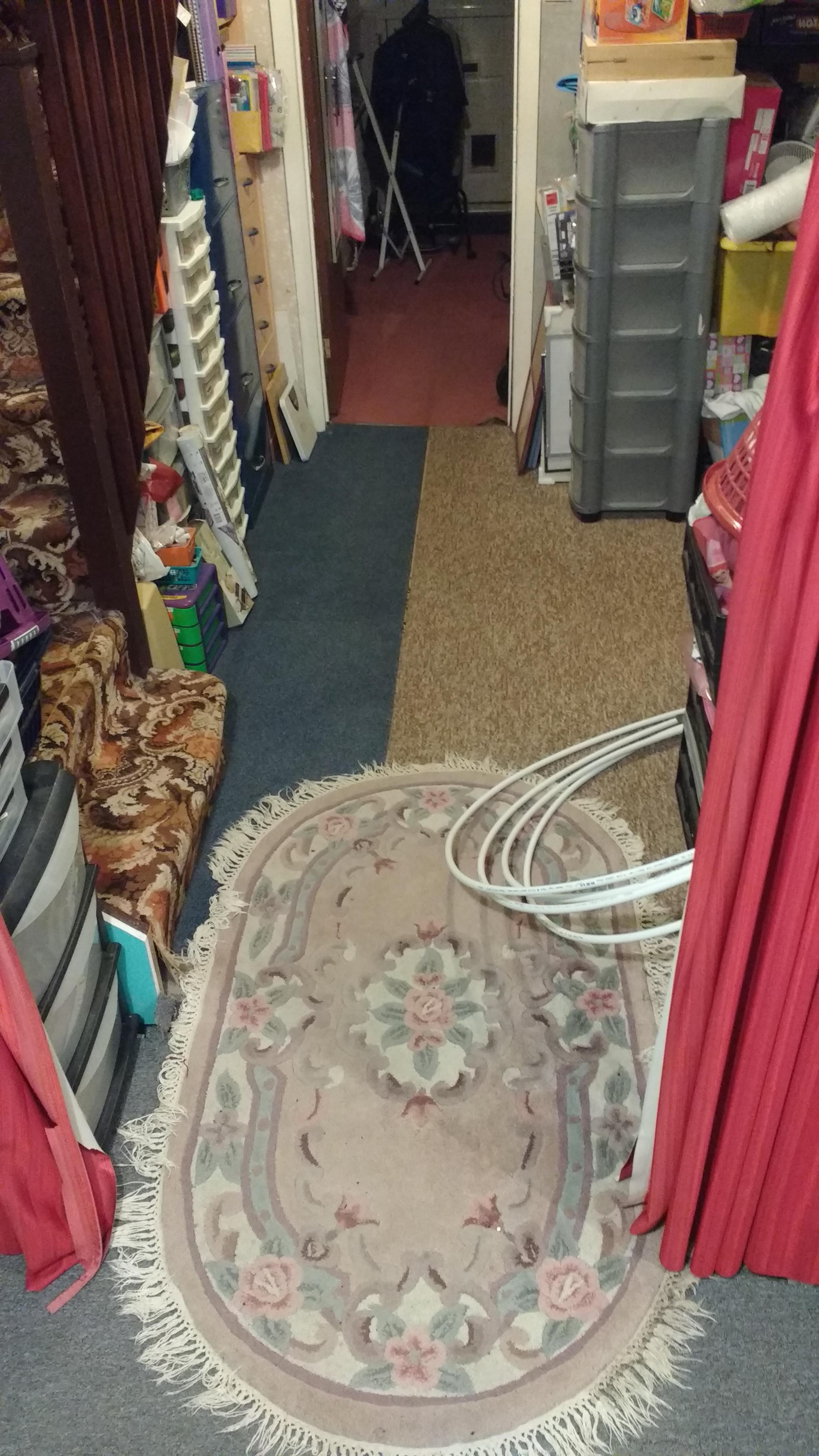

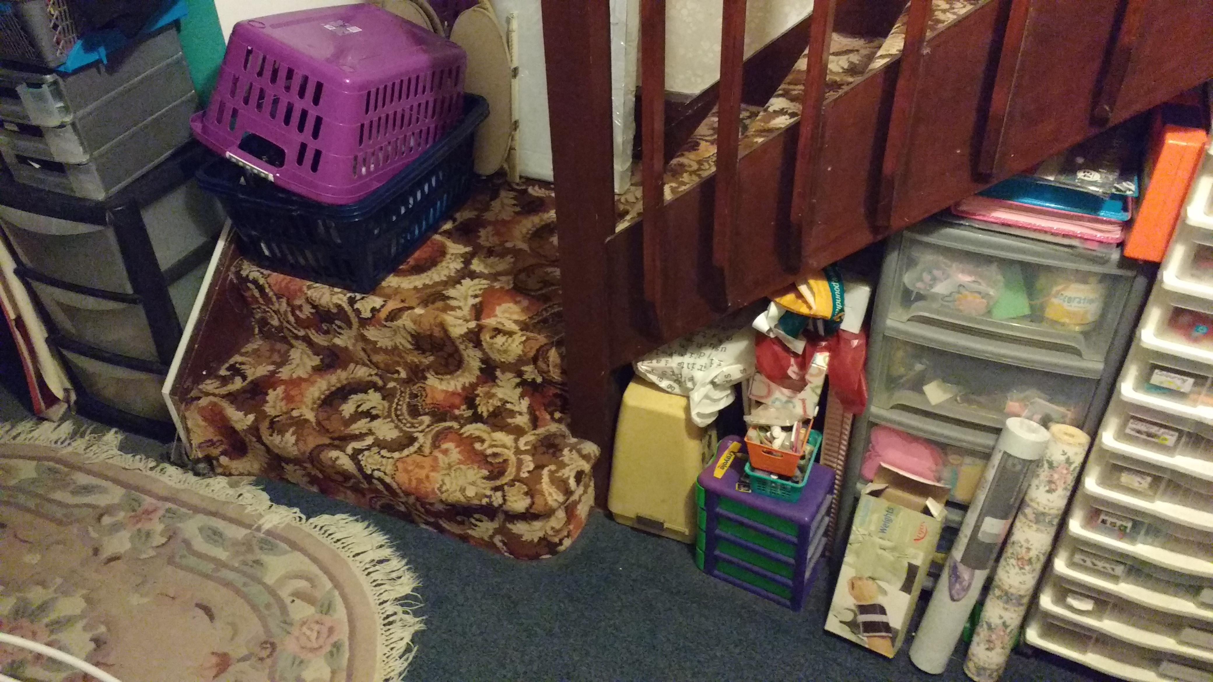

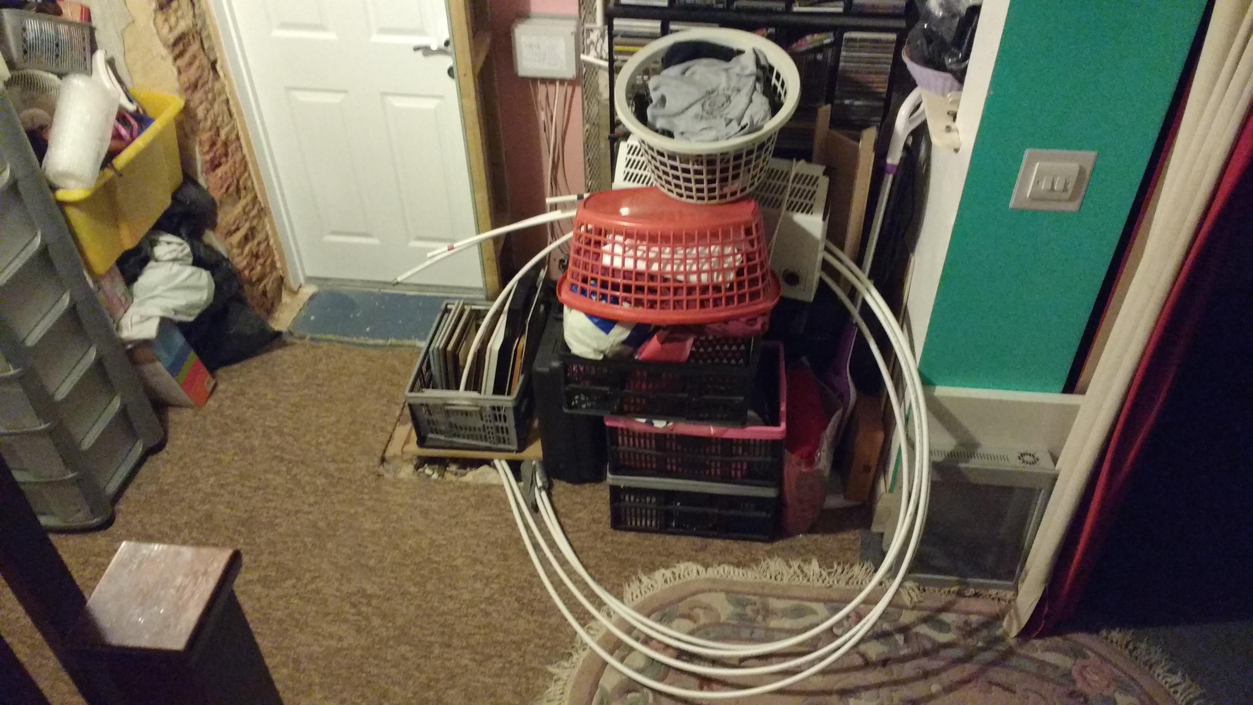

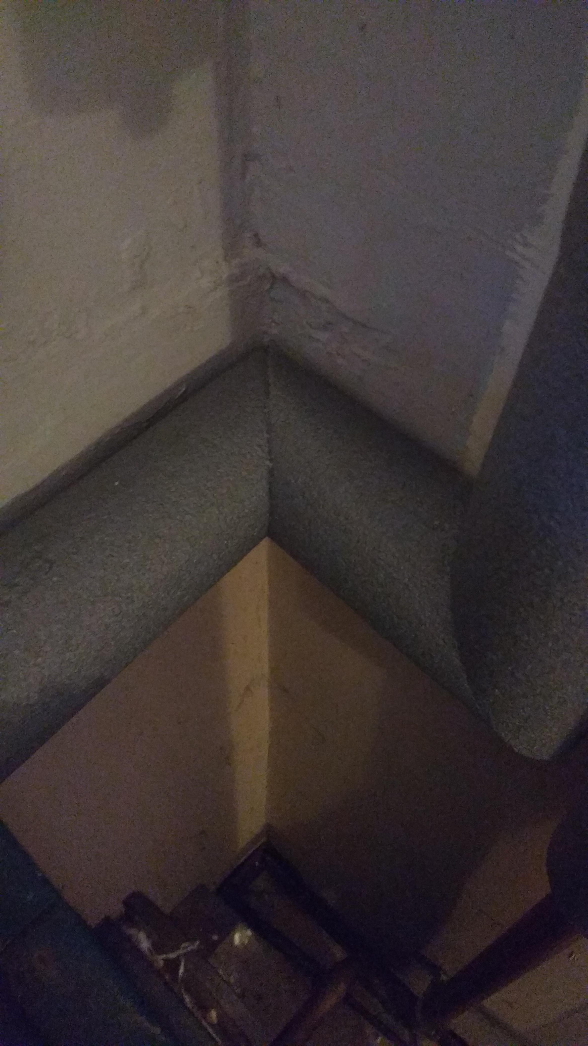

Onoff Posted November 14, 2020 Author Share Posted November 14, 2020 So all I need to do is dig this floor up now! (The one that's half carpeted in blue tiles): I'm really not sure what to do with the bit of the original floor under the bottom landing? The plan is to dig down like I did in the bathroom and rebuild back up with 150mm of pir. So from the top. Carpet 100mm concrete slab 150mm pir DPM 25mm eps Sand blind Compacted Type 2 - 50mm min Of course I've to clear out and find a home for all this hoarded sh!t first! Link to comment Share on other sites More sharing options...

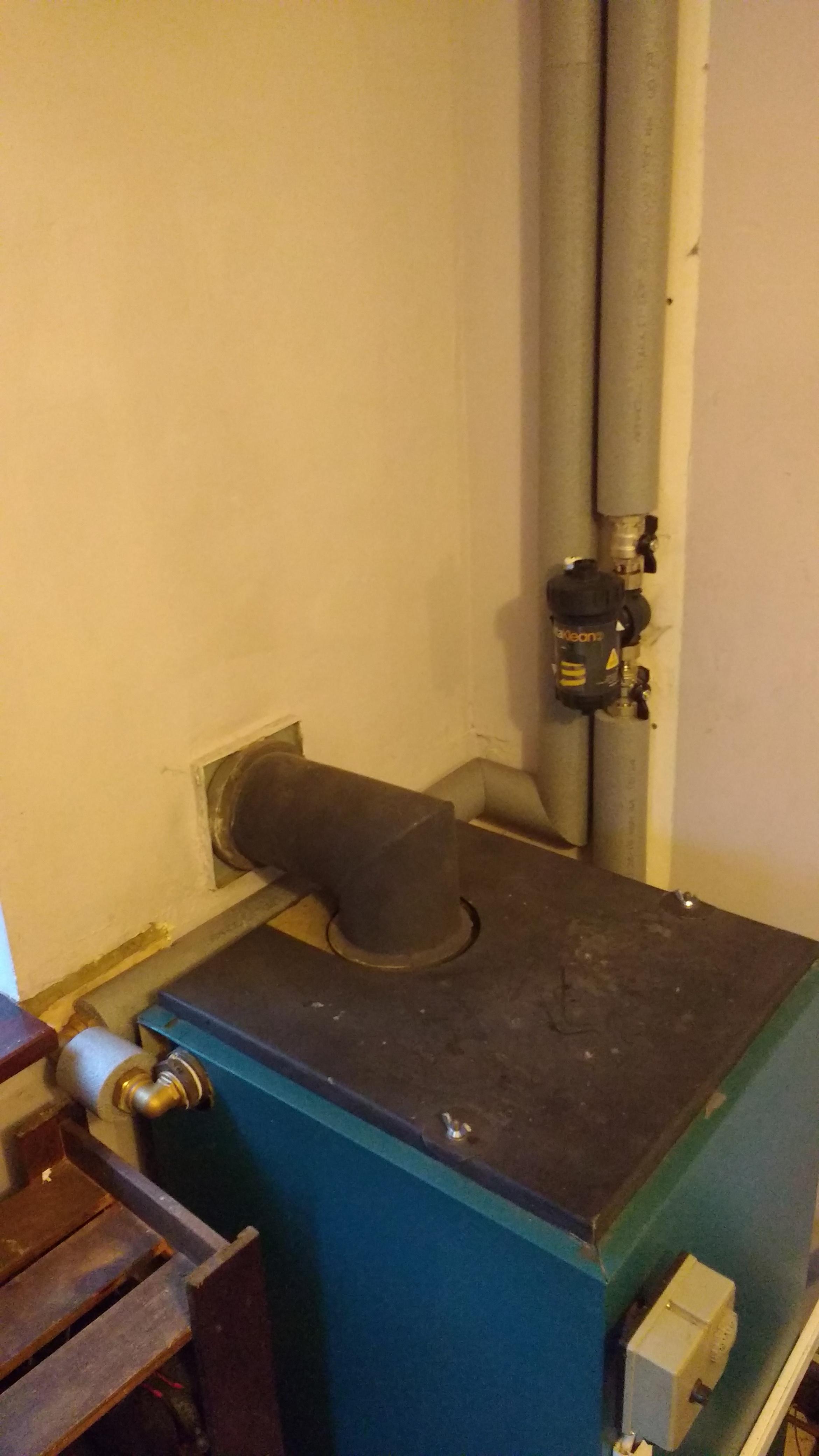

Onoff Posted November 15, 2020 Author Share Posted November 15, 2020 What's the done thing to insulate, pumps, valves & compression joints for instance? It's easy enough to do a neat job on say soldered elbows: But here, say the elbows and the mag filter, just thinking the losses must be quite high through uninsulated components. Cheers Link to comment Share on other sites More sharing options...
PeterW Posted November 15, 2020 Share Posted November 15, 2020 Just go up a size on the insulation. 22mm is pretty good on 15mm compression, 28mm on 22mm fittings. Cut and bonded with decent 50mm insulation tape. Link to comment Share on other sites More sharing options...
Onoff Posted November 15, 2020 Author Share Posted November 15, 2020 6 minutes ago, PeterW said: Just go up a size on the insulation. 22mm is pretty good on 15mm compression, 28mm on 22mm fittings. Cut and bonded with decent 50mm insulation tape. Thanks. These pipes though are 28mm in the pictures. Link to comment Share on other sites More sharing options...
PeterW Posted November 15, 2020 Share Posted November 15, 2020 28mm nuts need 35mm insulation https://www.jtmplumbing.co.uk/insulation-c555/climaflex-polyethylene-pipe-insulation-c556/climaflex-pipe-insulation-2m-lengths-same-as-tubolit-pipe-diameter-x-wall-thickness-x-length-p5251/s5261 Link to comment Share on other sites More sharing options...
Onoff Posted November 15, 2020 Author Share Posted November 15, 2020 13 minutes ago, PeterW said: 28mm nuts need 35mm insulation https://www.jtmplumbing.co.uk/insulation-c555/climaflex-polyethylene-pipe-insulation-c556/climaflex-pipe-insulation-2m-lengths-same-as-tubolit-pipe-diameter-x-wall-thickness-x-length-p5251/s5261 I'll try the local plumber's merchants. Thanks. Link to comment Share on other sites More sharing options...
Onoff Posted November 17, 2020 Author Share Posted November 17, 2020 All MY tat is out of the stairs room. I said to SWMBO that I'm ready to dig the floor up. "I've nowhere to put it all!" she said aka the ceiling high piles of hoarded stuff. Can't pin the delay on me luv! ? Link to comment Share on other sites More sharing options...

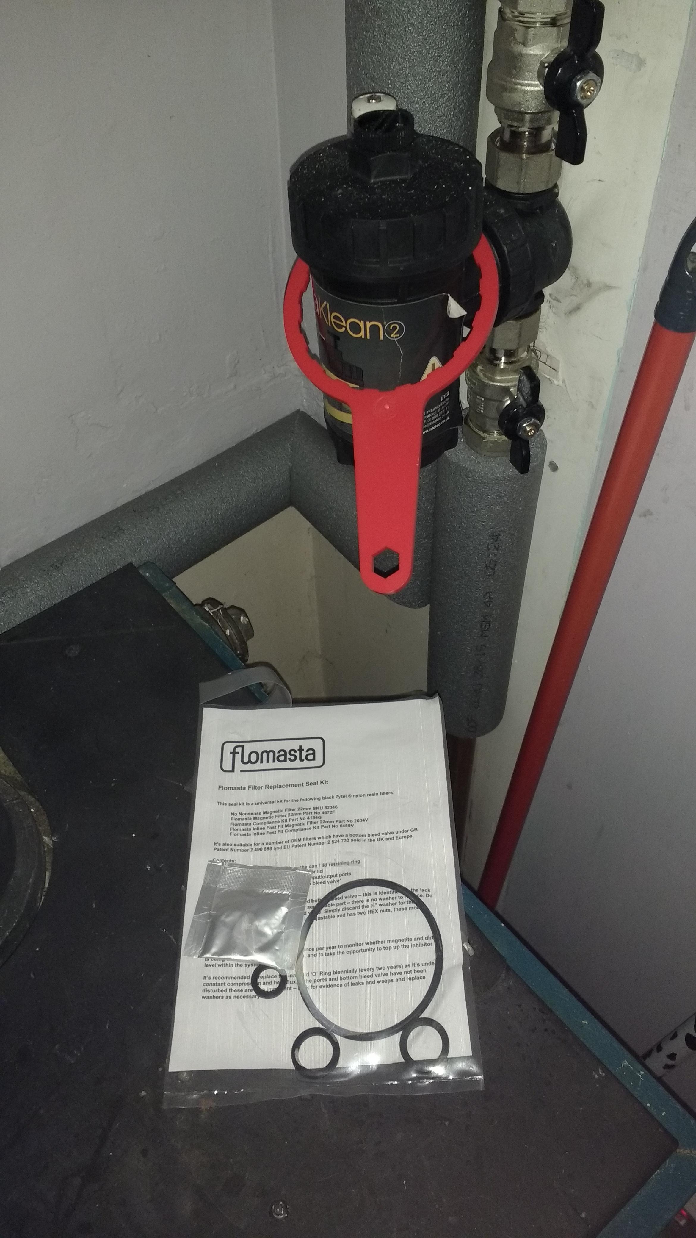

Onoff Posted November 21, 2020 Author Share Posted November 21, 2020 On 14/11/2020 at 18:09, PeterW said: From memory it is the same as the Flomasta one and you can get spares from S’Fix https://www.screwfix.com/p/flomasta-magnetic-filter-seal-service-kit/3287V Never mind, I'll draw one up and get my lad to print when back from uni: ? Link to comment Share on other sites More sharing options...

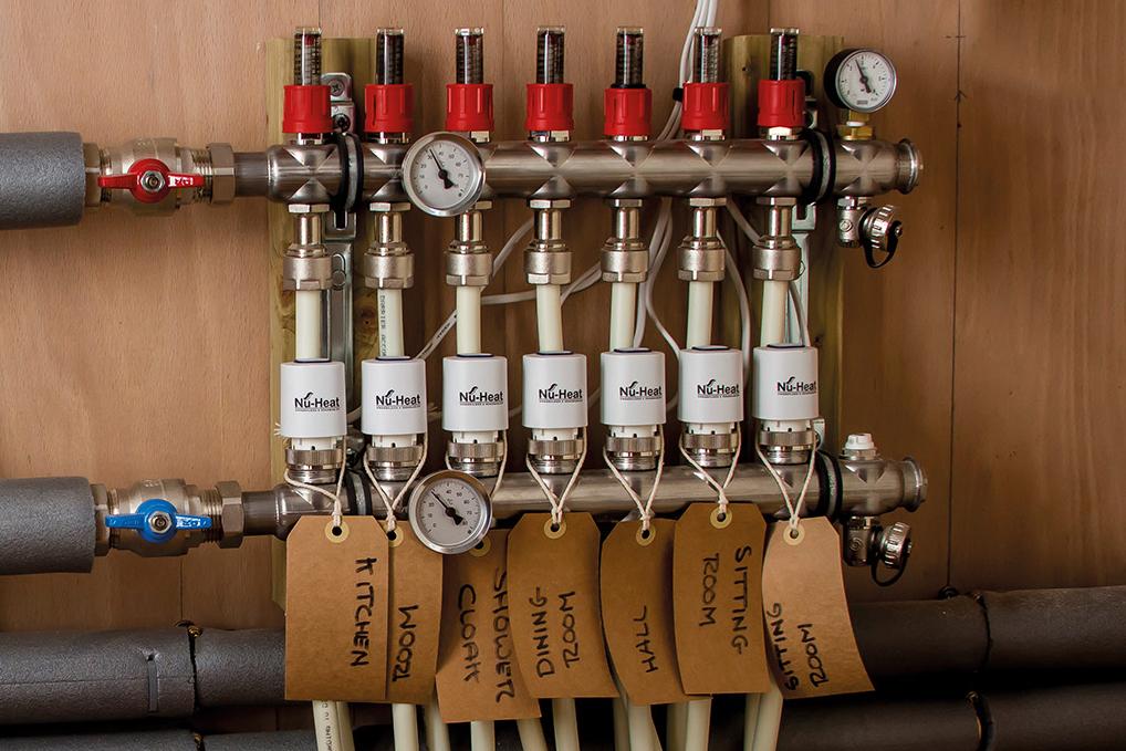

Gav_P Posted November 21, 2020 Share Posted November 21, 2020 Example (quick google search) this manifold has 7 loops with actuators, so could be controlled as 7 different zones or all 1 zone. Link to comment Share on other sites More sharing options...
Onoff Posted November 22, 2020 Author Share Posted November 22, 2020 7 hours ago, Gav_P said: Example (quick google search) this manifold has 7 loops with actuators, so could be controlled as 7 different zones or all 1 zone. That's actually very helpful thanks. The Nu-Heat actuators are in fact solenoid operated valves then, controlled by individual room stats potentially? Link to comment Share on other sites More sharing options...
Onoff Posted November 22, 2020 Author Share Posted November 22, 2020 7 hours ago, Gav_P said: Are you using a manifold? If so you will have an actuator on each loop. Otherwise every zone will need a zone valve I would think. my downstairs only has 1 stat and that controls 4 actuators and a 2 port valve. Following on from my last post, why the 2 port and actuators? Link to comment Share on other sites More sharing options...
PeterW Posted November 22, 2020 Share Posted November 22, 2020 Probably because it is wired as 2 zones, upstairs and downstairs. A lot of systems are done like this so they can use the zone valve micro switch as a call for heat to the boiler. For yours I would go straight in with the Salus self balancing actuators as they will control the return temps better as you have a more “leaky” house. Are you keeping Rads upstairs ..?? 1 Link to comment Share on other sites More sharing options...
dpmiller Posted November 22, 2020 Share Posted November 22, 2020 Other than the Salus auto-balancing actuators Clive, they tend to be wax-expansion rather than solenoid. Bit like a TRV body with a heating element integrated. As the actuators only take a few Watts it's no problem paralleling them, or instead you can link the inputs in the wiring box. And you'll probably need one of those, to get pump and boiler switching, delay tiing etc... 1 Link to comment Share on other sites More sharing options...
ProDave Posted November 22, 2020 Share Posted November 22, 2020 A few basics. Most of the actuators used in UFH manifolds are hot wax rather than a mechanical motor. The picture above showed a UFH manifold without a temperature blending valve. Make SURE you include a temperature blending valve to regulate the flow temperature in the UFH and a manifold pump to circulate the water around the UFH loops. It is normal to have a control box with each manifold. this reads all the room thermostats and it's job is to turn the manifold pump on when any room calls for heat, open the actuator(s) for that room, and provide the "call for heat" to the boiler when any room is asking for heat. In a new system use 2 port valves to direct heat to manifold(s) radiators and DHW as required. Do not use 3 port and especially 3 port mid position valves, they are the work of the devil imho, I have individual room thermostats in my house. What is very interesting from that is the utility room takes very much longer to heat up and keeps asking for heat long after the other rooms are satisfied. This is a general finding I have found that rooms like our utility room that use aluminium spreader plates put less heat into the room than the rest of our ground floor that has the pipes set in dry sand/ cement pug mix. 1 Link to comment Share on other sites More sharing options...
