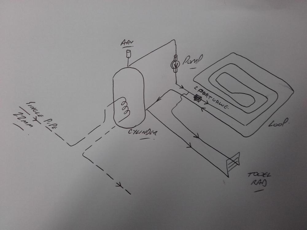

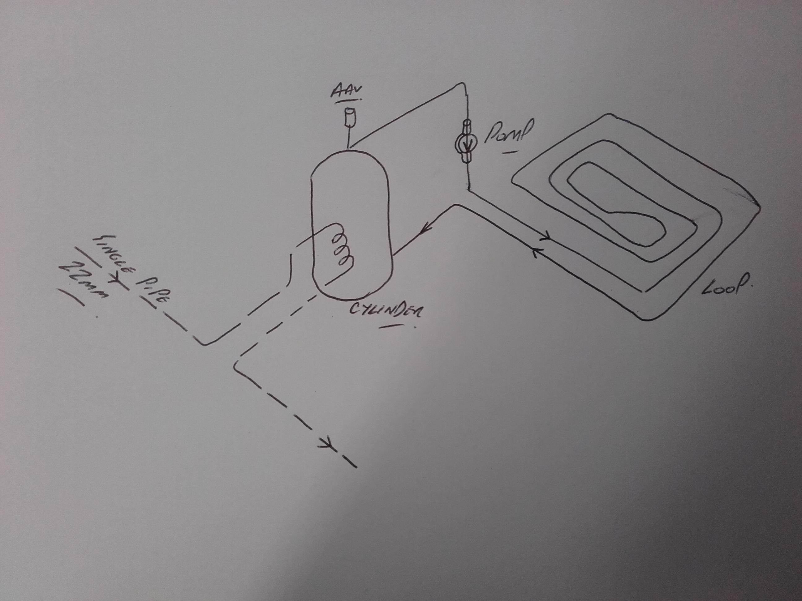

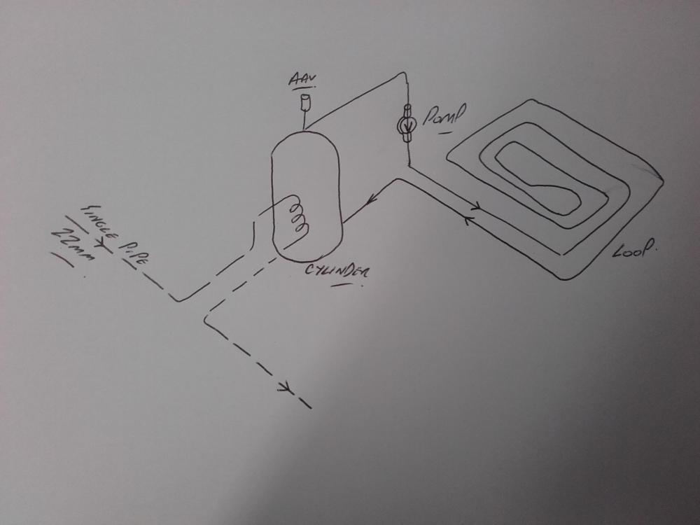

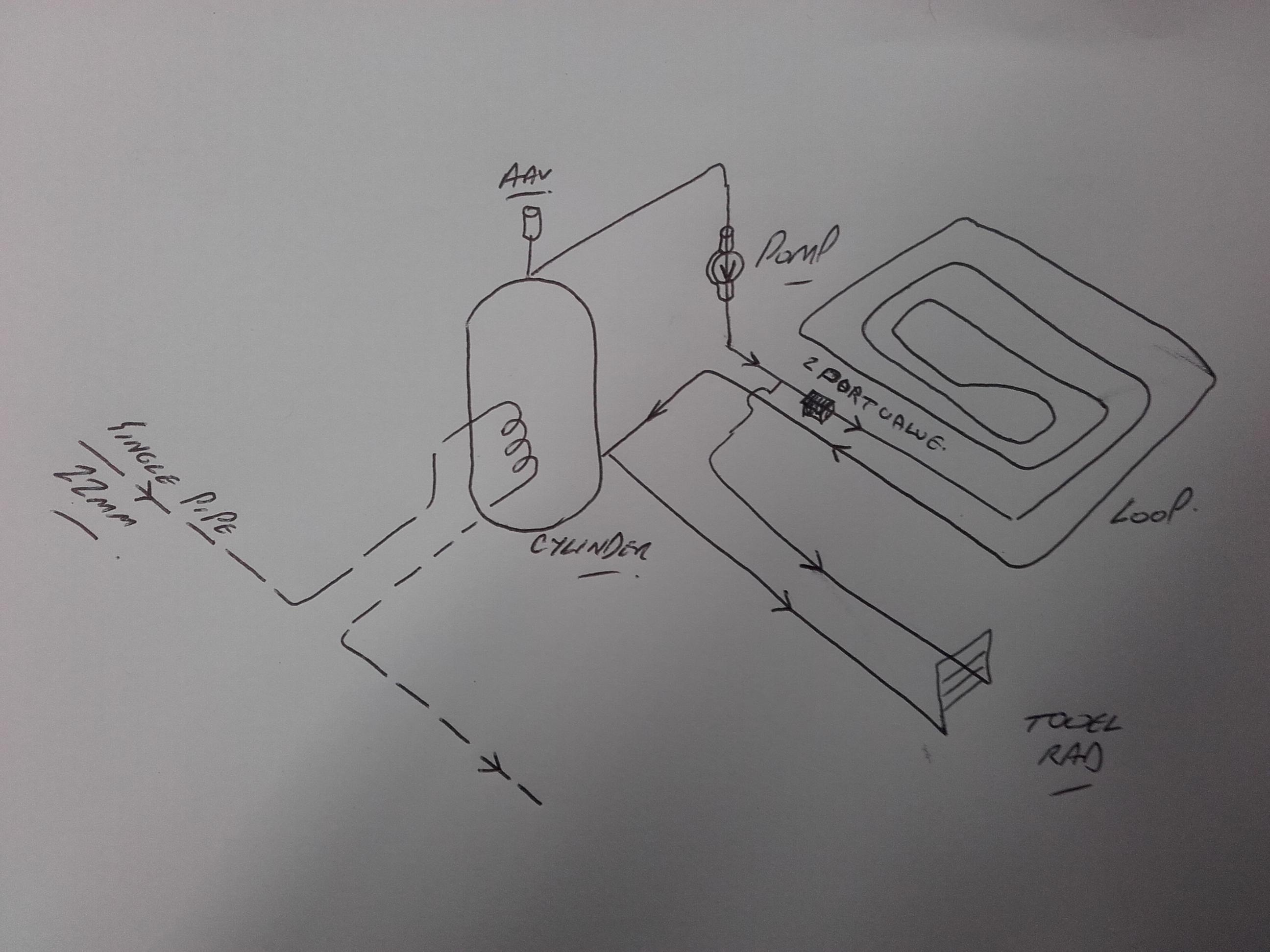

Onoff Posted January 16, 2019 Share Posted January 16, 2019 (edited) Bear with me as this might sound a bit mental! Current downstairs heating is a 50 year old 3/4" nominal bore system. New bathroom refurb has x1 UFH loop in the floor and a second loop purely for a towel rad. I don't really want to connect a manifold to the old single pipe system and get it and the new loops crudded up. Now for the mad bit... Thinking that as I've a spare copper cylinder I could divert the single pipe CH through the coil of the cylinder. Then fill the cylinder and pump that via a manifold around my two loops. I've an in slab stat I could use to control the pump. Thus I'd keep old and new systems separate. An aside is that the room where the "buffer" cylinder would be sited would get some heat from the cylinder as there's no heating there at the mo aside from the single pipe across the floor that I'd look to tap off of to feed the cylinder. Thinking it'd also maybe put less strain on the oil boiler. So stat calls for heat and pump simply circulates some hot through the loop (s). But would it be too hot as there's no blending? ??? Cheers Edited November 7, 2020 by Onoff Link to comment Share on other sites More sharing options...

Onoff Posted January 16, 2019 Author Share Posted January 16, 2019 8 hours ago, ProDave said: That sounds like a good plan. You will need a header tank would that go in the loft or just above the cylinder? Cheers. A daft question I'm sure but do I have to have a header tank? Could I maybe treat the water in the cylinder as a semi sealed system, add inhibitor and put an AAV on top of the cylinder? Is there really any need for an expansion pipe? Rough sketch shown less the manifold. As the sketch stands I'm thinking there's an issue as the UFH loop would run too hot i.e. at the temp of normal rads. Appreciate it's bit off the wall. Link to comment Share on other sites More sharing options...
Onoff Posted January 16, 2019 Author Share Posted January 16, 2019 Maybe add a 2 port valve to stop the UFH loop getting too hot? Have it cutting off via the floor stat? Link to comment Share on other sites More sharing options...
ProDave Posted January 16, 2019 Share Posted January 16, 2019 Better would be a 2 port on the input to the tank, driven by a tank stat so it only heats the buffer to the required temperature. Normal "1 pipe" system bypass when the 2 port is closed. Link to comment Share on other sites More sharing options...
Ed Davies Posted January 16, 2019 Share Posted January 16, 2019 Without an expansion tank, where would the water expand to as it warms up? Why wouldn't the tank burst? Or crinkle up as it cools down? Link to comment Share on other sites More sharing options...
Onoff Posted January 16, 2019 Author Share Posted January 16, 2019 1 hour ago, ProDave said: Better would be a 2 port on the input to the tank, driven by a tank stat so it only heats the buffer to the required temperature. Normal "1 pipe" system bypass when the 2 port is closed. Ta. I want though the UFH and towel rail at two different temperatures I'm thinking. Link to comment Share on other sites More sharing options...
ProDave Posted January 16, 2019 Share Posted January 16, 2019 3 hours ago, Ed Davies said: Without an expansion tank, where would the water expand to as it warms up? Why wouldn't the tank burst? Or crinkle up as it cools down? Agreed it needs a header tank. Link to comment Share on other sites More sharing options...
