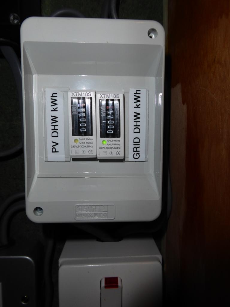

Just taken a photo of the two energy meters that I have connected to the Sunamp.  One is connected to the PV diverter, so records the energy we get from excess PV generation, the other is connected to the boost time switch so records the energy used when we boost the Sunamp during times when there isn't enough excess PV generation.

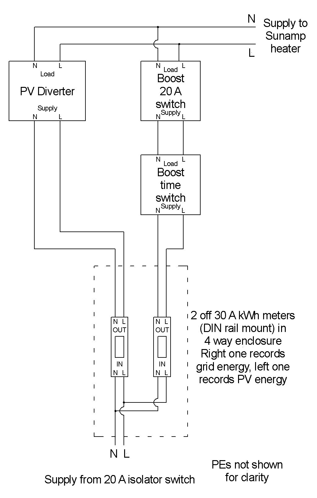

@JSHarris, sorry to be a pain, but do you have a wiring diagram and a kit list,  as I need to start buying the kit and could build it during the dark nights!
Here's a rough and ready diagram, with the PEs (earths) left off for clarity (all PEs need to be carried through each box):
Some items, like the the time switch and the PV diverter, only switch the line, so the neutral is just passed through the box.  The boost switch is a 20 A DP isolator with a neon indicator, that allows the timed boost to be turned off in summer, when it most probably won't be needed, as there should be enough excess PV generation.  Using a DP switch with a neon on the load side is useful as it will light up as the PV diverter pulses power to the Sunamp, and will stay on continuously when the time switch is in boost mode.  The boost time switch is a standard, cheap, immersion heater one.  I have ours set to come on at 03:30 and off and 06:00, just to make sure that the Sunamp has enough charge for our morning showers.  If the Sunamp is already charged from excess PV generation the day before it won't draw any power during the boost time, as it will just keep it's contactor closed.
