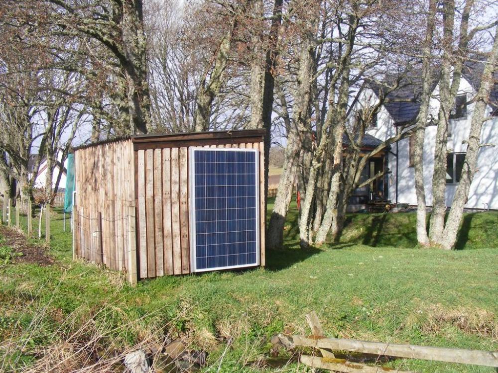

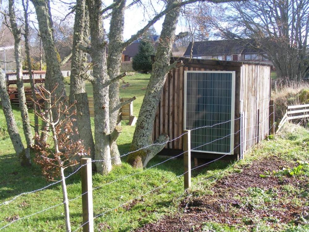

Ed Davies Posted September 15, 2019 Share Posted September 15, 2019 On 18/03/2019 at 14:34, ProDave said: So continuing with the above post, I am now thinking of fitting these 2 spare panels. As I have decided on one facing E and one facing W to try and squeeze a bit more out of both ends of the day, my thought are turning to a suitable inverter and how to connect them. … So how to connect them? I would say connect them in parallel, as only one will be generating at a time. The question is what effect witll the non generating panel have? Will it zap some of the power or just sit there as a high impedance load doing nothing? Should I put s series diode in series with each panel so only the higher voltage panel does anything and the other cannot back feed and zap power? Someone must have done this befoe and know how best to connect them. Just come across this video with some nice demonstrations of the effect of shading parts of a panel when there are two connected in series or parallel. If shading is likely to be a problem (as in @ProDave's case it definitely is) then this confirms that parallel is the right answer. https://www.youtube.com/watch?v=1qD3mN8VotQ Their results are very much in line with what I'd expect. 1 Link to comment Share on other sites More sharing options...

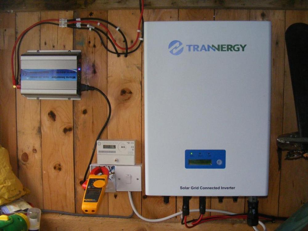

ProDave Posted October 28, 2020 Author Share Posted October 28, 2020 A couple of weeks back, I noticed there was nothing being diverted to my immersion heater. A quick check in the shed revealed the main inverter was showing "Grid disconnected" further investigation found the 32A mcb feeding the shed had tripped (but not the 16A inverter MCB in the shed) So I reset that and the main inverter powered up again. The cause of the trip was the little cheap Chinese inverter connected to my 2 spare panels had blown. Having failed at just under 2 years old I was not particularly liking the idea of buying another, but there is nothing else available anything like as cheap. So time to take it apart and see if a repair was possible. Inside a PCB mounted fuse was blown and some basic testing found that 2 of the transistors that make up the H bridge that synthesises the output waveform were blown, short circuit. So i ordered 5 of them from ebay from China for £5 They arrived yesterday and i fitted them and cautiously powered it up and it's working again, so this morning I put it back into service. It will be interesting to see how long it lasts before failing again. What I did notice is they were very short on the heat sink paste, with it only applied to one side of the insulating washer, so it's pasted up a bit better now. 2 2 Link to comment Share on other sites More sharing options...
ProDave Posted November 10, 2020 Author Share Posted November 10, 2020 Another observation about my repair of the cheap little Chinese inverter. When testing it, I found it's output is pulsed, in very much the same way as my solar PV dump controller is. And just like that it appears the duty cycle is varied to adjust the power output. I wasn't expecting this. I guess it makes it easy to design the inverter as it only has to synthesise a simple grid sychronised output and vary the power by pulsing it on and off. I wonder if the big "proper" inverters work the same way or not? Link to comment Share on other sites More sharing options...

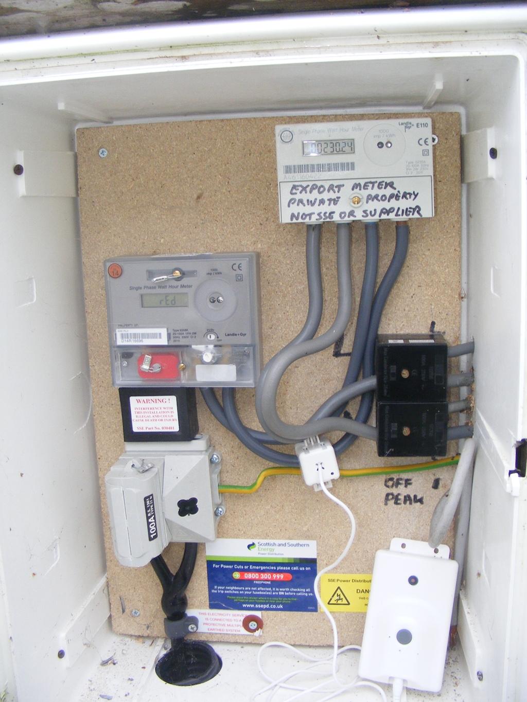

Dillsue Posted May 21, 2023 Share Posted May 21, 2023 On 20/05/2023 at 08:37, ProDave said: (I have fitted my own export meter) Interesting. Would that be a standard dumb digital meter wired in reverse?? Link to comment Share on other sites More sharing options...
ProDave Posted May 21, 2023 Author Share Posted May 21, 2023 1 hour ago, Dillsue said: Interesting. Would that be a standard dumb digital meter wired in reverse?? Yes exactly the same as my generation meter. Note the writing on it to avoid misunderstanding with any meter reader. Note also my import meter is displaying rED that means Reverse energy Detected (the small amount of export) It alternates between that and the import reading. Nobody has raised this as an issue yet. Link to comment Share on other sites More sharing options...
Dillsue Posted May 21, 2023 Share Posted May 21, 2023 4 hours ago, ProDave said: Note also my import meter is displaying rED that means Reverse energy Detected (the small amount of export) It alternates between that and the import reading. Nobody has raised this as an issue yet. Ours displays RED too on account of the not so small ammount of export. I read somewhere a bit ago that your style of meter(ours to) actually records energy flow in both directions but can only display one figure. I have it in my head that there is a way to display the second figure but can't remember how to change it or where I read it!! Link to comment Share on other sites More sharing options...
ProDave Posted May 21, 2023 Author Share Posted May 21, 2023 It can be read via the IR port, that red flashing light is one of 2 IR sensors / receivers and the right gadget can read all the data. The rED thing was initially there to detect people trying to reverse the meter in the hope it would run backwards. Link to comment Share on other sites More sharing options...
