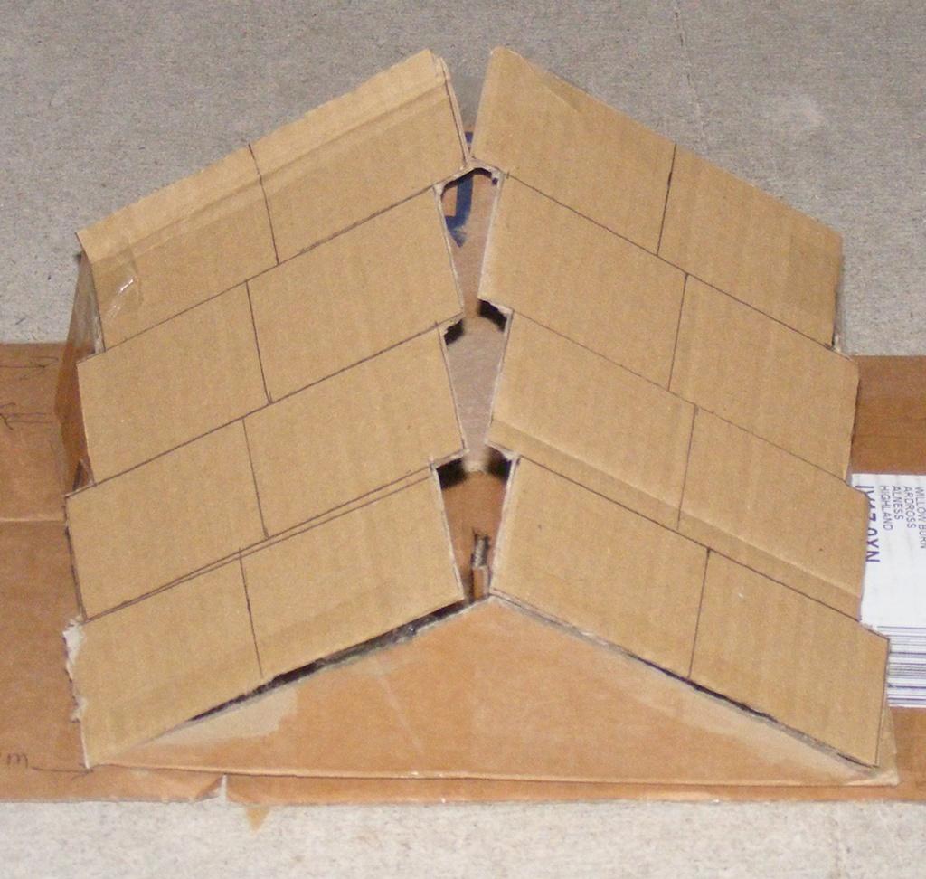

ProDave Posted December 28, 2018 Author Posted December 28, 2018 So I went and pegged it all out on the ground and found it was a bit tight for space, one end of the array would have been under overhanging tree branches. So a bit of re modeling with the "cad system" By putting the panels landscape, and stepping the rows gets the width down. Not the prettiest arrangement but practicalities dictate. It increases the depth but I have plenty of that. Other news, I have been busy on ebay. I wanted 2 generation meters, but found someone selling 4 of them for less than the cost of buying 2, so I will have a spare or 2 to put on the market place. And I have been looking at inverters, and just ordered one of these https://www.ebay.co.uk/itm/Trannergy-SGN4000TL-Solar-PV-Inverter/182792629582?hash=item2a8f4a2d4e:g:fX8AAOSwJixZy6Os With todays ebay sale code, I got it for £255

ProDave Posted December 29, 2018 Author Posted December 29, 2018 picture borrowed at random to illustrate the principle The rail (in this case unistrut) will run perpendicular to the long axis of the panels, 2 rails per panel. "between" panels will be clamped to the unistrut with M6 bolts and penny washers bolting into unistrut channel nuts. So there will be a gap of 6mm between panels that I will seal by covering probably with aluminium tape. The end panels will need a Z clamp to fix them to the unistrut. Form my panel arangement I will need 8 lengths of unistrut each a little over 4 metres long. I will have 2 rows of panels and there need not be any gap at all between them and they will get the same aluminum tape to seal the joint.
