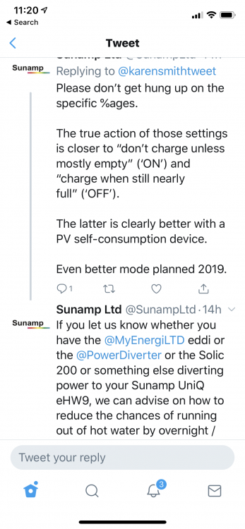

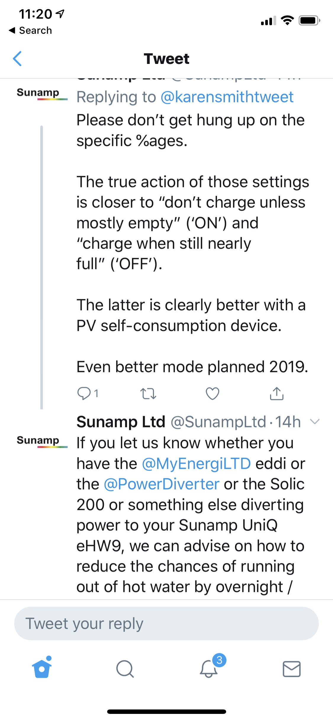

Onoff Posted December 25, 2018 Share Posted December 25, 2018 Interesting Sunamp comment saying don't get too hung up on %ages: https://jumpic.com/hashtag.php?q=Sunamp Link to comment Share on other sites More sharing options...
Triassic Posted December 25, 2018 Share Posted December 25, 2018 14 minutes ago, Onoff said: Interesting Sunamp comment saying don't get too hung up on %ages: https://jumpic.com/hashtag.php?q=Sunamp They go on to say...... “The true action of those settings is closer to “don’t charge unless mostly empty” (‘ON’) and “charge when still nearly full” (‘OFF’). The latter is clearly better with a PV self-consumption device. Even better mode planned 2019.” Well that clears that up then!! Link to comment Share on other sites More sharing options...

newhome Posted December 25, 2018 Share Posted December 25, 2018 Reply to my Tweet Link to comment Share on other sites More sharing options...
newhome Posted December 25, 2018 Share Posted December 25, 2018 What’s the next question to ask then ? Link to comment Share on other sites More sharing options...
Onoff Posted December 25, 2018 Share Posted December 25, 2018 40 minutes ago, Triassic said: They go on to say...... “The true action of those settings is closer to “don’t charge unless mostly empty” (‘ON’) and “charge when still nearly full” (‘OFF’). The latter is clearly better with a PV self-consumption device. Even better mode planned 2019.” Well that clears that up Looking at this in the cold light of day you have early adopters accepting that they're guinea pigs and that their feedback is an essential part of the R&D process. There is then a perfectly reasonable expectation that the newer models should work just as well as the old. There's then likely a section of less tech orientated people, perhaps with money to burn one may term "demanding clients", expecting it to work out of the box with no faults or glitches. Chuck in people who are a mix of all these traits. If in the early new year Sunamp come up with a definitive fix then on the grand scale of things then that's pretty quick and hats off to them. Link to comment Share on other sites More sharing options...
