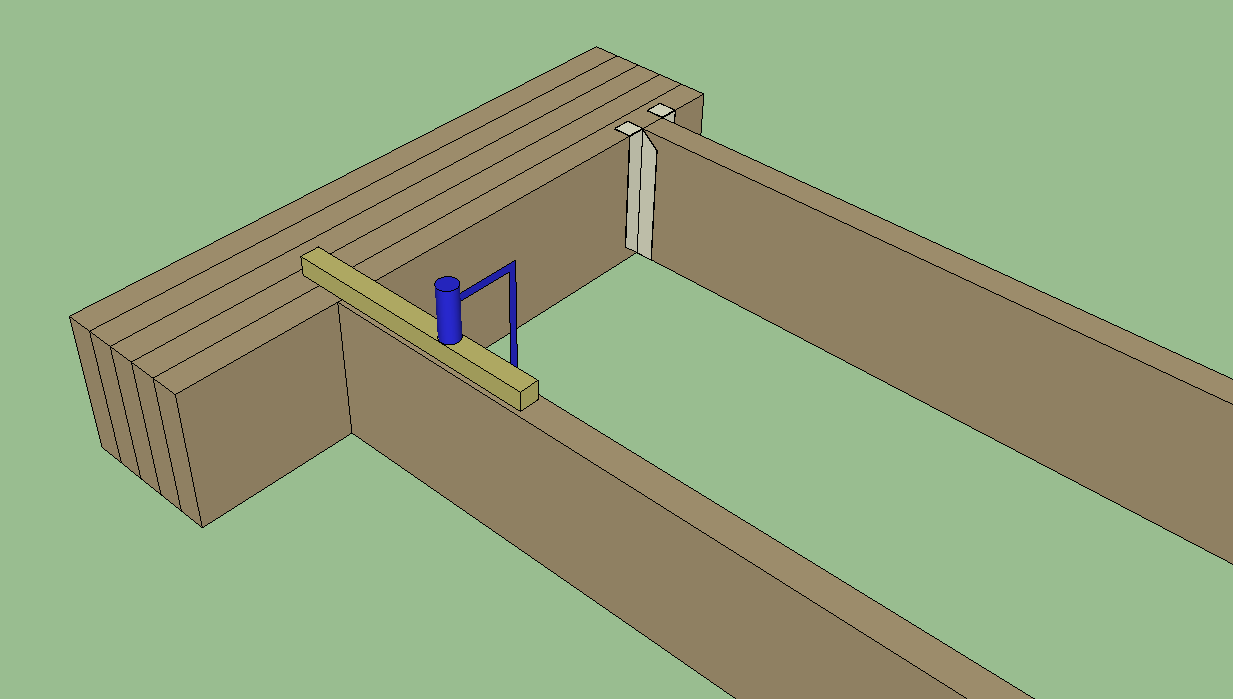

Ed Davies Posted November 24, 2018 Share Posted November 24, 2018 What I did for my joists was to clamp a stick to the top of the joist to rest over the header. If the stick is stiff enough and the clamp is tight this ensures that the top of the joist lines up with the top of the header and still allows a bit of movement for the bottom of the joist to get the best compromise on verticality of the joists (some of mine were a bit twisted so it wasn't possible to get both ends completely vertical). 1 1 Link to comment Share on other sites More sharing options...

ToughButterCup Posted November 25, 2018 Author Share Posted November 25, 2018 23 hours ago, Ed Davies said: What I did for my joists was to clamp a stick to the top of the joist to rest over the header. If the stick is stiff enough and the clamp is tight this ensures that the top of the joist lines up with the top of the header and still allows a bit of movement for the bottom of the joist to get the best compromise on verticality of the joists (some of mine were a bit twisted so it wasn't possible to get both ends completely vertical). [...] Elegant. Of the techniques suggested, yours, Ed (the Scottish one) , appeals the most. I'll try the others too just for reference. The post on your blog about checking your laser has got me thinking too. Thanks. Link to comment Share on other sites More sharing options...
joe90 Posted November 25, 2018 Share Posted November 25, 2018 Not heard of that one before but very simple and effective , it’s what I would do in future but not planning another build ? Link to comment Share on other sites More sharing options...
